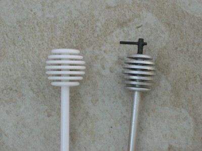

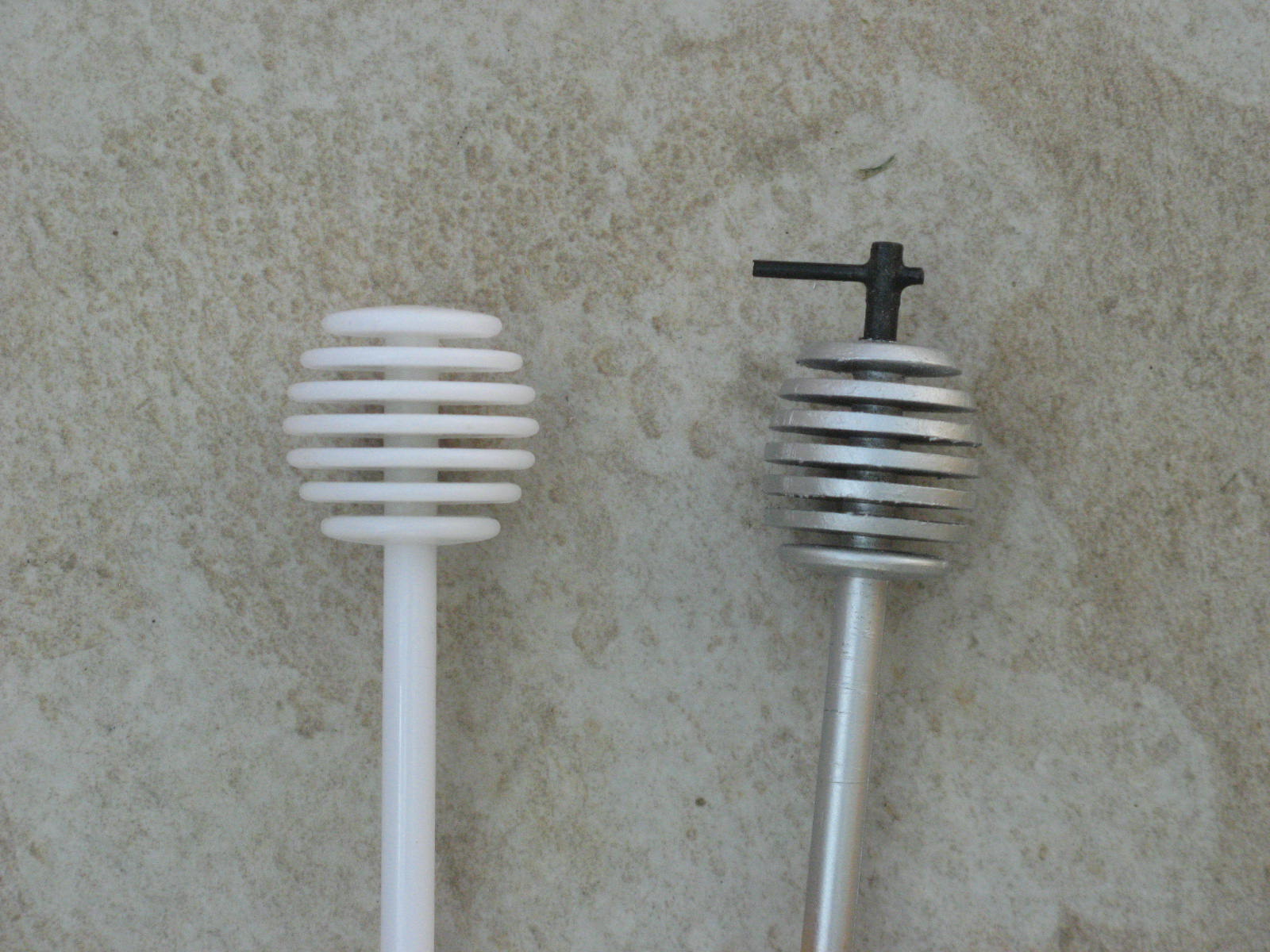

I don't think I can contribute much of an electronic nature but this easy dummy engine might be of interest to those who don't like to get their fingers oily. It is made from a "Honey Dipper" bought for a few pence off ebay.
On the left is as it comes. It wasn't quite the right shape so I stuck it in an electric drill and reduced it a bit with some sandpaper. Compression screw is made from a 3mm bolt and piano wire.- Shaun

I think most honey dippers are much the same size, these were plastic but many are made of wood and I think all will need some shaping and styling. I styled this one on the Mills .75 though it is a little bigger but I think it looks the part and and on a retro model looks a lot better than an electric motor.

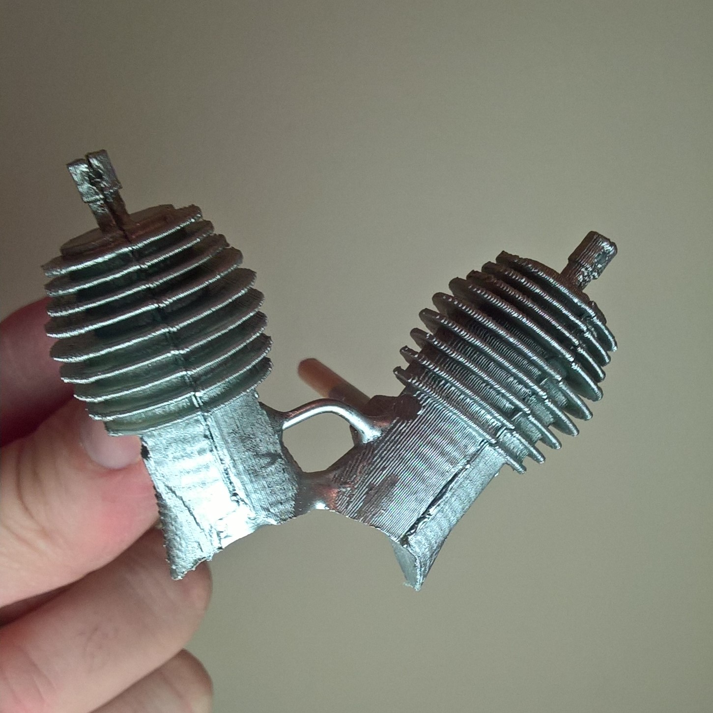

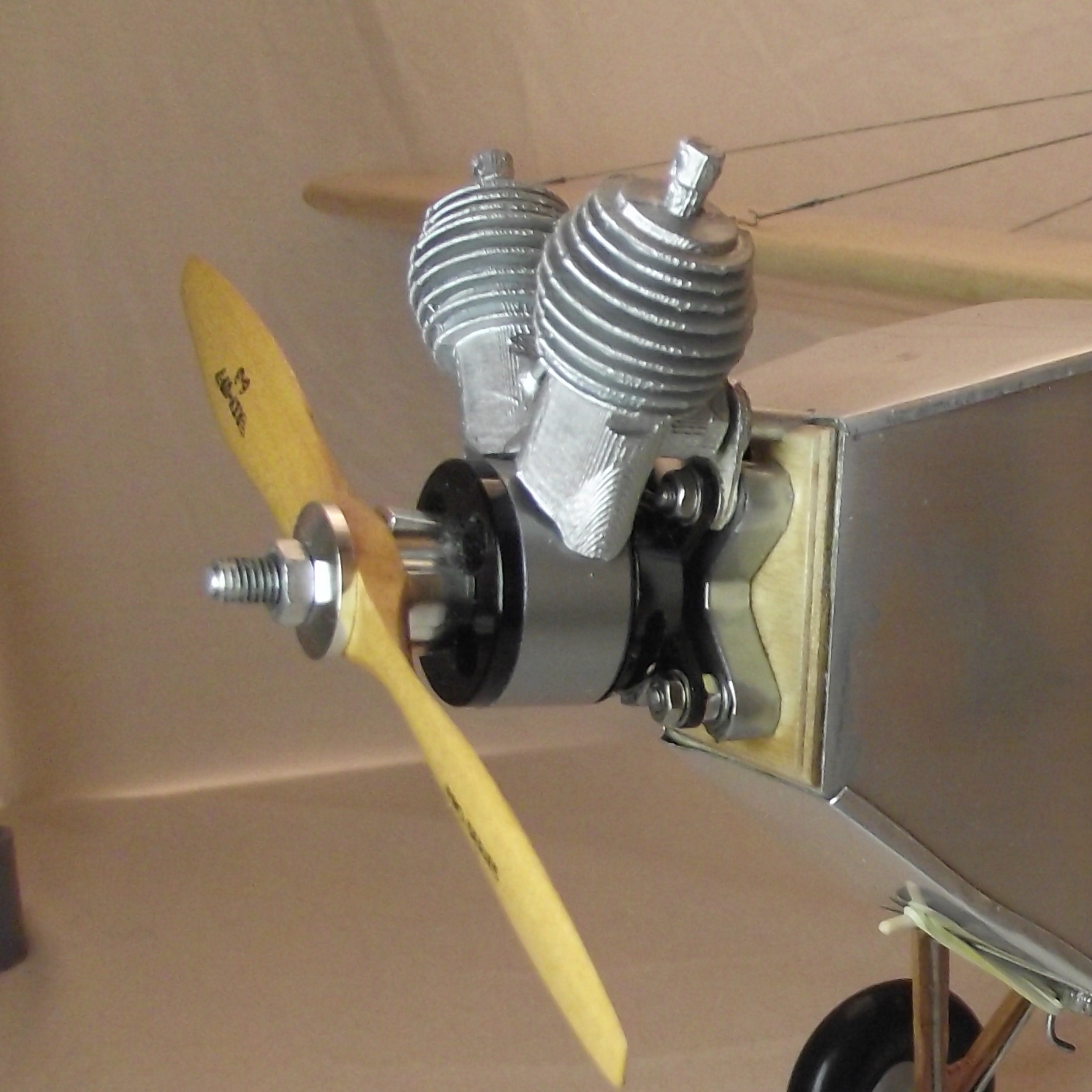

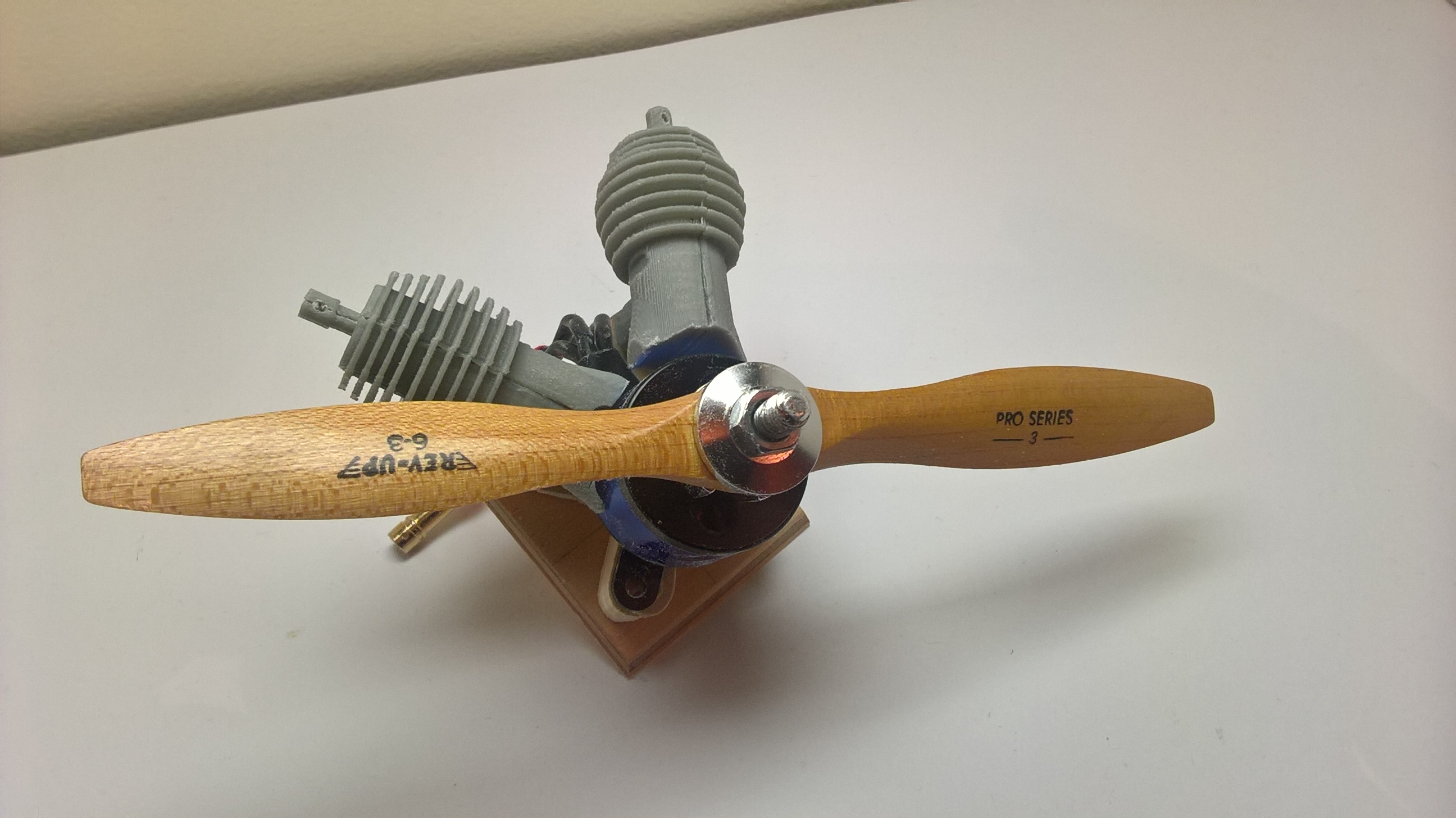

As Shaun said earlier in this thread I built a v-twin engine for the Sir Jasper build using two 3D printed Mills .75 cylinders. Shaun should have the contact for the cylinders, and they were not expensive.
The inspiration was the AVRO 560 monoplane:
Here's a mockup of how I wanted to put it all together:

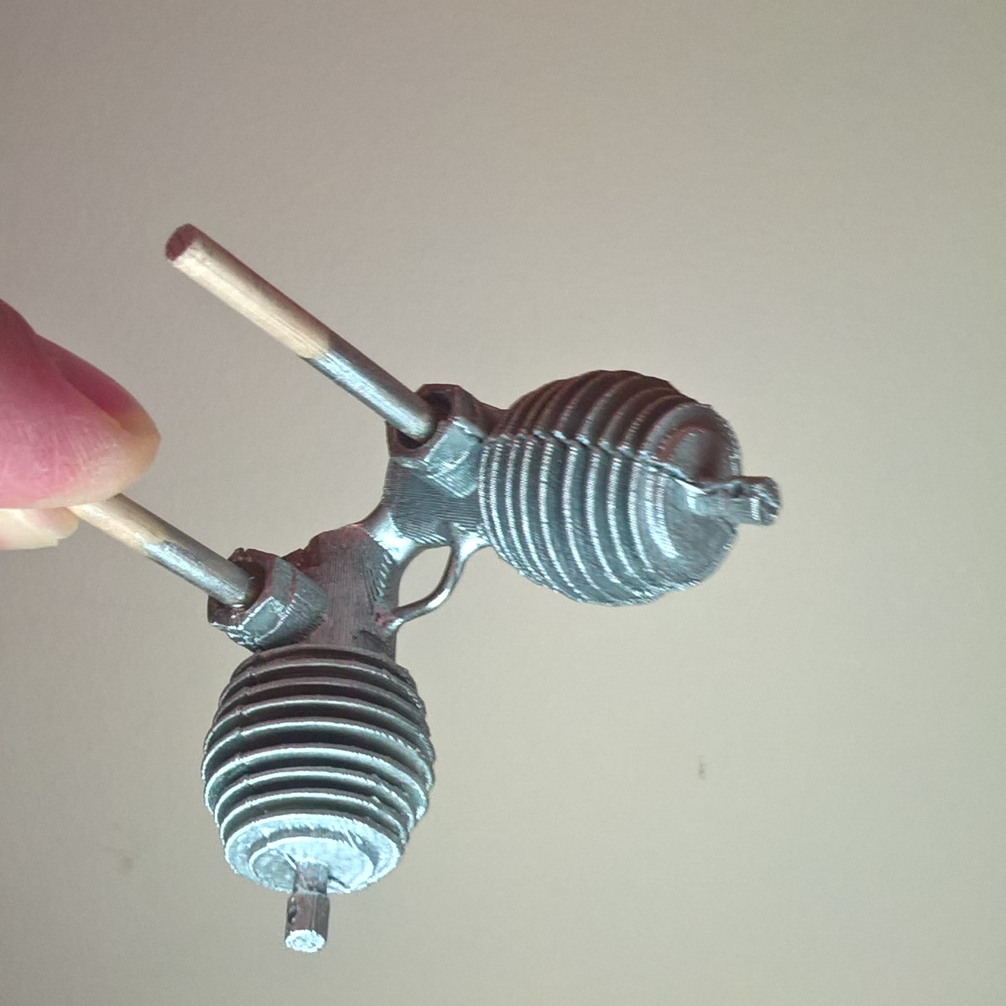

I shaped the bottom of the cylinders to clear the outrunner motor housing. You can see I joined them together at the bottom of the "V" and I made a link using piano wire to join them a little way up also:
Where the fuel lines would be mounted I glued in two short lengths of dowel - this would allow me to plug in the dummy cylinders into the nose of the fuselage:

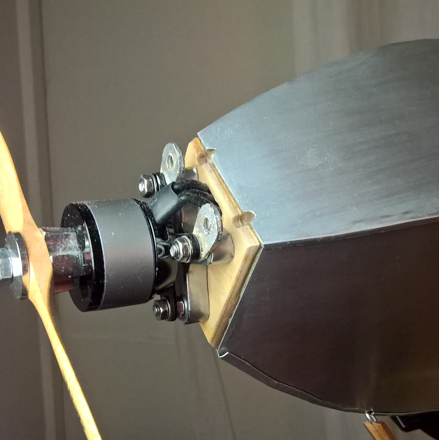

And here is the front of the fuselage - I made two little brackets so the dowel slots through snugly and then into the front of the fuselage. I also covered the outrunner casing with silver vinyl as the original blue wouldn't look right:
Finally the completed v-twin engine:
Carl

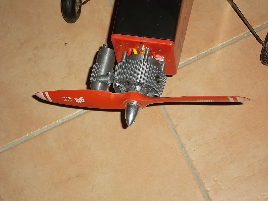

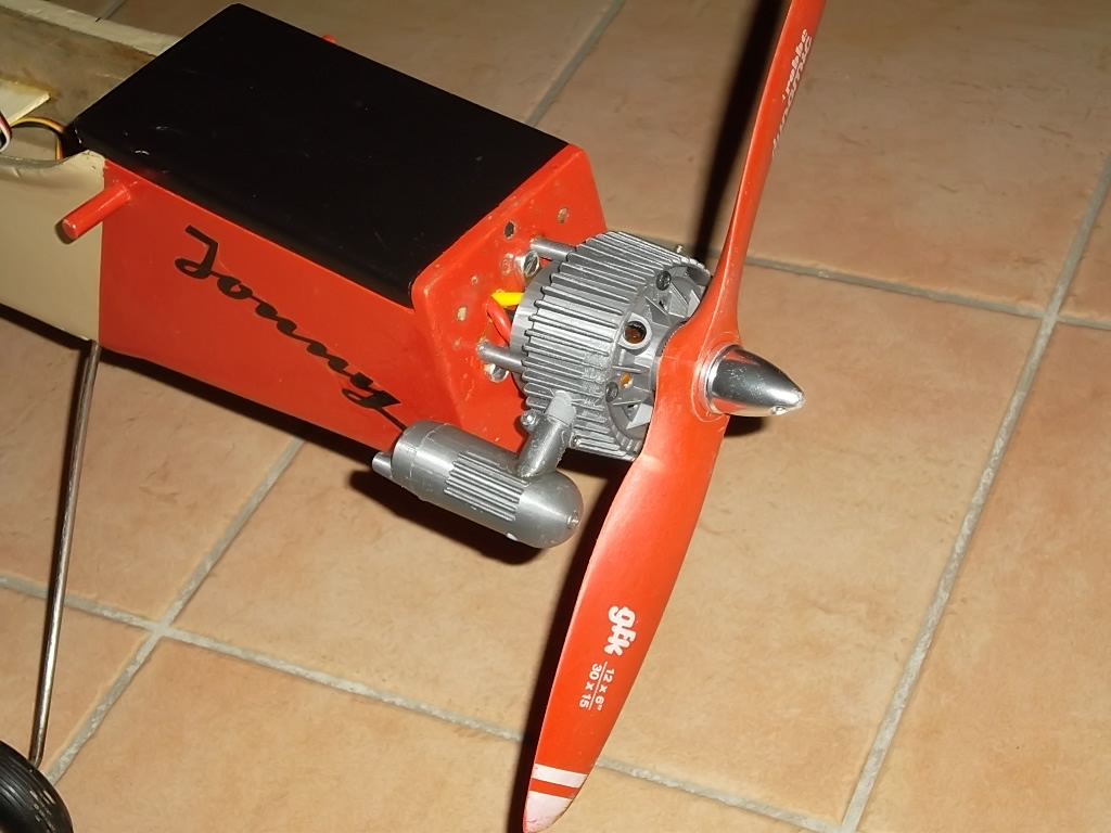

This is my dummy engine on my old Wik Jonny. It looks like a Graupner Wankel engine, but there is a 40 size brushless motor inside. The dummy engine including the muffler is 3D-printed.
CheersFrank
