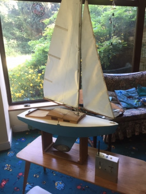

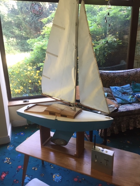

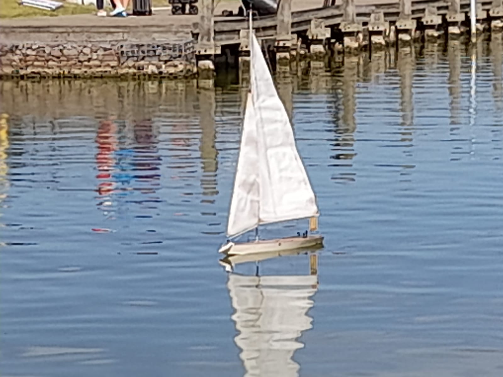

Here's my ancient but serviceable Starlet (the Vic Smeed one from the '60s not the earlier '40s one). Originally built with a modified RCS Guidance System single channel to provide proportional rudder and sails in/out on two buttons. Back in the day it used mark/space and fully on/off to drive relays and a damped WW2 aircraft indicator linked to a motor/gearbox for rudder with Marx mini richard for the sail winch. Very effective and sailed at Prince's Park Eastbourne, didn't matter about radio interference, there just weren't any other boats around! Now updated to 2.4 Ghz with later homemade ali case (+ Arduino and Frsky DIY), first sail at Chipstead lake Sevenoaks a couple of weeks ago. All inspired by Phil_G, P Luby and other members of the forum so big thanks to them.

PS I righted your capsized photo!

Clearly lack of enough lead on keel caused capsize!

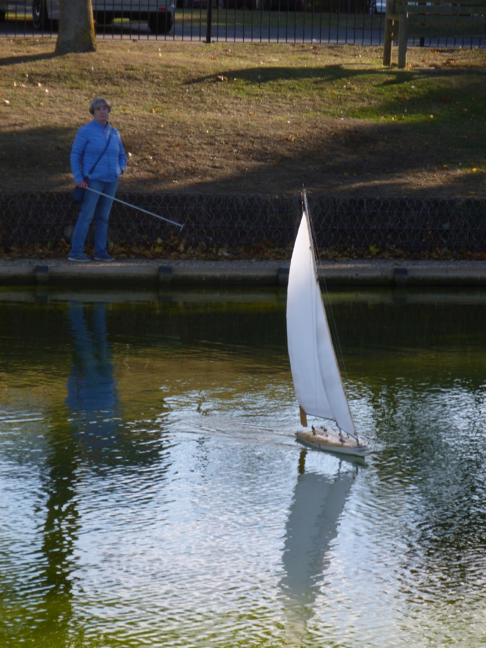

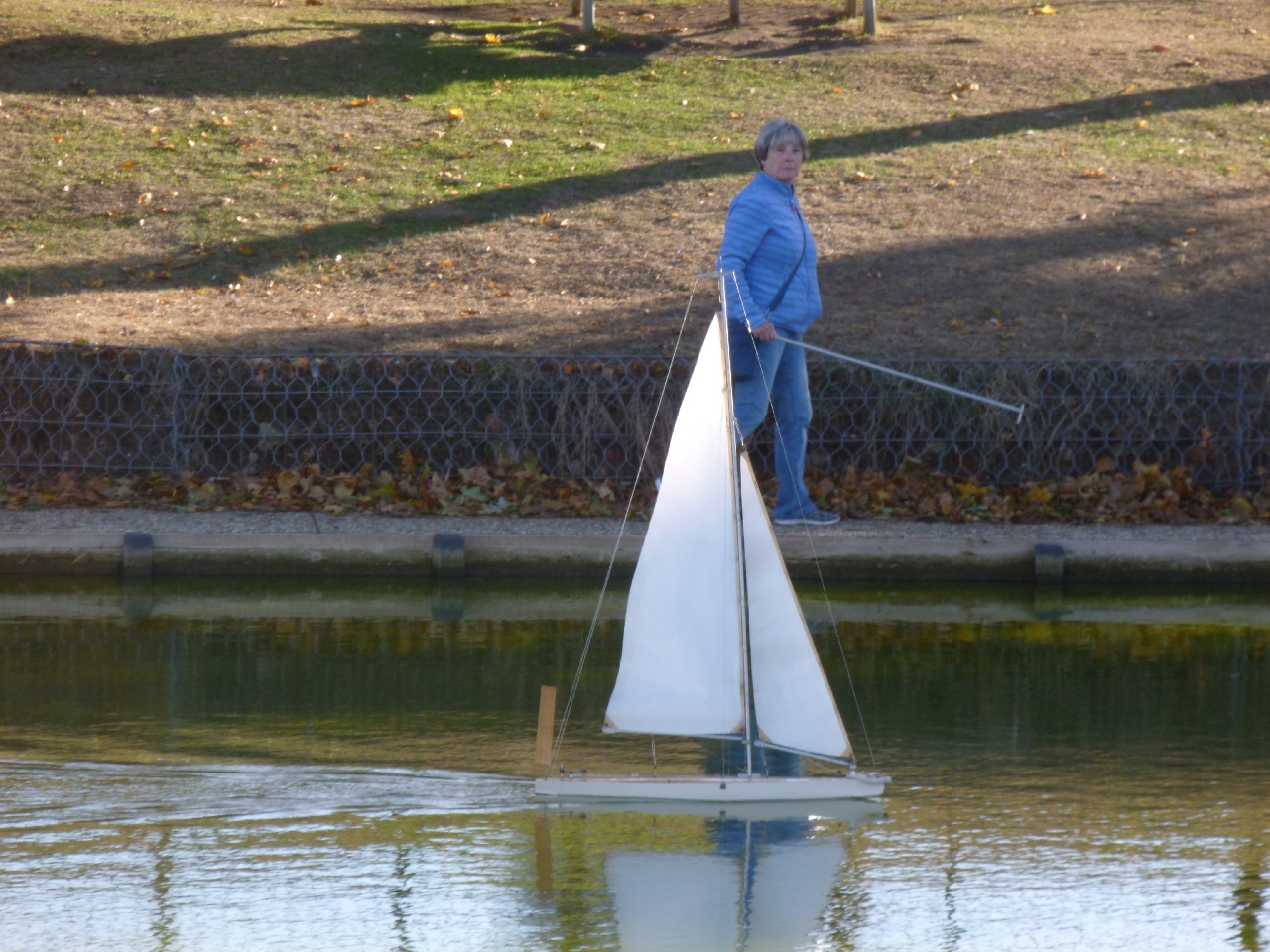

This is a 36R Vic Smeed Gosling using vane gear steering, and giving my wife and I some gentle exercise!
