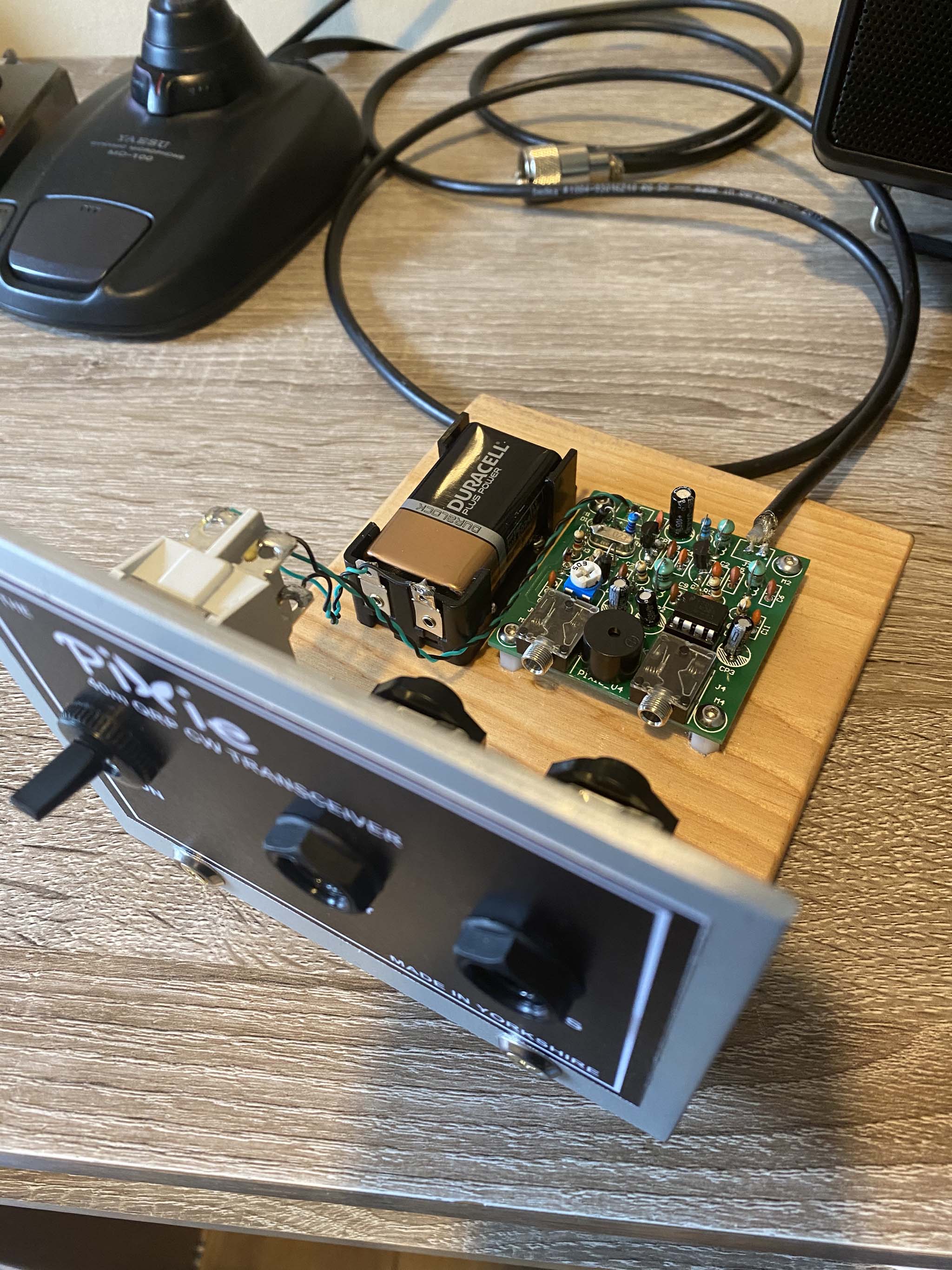

I’ve finally started one of them.

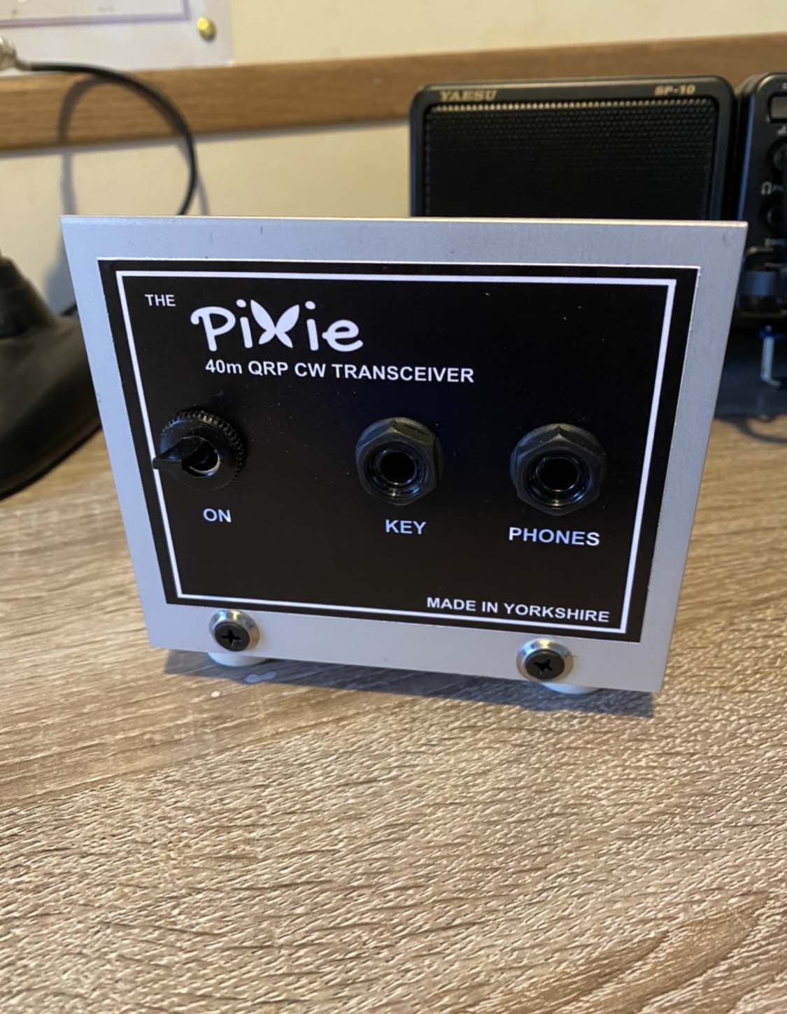

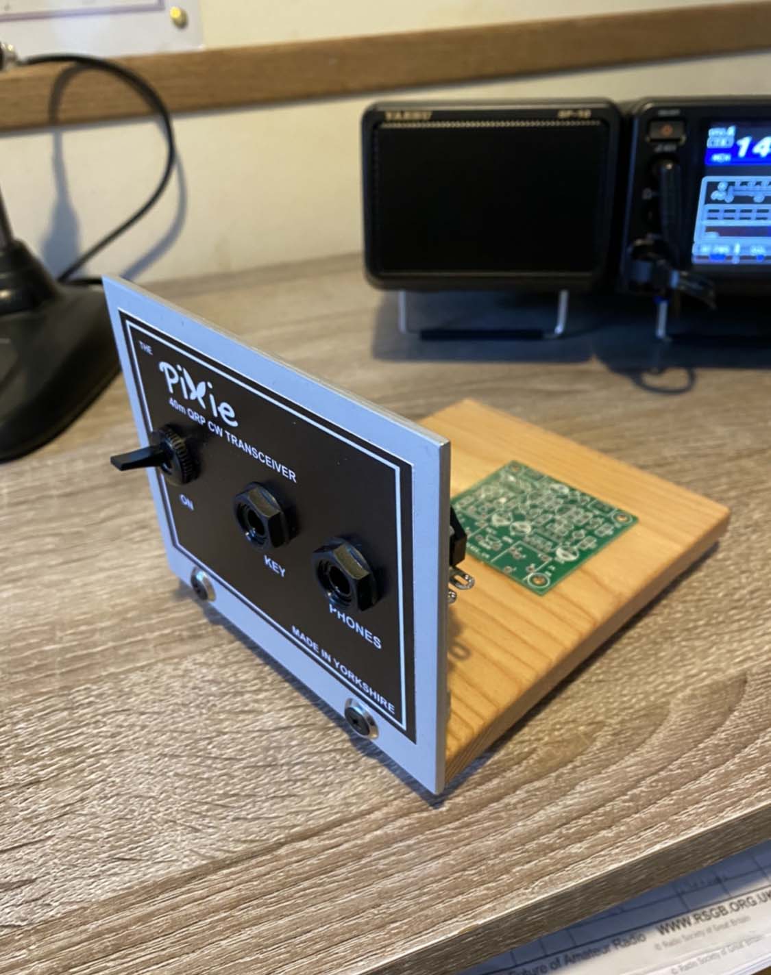

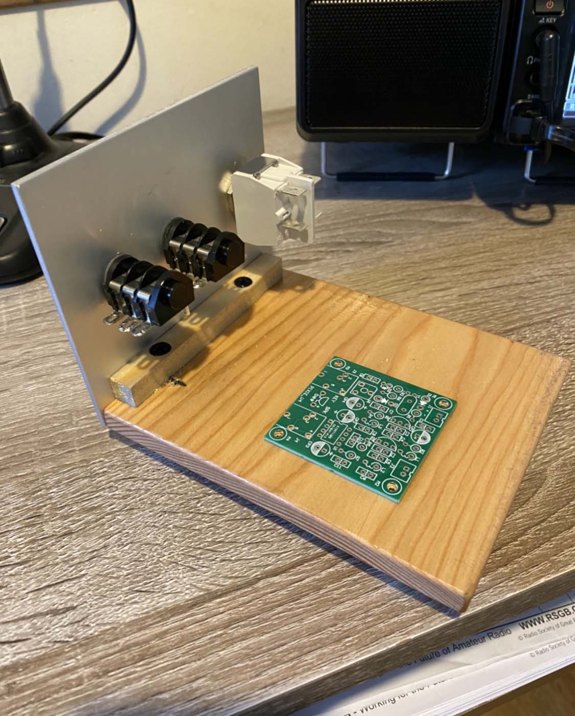

Built the front panel and base and mounted the PCB.

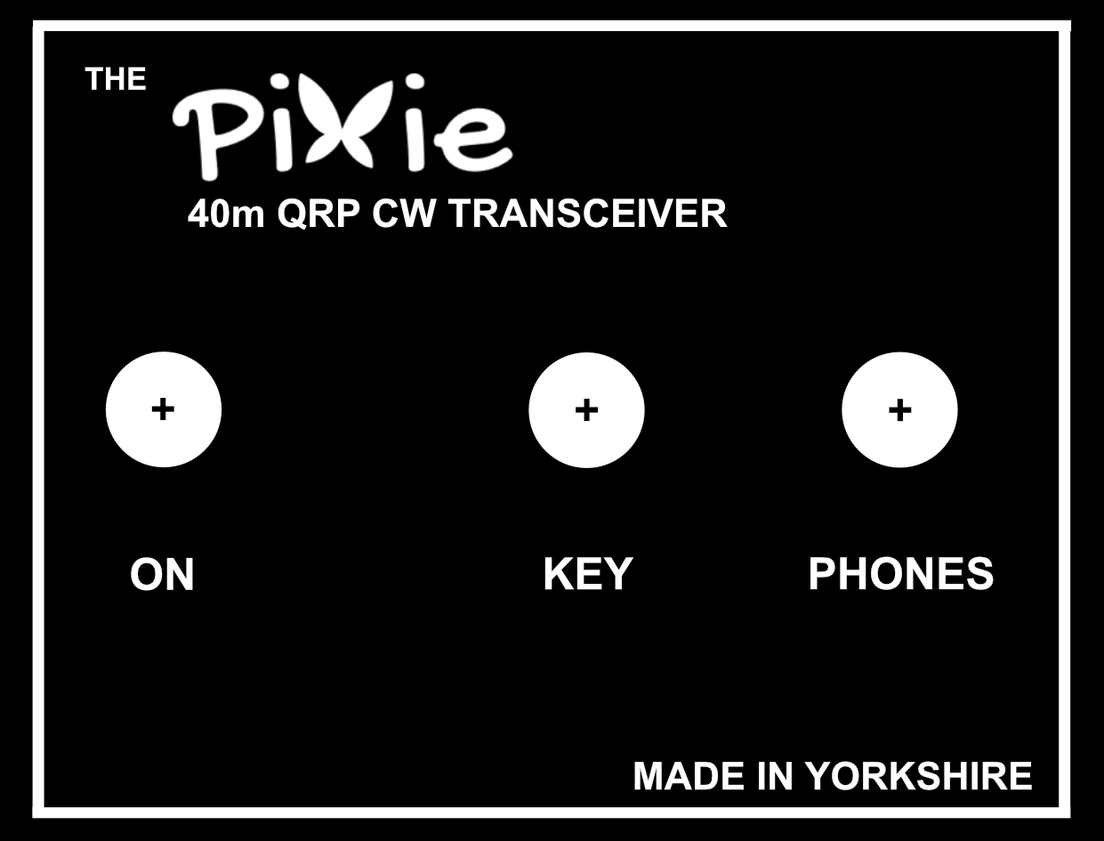

Decal is photoshop designed and stuck on 3mm ally plate.
Then a thin coat of clear laquer.

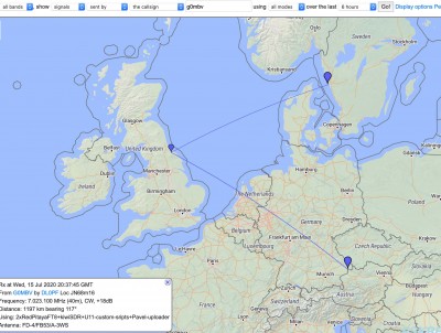

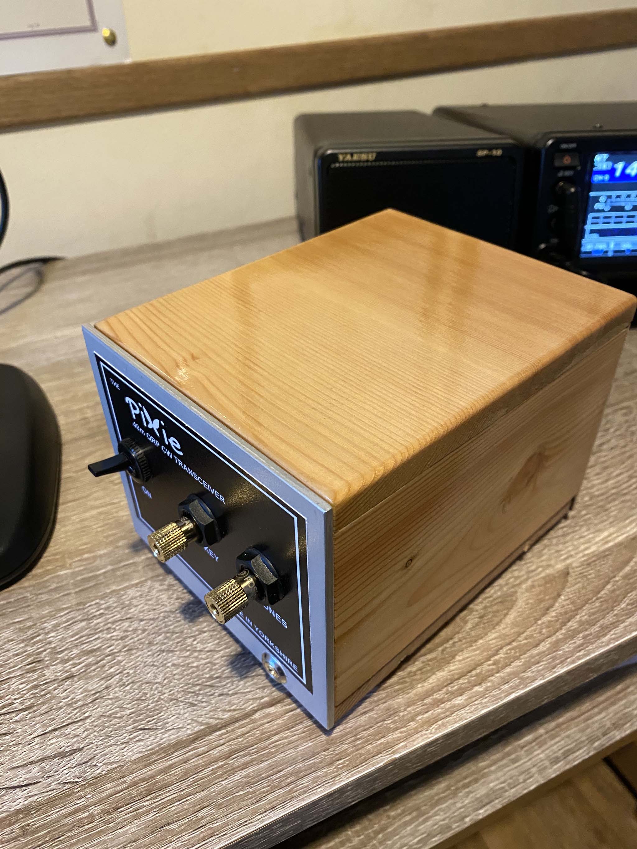

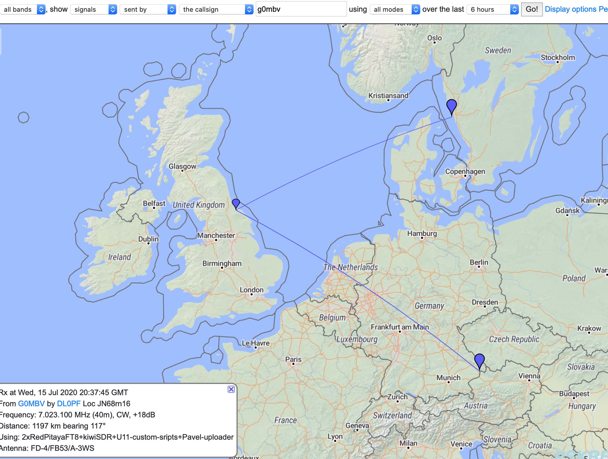

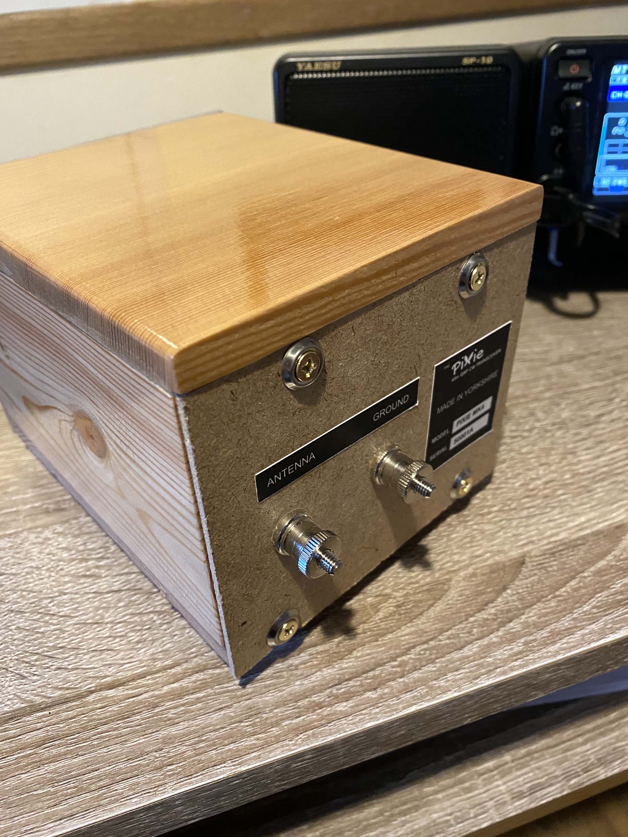

Pixie now complete,
Sent CQ last might and was heard on the borders of Austria and Sweden.
Here is a screenshot from PSK reporter. Plus the finished Trx

Hi Ron,

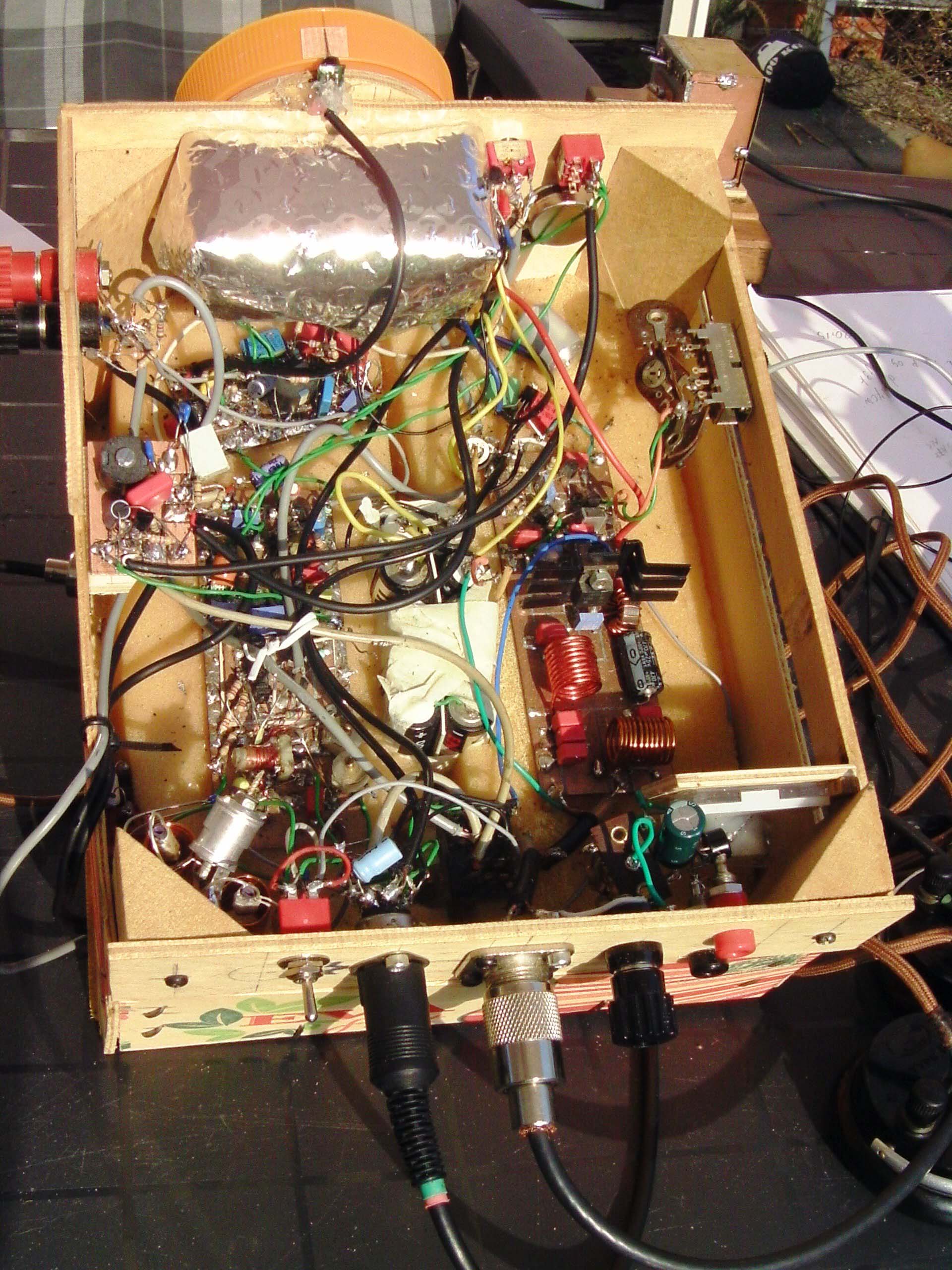

Nice project but nearly an empty box compared with my 40m tranceiver. ;)
What is the output power?
Cees
