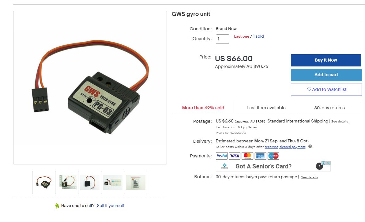

Pchristy wrote: 10 Sep 2020, 09:06 I used a small (and cheap!) GWS gyro that had been in my junk box for a while.
Must have been a cousin to this one then...... :shock:
https://www.ebay.com.au/itm/GWS-gyro-un ... .l4275.c10
Posts: 488
Joined: 16 Feb 2018, 13:57
Location: South Devon, UK
Re: Mayfly - by Peter Valentine
Post by Pchristy »
Yes, that's the gyro! I've got a few of them! Not terribly brilliant because of the neutral drift (not sure if its volts or temp causing it!), but adequate for small models.
I think the seller is being very optimistic with the price! :shock:
