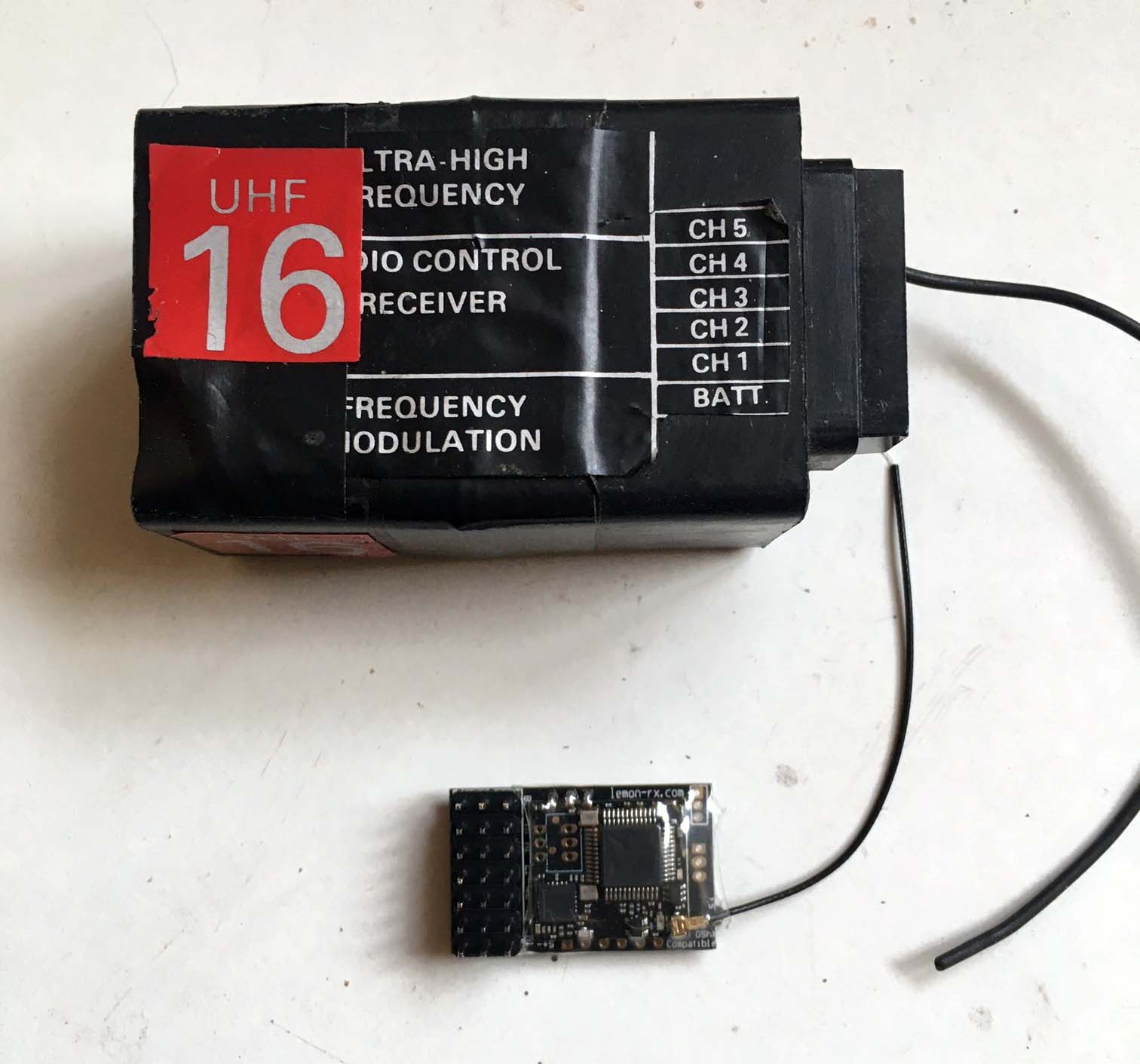

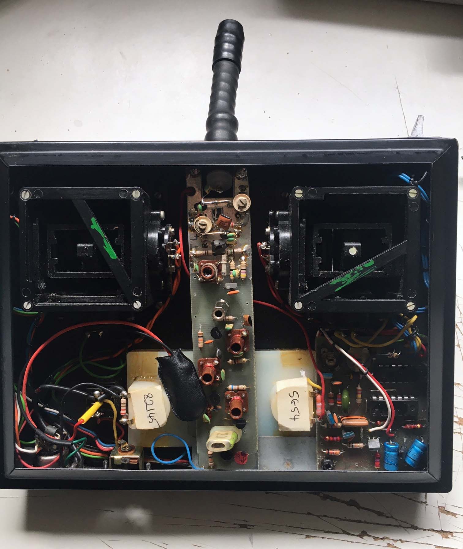

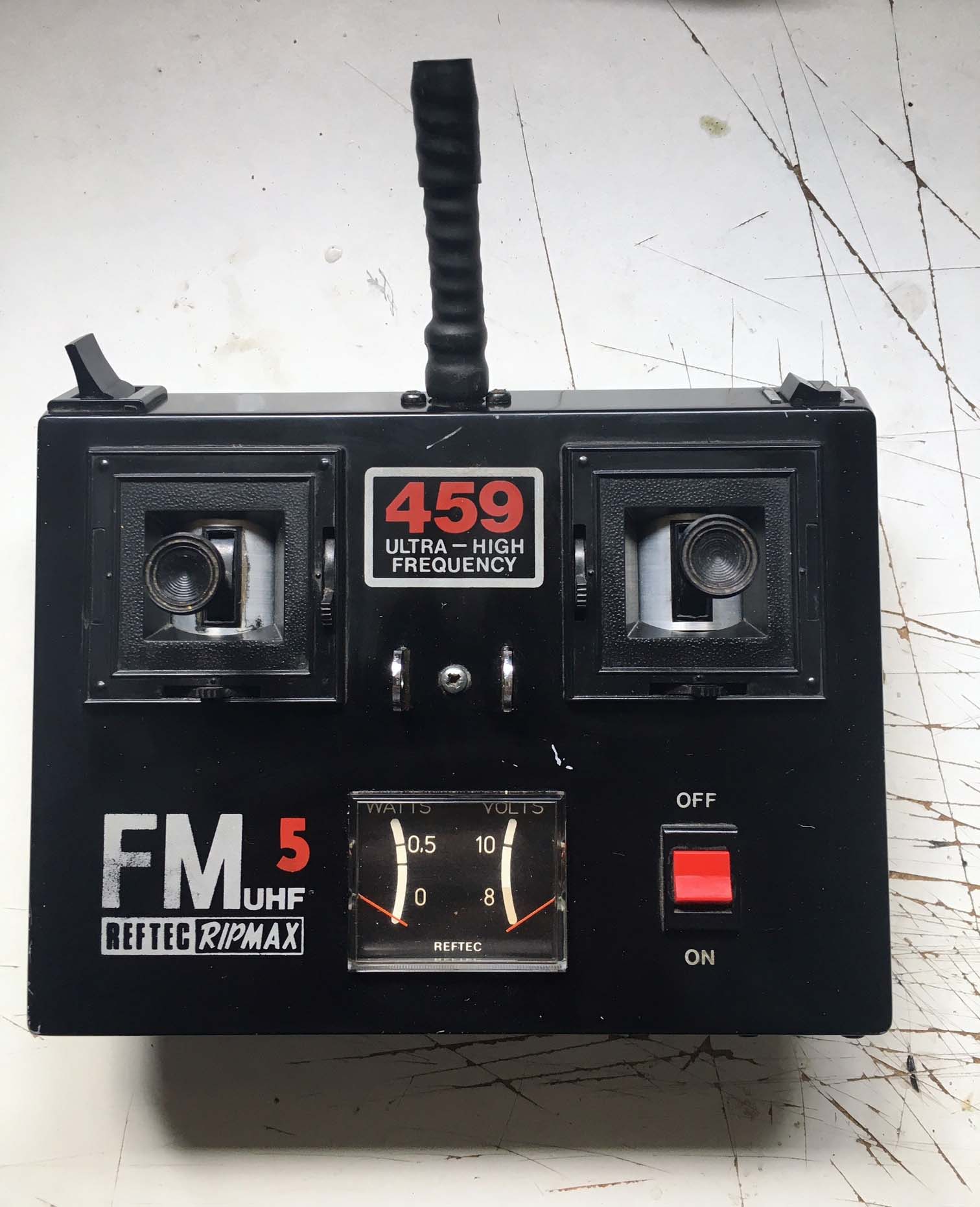

My first conversion was this Reftec 459 mhz set, got several of these but thought one for old times sake I can use again, the original system for its time was good far better than 27megs, but one big downfall , the receiver had an if board which had a frequency of 27 megs, so if it came into close proximity of A 27meg Tx, hey presto , stopped working......they were also fraught with dry joints as they aged.....

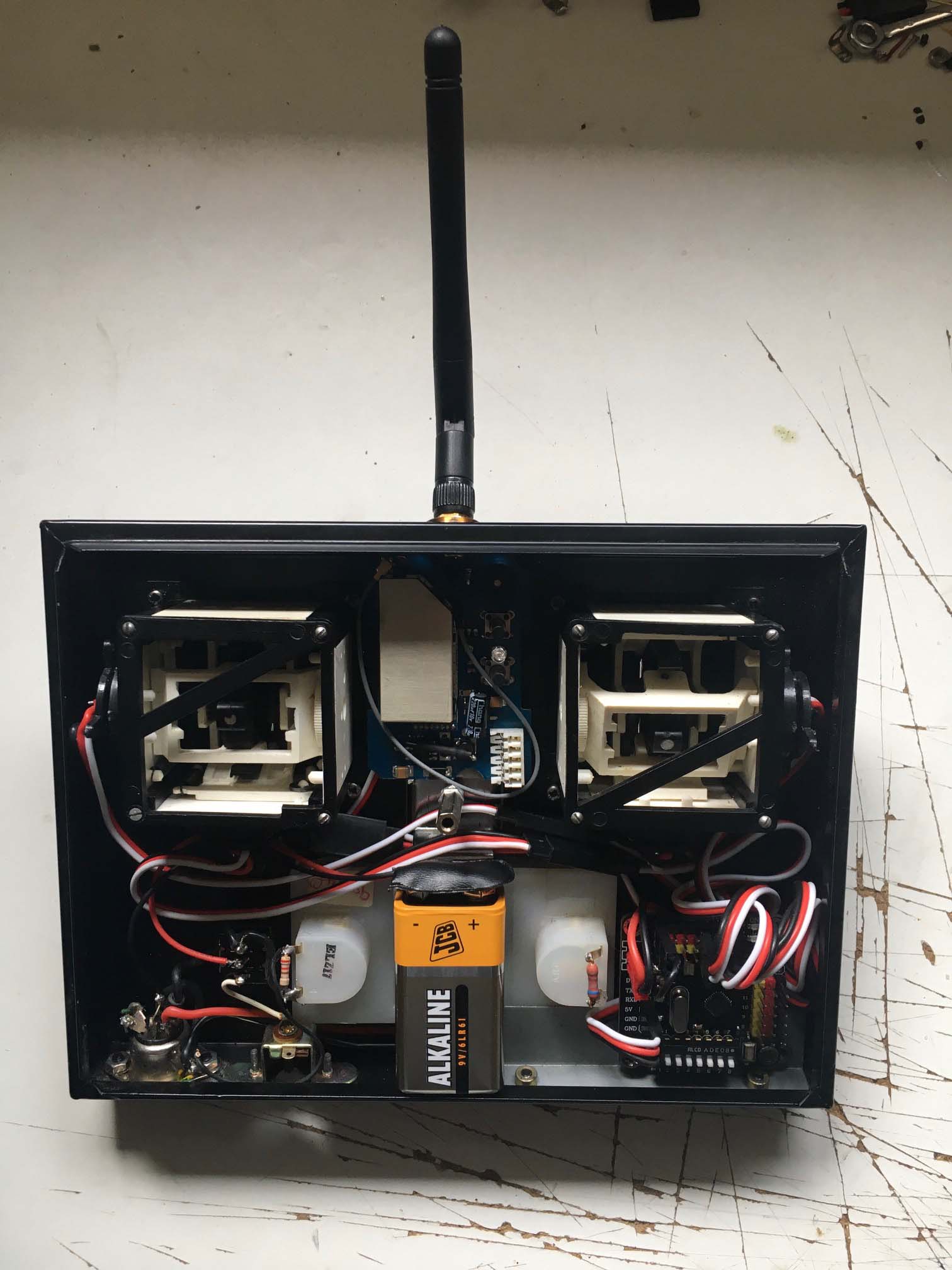

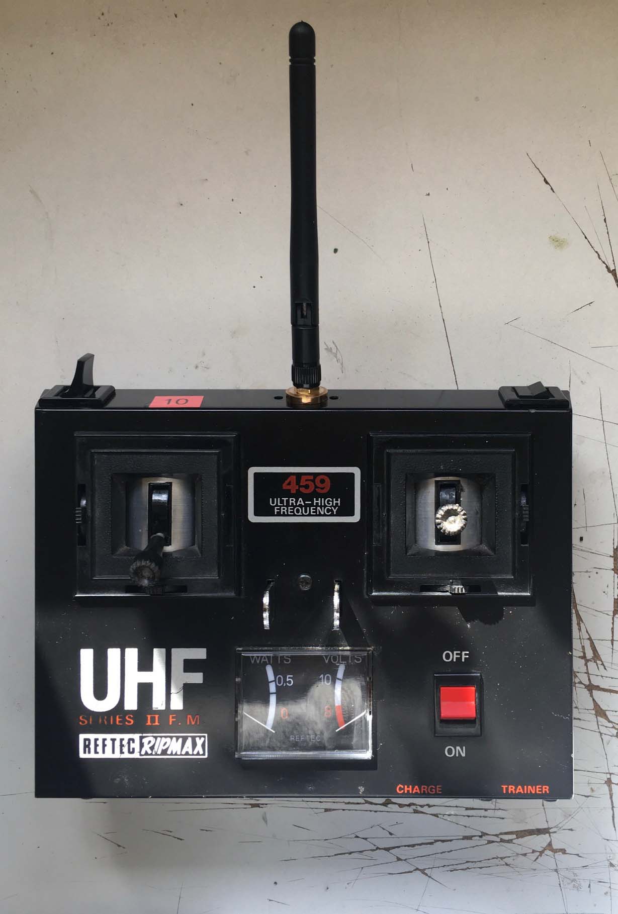

Below are before and after pics, I used an Orange Rx DSM tx module, removed from its case to reduce overall size of it, and of course the 'Famed' PhilG encoder boards stashed in the bottom right hand corner, along with a modern day dsm Rx of which I use, shown below along side the original enormous Reftec receiver, the Tx is powered by a 2s 7.4 volt LiPo battery ( I know there's a pp3 shown , that's been changed since pic taken) , and so far have proved to be enjoyable to use it and a doddle to set up ....

If you're short on space the EBL PP3 lithium batteries are very good - me & Frank use them quite a lot, they're 2S 600mAh so perfectly ok for transmitters: viewtopic.php?f=61&t=81&p=1359#p1359 and viewtopic.php?f=62&t=130
Did you get the two meters working too?

Thanks Phil for the heads up on the pp3 alternative...
Regards to meters, the voltage one was relatively easy as you know, the output power is in hand, I think refetec from how I see the wiring , it used to read the current drawn on the rf board and associated that with a rough rf output, it was not as far as I am aware a 'true' rf meter, although I could stand corrected........
