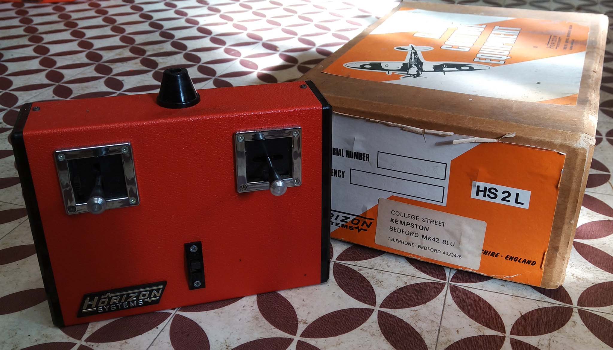

Just received this near mint Horizon HS2D from a fellow modeller.
Bit of a clean up and some new dry cell batteries and it is all working again on 26.995 Mhz.

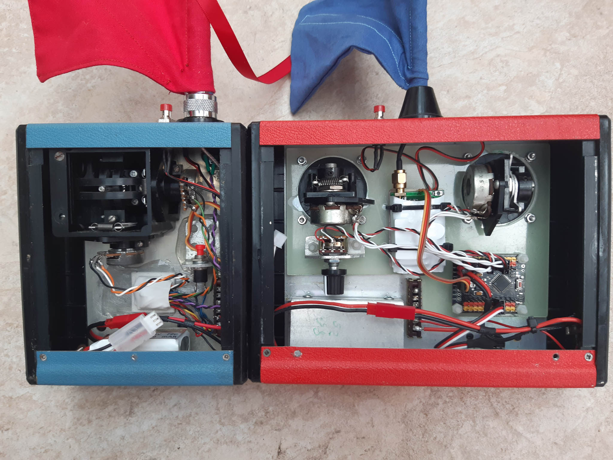

Very nice and thumbs-upped Stu, I also have a 2L which was the twin-stick two-channel version
The Ron-converted HS2D is one of my favourite trannies of all, its so nice. It has an additional channel for throttle, on a rotary pot:

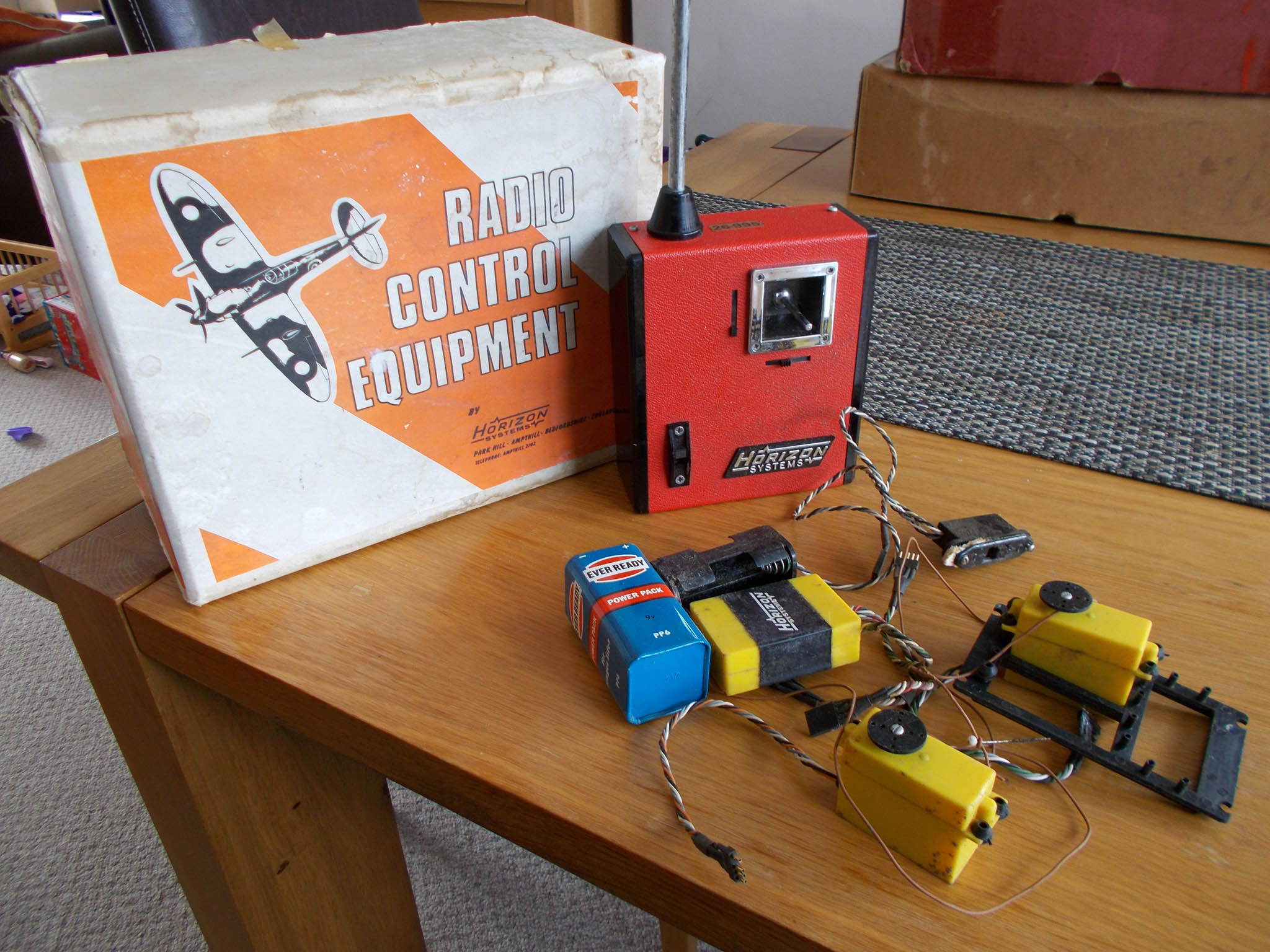

I too have just bought a 2 channel horizon. It’s cleaned up nice too. Yet to check it out but it’s destined for a vintage Marblehead Yacht I’m restoring.
My cousin had one of these back in the 70’s and I was dead jealous.

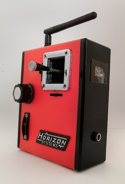

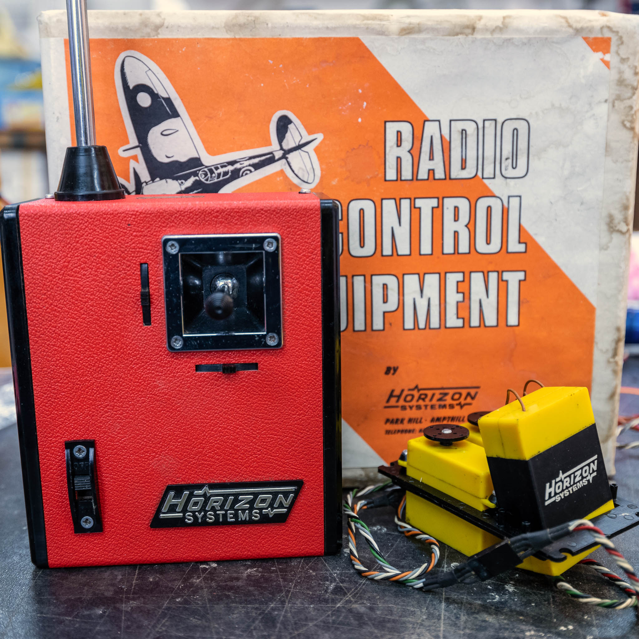

I've recently completed the 2.4GHz conversion of a Horizon HS2 single stick transmitter. I've added a rotary pot for throttle control to the front left of the case. This fits nicely between thumb and forefinger of the left hand for easy rotation.
It uses a 3 channel encoder, kindly supplied by Phil Green, on a DIY MORE Pro Mini Strong board. This feeds a FrSky XHT RF module.
I mounted the bind board in the upper part of the right cheek, covered by a clear acetate rectangle fixed in place using Nano clear gel tape. This provides some degree of waterproofing, but also enables the bind button to be depressed easily. The lower part of the right cheek has a Futaba-type charge socket for the 9.6 volt NiMH battery pack. The left cheek has a press button for the "Minute Minder" timer.
The red vinyl covered case was in a bit of a state when I acquired it, but I cleaned it with Swarfega and a toothbrush, and I think it came up well without causing any damage to the vinyl. Here's a picture. I would have provided more, but this one is large enough, and I have yet to find out how to shrink a Google Photos photo !

Re: Horizon HS2L
No pIcture visible Roger.
Try using Paint or similar imaging software and do a resize to 2000 pixels wide?
