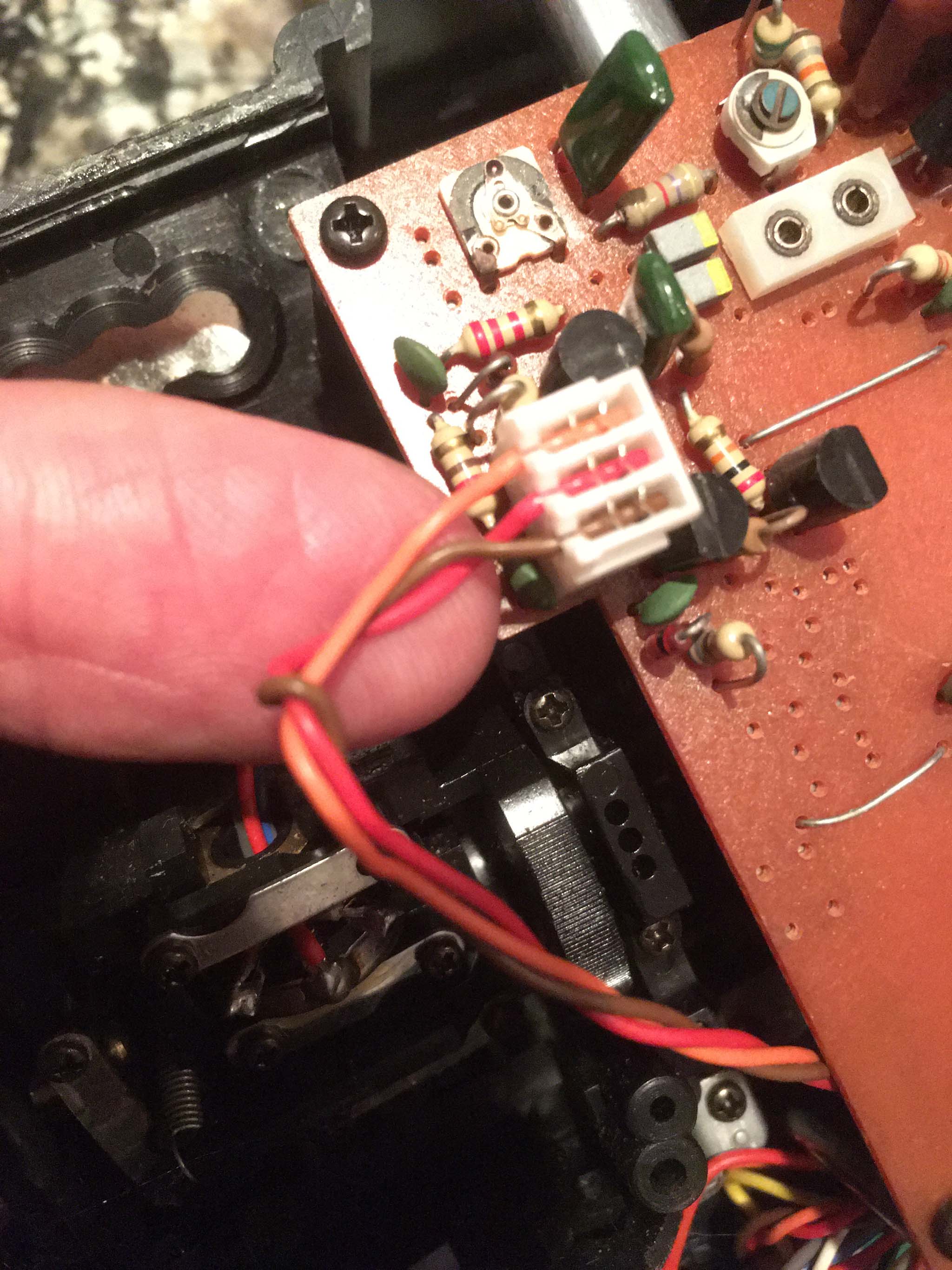

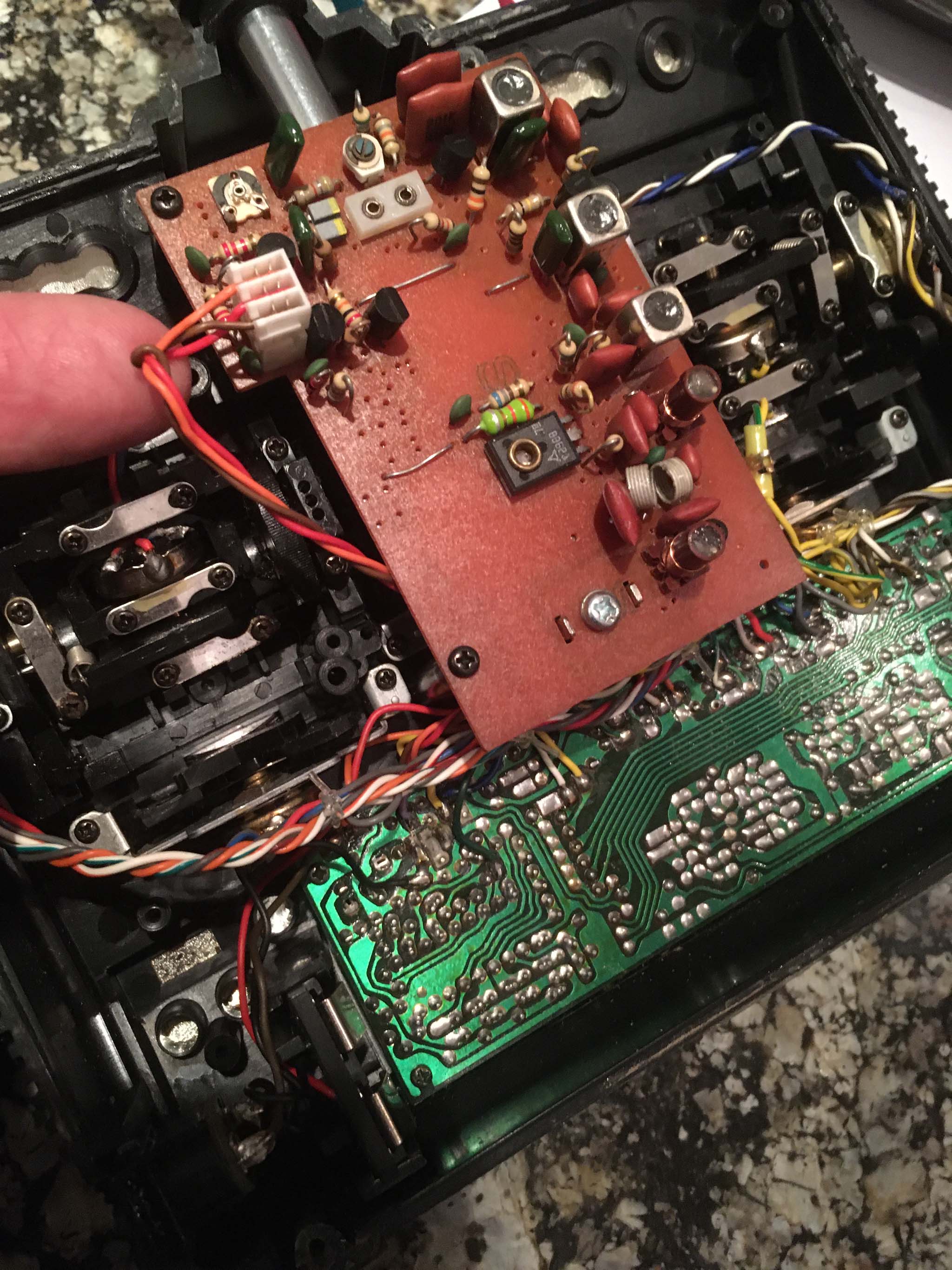

Hi guys I’m salvaging an 35mhz FM RF board from a redundant JR tx . The RF board works perfectly.
Now this will become the RF stage in a Reeduino Reed Tx.
I need to know the wiring colour code - simple I would have thought : Orange = PPM
Brown = earth and Red = +VE
HOWEVER ! before I connect it up in this fashion my multimeter suggests this is NOT correct!!! Seemingly indicating the reverse
Can somebody sort me out ?
JR RF Board ppm wiring

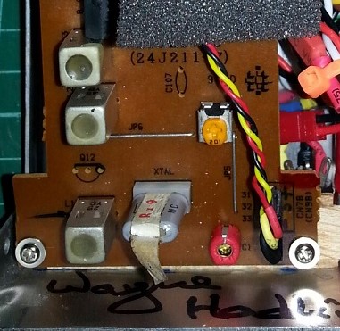

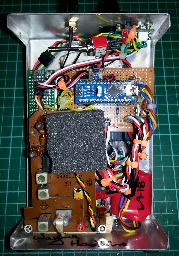

I found similar when I did my Ceptimus (i.e Martin) "super" s/c tx build into a Controlair Mule case. The JR RF board I used is slightly different to yours (mine is 29 Mhz FM) - you can see that I changed the wiring to more conventional colours so I wouldn't trip myself up later on I've labeled the pin connections on the board. Regardless, as Bluejets said, chase the orange wire back to the main board - it should go to ground if its the same as mine.
Good luck
Good luck
