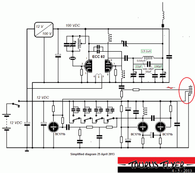

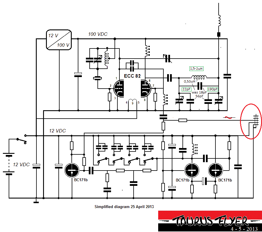

Oh, b.t.w. that was the carrier wave of ny 4 channel double triode transmitter I made a few years back, combined with a four channel superregen receiver.

Phil_G wrote: 21 Oct 2020, 11:13 Excellent thanks Cees, great to see the old-tech valves still in use ;)
Yes Phil, I am glad with the transmitter, I also have my 4 channel double simultaneous transmitter, 50 years old functional for several receivers and actuators. Building a vintage glider and boat now but, not in a hurry.
Both transmitters and receivers combo's do have more than enough range to fly.
The old double triode's ECC81, ECC82 and ECC83 can have 6,3 or 12,6 V (DC-AC) heater tension, easy to combine with a 12,5 VDC NMHi battery. That was why I did use this double triode to design the MOPA (Master Oscilllator and Power Amplifier, ahum ;) ;) ) for this transmitter. The ECC82 was best choise for this task. The converter efficiency is about 85 %. All enough for several hours of functioning.
All receivers of own design, one 4 channel and several single channel, superregens but with added an antenna signal amplifier and tone selective by Schumacher filters, relay/relayless as in the past.
Cees

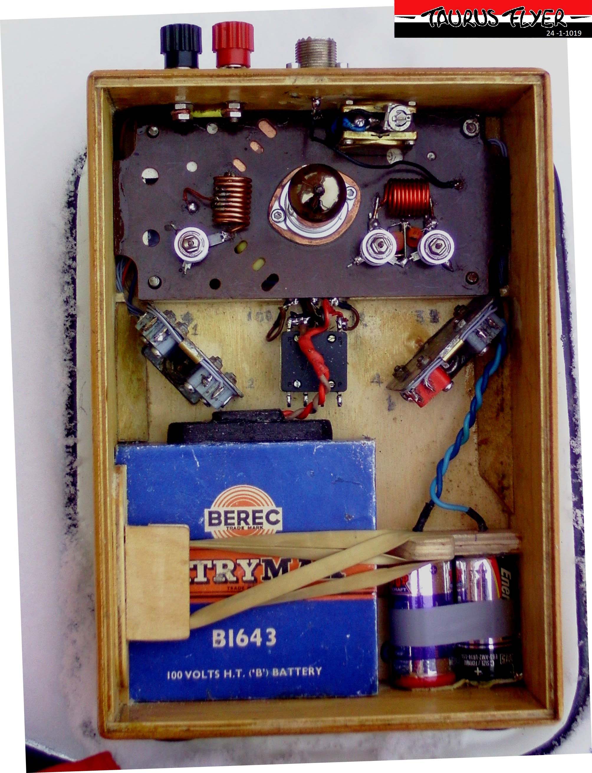

Taurus Flyer
Posts: 28
Joined: 06 Dec 2019, 11:56
Re: Come on post your project please.... fieldstrength meter
Post by Taurus Flyer »

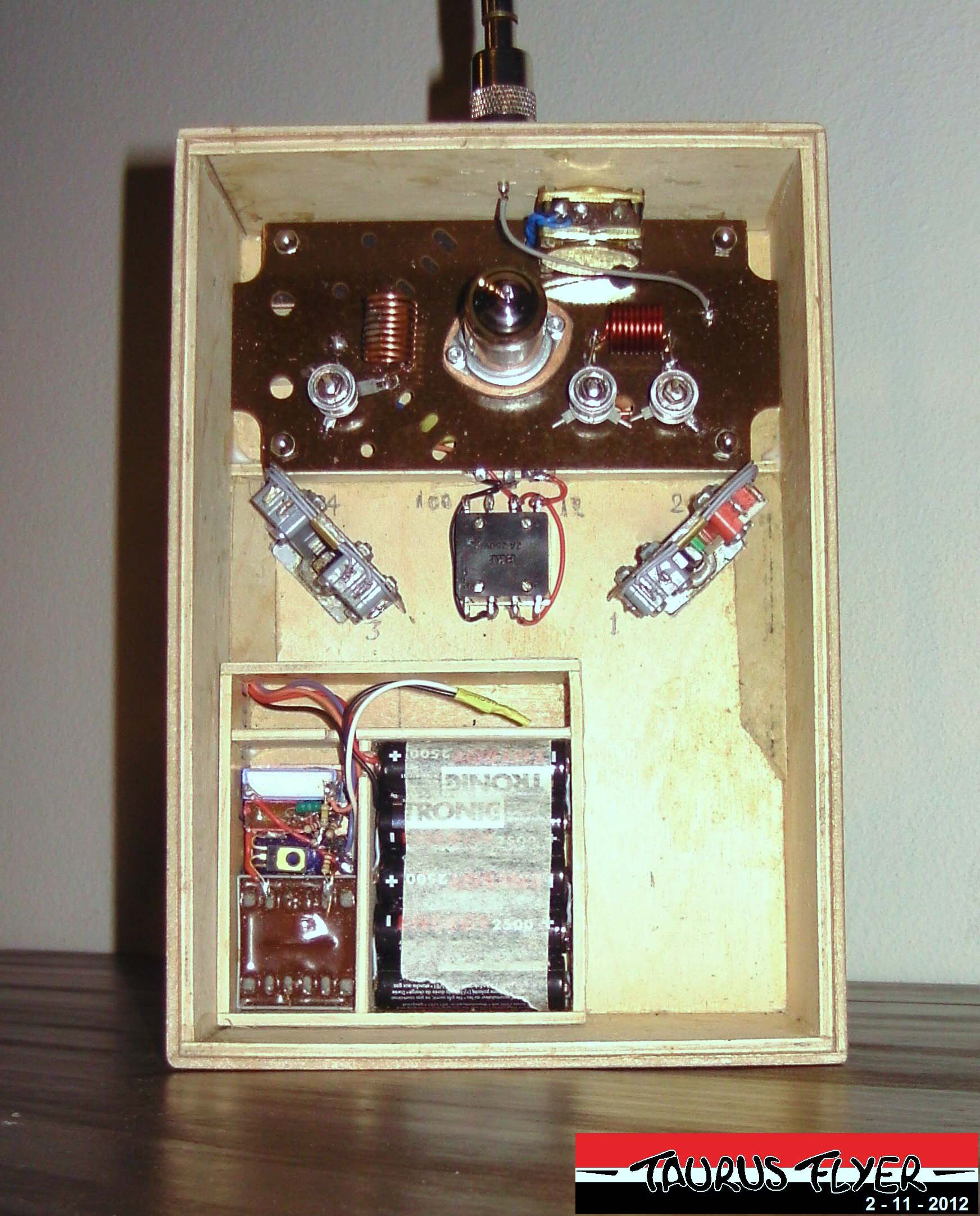

Martin, I have an original battery, 100 VDC. Copied the outside and let it print in a copy-shop.
When I turn the battery you see the converter and 12 AA penlights stillm in development stage.
The 4 - tone oscillator is at the backside of the circuit board, only the pot core(?) coil is right on top visible.
Picture two the front side the way it is now.
