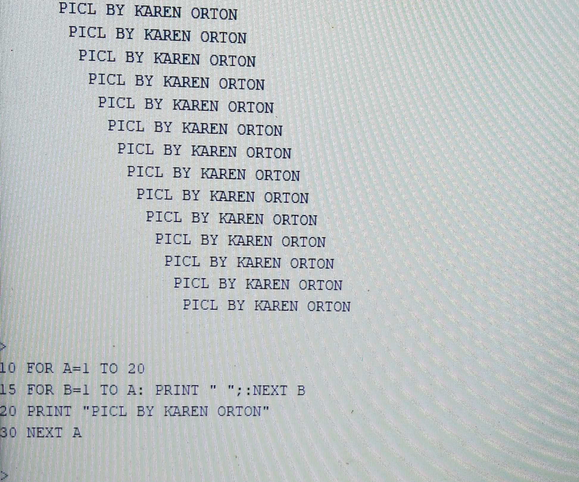

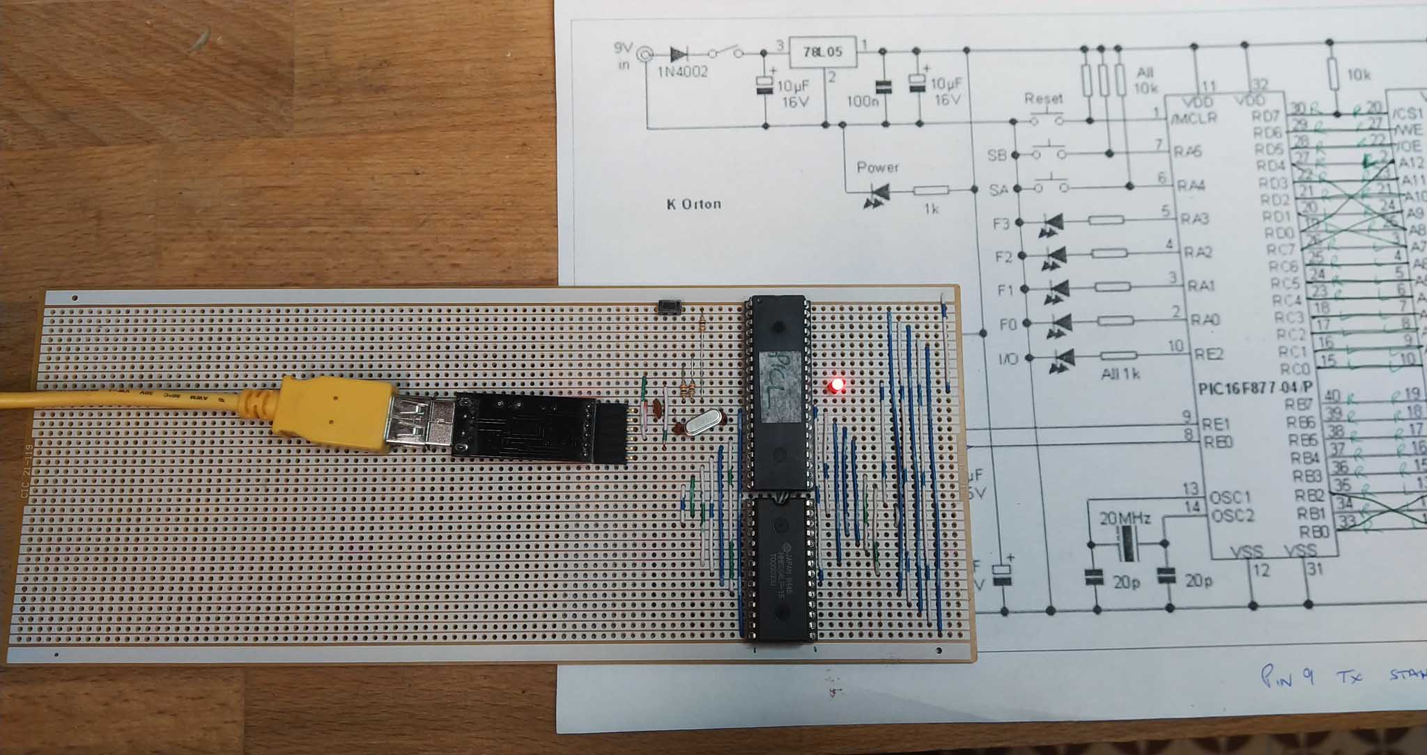

Spent today in the shed making this ultra simple SC/MP computer which runs NIBL basic.
Its another of Karen Orton's designs and couldnt be simpler - two chips!
NIBL is a fairly standard Tiny-basic with a few nice extras like do/while, indirection, multiple separate memory pages and as the SC/MP has a few on-chip I/O pins, you can do real world stuff with it.
Genuine chips being hens teeth, the project makes use of Karens cycle-perfect SC/MP emulation on a PIC chip, with the genuine NIBL interpreter code in its flash. Since it's a PIC running NIBL she calls it a 'PICL' :D
Terminal connection is via our old faithful FTDI lead, like the one you'd use to program a Promini.

If anyone fancies making an authentic 1976 computer, I can supply a pre-programmed PIC chip at cost and I have a few spare RAM chips.

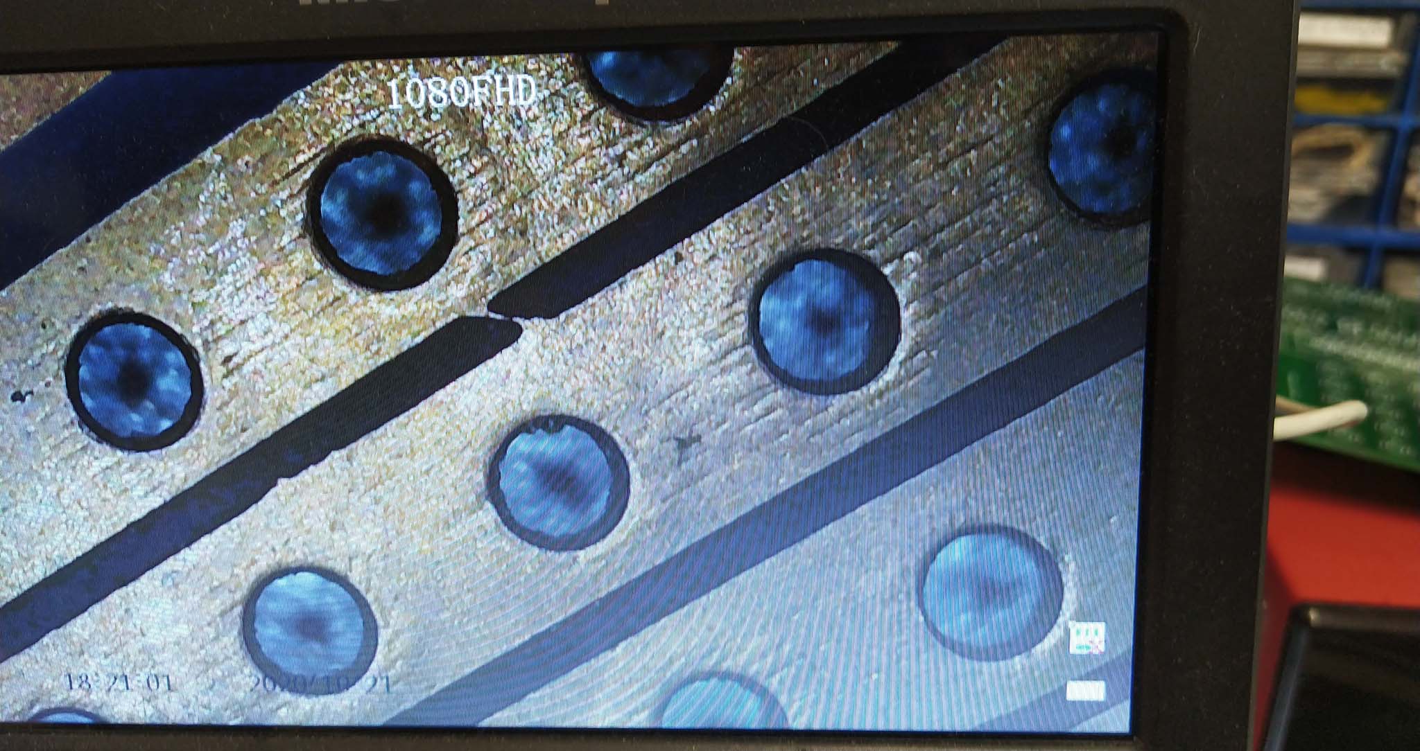

Beware cheap chinese veroboard though - this short had me baffled for a while:
