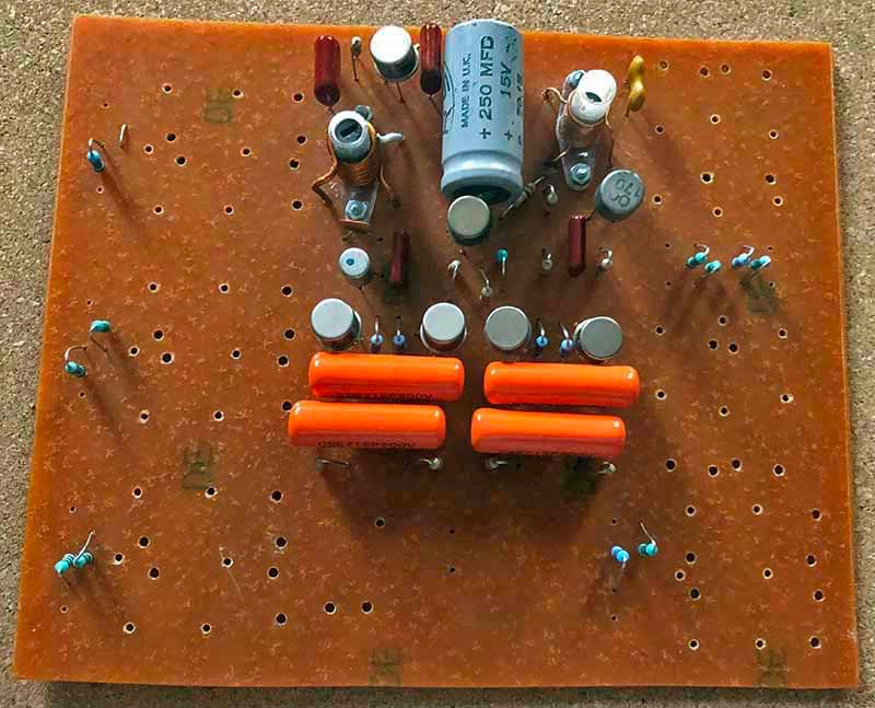

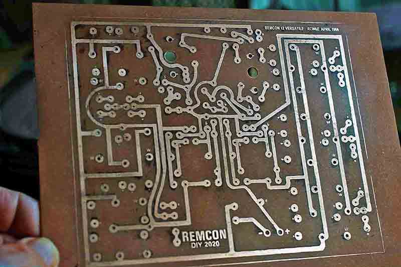

Not having the luxury, this time, of a kit, I started off by etching a hand drawn circuit board. Whilst OK, it didn’t look very smart and could have made better allowance for my choice of Bourns sliding pots (metric, now, not imperial!). Phil_G’s advice was to use a laser-toner transfer process. My first try was usable! Still requiring a lot of cleaning up and cutting to size, the board is shown below.
Since then, all the components have been added, with the exception of the seven switches (on stalks), the crystal and the six sliding pots (on the reverse). The sliders can’t go on, until the switches are in place; and I want to use the case as a jig for mounting the switches. So, not having bashed tin since 1965, making the case is my next job.

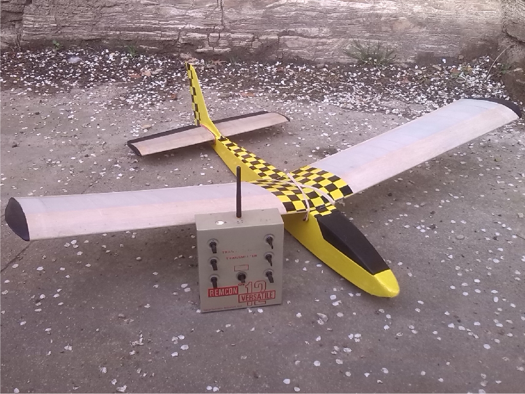

I love this project. I remember being very envious of a Versatile 12 for sale high up in a cardboard box in a junk shop. It had the receiver and three Duramites with it. I distinctly remember it’s khaki colour with red lettering . What looked like switches out of may Dads mini . A long chrome aerial with a well tatty red pennant. Oh I so wanted it.
Re: Remcon 12 Versatile - A Tribute Act
Back in the day my Dad did the same thing John - he borrowed an unbuilt Remcon kit from a clubmate and copied the PCB, it was a great set and served us for several years then was passed on I dont remember where. I'm guessing I'd be maybe 12 ish, this is the only photo I have of the Remcon:

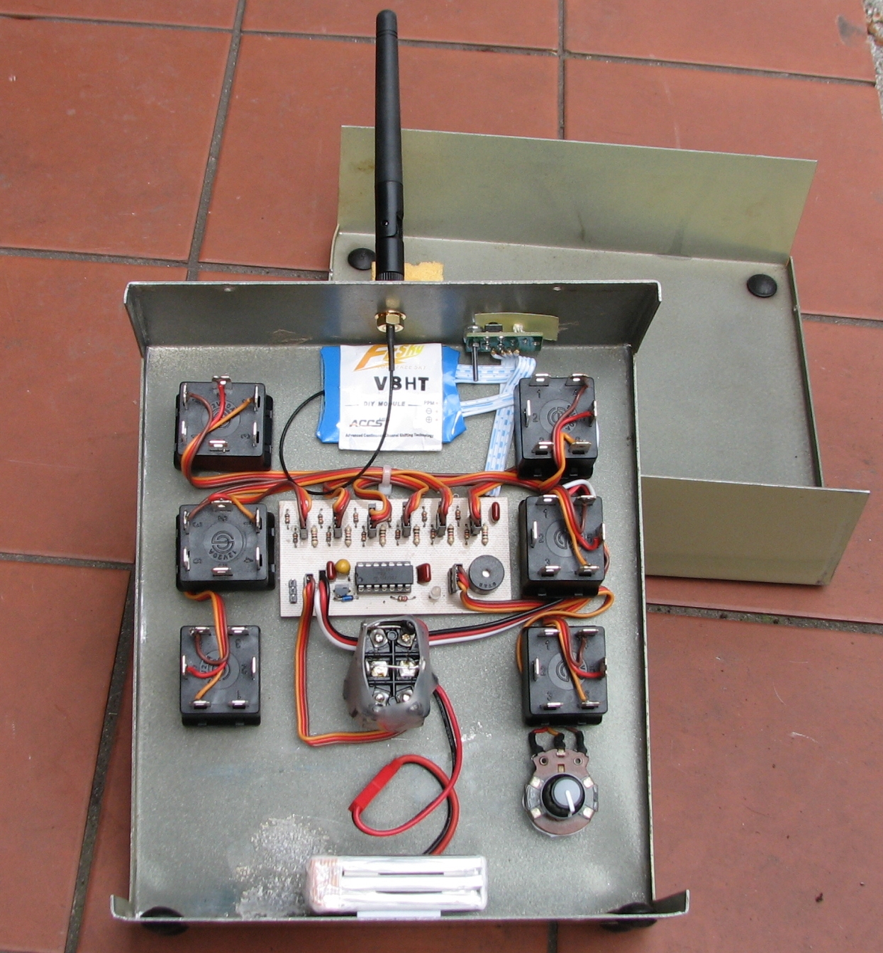

My current one is a frequent flyer, still has the old PIC 12ch encoder:

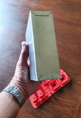

An Update

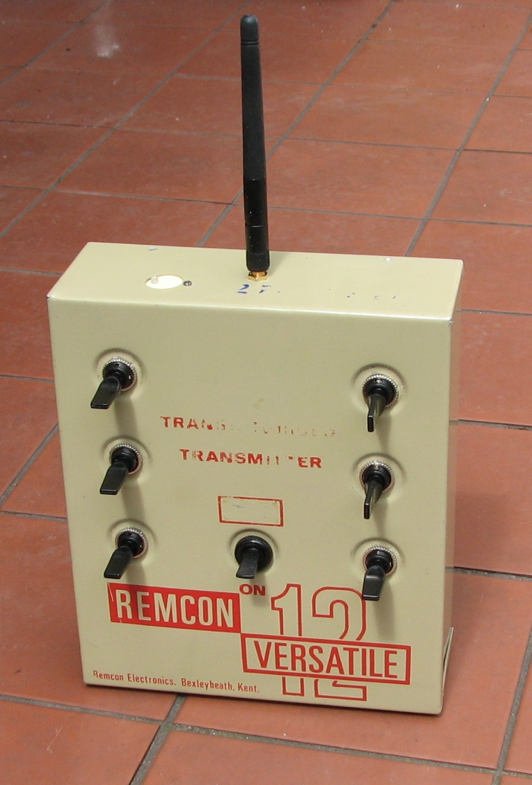

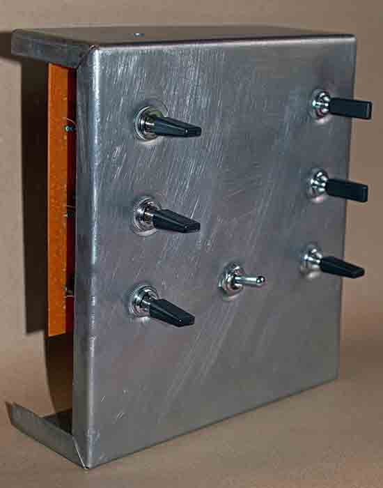

Case front, with dimples, made and switches soldered to the circuit board.
I ended up making the case from 0.8mm mild steel. It's fine. I tried 1mm, but just don't have the strength, these days, to work it on the kitchen table. The dimples were made by reversing a hole punch. Not perfect, but a fair facsimile. The case rear should be easier.
Due to the virus, it might be a few weeks before I can get down to Halfords, to select the right colour paint.
Using the case as a jig, when soldering the switches to the board, seemed like a good idea. However, this resulted in a huge heatsink (the switch!) being attached to the "stalks", when soldering them in. I had to turn the wick right up! But done, now.
Using yet another paddle switch for the on/off switch might create confusion, in the heat of the moment, and so I elected to use a traditional toggle switch. It looks odd and might be changed.
Thoughts turn, now, to the correct crystals and the making of a centre-loaded aerial.

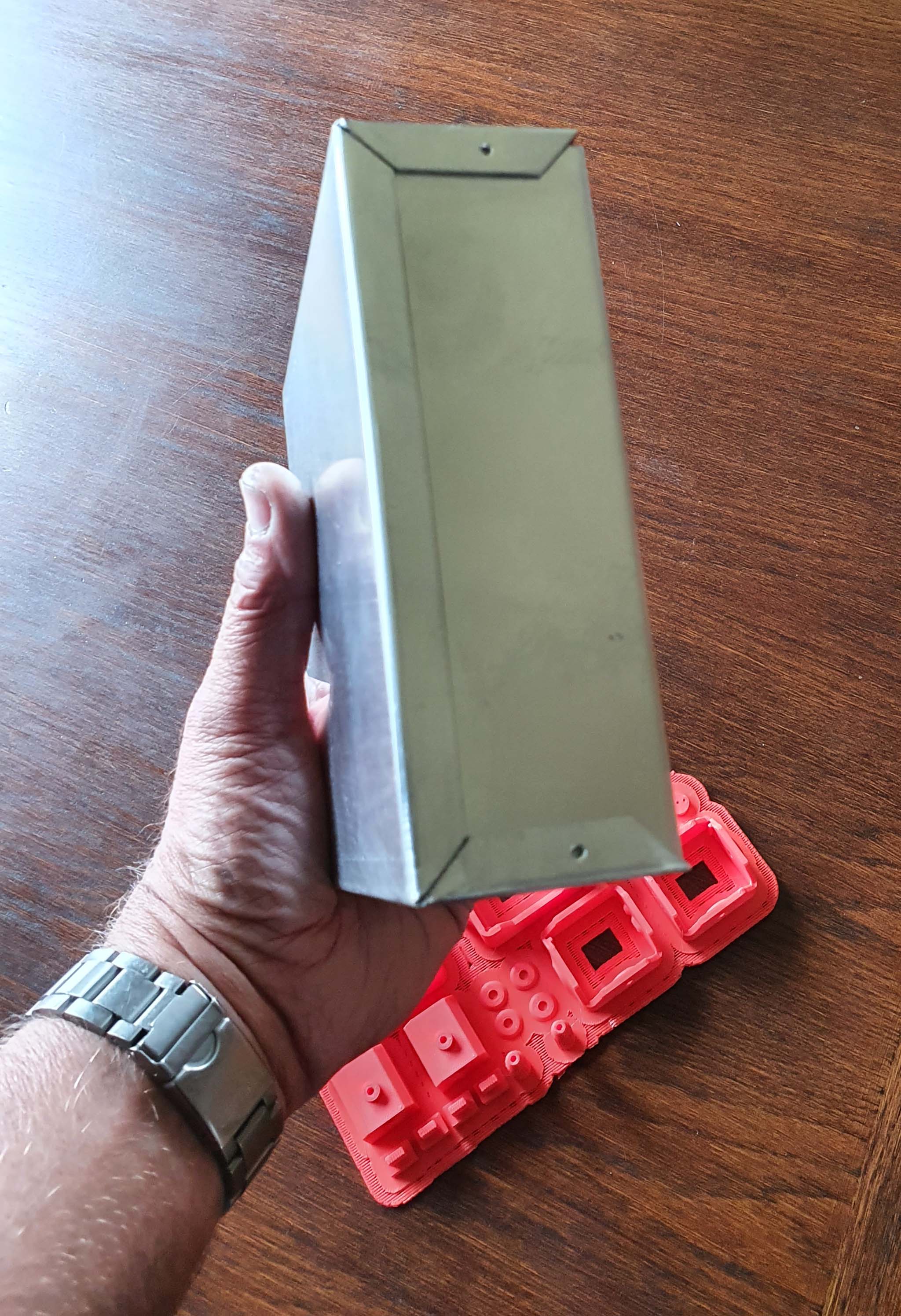

That's a nice sheet metal job, hat off.
I also do my cases but I stay with aluminum.

Thanks for your kind words, Tobe.
If doing it all, again, I would use aluminium, too! My wrists took three days to recover, after punching those dimples!
Meanwhile, I envy your own abilities with 3D printing.

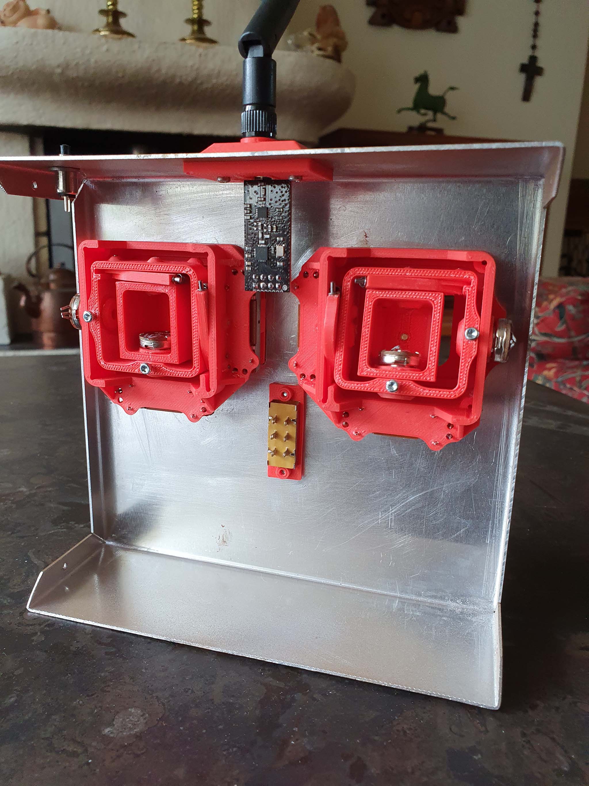

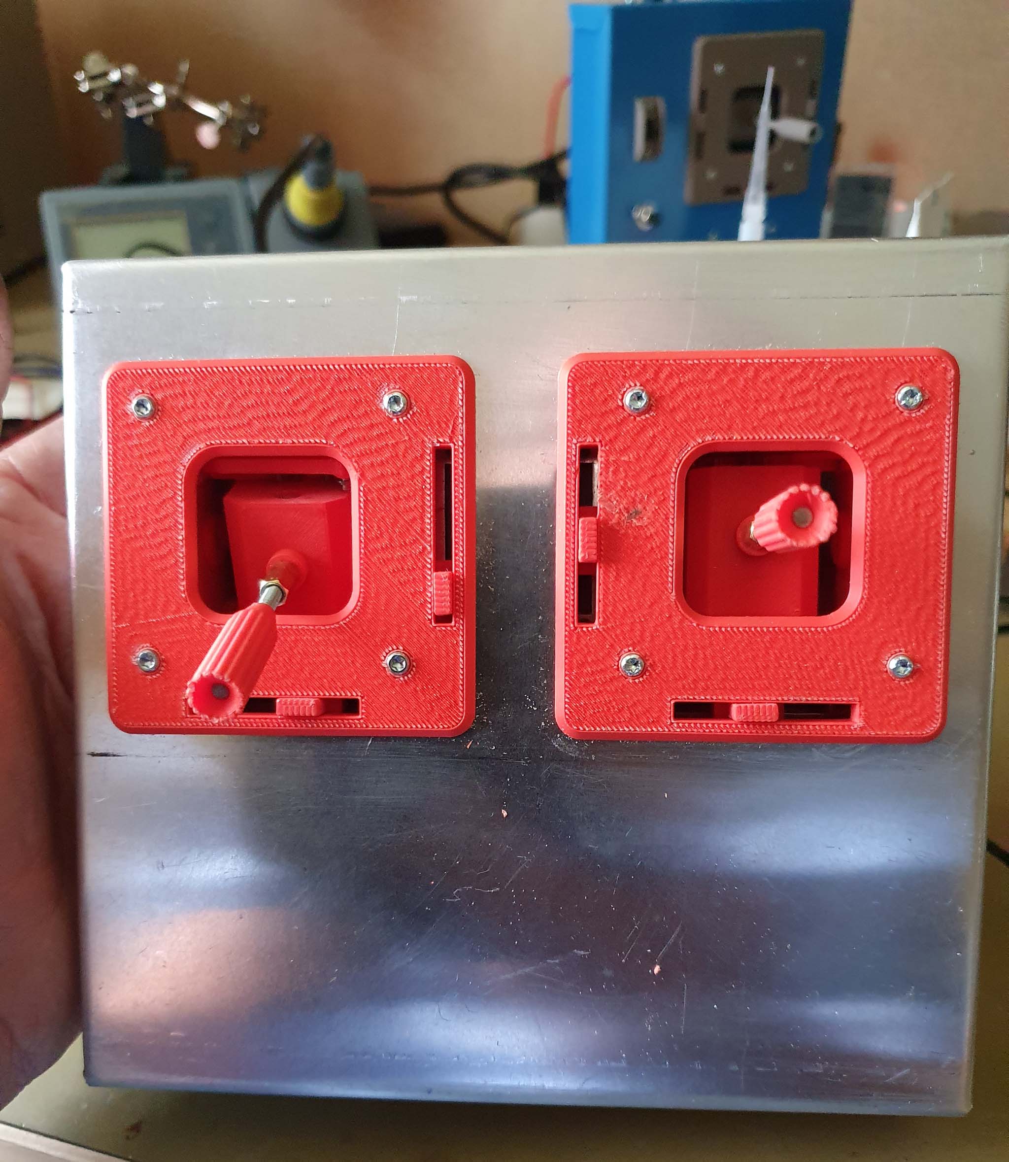

John,

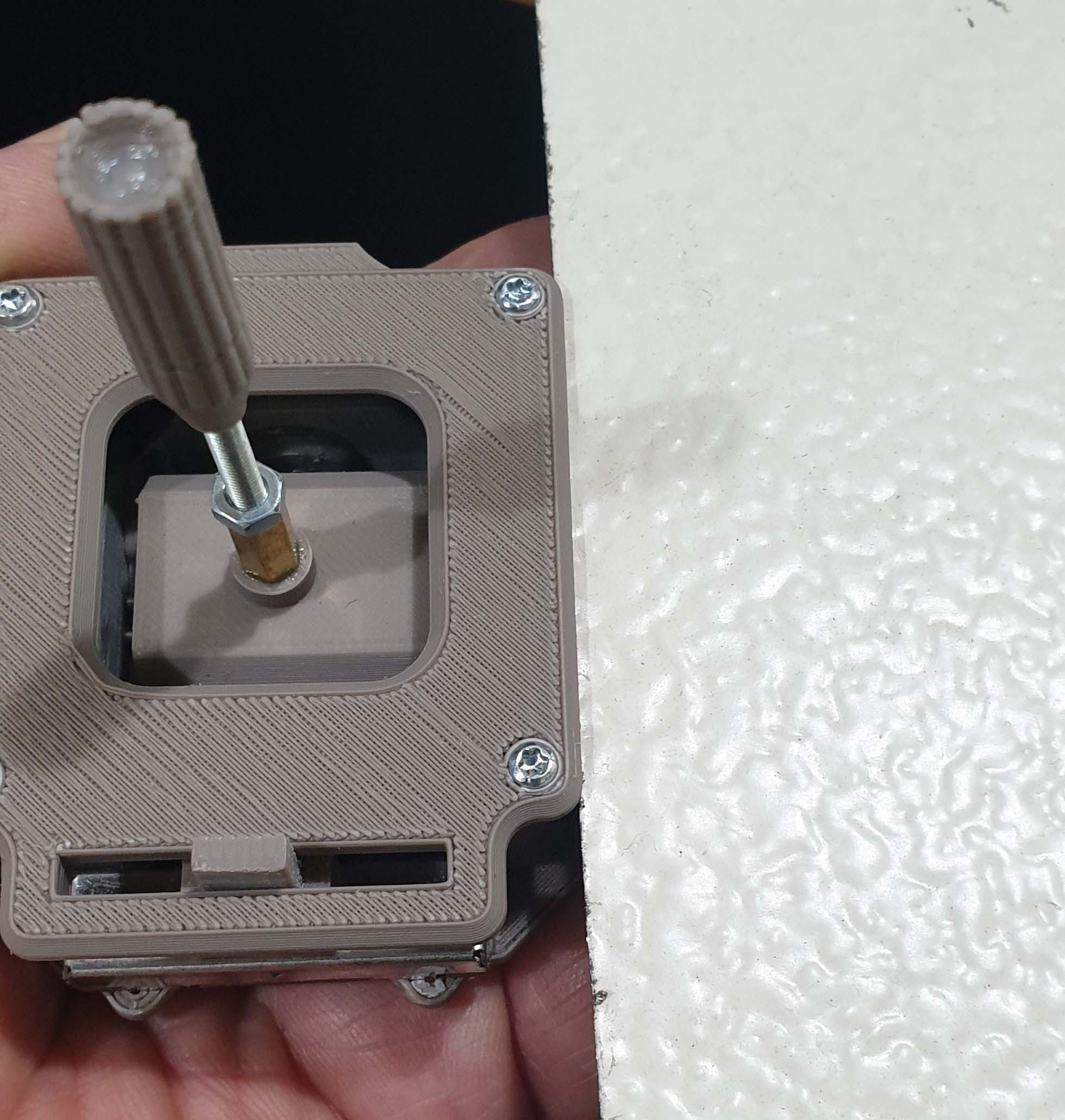

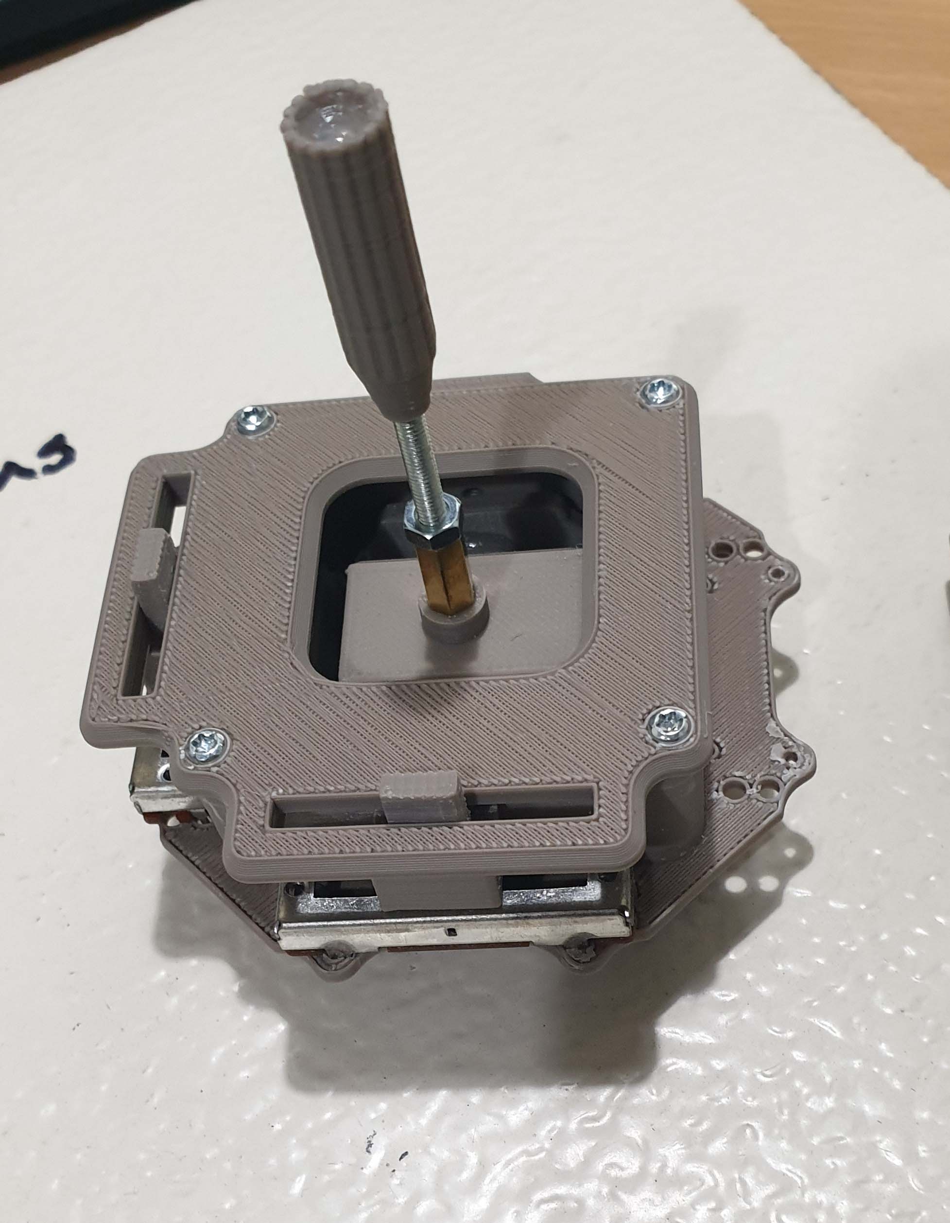

I too normally use aluminium, but as I have a huge supply of 0.8mm steel sheet with a textured & coloured finish, I'm thinking of using that with the stick assemblies I recently acquired from Tobe (and which by the way, are awesome!!). However, my arthritis may not appreciate working it
We shall see....
Good luck with the Remcon 12 Versatile.
I agree with Tobe - nice job
