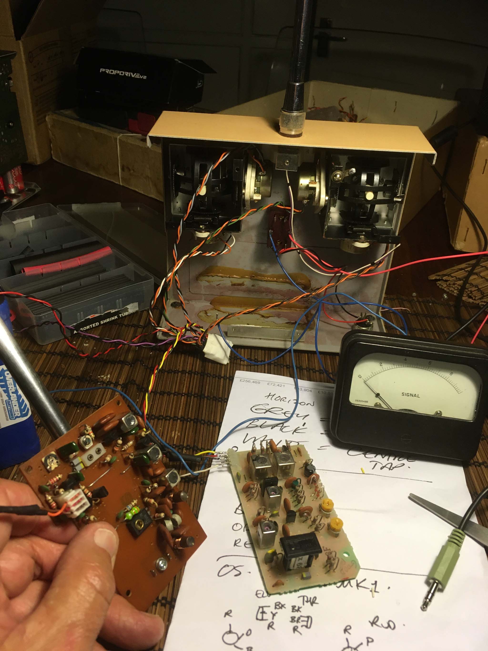

Here we go! First in the list of ‘conversions’ this lovely OS Cougar is to have a Digispark 4 channel encoder and a JR 35mhz RF.
The Digispark has very recently been received from Phil Green.
It’s a step up from my Ladybird book of Magnets Bulbs and Batteries. So I’m going to need a little help here as I’m not sure it’s working correctly?
So far the RF stage us belting out a signal. The throttle buzzes if the stick is in the wrong position on switch on but I must have it wired back to front as it squeals when it’s down not up. Easy fix me thinks.
Followed the press to break micro switch routine to calibrate the sticks. Got a green LED light on the Digispark But so far no movement on my servos.
Early days but any thoughts much appreciated

Morning musings suggests I need to check for PPM - if not present or not getting to the RF it would produce the results I’m getting

I might be wrong, but I seem to remember that JR 35MHz modules are quite fussy about the PPM signal they require, they require the polarity that is predominantly positive and just the short separation pulses going to 0V (though I think Phil prefers to call this negative polarity) and this short separation pulse is 400uS, not 300uS like is used by most of Phil's encoders. It's worth PM Phil to check as he knows more about this than me.
If you haven't got a PPM tester, it's well worth building one and there are a couple on the forum by Phil and Ceptimus. They save having to get the logic analyzer or scope out and are worth their weight in gold for these types of conversions.
Cheers Mike

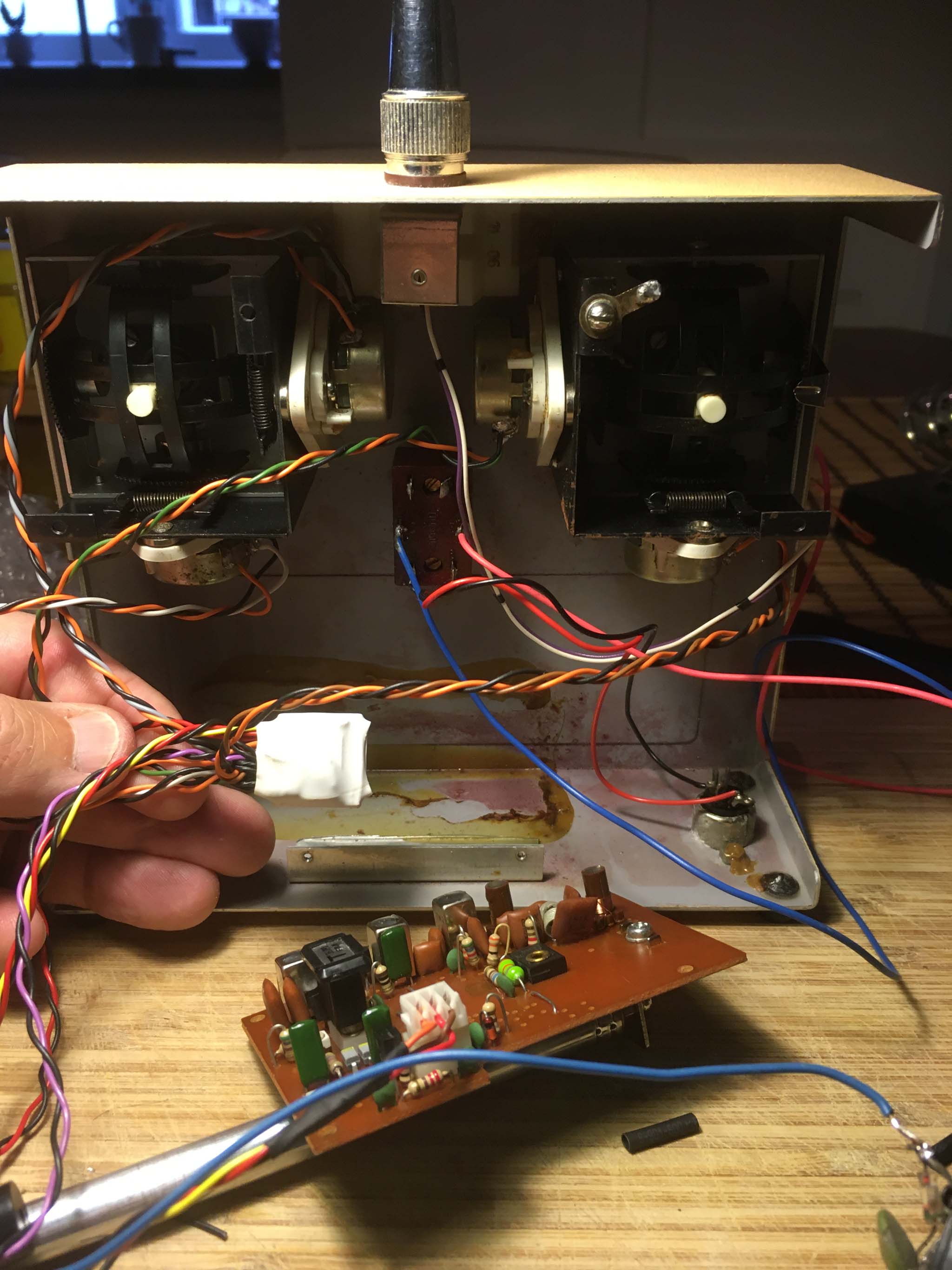

Hello Mike well my brain was working this eve. Used a small audio amp to probe the PPM and it proved it was present . Then tried a Futaba RF board with same crystal. Same result - belter of a signal but nothing at the rx . Then became suspect of tx crystal. Changed it and works perfectly! So that tx crystal is way off frequency . Going to put the JR RF stage back now .
