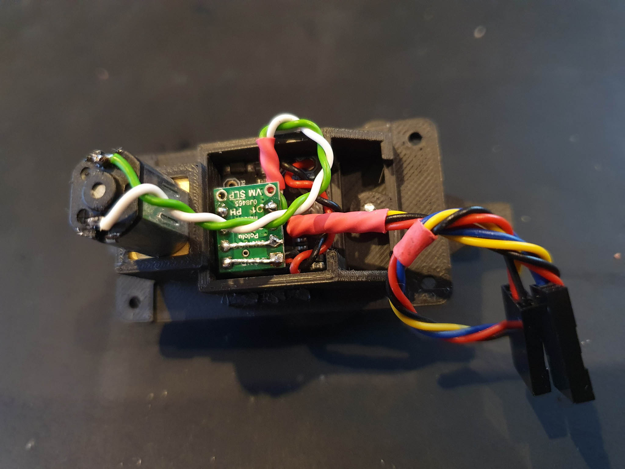

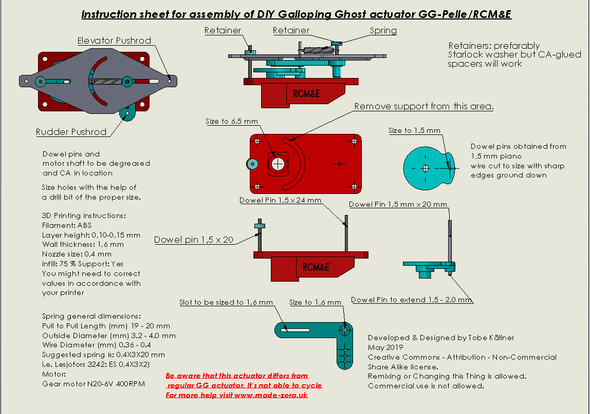

The attached file includes all necessary parts to print your own DIY. Printing details on the instruction sheet
Hardware:
Spring general dimensions:
Pull to Pull Length (mm) 19 - 20 mm
Outside Diameter (mm) 3.2 - 4.0 mm
Wire Diameter (mm) 0.36 - 0.4
0,4X3X20 mm ( Lesjofors 3242: ES 0,4X3X20 is the one I use)
Motor:
Gear motor N20-6V 400RPM
Steel dowel pins:
1,5 mm x 20 mm 2 pcs
1,5 mm x 24 mm 1 pc
and a couple of "Starlock / Starwasher " for 1,5 mm but could be replaced with properly CA retainers as shown
!,5 mm can be replaced with 1/16"

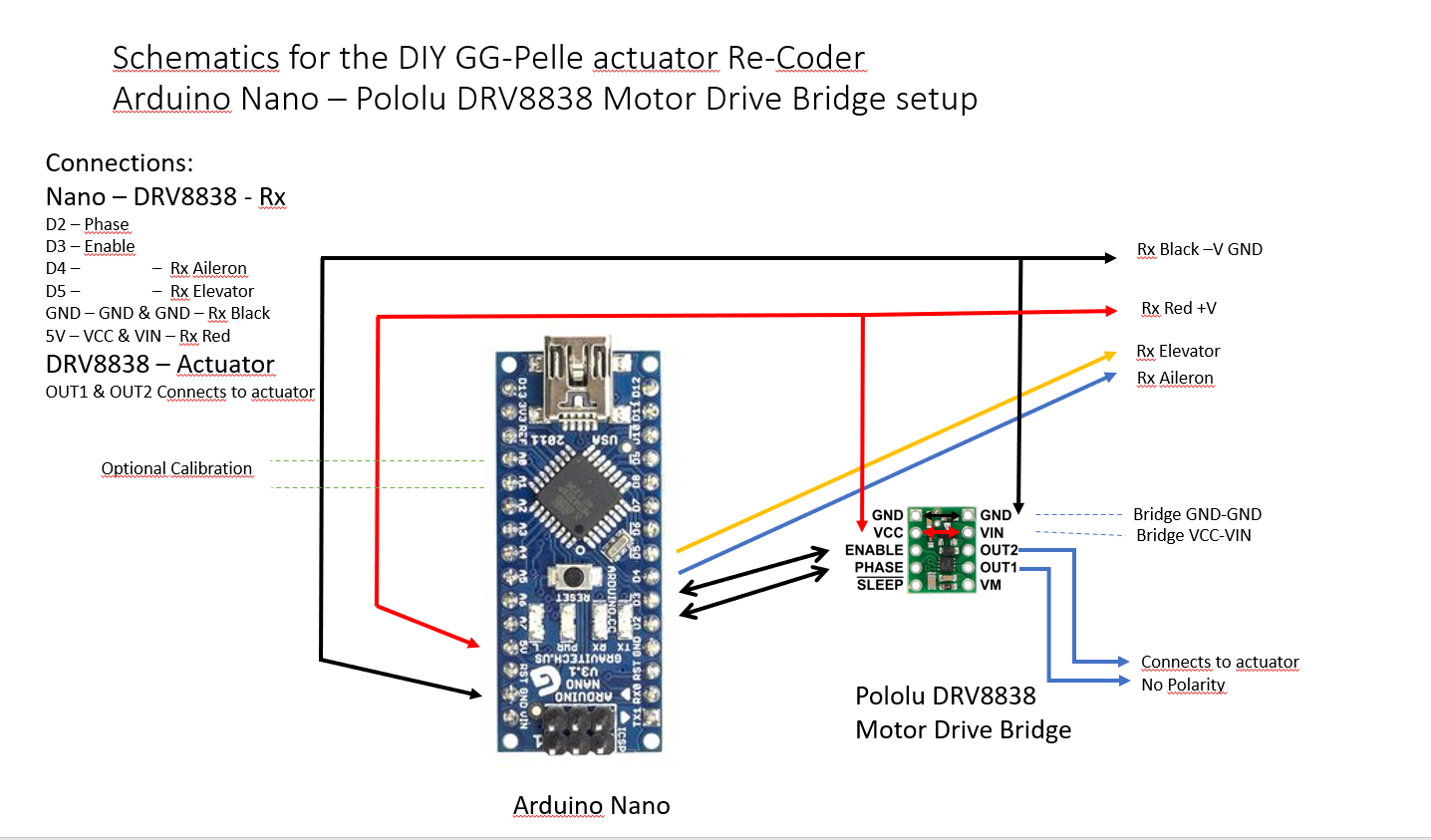

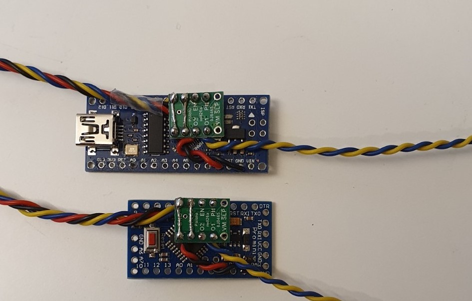

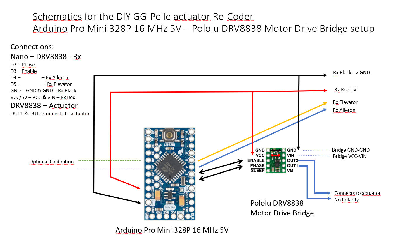

DIY actuator RCM&E GG-Pelle Arduino based Re-Coder
Here are two versions of the Arduino sketch for the DIY Re-Coder. Either an Arduino Pro Mini 328P 16 MHz 5V or an Arduino Nano in junction with a Pololu DRV8838 Motor Drive Bridge setup
At the beginning of each sketch there is a note with some additional notes and credits please read carefully.

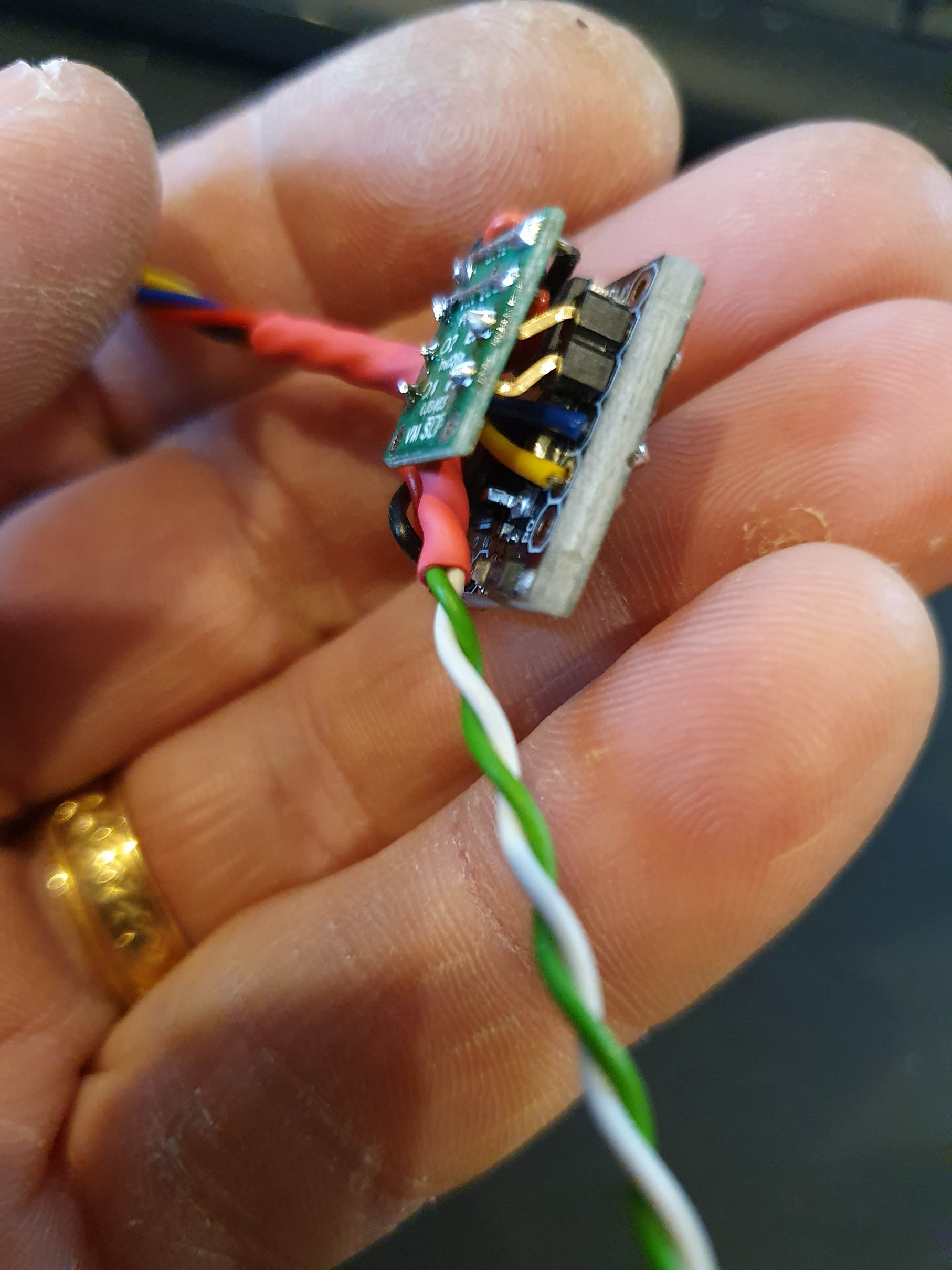

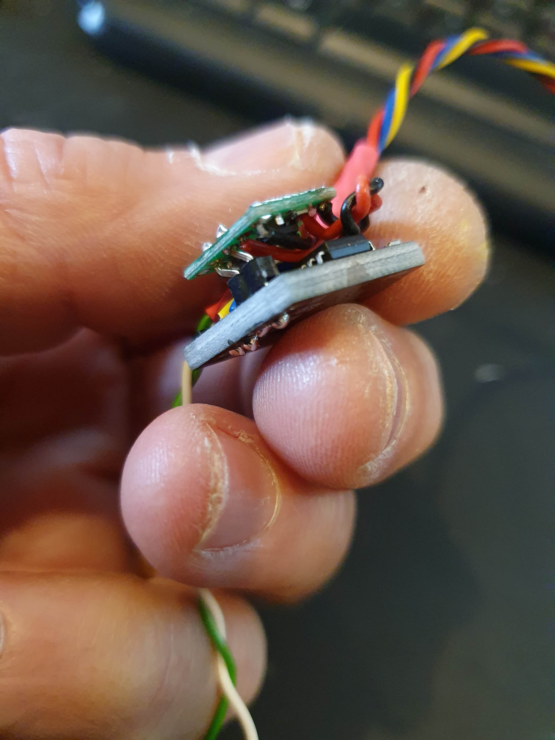

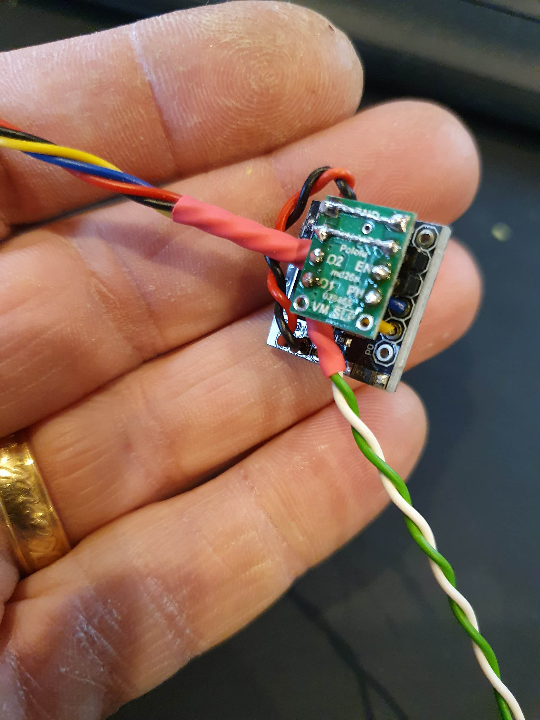

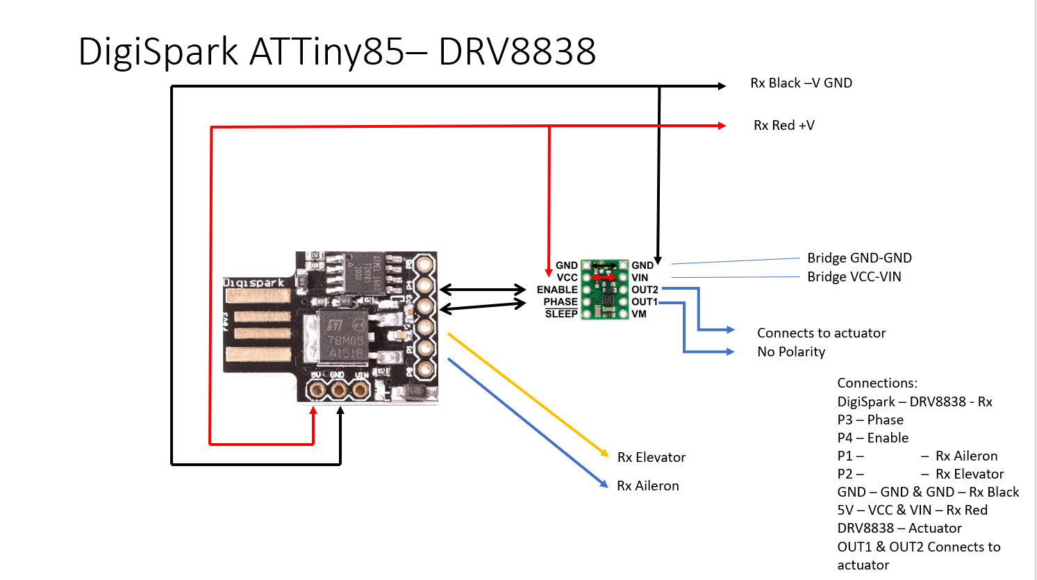

Re: DIY actuator RCM&E GG-Pelle DigiSpark based Re-Coder
For the one that want an extra challenge here comes a Recoder based on the DigiSpark ATTiny85. This Recoder fits inside the DIY. I would recommend to load the sketch by ICSP and not the USB port to get a swifter start up in accordance with Phil previous instructions viewtopic.php?f=41&t=60
- Attachments
- Recoder_v3_DigiSpark.ino
- (10.31 KiB) Downloaded 465 times
- DigiSpark.pdf
- (143.53 KiB) Downloaded 491 times

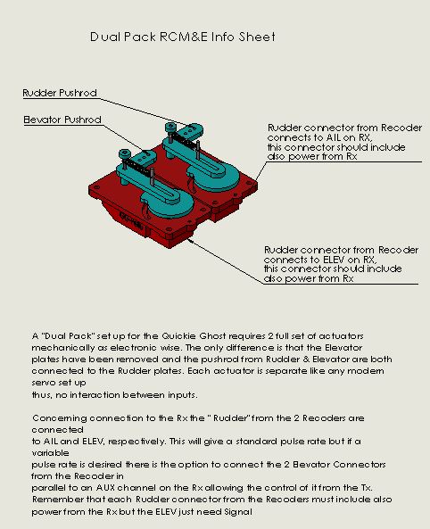

Re: DIY actuator RCM&E GG-Pelle Dual Pack option
Here comes some guidelines for whom of you would like to go for the Dual Pack option.
To remember is that you will need 2 sets of actuators and Recoders.
Each actuator is completely separate from the other, basically each actuator is an independent "Servo" w/o interaction between them i.e. no elevator on rudder input and the direction of controls can be reversed from the transmitter which was a No-No for elevator on the regular actuator/set up.
- Attachments
- RCM&E Dual Pack set.PDF
- (44.11 KiB) Downloaded 440 times

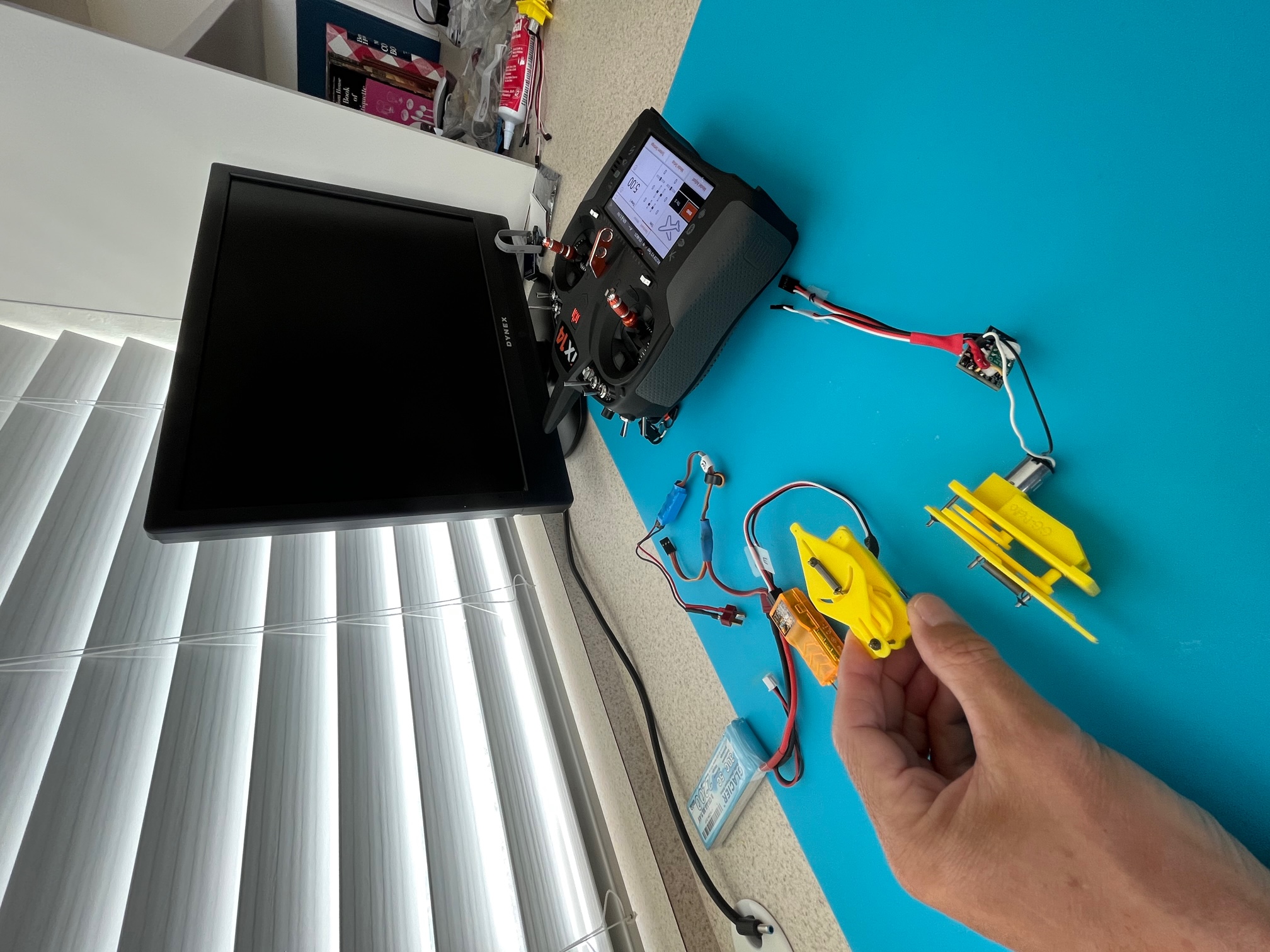

I just wanted to thank Tobe and Phil G for all their hard work on these GG projects and Phil's quick responses when I had an issue. I finally have a working GG. See attached photo. Thanks again guys!
- Posts: 714
Good to hear of your progress and hope it will bring you as much pleasure I had designing it.
So it’s time to hit the stack of balsa wood and shape large pieces into small pieces that creates a model.
