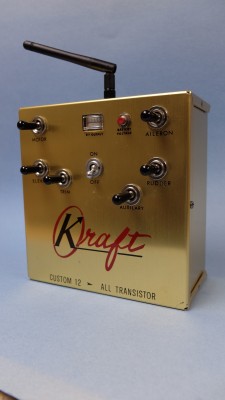

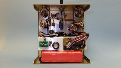

This set uses the PIC Reeds emulation encoder.
All wiring is now complete and tested. The Encoder board and FRSKY DHT 2.4 module are secured with two layers of double sided tape intended for securing automotive trim. Two layers are used just incase I press too hard on the plug in connectors which may cause any sharp solder points on the back of the board to pierce one layer which could cause a short letting all of the smoke out of the colorful components on the board rendering them useless. You can never get the smoke back into them. The round knob is connected to a 10 K pot to enable slowing the servos to emulate the speed of the old Bonners. The toggle is part of the FRSKY DHT 2.4 module kit which has telemetry capability. My Rx does not so the toggle is set for one way comms.
Here is the finished transmitter looking original with the exception of the dinky 2.4 antenna instead of the 4 foot center loaded one.

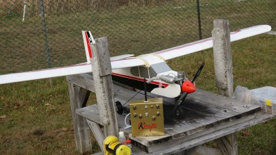

The weather finally cleared this weekend with temps at 6 degrees C and 15Km winds. It was time to make the 80Km trek to our Huronia Radio Control Club flying field to test fly my Kraft Reeds conversion.
The converted Kraft reeds radio is installed in a well used second hand Sig Kadet LT40 which is very easy to fly especially on proportional.

Here is an after the flight photo with the plane still in one piece. As I took the photo you cannot see the grin on my face!!!!!

By the way, for anyone puzzled by Mikes internal build shots, he has the old PIC encoder, not the Reeduino.
