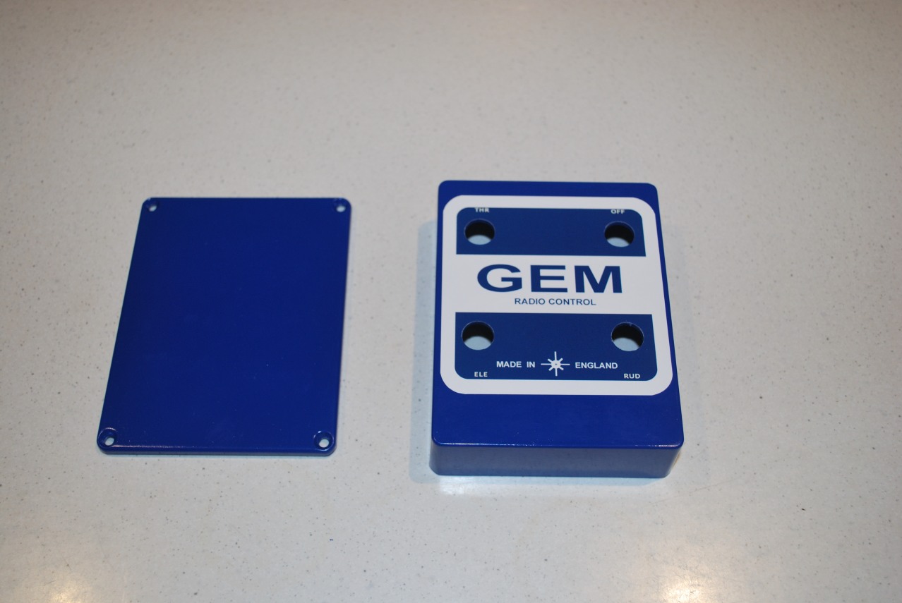

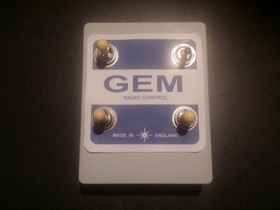

I received some cases for the next couple of projects today & one I thought was white is actually grey.

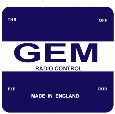

After a bit of a think I've been mucking about with the GEM decal Ron created a while back. GEM Reeduino perhaps?
I'm still waiting for my Guitar switches to arrive so I have a bit of time to play with the decal before I get serious.

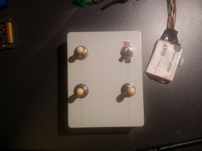

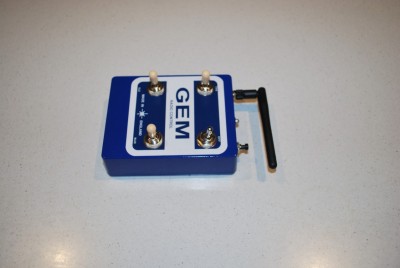

The switches arrived yesterday so I spent last night "fixing" them. These ones are really nice. Much better than the others I bought.
I messed about with layout this afternoon & drilled the holes for the switches once I got it feeling right.
Some tweaking to do with the decal but it's getting there.

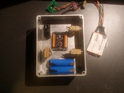

Inside. That'll work
Switch placement is similar to my other Reeds & feels pretty good. These switches are really nice.
Messing about with the decal placement & working out what needs to change. Still some work to do here.
Getting closer now.

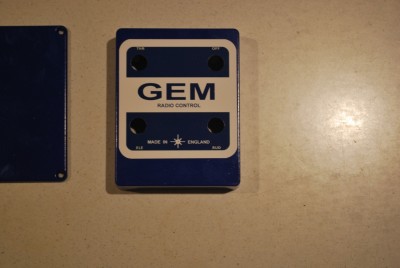

The plan was to have the auto parts store colour match some paint to the decal with their fancy colour matching machine. Unfortunately they don't have the machine anymore so I had to resort to TLAR.
I ended up using 1/3 dark blue & 2/3 french blue Modelmaster acrylic paint which was pretty close.
I painted this afternoon with an airbrush & baked for 10 mins in the little toaster oven at around 45c. Once I test the decal will cope, I'll clear it with auto acrylic clear coat.
Not my best paintjob but it'll do. I'm pretty happy with it at this point.

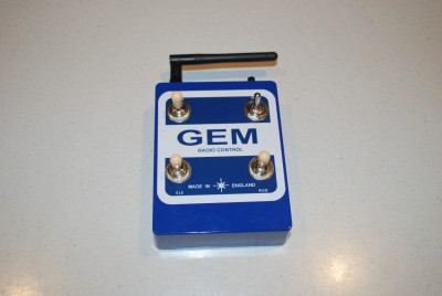

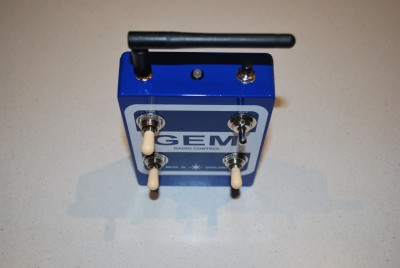

That's a wrap.
Al

Postby _AL_ » Sat Jun 17, 2017 1:46 am
I bought some white & clear inkjet sticker paper to try for decals on my scratch build gliders. I'm finding water slide decal paper fiddly & fragile.
This is just white sticker paper with the logo printed on photo settings.
It went a bit translucent when I cleared it but once the clear dried it went back to white & is as close to perfect as I could hope for.
Looks very promising for decals too.

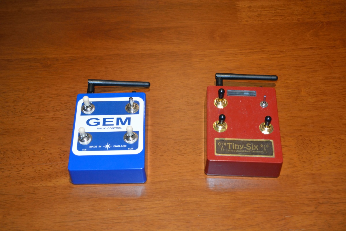

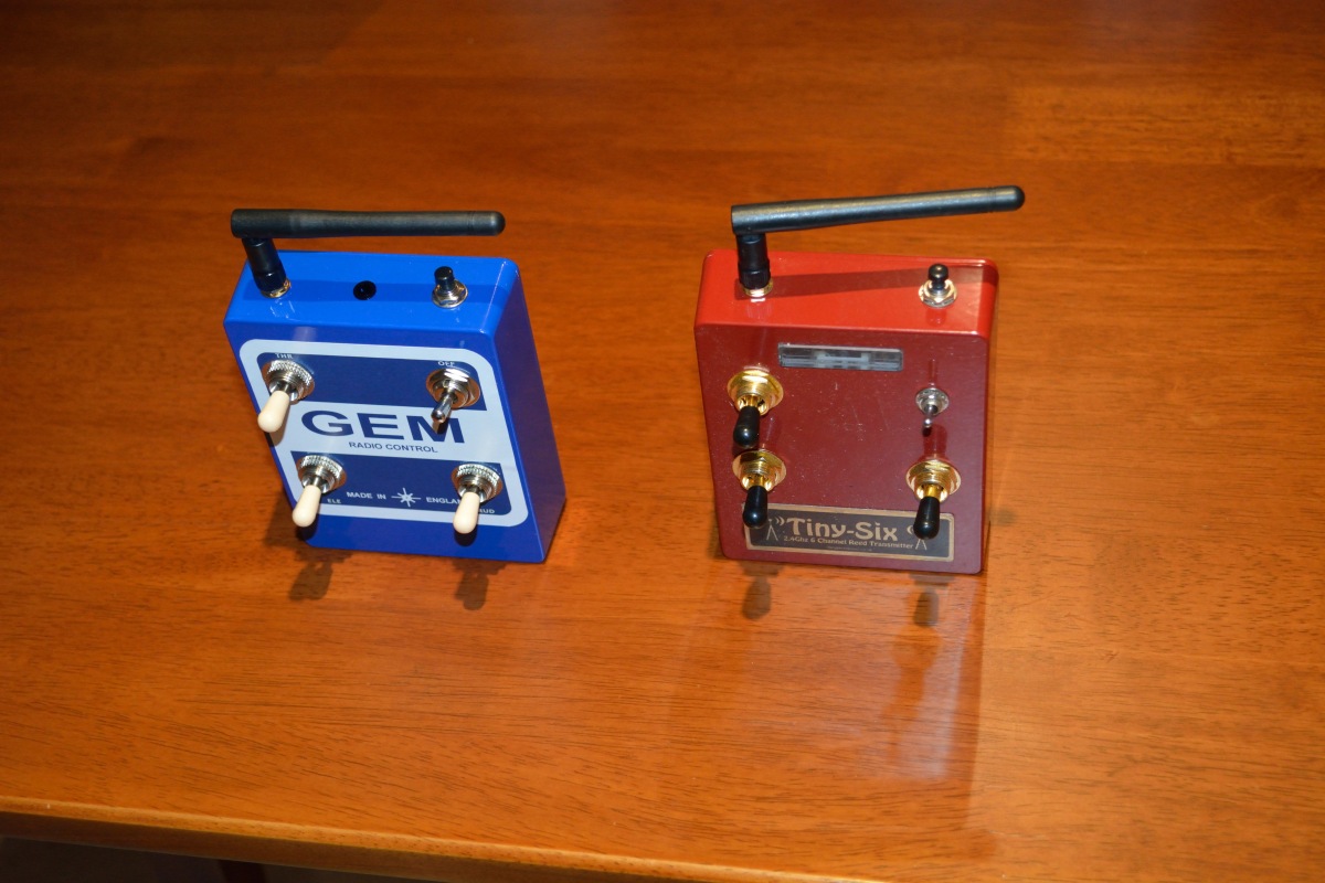

Reeduino Gem & Tiny 6.
