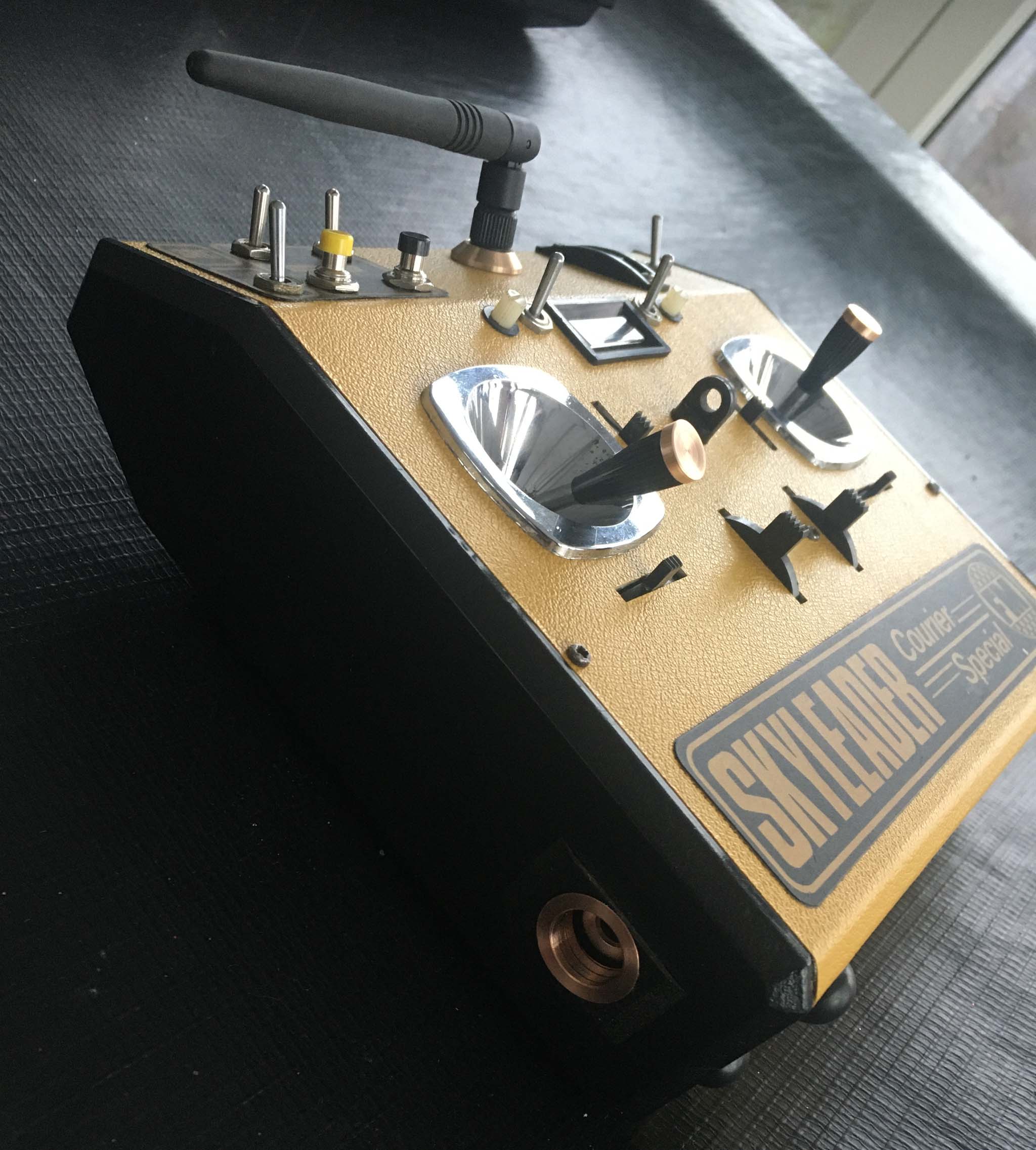

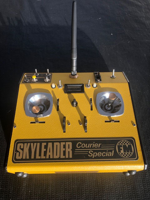

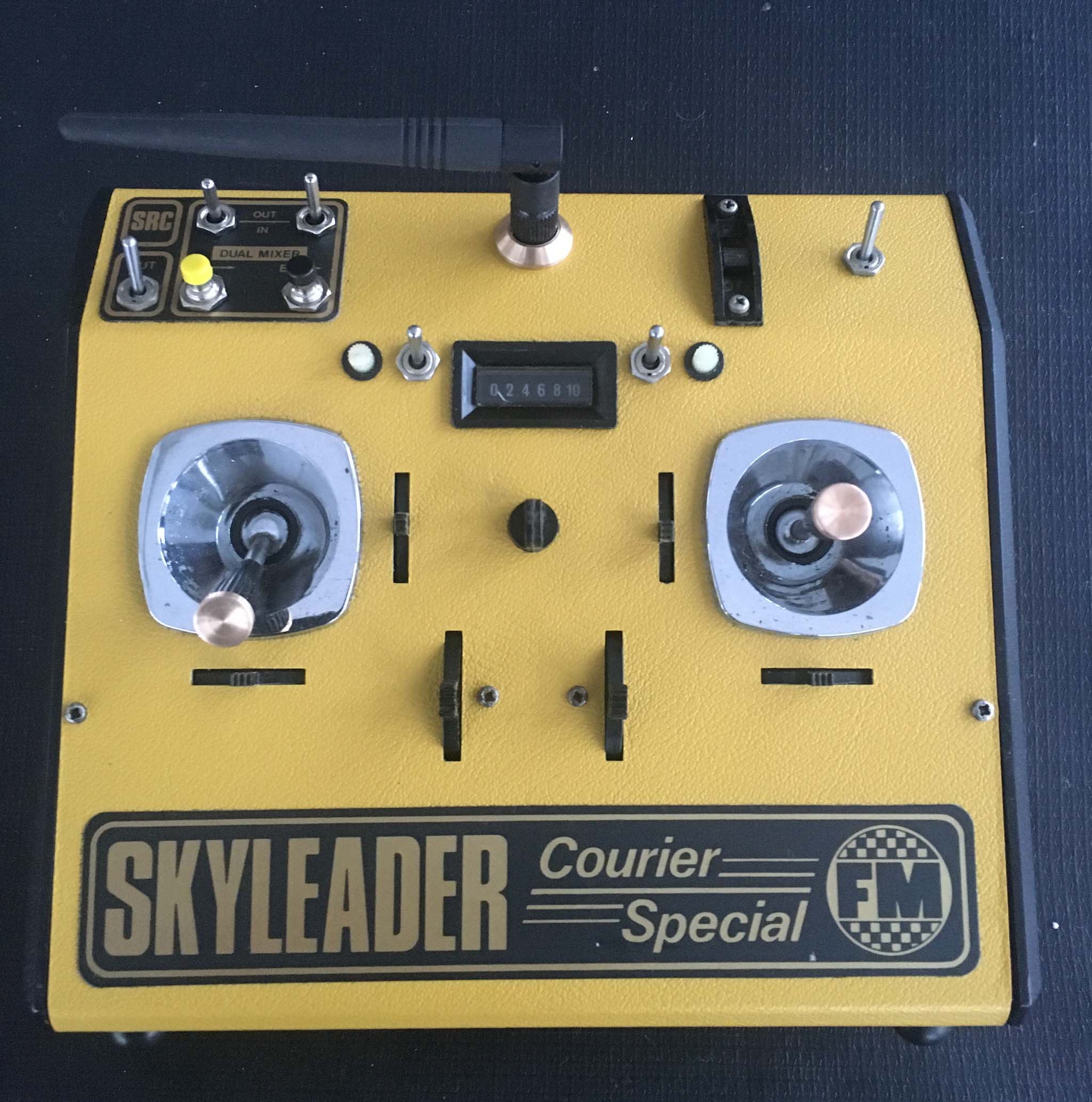

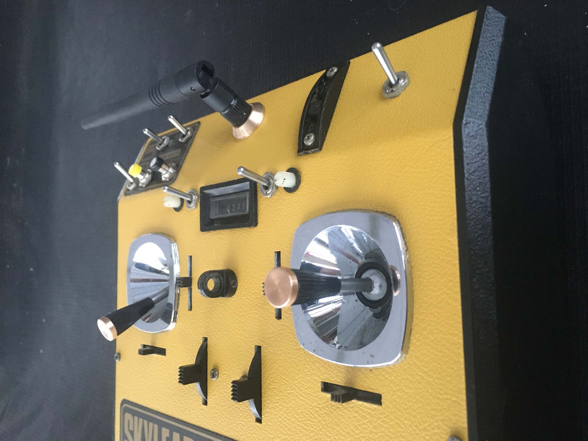

Just a few pictures of a newly finished Skyleader conversion
I’ve removed some trim potentiometer controls on the ‘in out’ switch panel and replaced with Bind button (black) and timer button (yellow) the rest is four on the sticks , two on the centre trims , and 7th on the top switch (right), throttle lock switch is on far left, the rest are just there to fill the holes .,

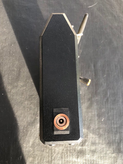

You may notice which looks like a Rose Gold Aerial mount , charger socket and stick tops , in fact are really phosphor bronze turned up in the lathe 😊..
Uses an OrangeRx transmit module , and a Phil G encoder ..

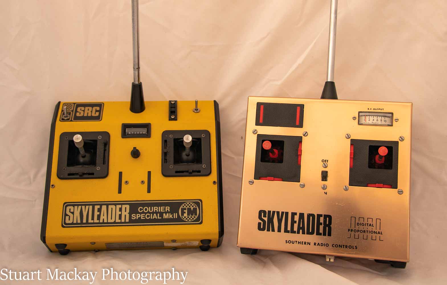

Mk 2 Courier posing together with Mike's Skyleader 4
Courier Special Mk2 and Skyleader 4

Very nice , those open gimbal sticks look good !

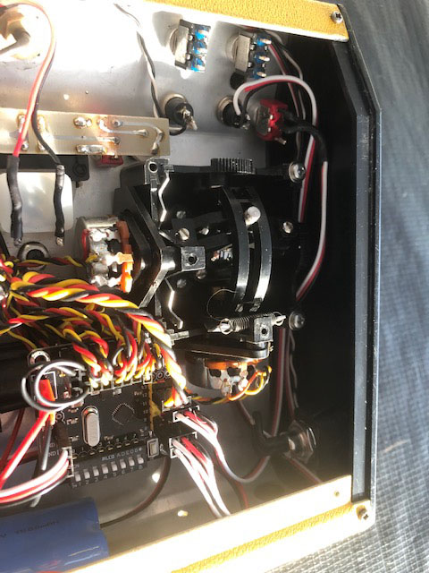

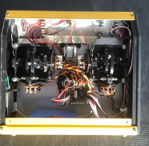

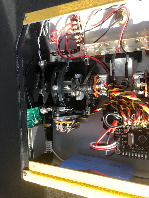

Any chance of a peek inside the box RobertC?

Of course my friend I'll get the set out, bear with me

Here you go Wookman if you require any more do not hesitate......
p.s. apologies if some pictures are rotated wrongly its my fault :D

Thank you. Nice neat conversion.
