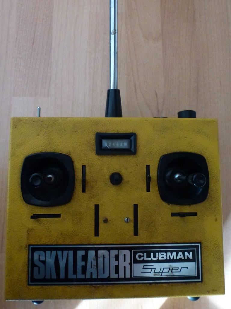

Original Condition
As seen from the photgraph it needed a good clean, once stripped, this was done with 'MUC OFF'. The results were better than I expected, the case came up looking like new.

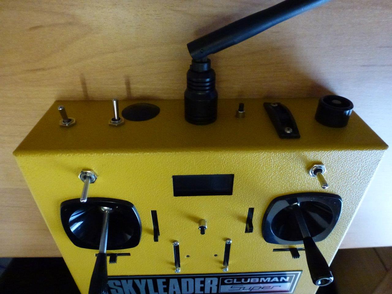

This ended up with the transmitter looking like this....
Controls
Controls are as follows:-
Top (left to right) Ch5 Sw Lo/Mid/Hi, Ch7 toggle, Bind Sw, On/Off Sw, Compound SC Sw
Front (left to right excluding joysticks) Throttle Cut Sw, Expo slider, Display Reset, Rates slider, Mix Sw

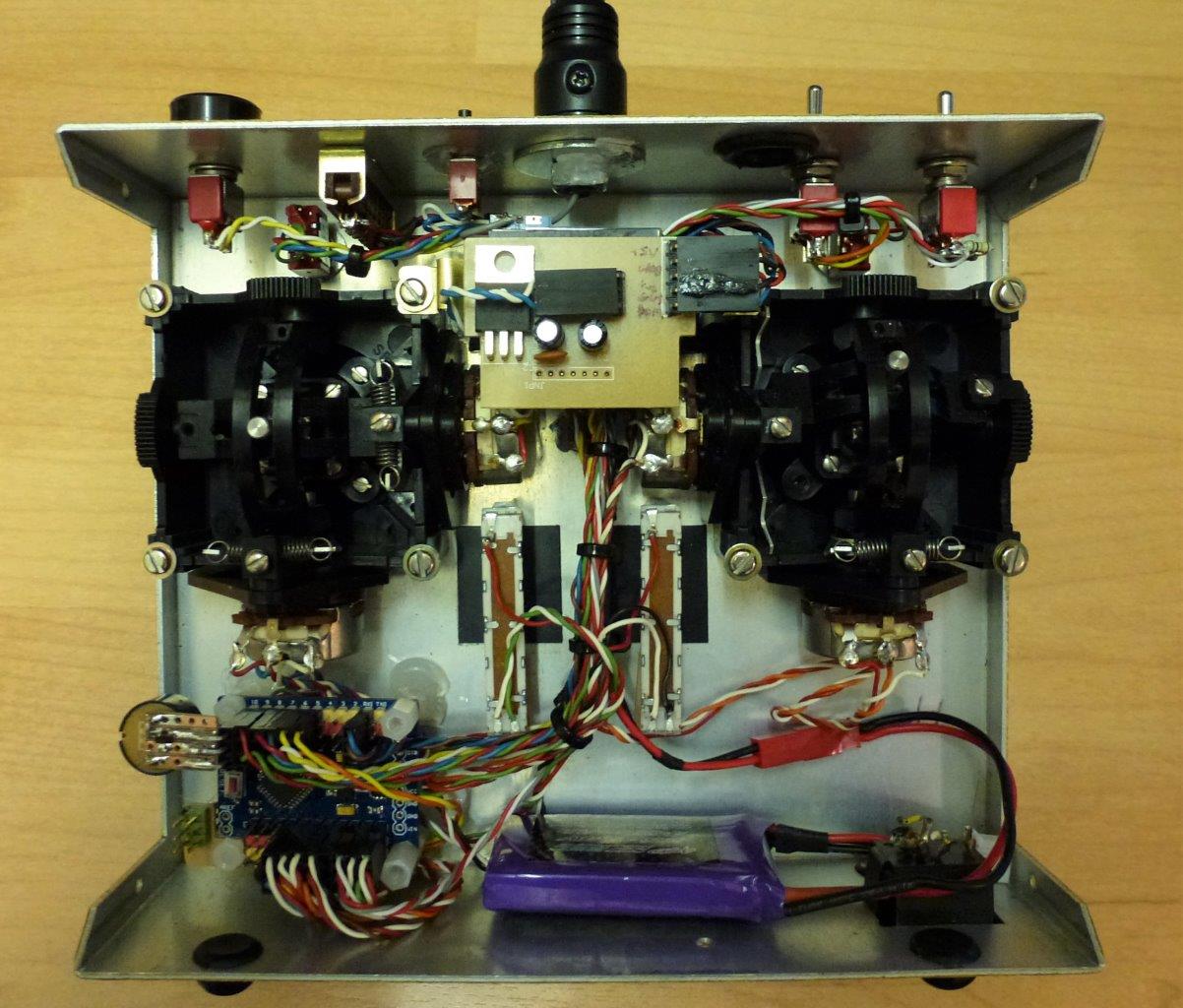

The FlySky RF module has quite a large footprint so I separated the PCBs and stacked them instead to make my installation easier. A bind switch header was fitted and also a header to bring in the battery voltage together with the signals from/to the nano board (I decided to use the FlySky on board 5 volt regulator to power the encoder circuitry).
Now for the moment of truth using the RF link to fully test the TX out.....all worked fine first time (that made a change).

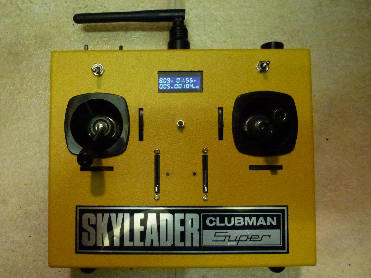

The USB meter works fine and gives a good indication of the information all on one screen.
Front View
Inside View

Hi PhilPhil_G wrote: 22 Feb 2018, 23:53 I'd missed the USB meter idea Ade, thats brilliant because its cumulative - so it adds all the 'on' times giving you an overall discharge mAh from the battery, and doesnt lose the total during 'off' times.
Reset it after every charge and its foolproof. I'd not noticed that idea the first time round!
The meter is good way of displaying a lot of information and it is nice and bright indoors but outside it is a different matter. I keep meaning to see if I can do anything about fitting a some brighter LEDS behind the display to see if that may help.
