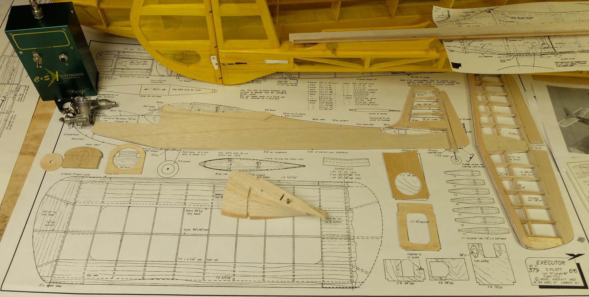

Just started cutting out some parts for a 1963 Dave Platt design "Executor" originally spanning 54" for a .15 cu in. engine.
Intended for Single Channel using three rubber driven escapements - plan from Outerzone
https://outerzone.co.uk/plan_details.asp?ID=9919
I liked the overall shape of the model as well as the symmetrical airfoil which I think should handle a breeze better than a flat bottom.
That and the fact that Dave Platt is known for some pretty good model designs.
I have scaled it down to 80% size to suit my Enya .09 that I will be using. (also running out of space for bigger models!)
Still early in the build stage at this point.
This will be flown with a converted to 2.4 single channel C&S Electronics Falcon 1 transmitter using one of Phil G's single channel encoders.
I will have rudder, 3 position throttle and kick up elevator on this one.
Will post more as the build progresses.

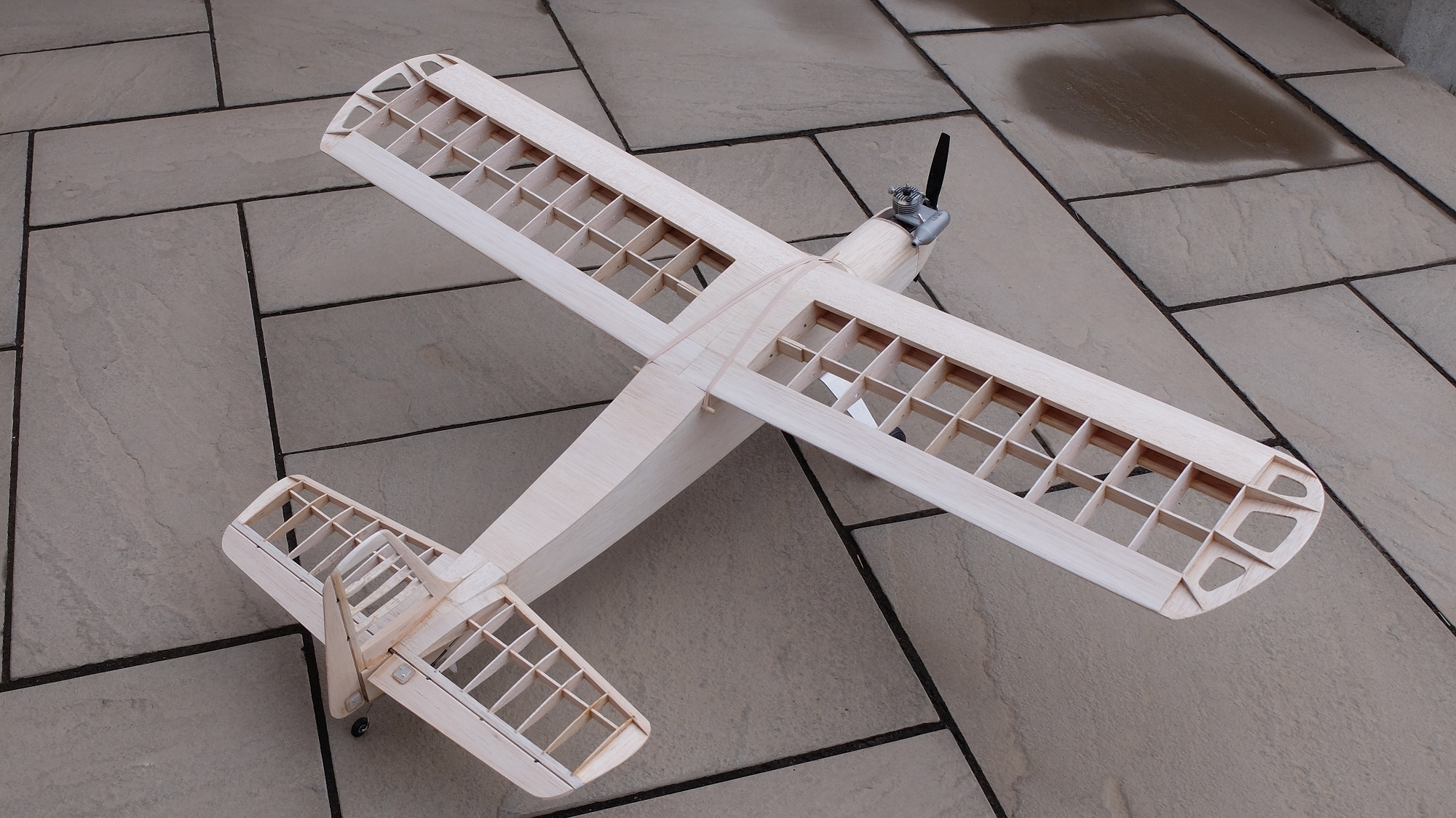

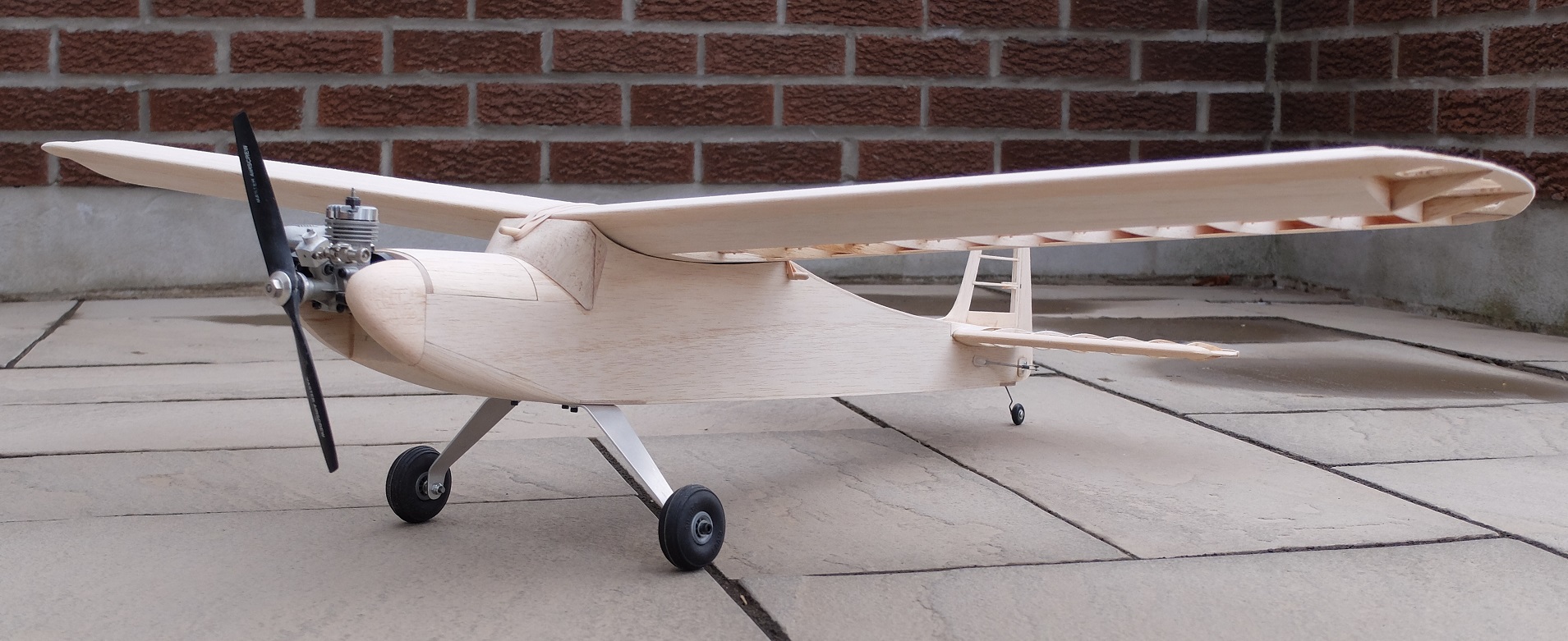

The project so far. <br />Fuse sides cut out, stab, elevator, fin &amp; rudder made<br />A few fuselage formers. You may notice that I changed some of the formers shapes to suit <br />more modern internal equipment.
The project so far.
Fuse sides cut out, stab, elevator, fin & rudder made

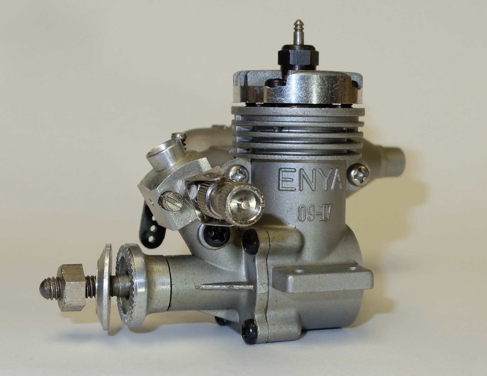

The mighty Enya .09 series IV<br />with muffler
with muffler

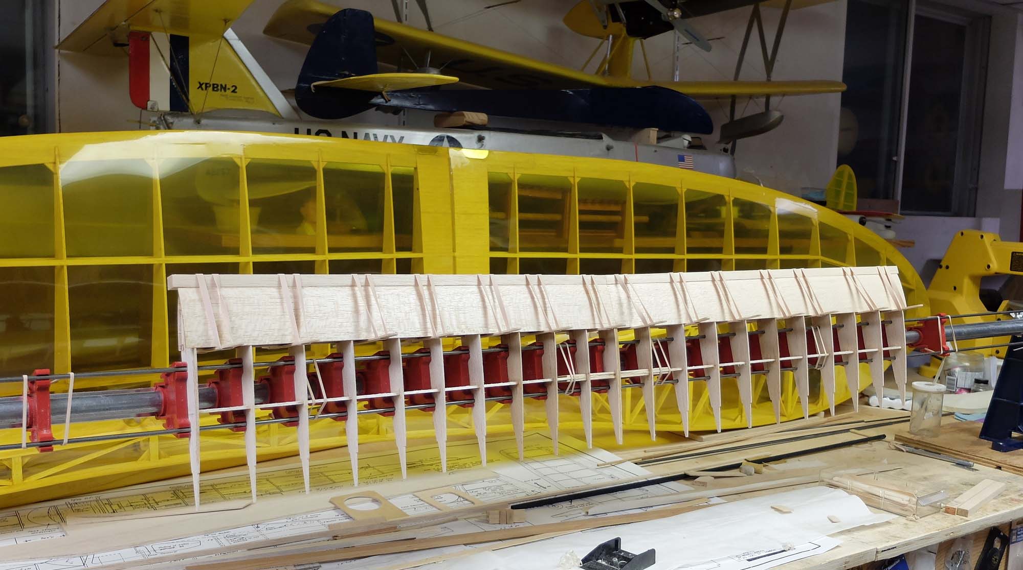

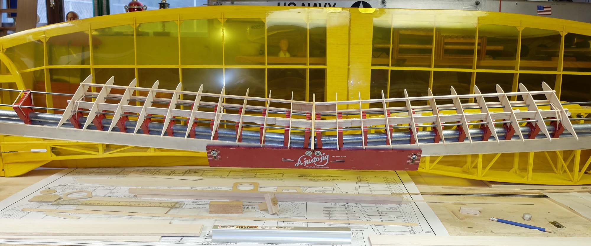

I have the ribs and spars setup in my trusty Adjusto-Jig.<br />A bit of a pain to setup but the wings always come out very straight
The leading edge wing sheeting is glued in place top and bottom. You can see the yet to be shaped leading edge being held in place with popsicle sticks and #64 rubber bands while the glue drys. Being a simple wing without ailerons I can usually complete everything with the exception of the bottom center sheeting and bottom side wing tip braces in while in the jig.

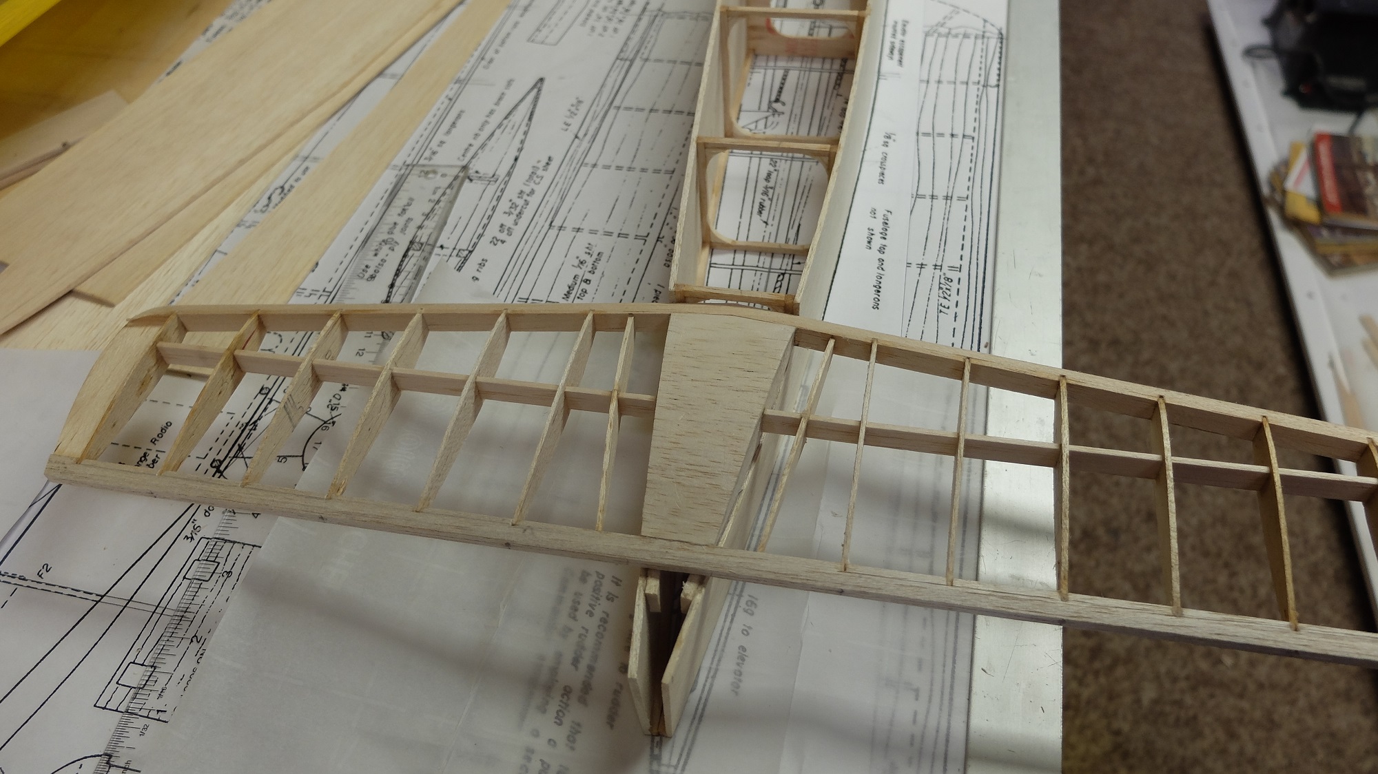

The completed wing &amp; out of the jig. <br />It is a very rugged wing!<br />Tail group is built. Fuselage next.
The completed wing & out of the jig.

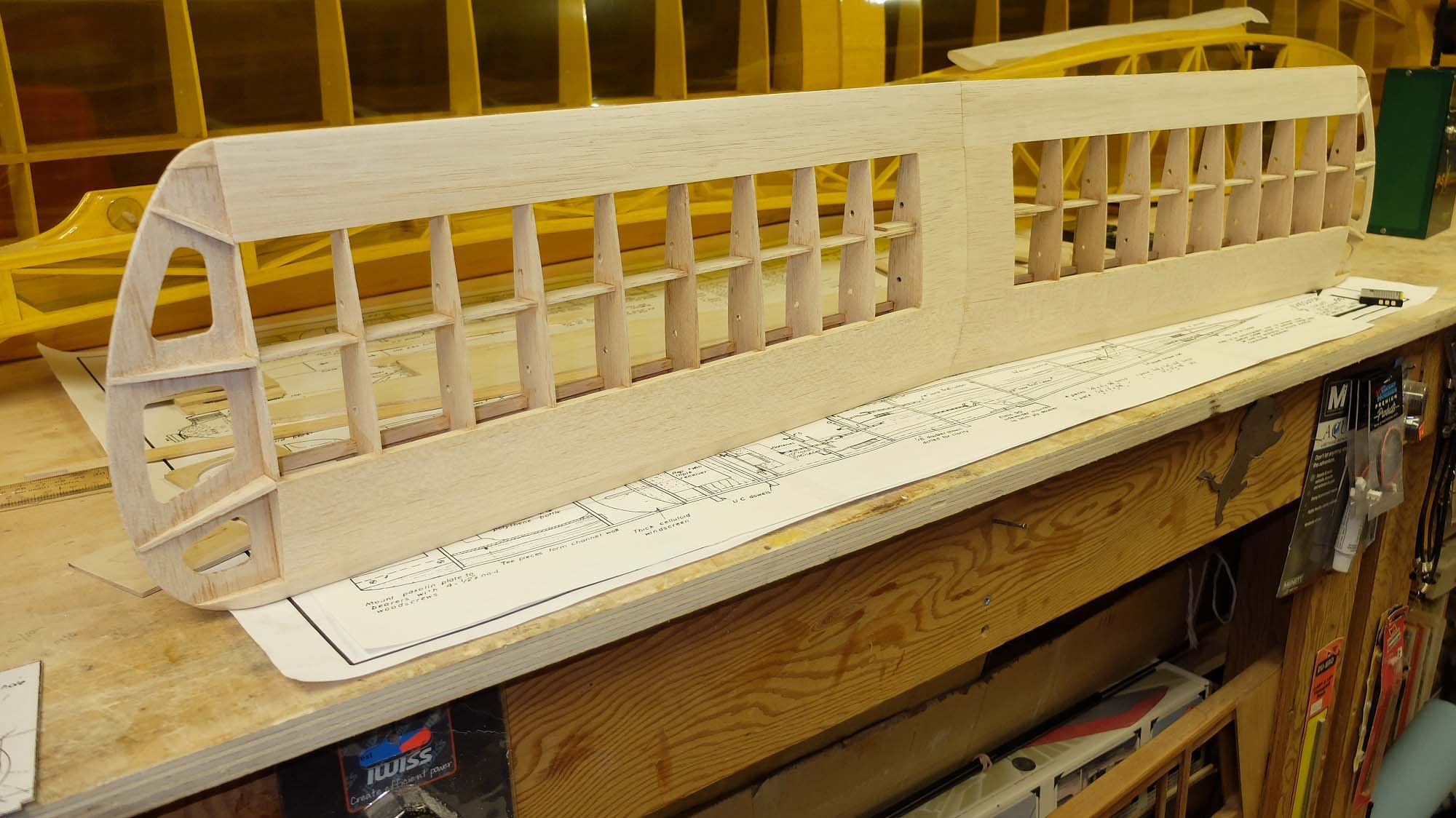

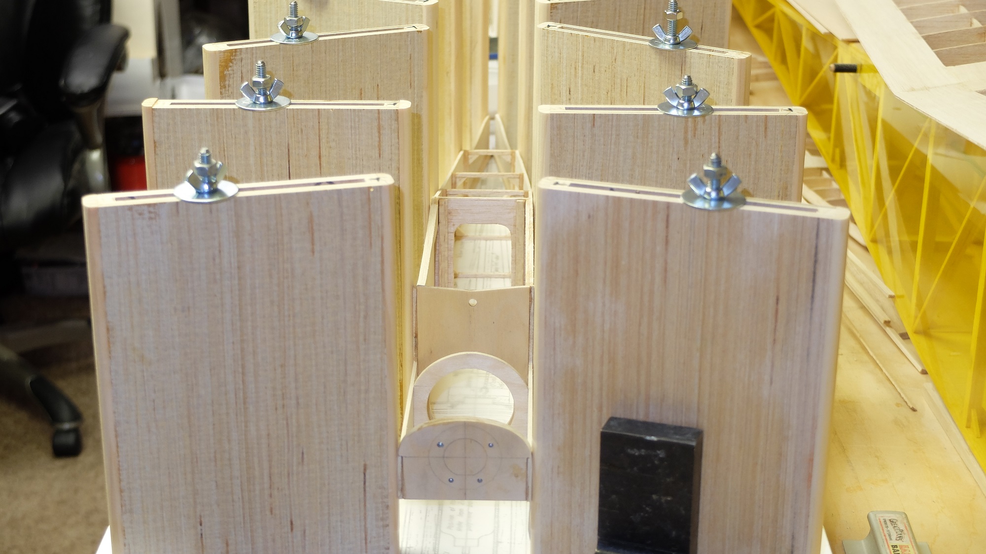

The fuselage taking shape in the jig. <br />Somewhat dwarfed in the huge jig originally <br />created to build a Leprechaun fuselage. <br />It does however prevent building a banana shaped fuselage.

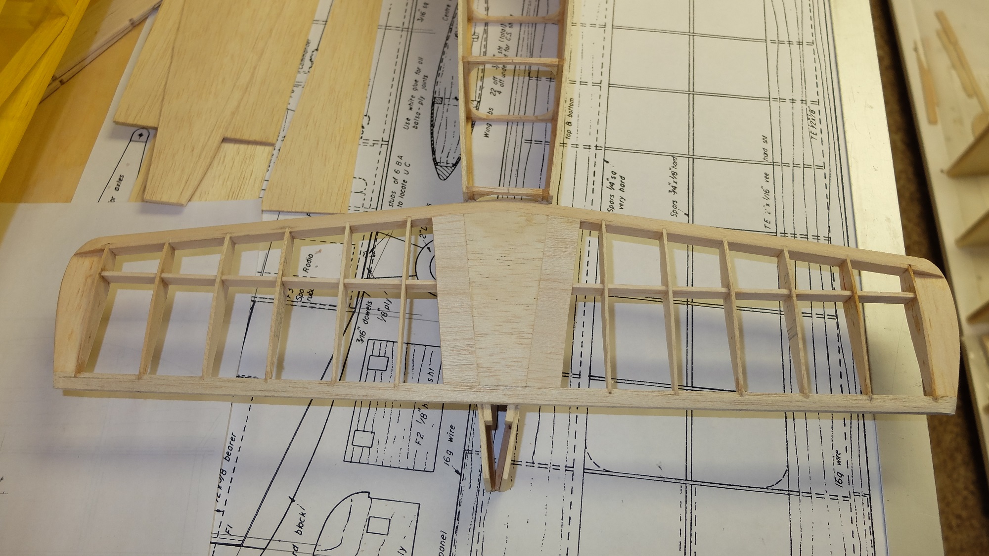

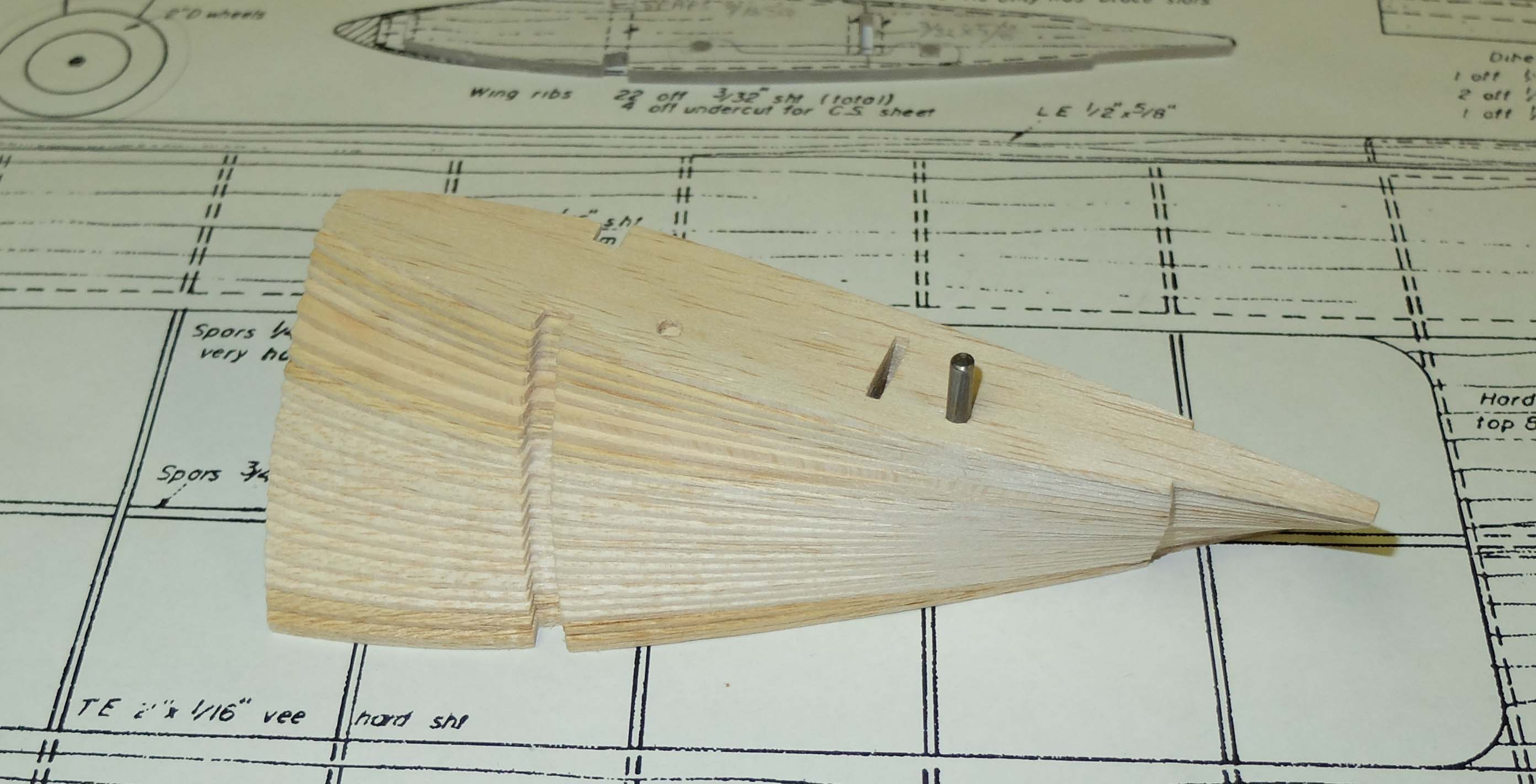

Out of the jig with the stab placed on the tail end I noticed a potential problem. The center sheeting matched the fuse edges perfectly - no extra wood to attach covering after gluing in place or if repairs are needed later. I added a couple of extra ribs approx 1/2&quot; farther out.
Out of the jig with the stab placed on the tail end I noticed a potential problem. The center sheeting matched the fuse edges perfectly - no extra wood to attach covering after gluing in place or if repairs are needed later. I added a couple of extra ribs approx 1/2" farther out.
Extra wood added. Now I can glue the stab on and cover later.

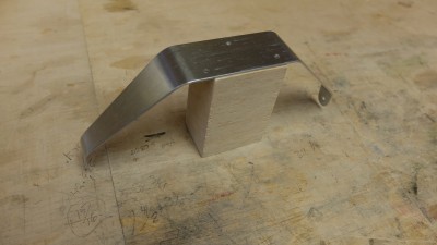

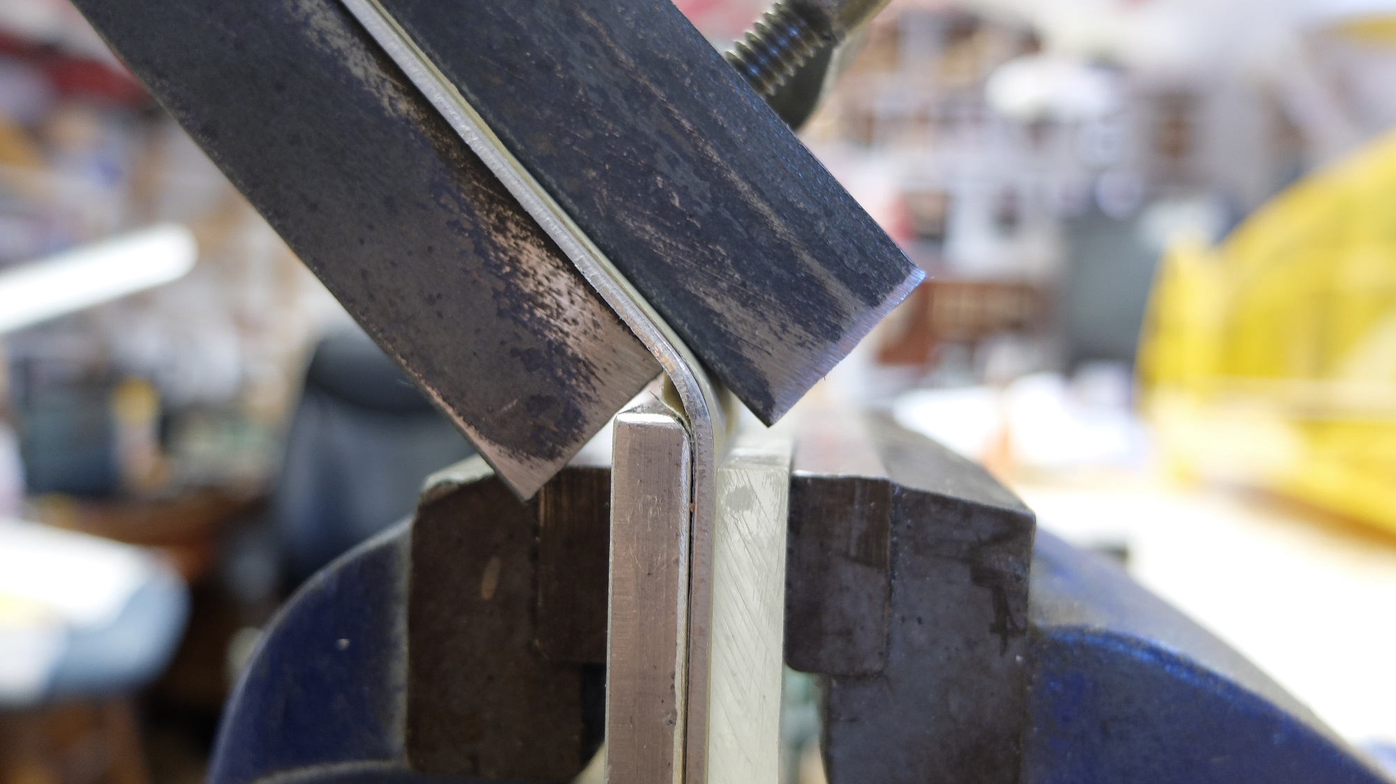

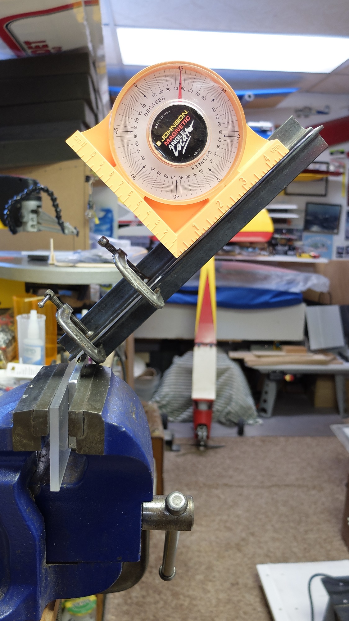

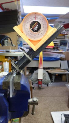

My brother has access to a metal shear so he cut a couple of blanks for me. Here it is being bent to shape. At this point ALL holes have been drilled for mounts and axles prior to bending.
I used a couple of short lengths on angle iron to keep the straight parts straight. A length of aluminum with a radius filed on on provided the form. Bend line on the gear is lined up with the top of the form block.
Completed gear came out looking good to me.

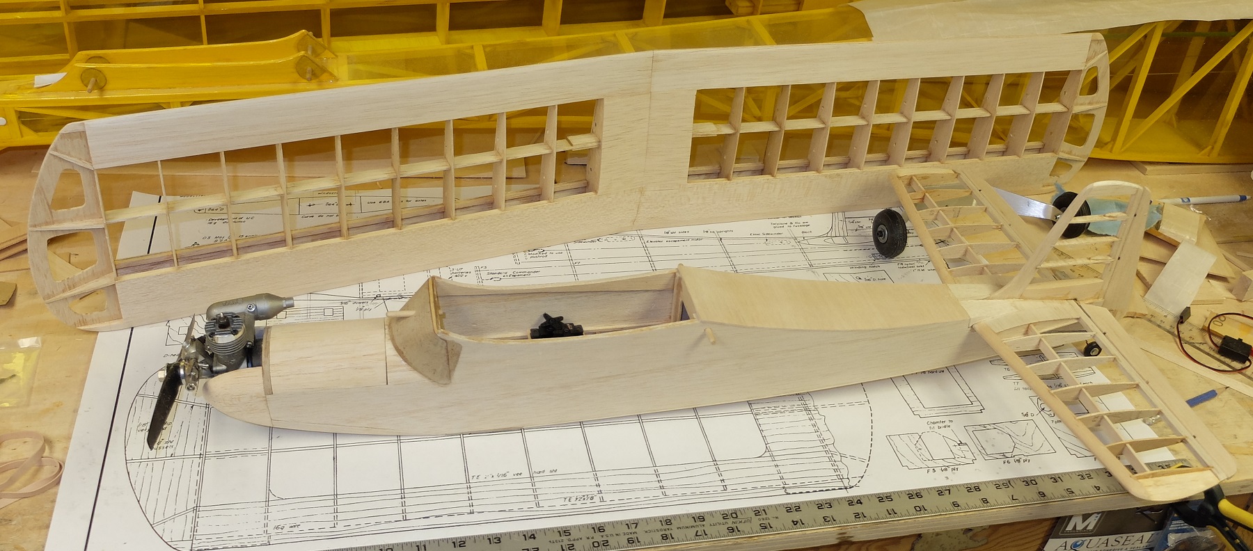

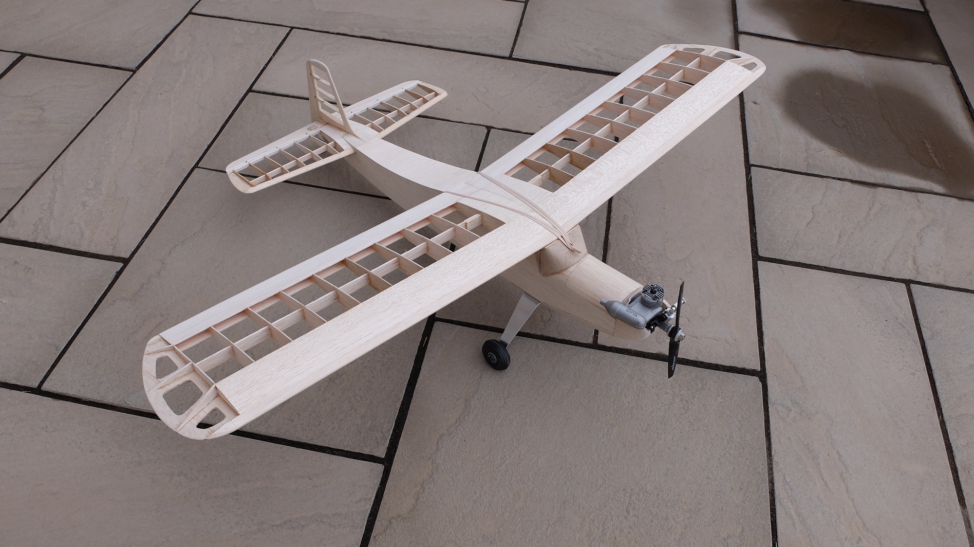

Air frame construction almost complete.

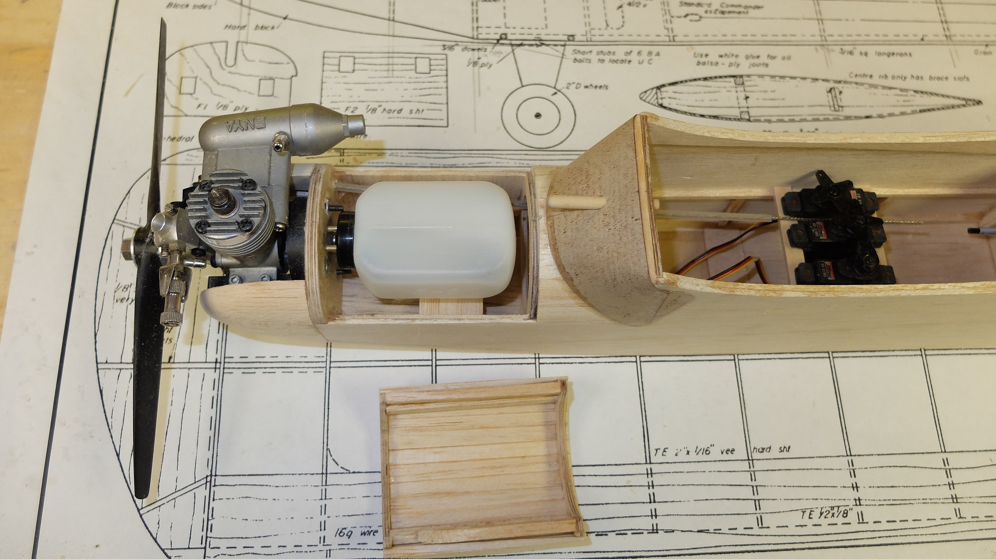

Fuel tank located and servo rails temporarily in place. I will slide them back &amp; forth along the 1/8&quot; square beams to get the best balance when the covering is completed. I will also add some vertical 1/8&quot; square braces from the servo beams to the wing saddles to stiffen up the cabin area after the servos are in their final location.
Fuel tank located and servo rails temporarily in place. I will slide them back & forth along the 1/8" square beams to get the best balance when the covering is completed. I will also add some vertical 1/8" square braces from the servo beams to the wing saddles to stiffen up the cabin area after the servos are in their final location.
Lots of sanding to knock off the sharp corners and maybe get rid of some weight still needs to be done.
Some pre cover bones shots. 22 oz. ( 623.7 grams) at this point.
