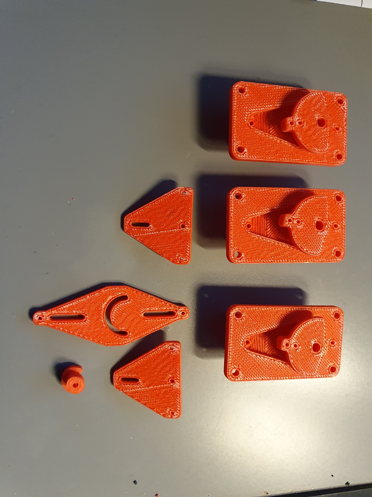

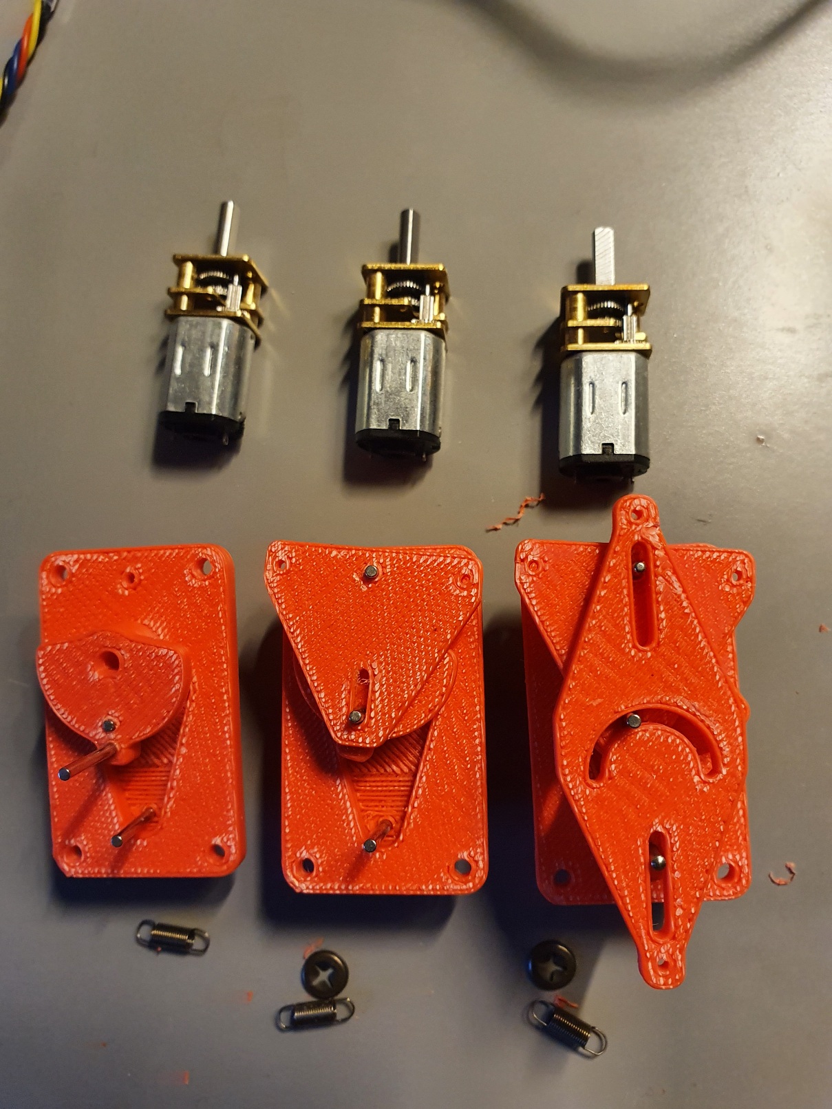

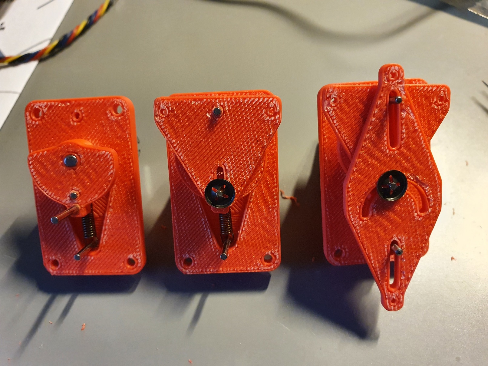

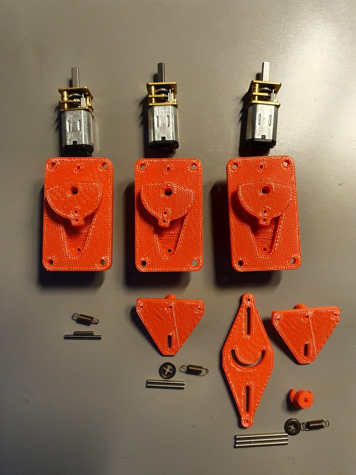

For all of you that enjoy Galloping Ghost.
Here is a different concept for a GG actuator or maybe more of a natural evolution as due to this lock down we are going through I had time to think and realized that I have too many options concerning my actuators and too many parts to keep track of...
From all this the following have come up, the same base will offer 3 options of actuator and all simple enough for those of you that would like to give it a try with your own 3D-printer. The only concern is to print in ABS as it gives a decent glue joint between steel dowel pins and the plastic. Dowel pins are obtained from 1,5 mm piano wire and the motor set up is the same as in the DIY.
Background is that I have evolved my "Mini" GG actuator to be a "Multi roll" actuator where the same base is used for a R/O actuator, a "Bellamatic" style actuator and a regular 2 channel GG Rand-style where all 3 uses the same Re-Coder, preferably one of the 3 DIY options. All relevant files are here below but if somebody is interested in a "Kit" with an option for a preprogrammed ATTiny85 I will be able to supply it and leaving the rest to interested modeller.
The concept is intended for the tinker that would like evolve from the DIY actuator to a more compact unit and experiment as this one is more compact opening for smaller models.
Please note that Elevator plate has been updated and will work better also with a softer spring
Please see the GG-Mini topic viewtopic.php?f=25&t=1122 for additional info.

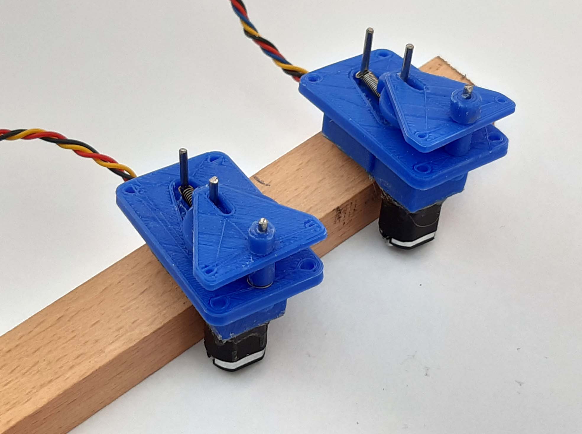

'Done it!...... :P
And they work!
I've been playing with my new toy (3D Printer) trying different plastics and different temperatures. I have been extremely unsuccessful with ABS but eventually got some acceptable prints with PLA so finally committed to making some Tobe Mini Actuators. In my previous rather limited experiments with Galloping Ghost I didn't like the interaction between rudder and elevator so this time I have elected to go for two basic actuators, one on each channel.
HUGE thanks to Tobe for all the work he has put into this project and for making the files and recoders available. :P
Posts: 717
Re: A modular concept for a GG actuator
Well done Paul, hat off for you.
I like the blue color, I have the habit to use blue filament for my test units. Interaction in the regular GG actuators is not as bad as it looks like but it calls for its specific approach to be appreciated.
