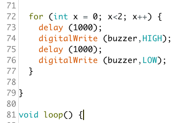

Hi guys,
I am writing some code for the Digispark. Actually it is a modified version of Phil's digispark_3ch_propo_sc_v2, intended for conversion of a WebraPicco Tx , see viewtopic.php?f=25&t=1168
Actually it was working very well, just as I intended it to be. Then I decided I wanted to add a buzzer and to have it sound two pips just before it enters the loop. I have been spending about 4 hours now to get it to work, without success. All it wants to do is show a single short flash (I have connected a led instead of the beeper for now, I am doing this in the living room and don't want to drive my wife nuts.....).
It's probably something simple, but I cannot work out what I am doing wrong, hence this cry for help.
Here is that part of the code:
Max.
Edit: and yes, buzzer is defined as OUTPUT, on P2. And the Digispark has been de-fluffed.

Hi Mike,Phil_G wrote: 04 Jan 2021, 18:08 Your modification prevents any ppm generation for four seconds Max
You need to do it on a frame-gated basis which is how the inactivity warning works.
It's further complicated by the multiplexed buzzer and button input...
I have posted 2, 3 and 4 channel versions, including rudder/throttle... all work perfectly
I revised the entire sketch for my specific purpose, one of the things I did was to split the combined buzzer and s/c button, P1 is now the button and P2 the buzzer.
I did test the whole thing without a buzzer installed (or its led replacement), and all was well. I did not test the inactivity timer, so I don't know if that works or not. But that part is exactly the same as Phil's original (yes Phil, I will add a source reference.....), except maybe for the channel assignment.
This is my code. I commented the part about the reversing check out since I did revise that to add an audible signal (the Webra has a non-centering lever for rudder, so you could be reversing inadvertently), and I wanted to be sure that it is not the culprit of my current trauma..
Max.

I know Phil, but it happens during Setup, not in the loop. And the millisecs shown are just for testing, I will change them to more appropriate values later.Phil_G wrote: 04 Jan 2021, 18:08 Your modification prevents any ppm generation for four seconds Max
- Posts: 787
Re: Help needed
You've got a noInterrupts(); statement at line 28.
That stops all interrupts, including the timer0 interrupt which the Arduino uses to keep track of milliseconds. So delay() won't work.
In general, you don't want to leave interrupts disabled for very long in a normal Arduino sketch. I don't see a good reason for disabling them in your setup() routine.

Ah, thanks Martin. But it does not seem to affect the delayMicroseconds() used to construct the ppm stream.
- Posts: 787
Re: Help needed
Yeah delayMicroseconds() just uses the timer0 hardware. There is a hardware register, TCNT0, that is set to count once every 4 microseconds. It counts up to 255 and then resets back to zero. It does this regardless of the interrupts. delayMicroseconds() just sits looking at this changing register to keep track of time, so it works even when interrupts are switched off. Note that delayMicroseconds() and micros() only have a resolution of 4. If you write a loop to just Serial.println(micros()); you'll see that all the numbers printed are multiples of 4.
