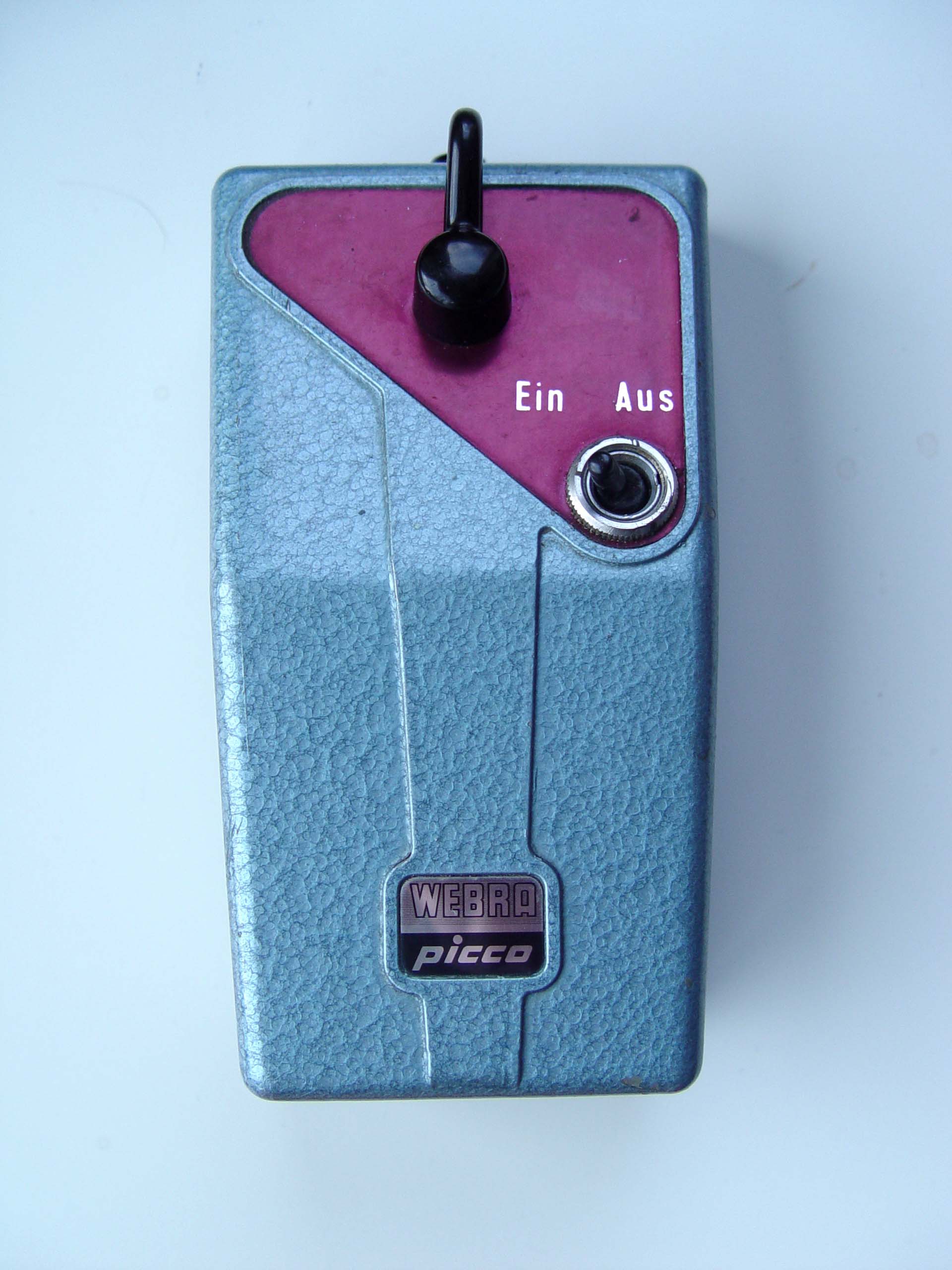

As I reported in this topic viewtopic.php?f=25&t=1168&start=10 , I am in the proces of converting a WebraPicco to 2.4GHz. The case is entirely metal, an aluminium casting and aluminium sheet backplate.
The antenna of the internal Frsky DHT module could be placed in the same position as the original 27MHz antenna, as Frank (tiptipflyer) has done, properly insulated, but the owner has expressed a wish to keep the original antenna as a dummy, and place the 2.4 antenna somewhere on the backplate.
I did warn him that the antenna should be kept as far as possible from the case to avoid any interference or shielding of the signal.
However, on reflection I wonder if it makes much difference if I did mount it on the backplate. In that case I would choose the left-upper most corner, as seen from the front. I usually swing my antennae on my own transmitters to the left, to an almost horizontal position, as I learnt that this is the most effective attitude to ensure the donut-shaped signal strength shape is strongest in the direction of your (flying) model.
I cannot see any shielding happening this way, but I am not sure about the proximity of the metal case.
Does anyone have any experience with this?

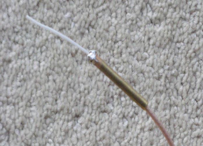

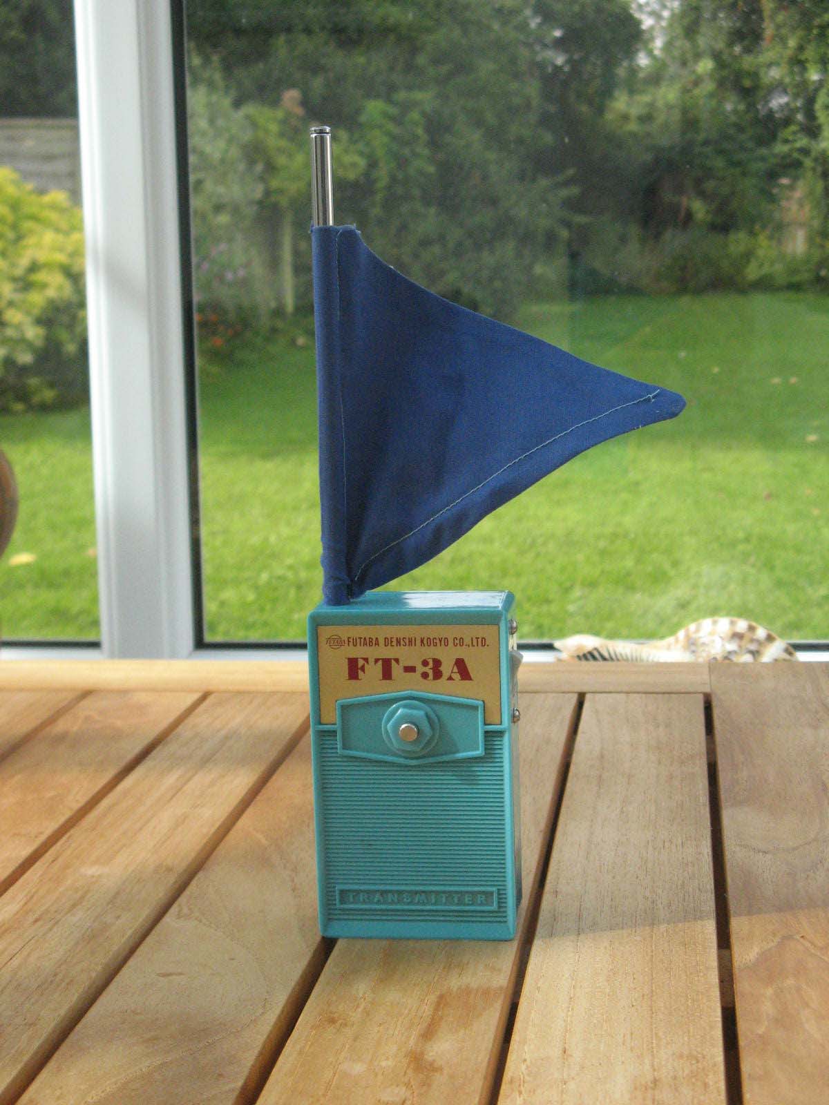

Max, this would be an ideal candidate for hiding the 2.4GHz antenna in a dummy frequency pennant.......

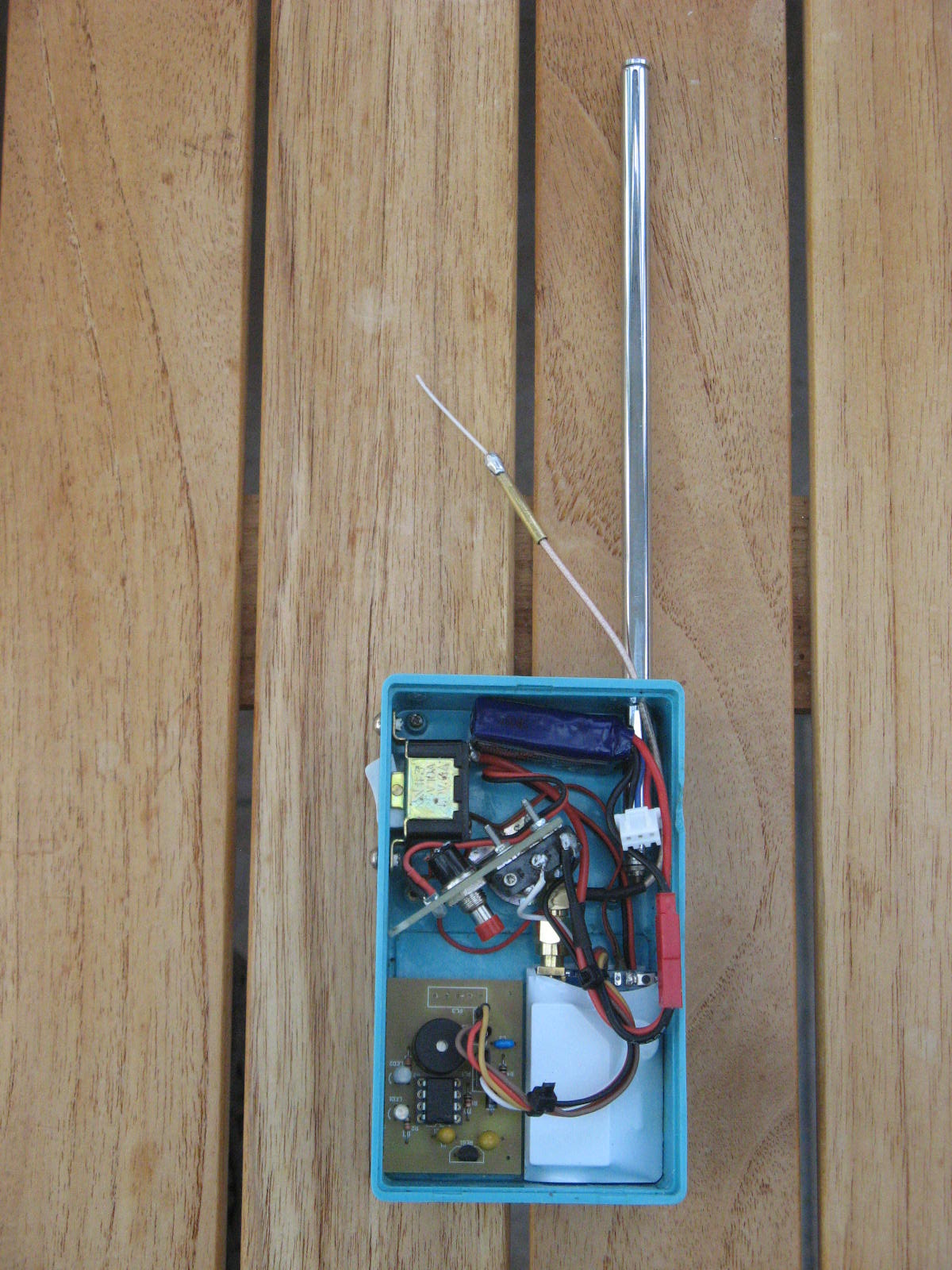

You either find a natural way through or drill a small hole for the antenna co-ax and make your own dipole antenna, which is a bit of a fiddle but not difficult......
The antenna itself is made from the co-ax connector cable. The actual lengths of the "whisker" and the tube are fairly critical to get it to resonate at exactly 2.4GHz. Following help and advice from Martin, I invested in a Vector Impedance Analyser which enables you to "tune" an antenna to some extent but using it, I have found that very few of the commercially supplied antennas are well matched anyway! You don't really need the VIA, if you make both whisker and tube 28mm long you shouldn't be too far out. though before using any homemade antenna you should extensively range check it just to make sure it is up to the job.

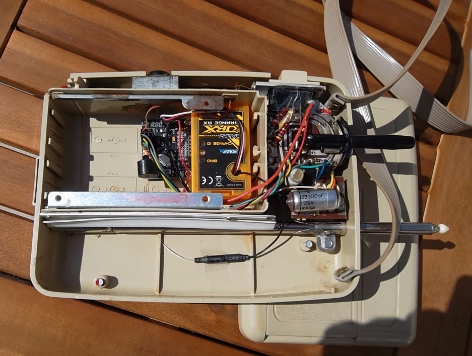

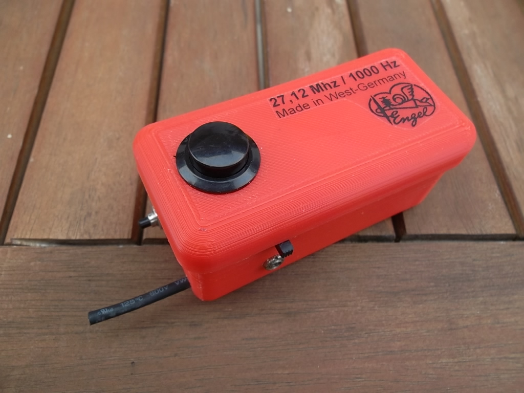

I am using similar antennas to those in your request, intended for Rx in some of my converted transmitters (Metz 3channel, Engel Handy).
The Metz antenna is located within the plastic case, the Engel Handy antenna is sticking out.
They do quite well both. I did not have any issues until now. Frank

Max, I am not familiar with the Frsky module but I have made antennas from both the thin RG178 and the thicker coax connecter that is sometimes supplied with Orange modules and both thicknesses have performed well. When I started making these things I used the lengths suggested by Phil but since I aquired the VIA and was able to measure the performance I have fiddled with the length and ended up with 28mm. Start with it a bit longer and trim it down if the range isn't good enough.
I think the antennas in the link you supplied would work very well.
