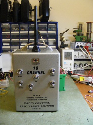

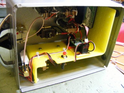

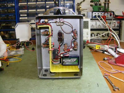

Now I have finished working on Twitcher's Guidance System s/c Tx, I have been able to complete my Tiny-6 Reeds.
All the original RCS levers and switches are used while the Trim lever when pressed in either direction is doing the job of Phil's trim button. The coder board is on Veroboard with standard RC connectors. RF is an Orange diy module that eventually arrived from HK after a 3 month wait. Currently using a 3S 850 LiPo, mainly because I don't have any 2S at the moment.
The bind button and its led have been left inside as it is easy to pop the back off without any tools. The analogue meter has been connected and calibrated since that photo was taken.
It is all working as intended so I look forward to flying this very soon to revisit my Reedy roots.

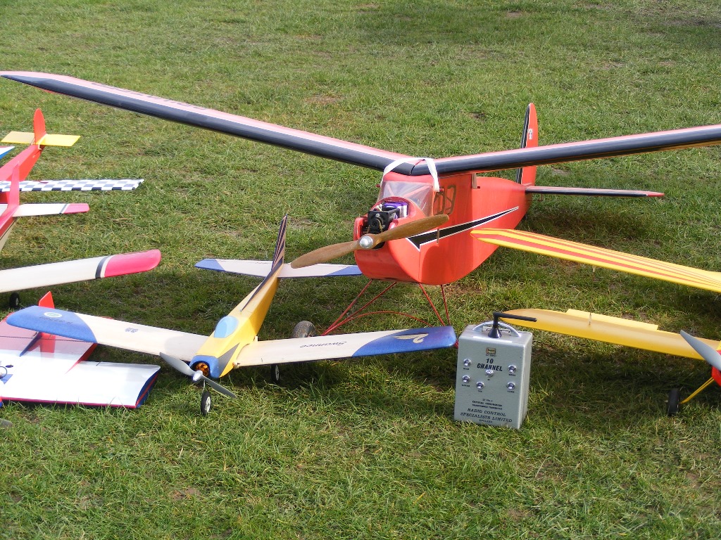

My Tiny 6 has now flown both the Privateer (very sedate) and the Swannee (bum-clenching). This pic taken during a South Oxford Nostalgistas gathering in Feb 2017. :D
