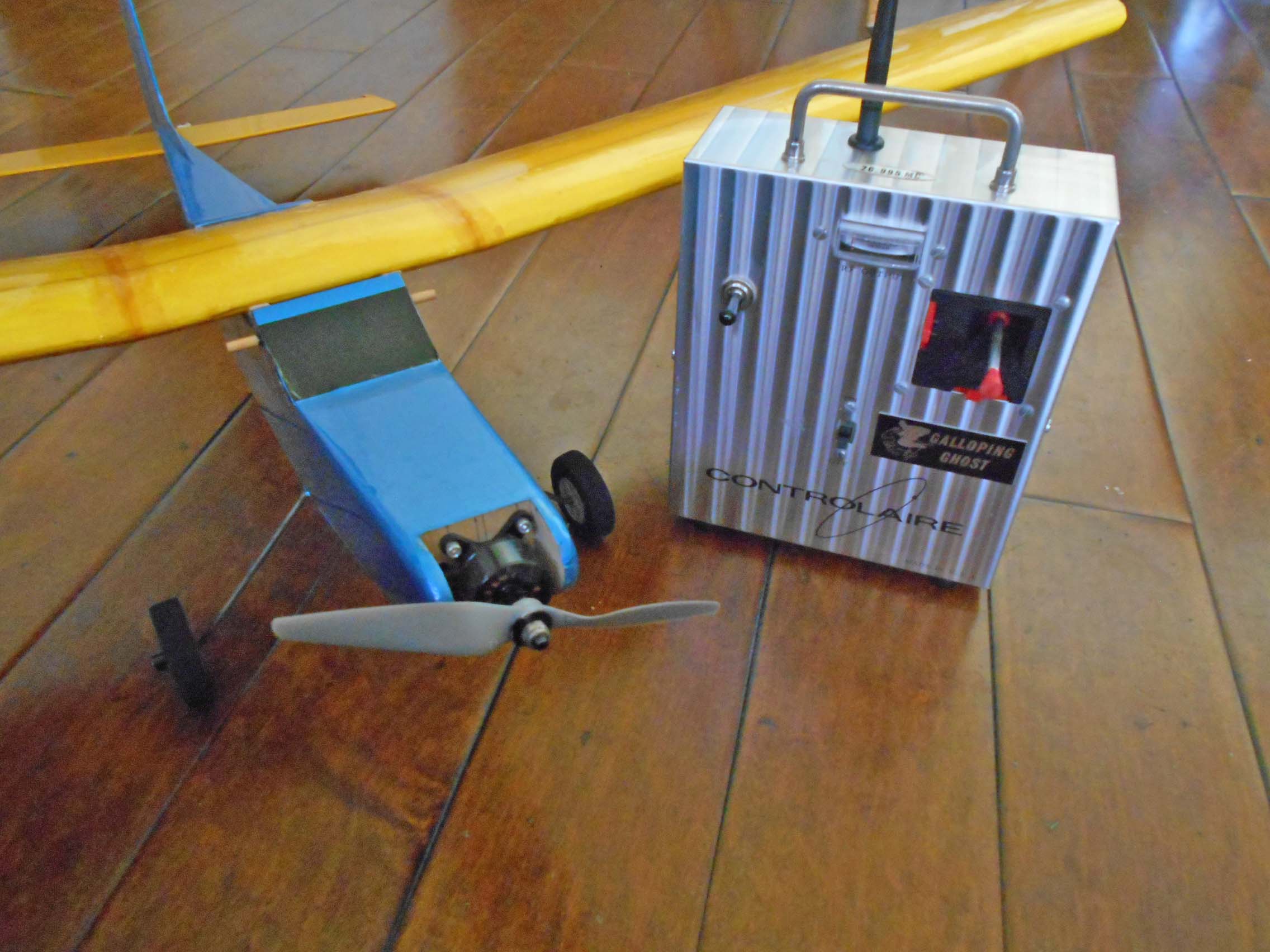

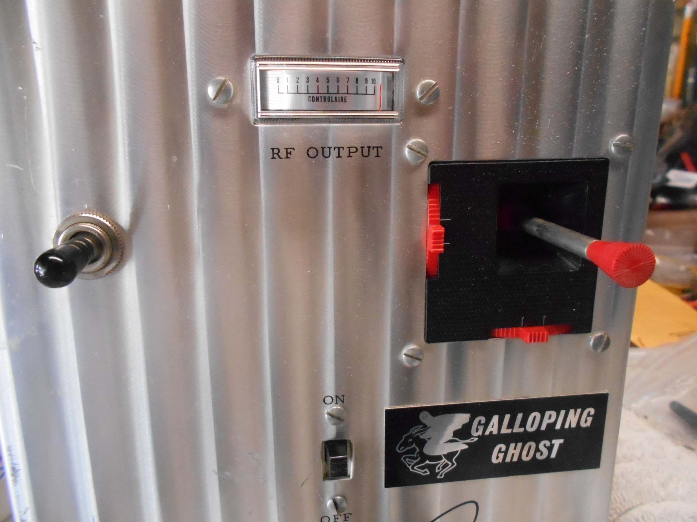

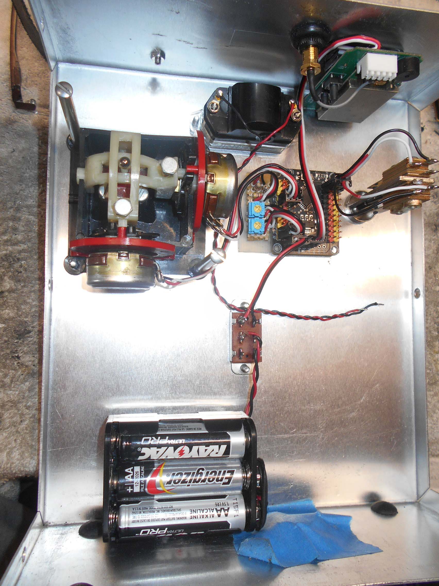

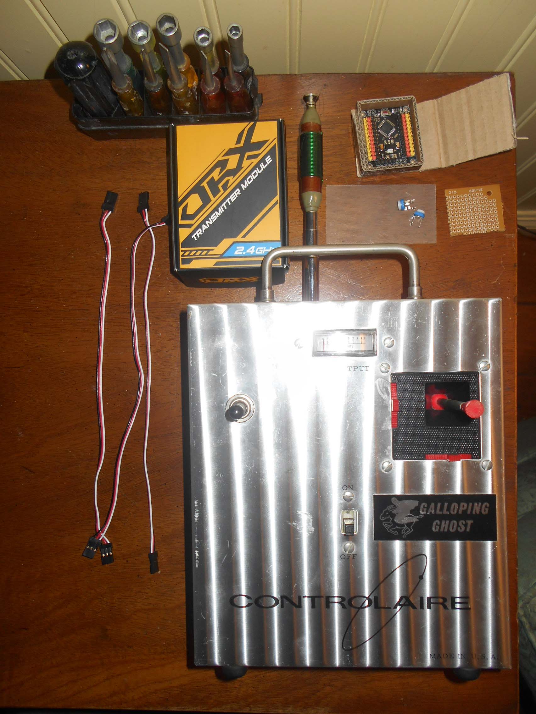

This is a converted Controlaire GG transmitter ( version 2) using Phil G's GG encoder with progressive throttle and throw adjustments for rudder and elevator. The RF output meter was converted to read voltage as an expanded scale voltmeter using a 7.2V zener diode. I used a pot to adjust the full scale meter reading so I can use an 8 cell NiCad, 6 cell dry cell pack, or a 3S LiPo.

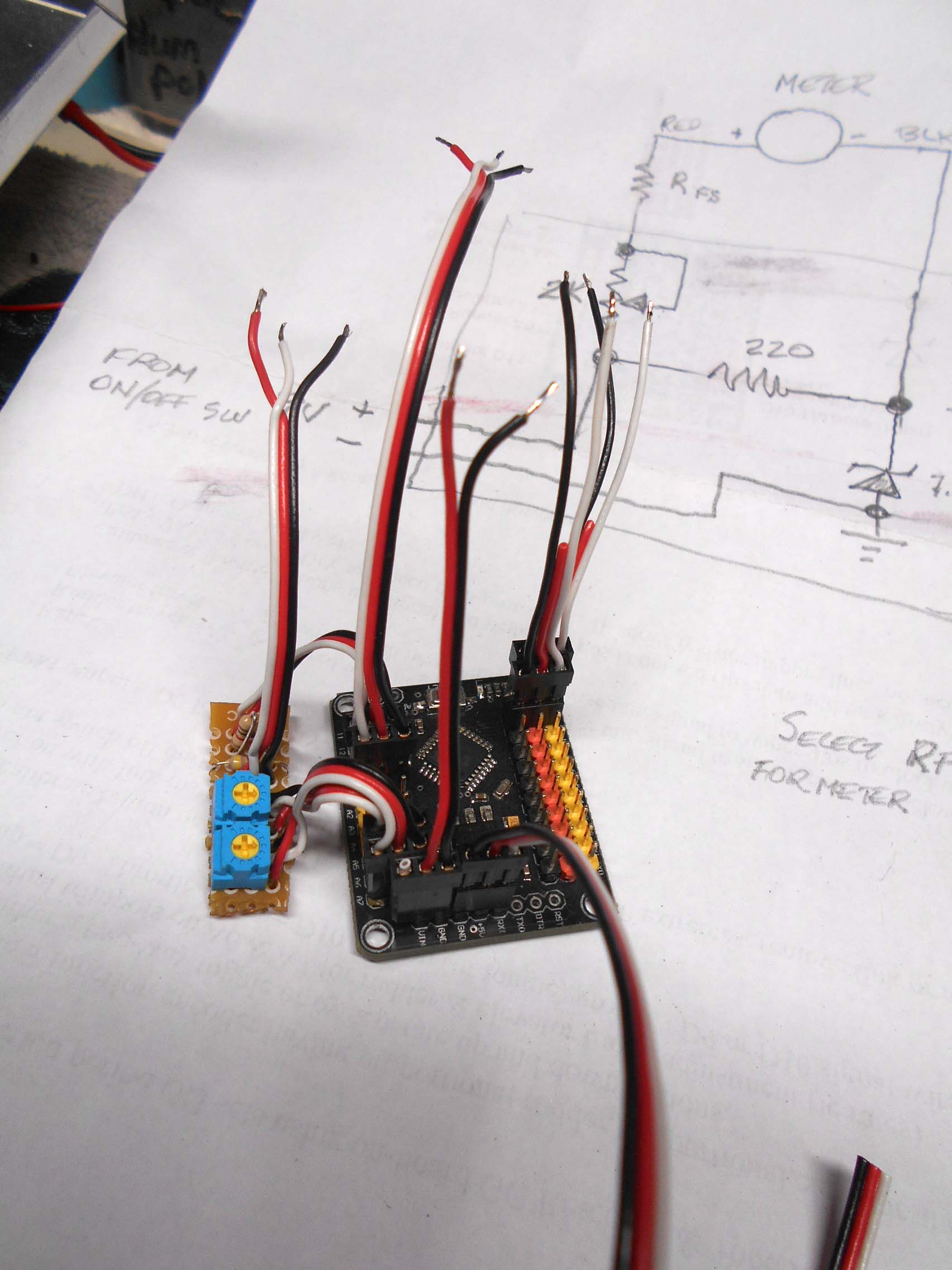

Items in 1st photo are the Tx, the Arduino from Phil, and the pots for the throw adjustments.

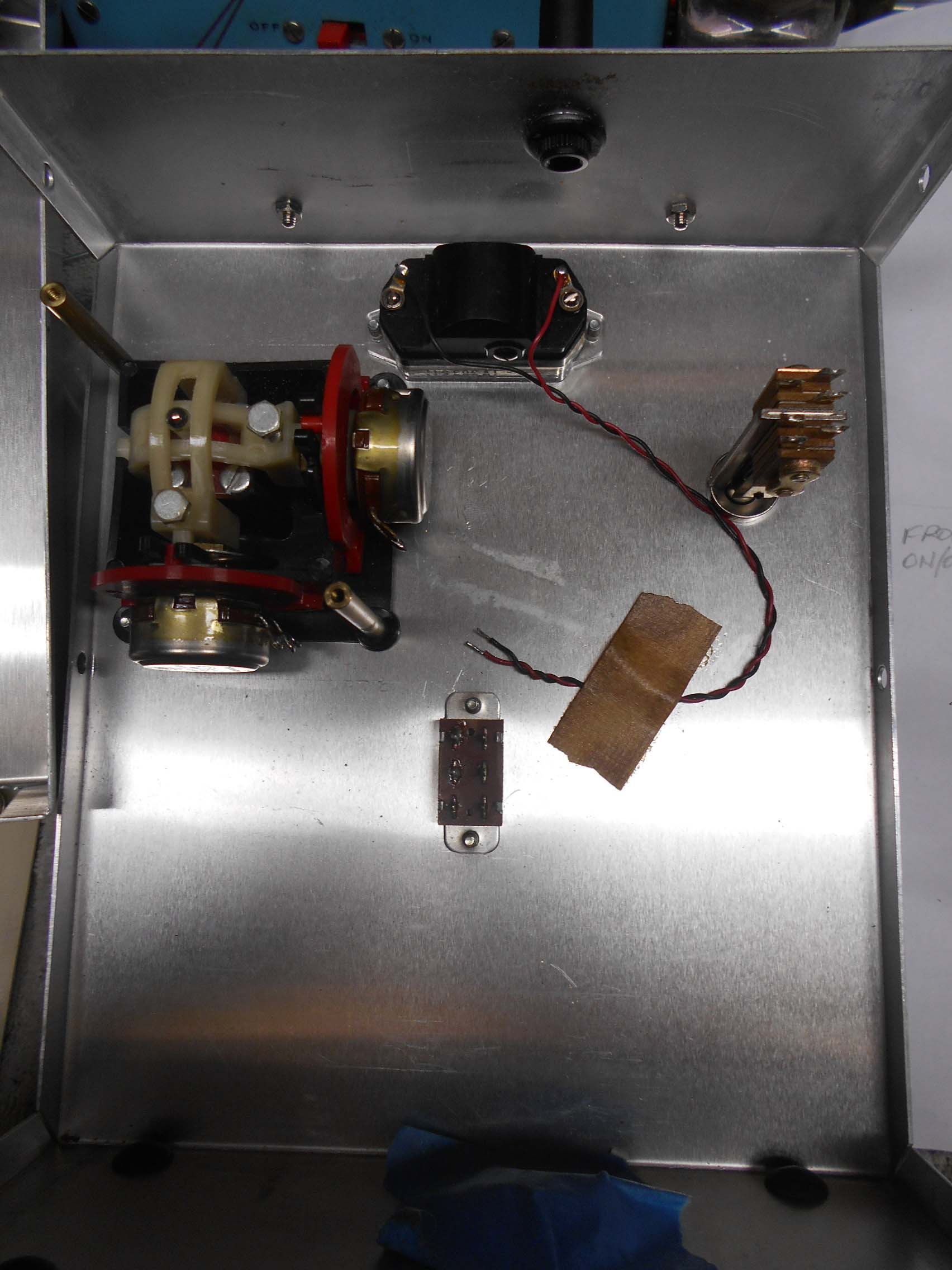

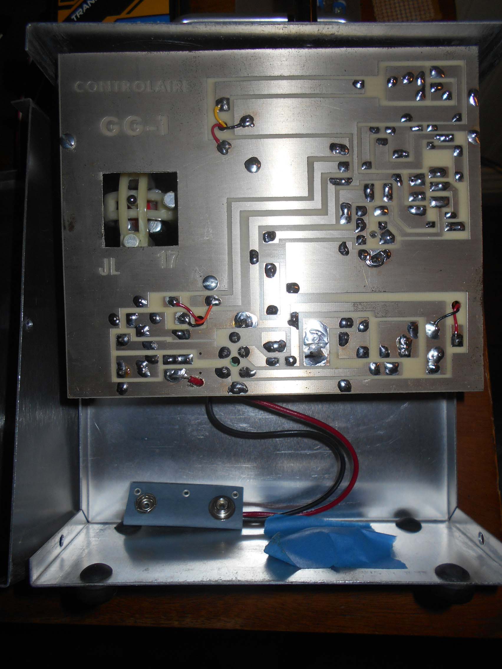

Next is the inside of the Controlaire before gutting it.
3rd photo shows original PC board removed, note grommet and 2.4 GHz antenna installed.

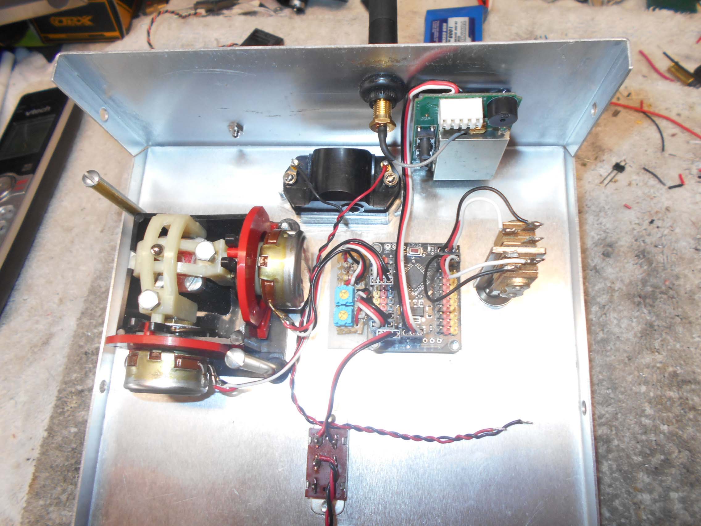

4th is a shot of the encoder wired up to the throw pots

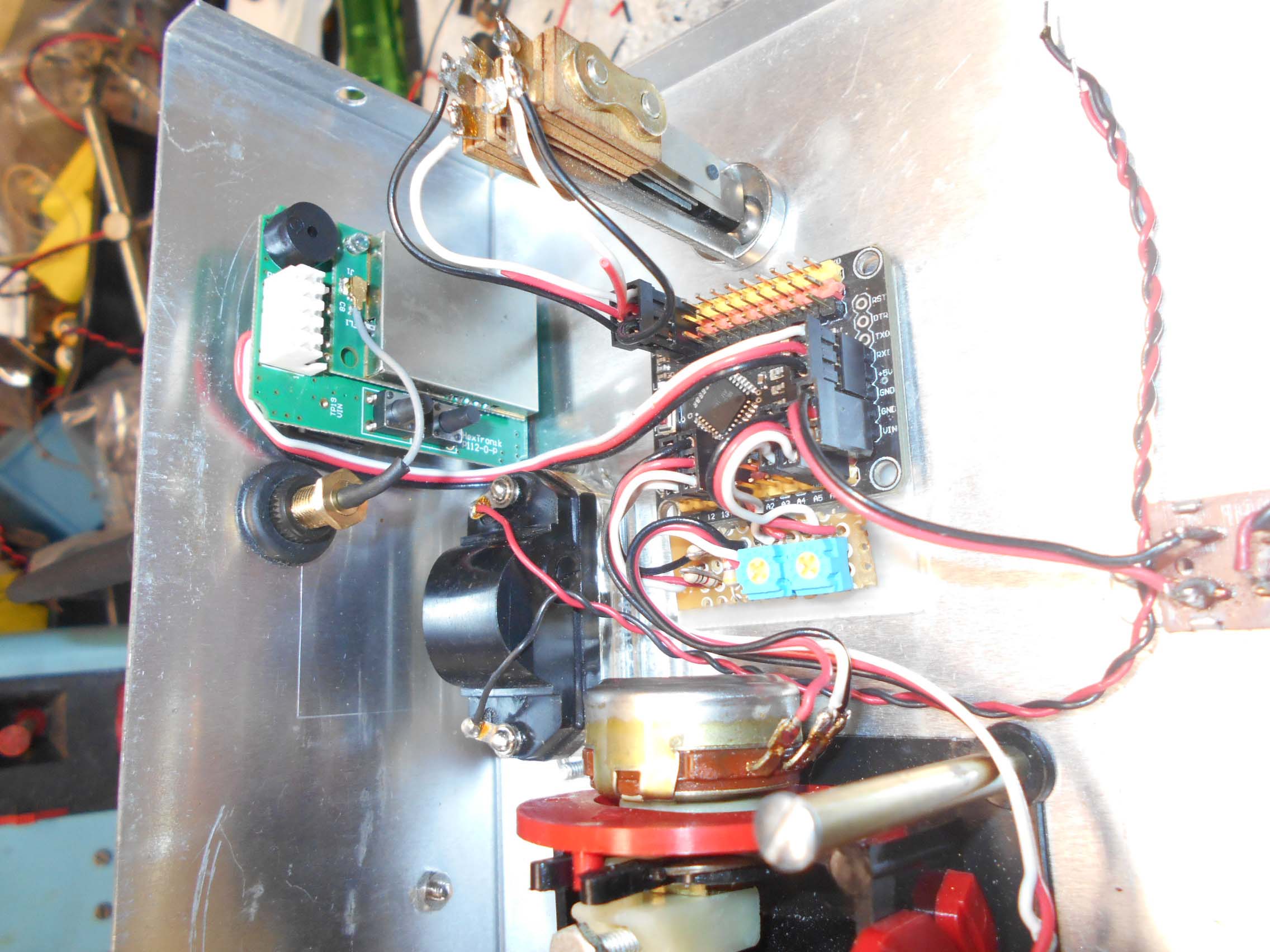

5th is the encoder and Orange Rx DSM2/X module installed and wired to the sticks and switch.
6th is the little ESV board wired to meter
7th shows meter working, yes!
And final shot is after a successful flight of the Ace Wizard equipped with GG-Tobe and Phil G recoder.

A few things about the Controlaire:
To use the 100K elevator pot, it was necessary to strap it with a 47K resistor to make it appear be less than 40K . In addition, the outside pot lugs of the 100K pot have 100 ohm resistors in series with supply positive and negative to isolate the pot from the power supply rails; this was needed so the 47K across the pot would work. You can see the little board with the two trim pots for throw has the 2 x 100 ohm and 47K resistor. The Elevator pot wires to the little board with the 3 resistors and then from there it connects to the Arduino analog input.
I found that there is a bonus feature with this transmitter: It can be use for any 2 or 3 channel plane as the Galloping Ghost feature is part of the actuators re-coder electronics, so in effect, the transmitter is a 3 channel rig with positionable throttle control.
The only caution I have is that it takes a few seconds for the throttle to go from low to high, and back again, so make sure you account for that as you cannot chop the throttle instantly. If the slew rate of the throttle was any faster, it would be very difficult to get fine adjustment of the motor speed and make it hard to control. Drawing and Sketch attached below, thanks Phil-G!
