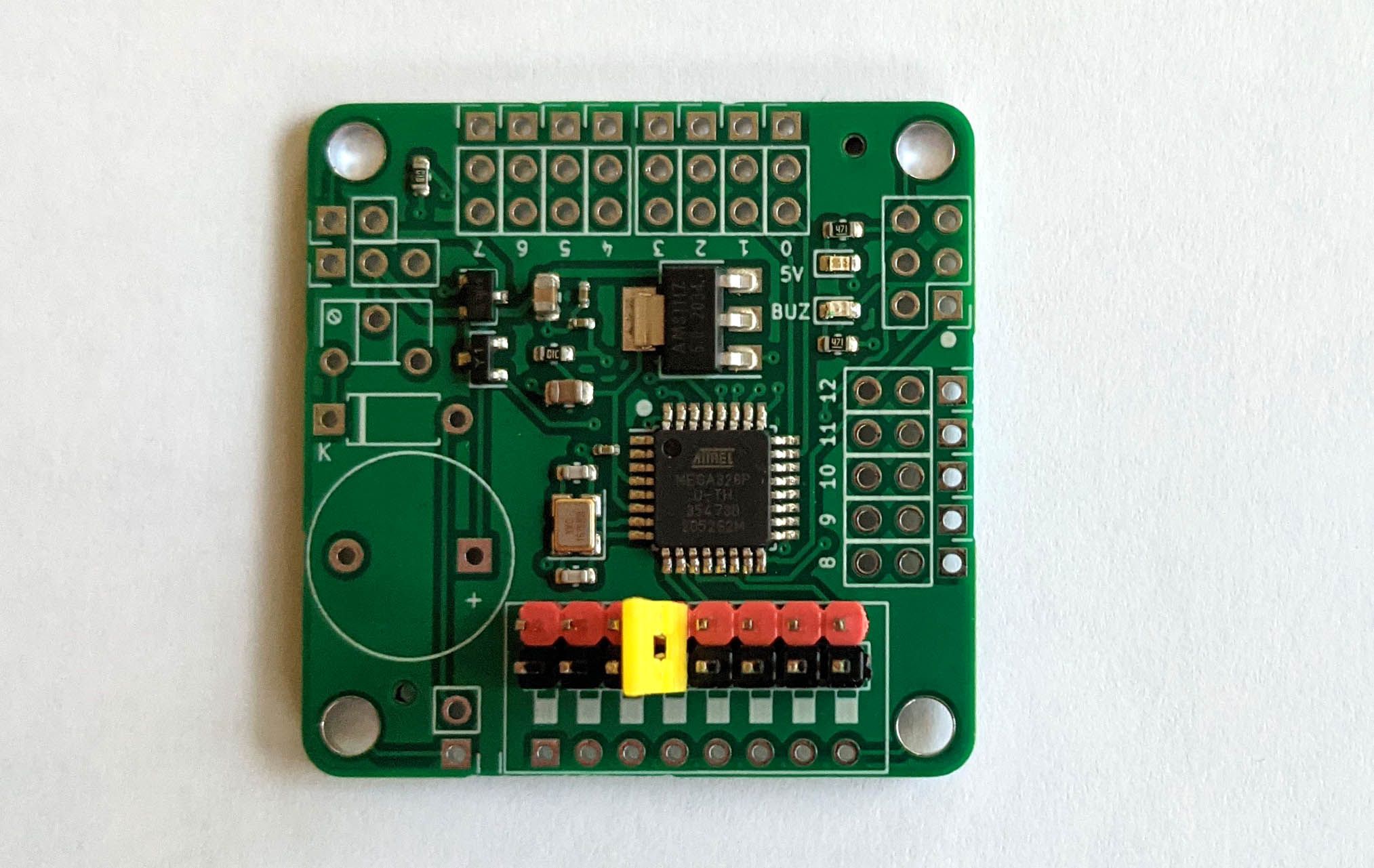

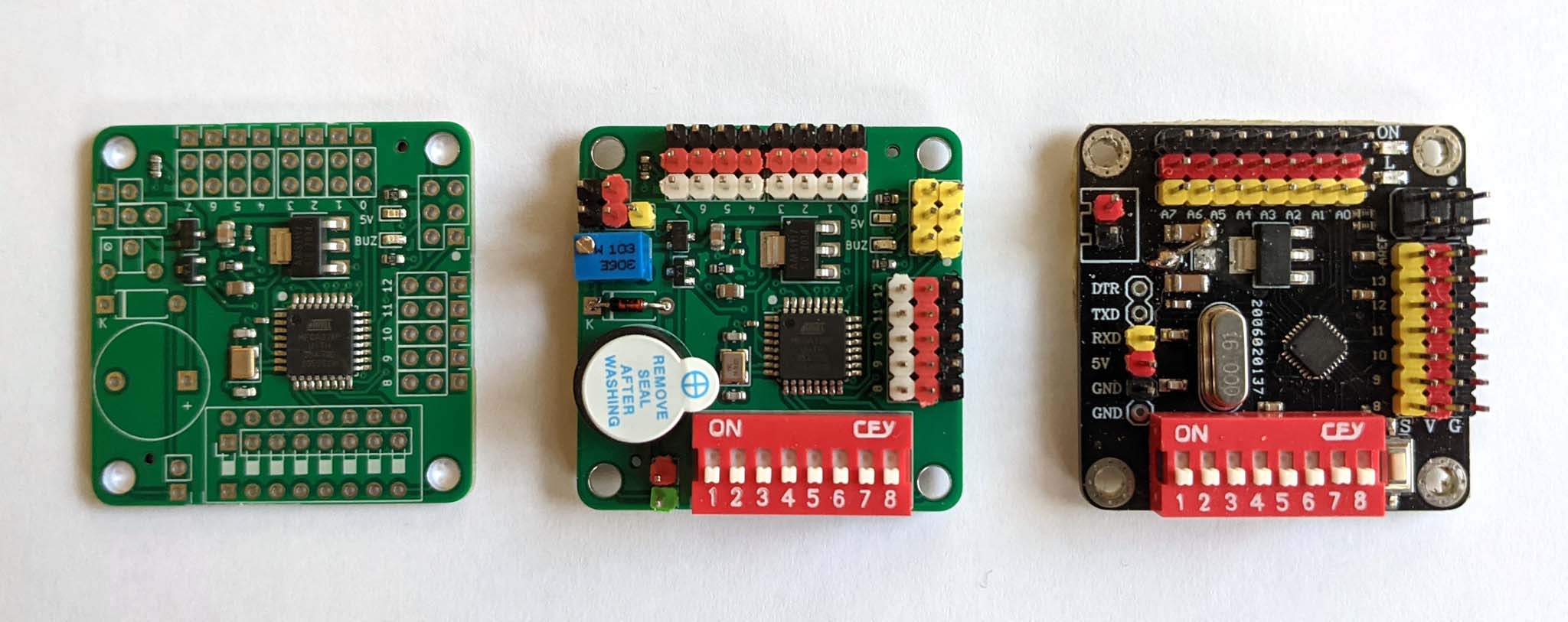

Pro Mini Encoders with a Pro Mini Strong for Comparison
Headers and 0.1" jumpers can be used in the place of a DIP switch
As I become more familiar with KiCAD, I wondered what else I could draw up. This coincided with Stuart Mackay having some problems with a bad batch of DM More Pro Mini and I wondered if I could do a DM More copy, but more customised to our use. After discussing with Stuart his wish list, we came up with the following:

After a bit of shuffling the components around, everything fitted on the board and I think all the design criteria have been met. Obviously, it can't quite compete on price with the mass-produced DM More board, but I think it'll be close enough to tempt some people to consider it.
But before I had even received the boards, I'd already designed a MK2 version with some other idea's. The sounder was very close to the DIP switch and if a different brand of DP switch was used it could foul the sounder. And it seemed a shame to have to solder a through-hole zener diode on-board and not have a surface mount version. I always use a 6.8V zener for the meter and Phil uses a 6.2V zener, hence why I thought you'd fit one to suit. But I realised I could put a 6.8V and a 6.2V smd zener on the board, on different pins of a 3 pin header and the cost would be less than one through-hole version.

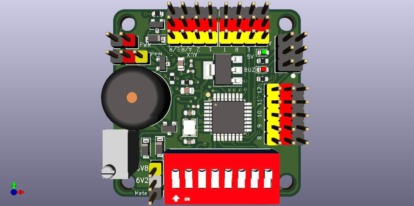

Virtualisation of the MK3 Pro Mini Encoder - the sounder and pot' are slightly smaller in real life
I've sent out a number of the boards to members on the forum for comment and also ordered some MK2 and MK3 boards, to compare.
