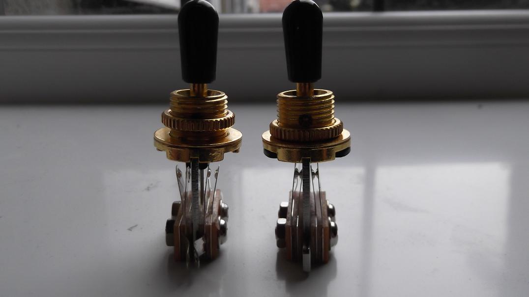

Postby Histone » Tue May 09, 2017 8:35 pm
Two pictures of my modified guitar switches, both types differs in their nuts (and slightly some other details).
To prevent blocking during operating, I reduced the travel of the stick by sliding a short piece (4-5mm) of an RGU-58 cable rubber outercoat over the central serverpin.
As far as possible, but keep the end of the serverpin (contact with the moving contactstrip) sufficient free.
Even a second coat can be applied.
The outer end of the moving contactstrip is straigthened / flatened.
In the bottom picture the switchtype with the (removed) PVC position lock-disk, and allas nearly visible, a black serverpin, but same modification.
Not critical anymore and a safe operation !

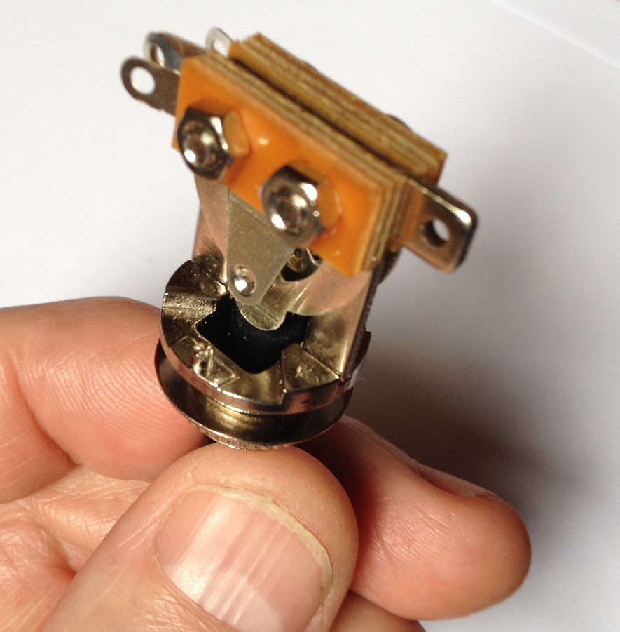

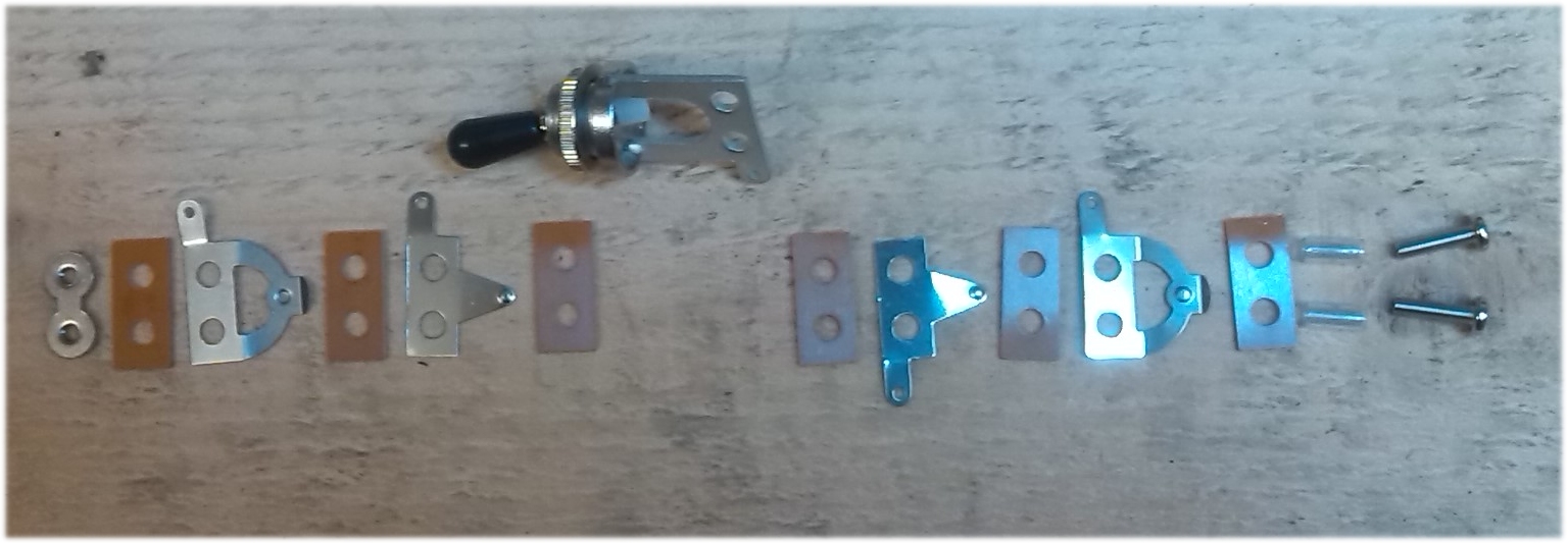

Postby Phil_G » Fri Jul 29, 2016 1:27 pm

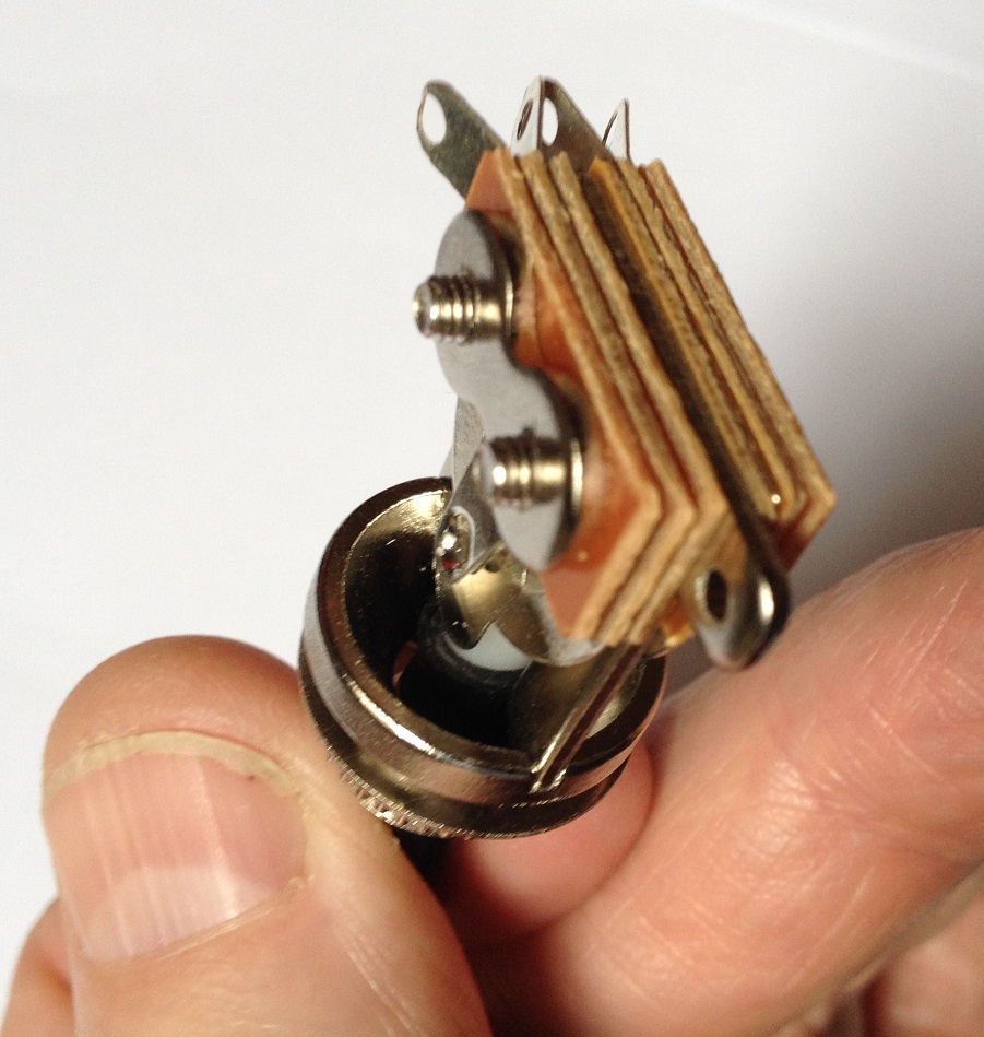

Heres a 'disassembly' photo I took a while back, click to enlarge.
This is a 'before' shot, we simply swap the t-shape and the D-shape so the D is against the toggle. The t shape is adjusted to contact nicely at about half throw.

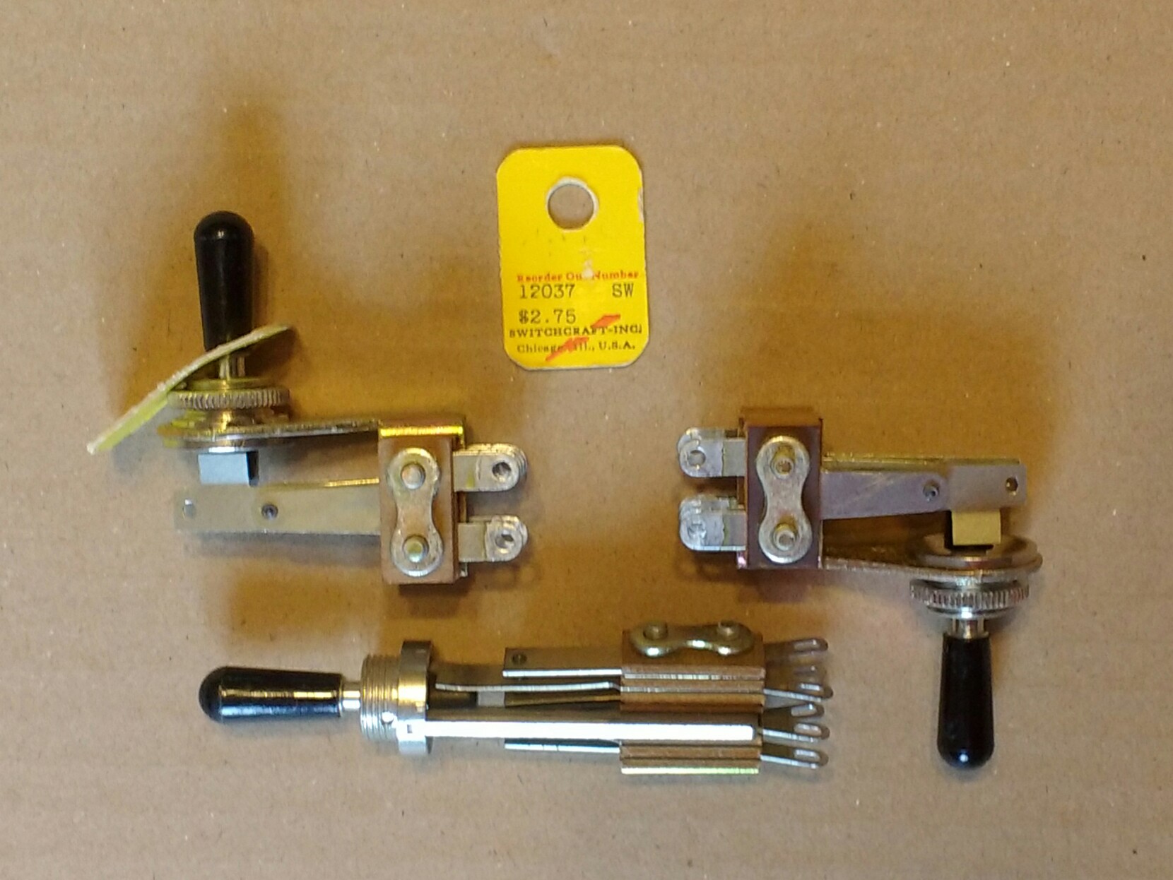

These are genuine 'Switchcraft' toggles though, not guitar switches. The long ones are really long which is why Orbit reed trannies were so deep!

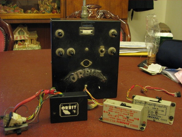

What is the size of the Orbit or RCS 10 channel reed transmitters? Also what is the position of the switches approximately?
Ta
Re: Guitar Switches

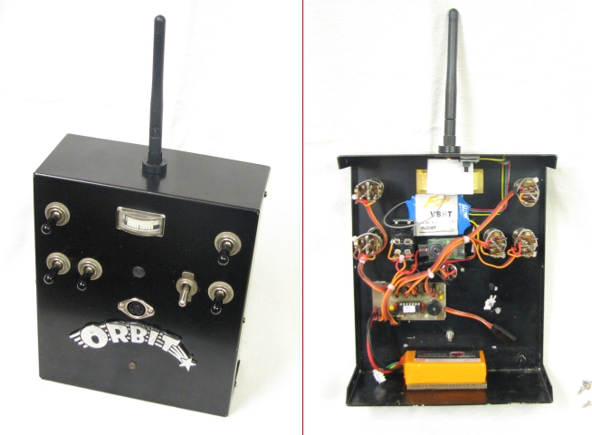

Postby Phil_G » Mon Aug 08, 2016 10:57 pm
My Orbit 10 is 193mm high, 165mm wide and 75mm deep.
Before the conversion:

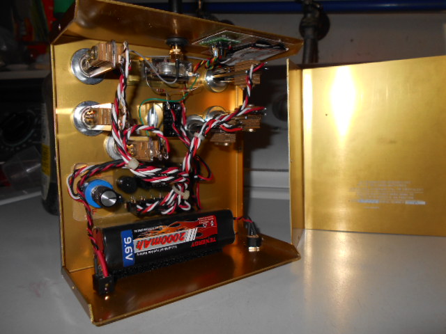

Postby jmendoza » Thu May 11, 2017 4:43 pm

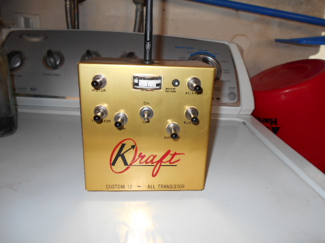

Here is a Kraft Custom 12 converted with a Phil_G reed emulator. We added some circuitry ( zener diode, 2 resistors) to drive the meter so it would read battery voltage, essentially making it an ESV. The old battery test button hole to the right of the meter was used to hold the status LED off the encoder such that one can do programming and settings without having to remove the rear cover. It works flawlessly , of course!
Thanks Phil,
Jay

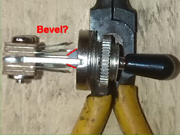

John I've just got a guitar toggle (just one, my fault, mis-read "3 way toggle" for "three toggles") and I've straightenend out the plates, rearranged them into "reeds" order but at full throw it sticks - I was wondering do you bevel the lever at all where it pushes on the spring contact?
Ta
Re: Guitar Switches
Postby Glyn » Thu Apr 03, 2014 6:59 pm
Hi Phil
I bevel my switches where you have marked them, I got this tip from PaulJ, it also helps to remove a bit of slop around neutral.
Glyn
Re: Guitar Switches
Postby Phil_G » Thu Apr 03, 2014 9:07 pm
Brilliant thanks Glyn
I was just thinking I should ask before I permanently file it away.... :D

Postby singlechannelman » Thu Apr 03, 2014 10:26 pm
Hi Phil,
On mine I just pulled the tube a little lower on the operating lever that cured it.
John.
Re: Guitar Switches
Postby Phil_G » Fri Apr 04, 2014 1:04 am
Ah I didnt realise you could do that John!

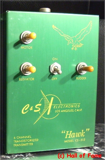

Got a lovely new die-cast case from CPC, having seen René's C&S 10, I'm going to try to replicate this:

Re: Guitar Switches
Postby singlechannelman » Fri Apr 04, 2014 9:01 am
That looks nice Phil I also like the green reed transmitter in Franks post from Germany.

Postby Phil_G » Sat Apr 05, 2014 12:09 am
Followed Glyn's advice, filed a small bevel just like in the photo above - perfect!
Thanks chaps

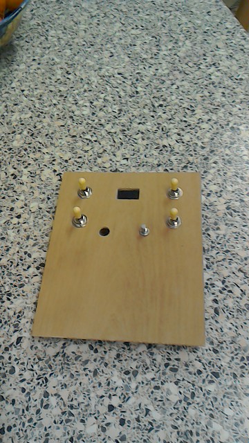

I have made two boxes
1 - a 3D printed Ariel box (stl files from here)
2 - I have also bent some thin aluminium to make a face / top bottom - I'll 3d print some sides (and a back) - I had a Hozixon 2 ch set that did this
I'll see which I prefer on the day

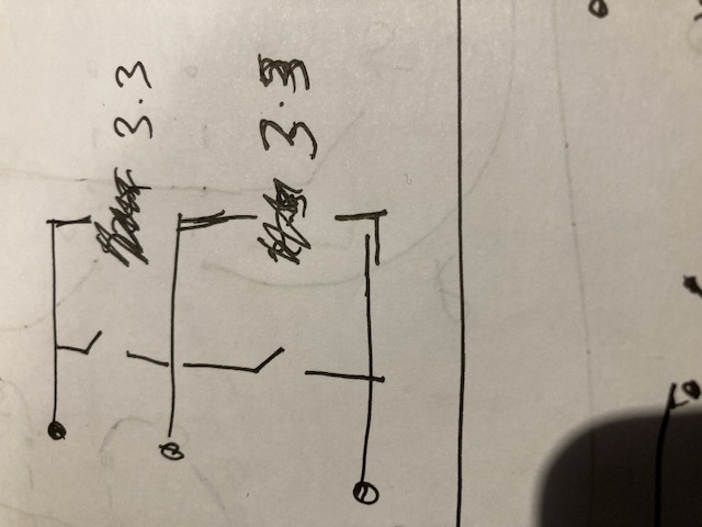

Out of interest this is what I was going to try - would it have worked?
Re: Guitar switches as reeds toggles
Yes, I think so - providing whatever the 'signal' from the switches connects to doesn't mind being joined directly to one of the supply (to the 'pot') rails. The version I posted with the four resistors more closely simulates what a normal stick pot would do. The sticks don't normally travel right to the ends of the pot tracks so there is always some resistance on both sides of the signal.
If you still have the original pots, and stick units, you could temporarily put, say, 5V across the two outer pins of the pot, and measure the voltage with a voltmeter from ground to the wiper when you move the stick over its full range. You'd expect it to be about 2.5V in the middle, but if it only swings from, say, 1.25V up to 3.75V with full movement, then you know it's only using roughly half of the full pot travel. Then the diagram I posted with four equal resistors would be closer to simulating that full movement range using the guitar switch.
If you want to get fancy, you could use three trim pots wired to the guitar switches instead of fixed resistors: then, by tweaking the pots, you'd have individual control over 'left position', 'right position', plus a 'centre trim' adjust! :geek:
