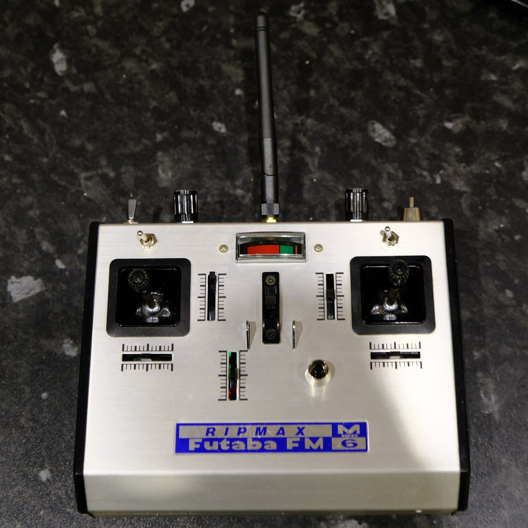

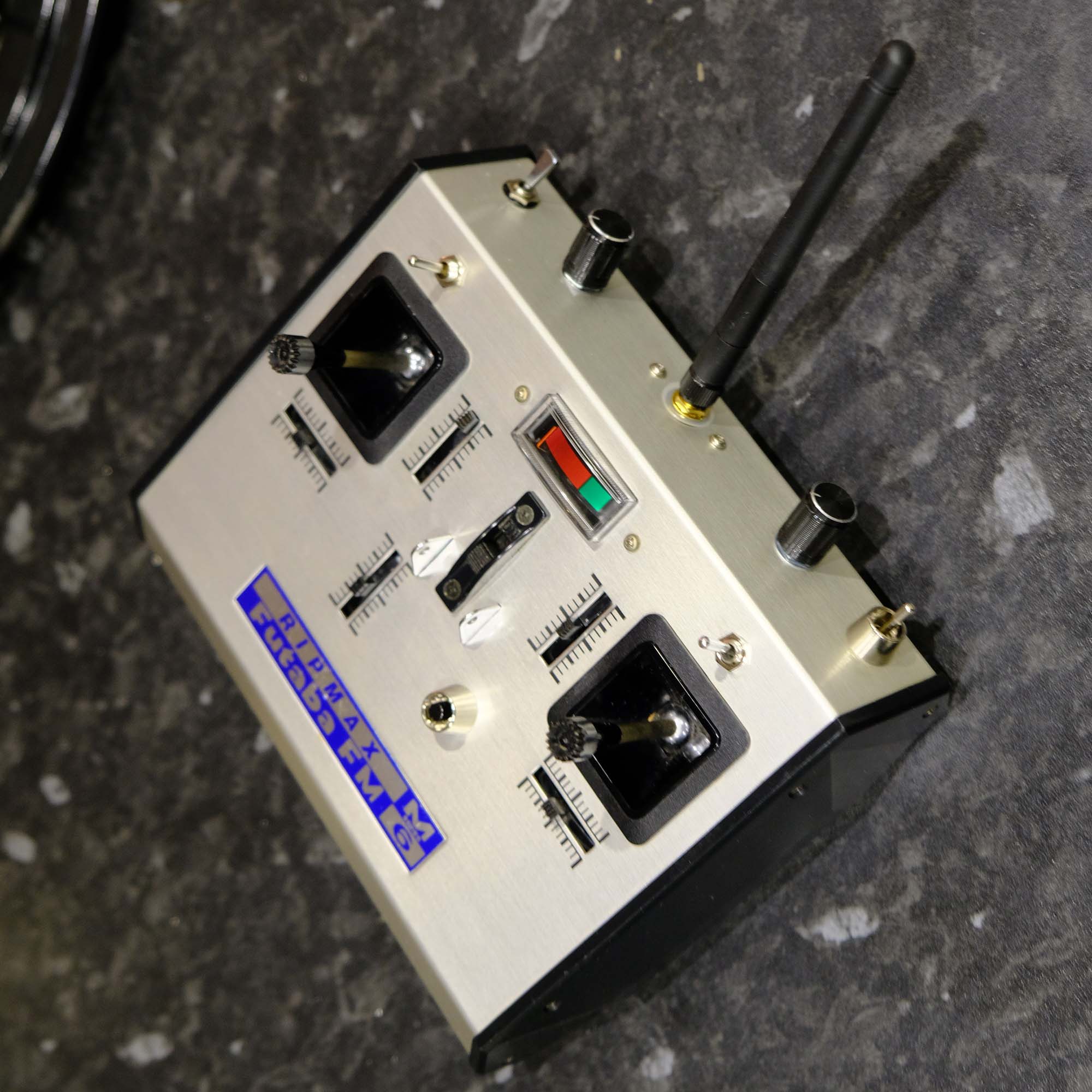

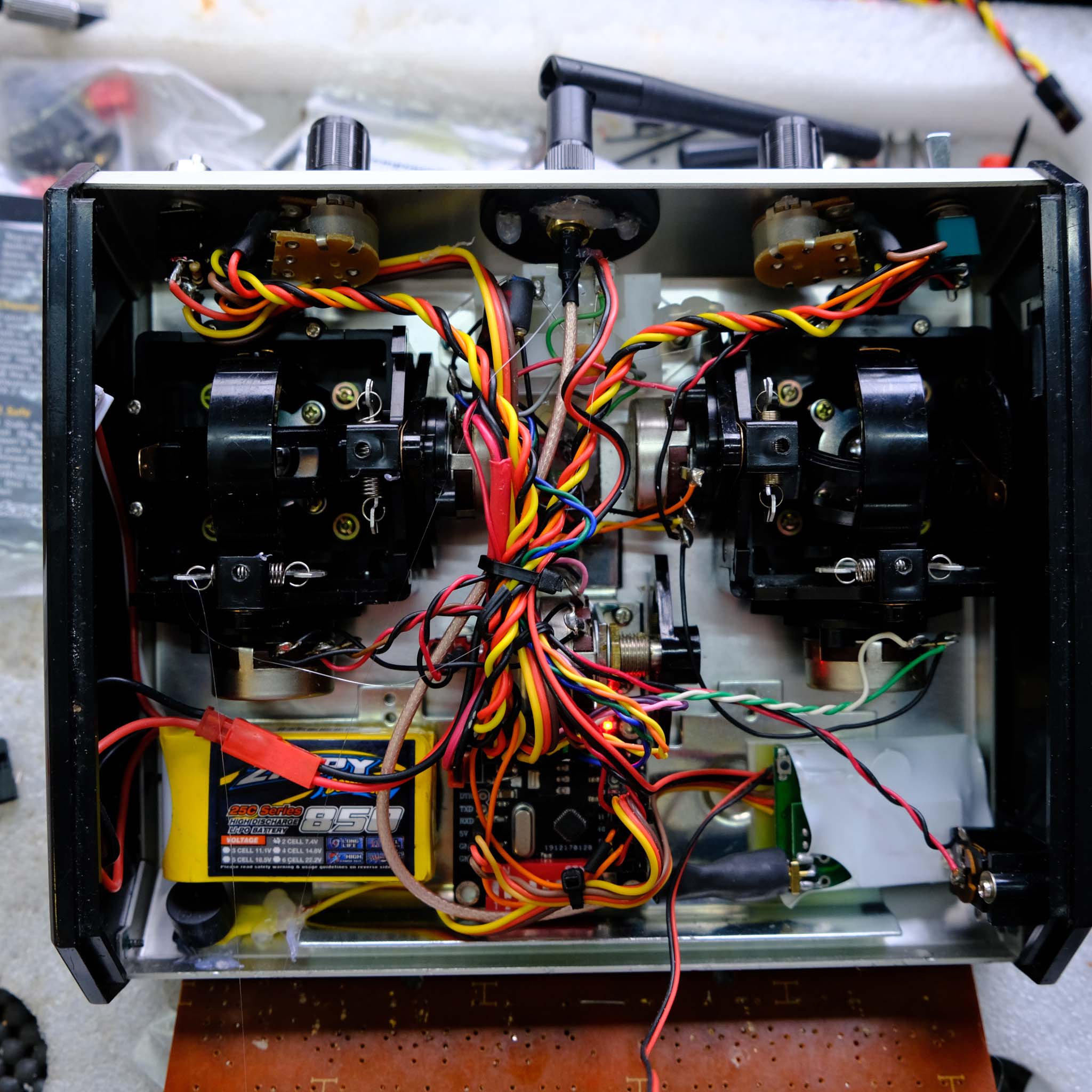

Found this lovely condition 35 MHz FM M6 this week, so using the original stick wiring, have installed an F3A encoder and an extra switch for a ch7.
RF module is the new Lemon DSMP.
Another one saved from Landfill!
Futaba M6, F3A encoder, Lemon DSMP

Nice clean lines on the front panel , lovely conversion Stuart , what type of LiPo have you used ? In this build .
Posts: 596
Re: Late Futaba 35 Meg M6 now on 2.4 with F3A Module
Thanks Rob, This one uses a 2S 850 maH Zippy LiPo
