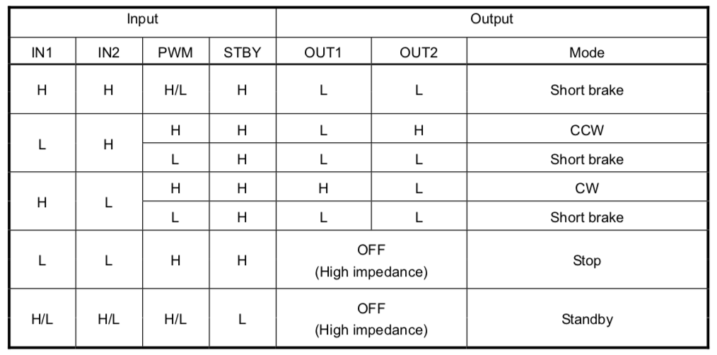

Hi Mike,Mike_K wrote: 11 May 2021, 00:09 the Pololu TB6612FNG can drive two motors, can forward, reverse, brake and freewheel them, has a continuous current rating of 1.0A and a peak current ratings of 3.0A, so would be a lot more robust in your application.
Some further mishaps have occurred, not directly related to the Arduino, but I have been studying your suggested alternative, the Pololu TB6612FNG.
https://www.pololu.com/file/0J86/TB6612FNG.pdf
Clearly, it requires changes to the code, basically it is 2 inputs per motor setting the rotation direction or stop, and a PWM input to regulate the speed.
Looking at the datasheet, this is the truth table: What puzzles me is that, every time the PWM goes low, the outputs go into "short brake" mode. But should that not be the freewheeling mode? But to get that you would have to manipulate the inputs together with the PWM, so is this necessary? Note that the PWM port is pulled low by an integrated 200 kOhm resistor.
Then there is a note "To prevent penetrating current, dead time t2 and t4 is provided in switching to each mode in the IC". I take it that is incorporated in the IC, right?
Then there is another note saying:
"If your design includes an inductive load such as a motor coil, incorporate a protection circuit into the design to prevent device malfunction or breakdown caused by the current resulting from the inrush current at power ON or the negative current resulting from the back electromotive force at power OFF. IC breakdown may cause injury, smoke or ignition.
Use a stable power supply with ICs with built-in protection functions. If the power supply is unstable, the protection function may not operate, causing IC breakdown. IC breakdown may cause injury, smoke or ignition."
If the stalling current of the motor is below the continuous rating, and I am preventing a sudden reversal (see my previous post), do you think any additional protection should be provided?
Max.
