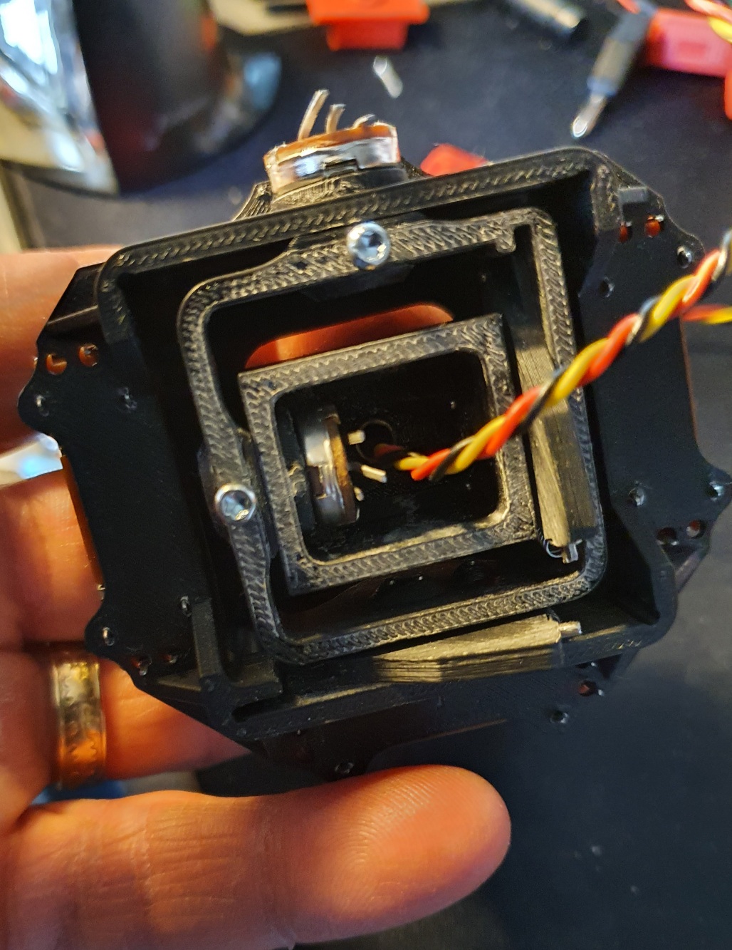

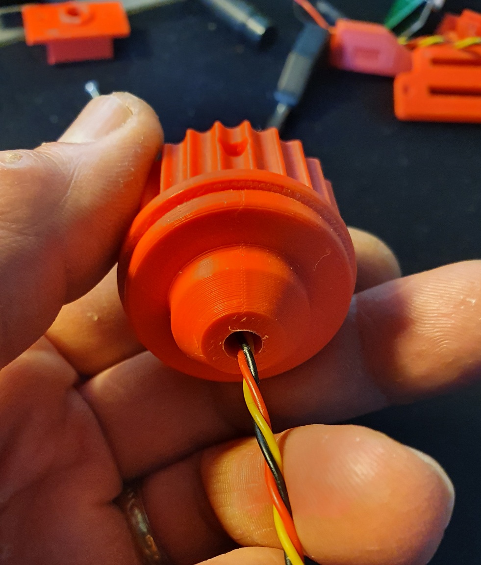

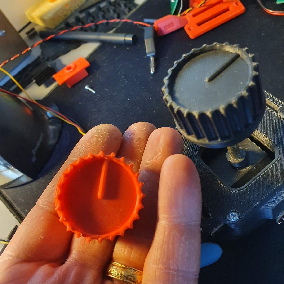

Pete, hope to find you and all your beloved well.
Let me know if I can be of any assistance, if, I can resize the shaft of my knob to fit most diameters. Just PM me
If, also, I would be happy to supply you with a full "Single stick", the knob is on the large side but not larger than the old Kraft knob.

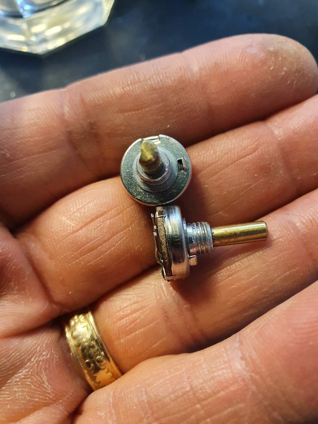

The pot I'm using are close to the "cermets" size

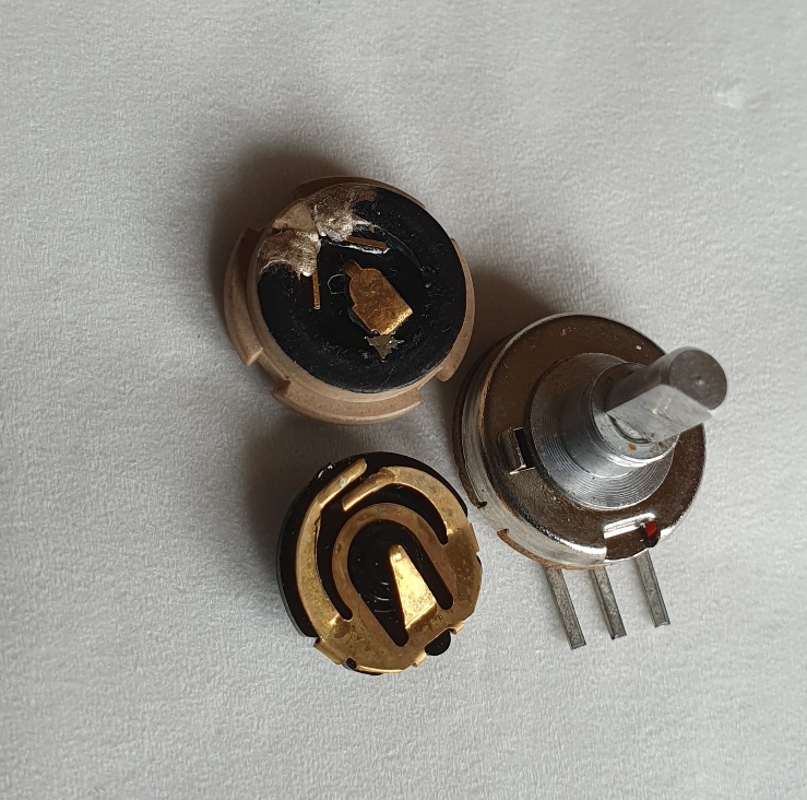

....I might have a few cermets pots or at least "ceramic" parts in my spare Kraft box and probably some wiper also! If, how many would you need?
The pots i use in my sticks have a shaft of 3.5 mm.

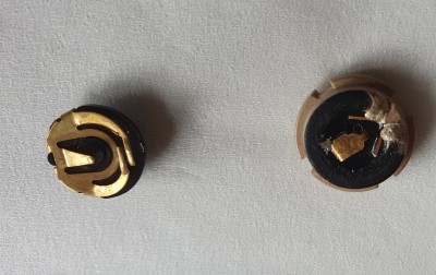

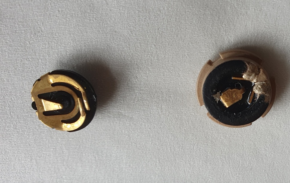

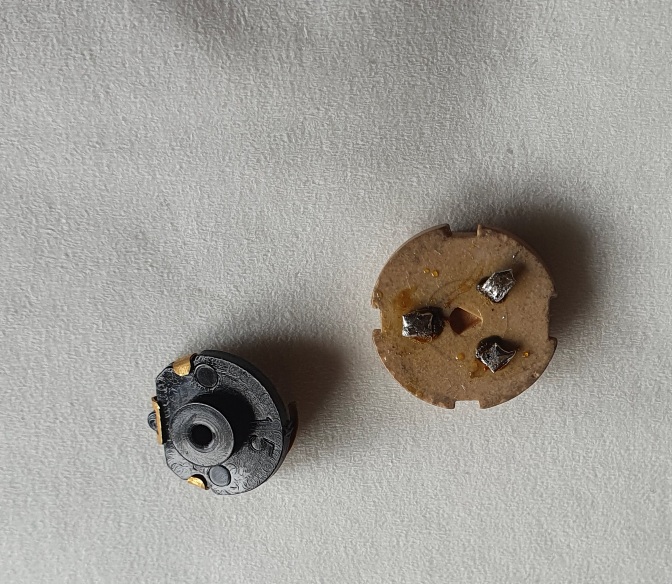

There was also a later version of the wiper with bi-furcated "fingers" so that there were in fact 4 wiper "fingers" in contact with the pot's resistive surface - I don't recall if they were sold under Cermet, D&R or Dunham brand, but I purchased all of mine through ACE R/C. Regardless, they fitted the standard wiper carrier and worked well on cermet pots
