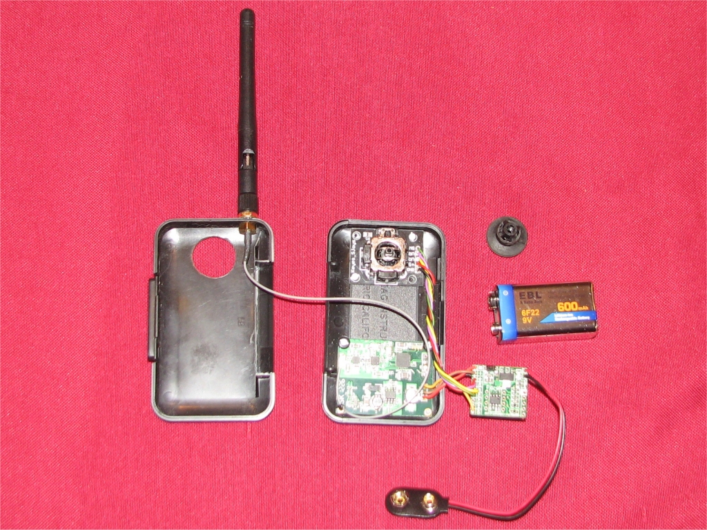

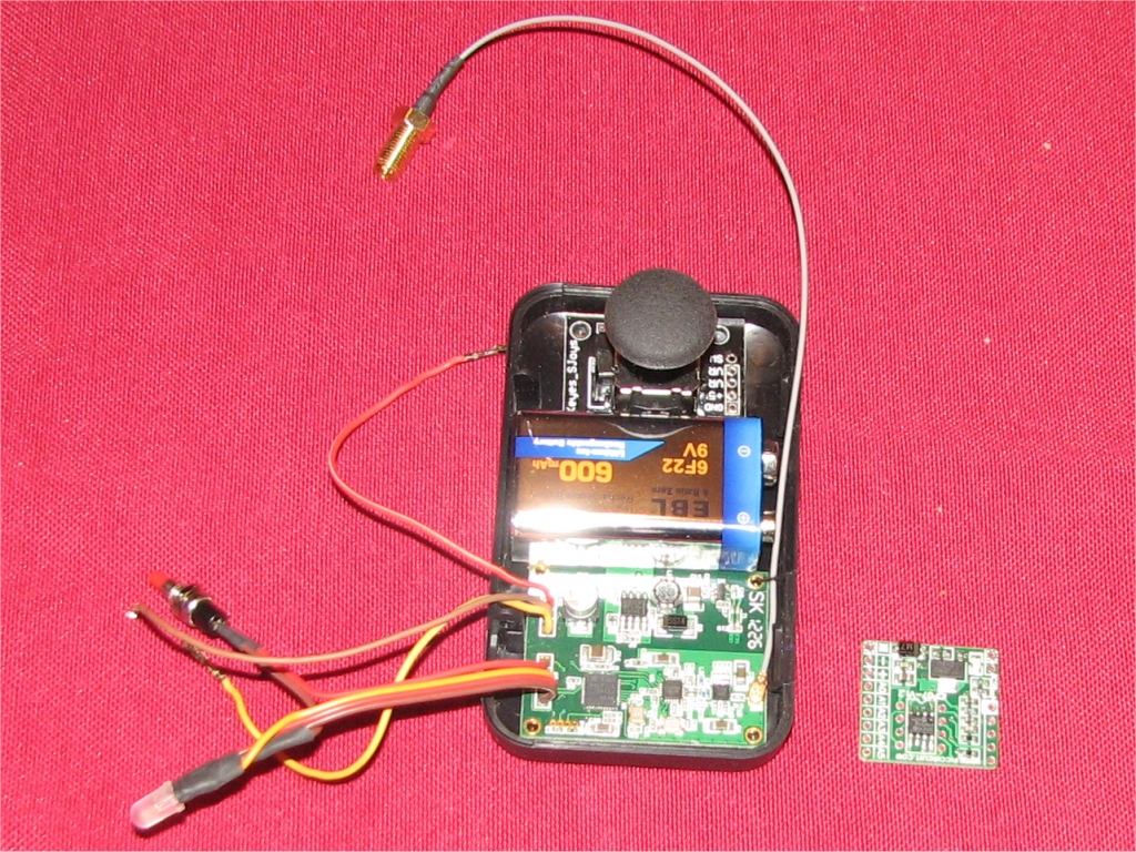

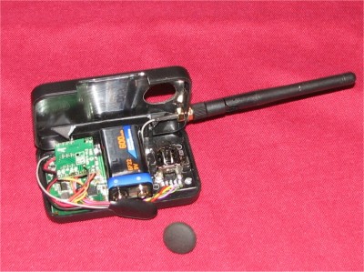

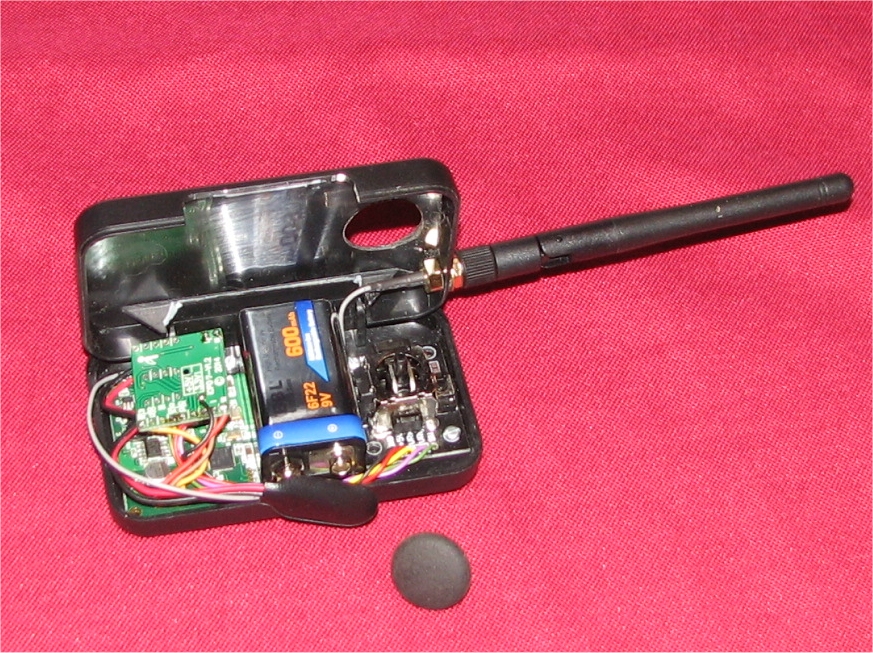

These are 2S 8.4v lithiums in a convenient PP3 format and optionally come with a charger. It doesnt balance charge, balancing is done internally inside the battery, so there are just the two standard PP3 terminals. I first used them in my OS Pixie thread, and also in the micro 2ch "one evening" project. I've tested them and they deliver the full 600mAh claimed, they're great little batteries for small domestic stuff as well as for trannies.
