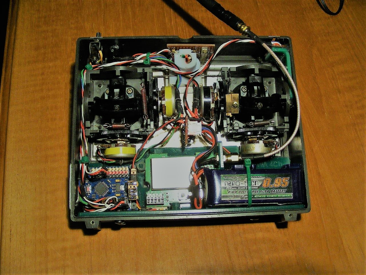

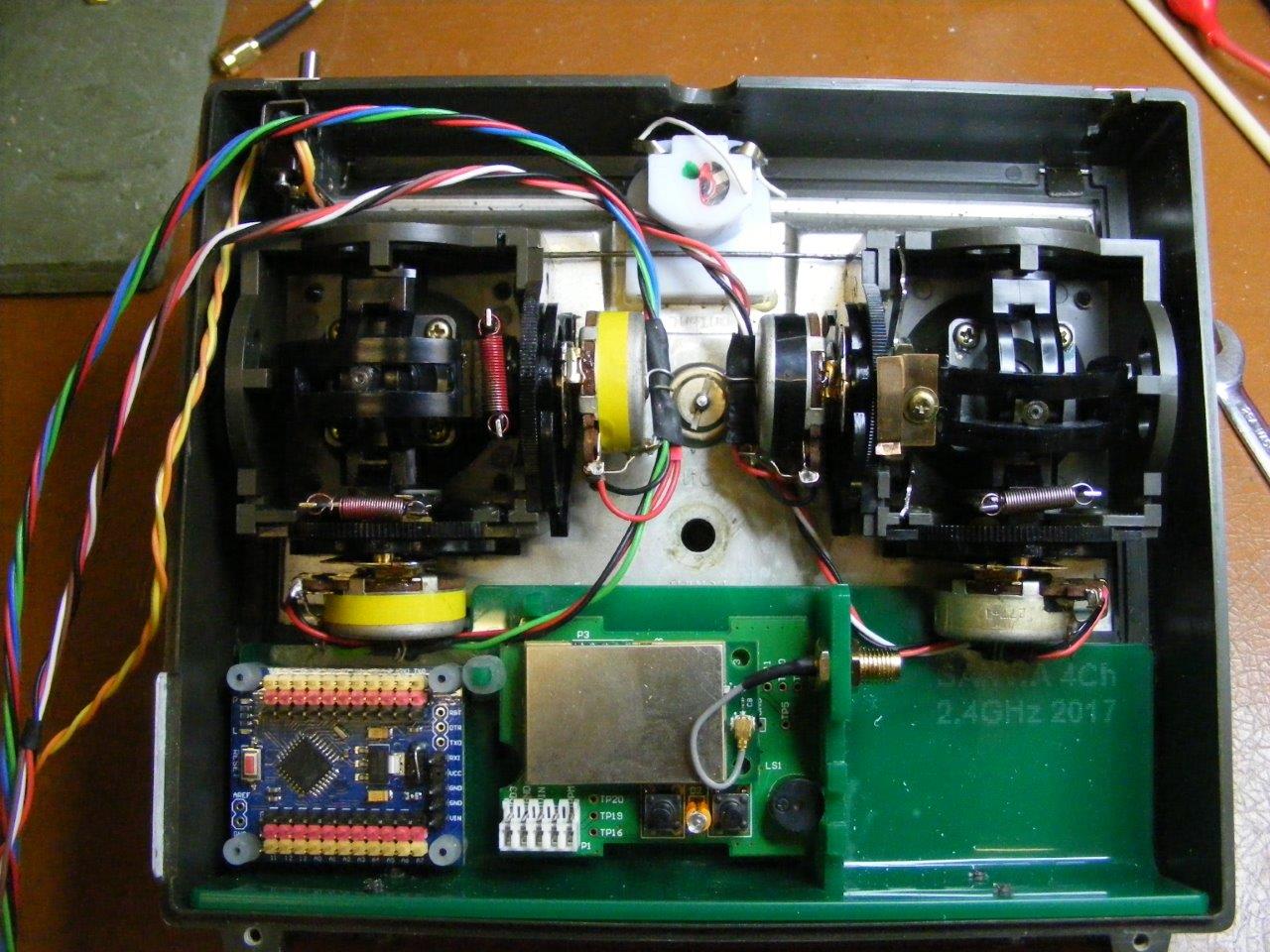

Not often seen but one of these fell into my hands last year. Converted using orange (Fut) module and one of Phil's Propo + s/c coders. The case is quite small so it was all a bit of a squeeze.
Coder with uncased module installed

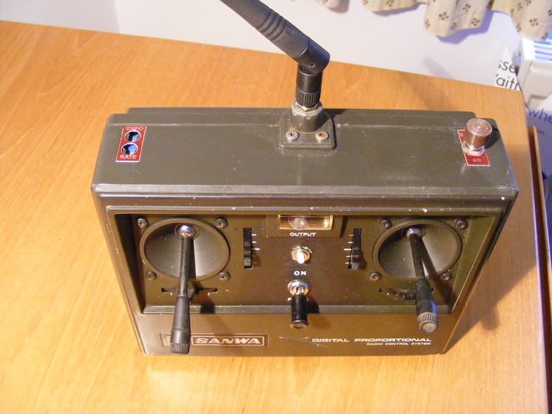

Completed installation
Bind button where the neckstrap mount was.  Expo and Rates trimpots top left, S/C button top right, using original AUX positions.
Bind LED shines through the base of the original voltmeter.
Flown a couple of times in 2017. Roll on the 2018 season.
