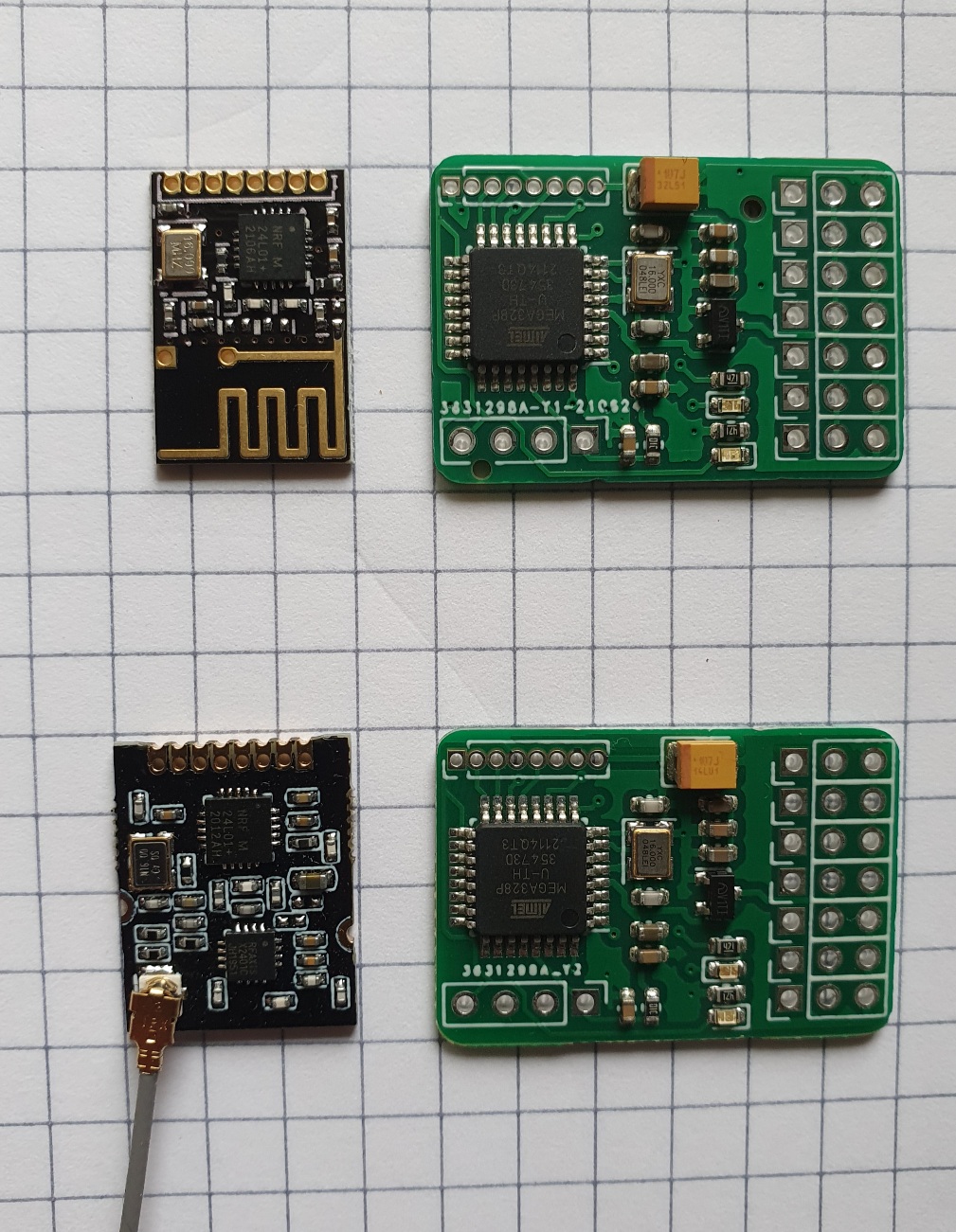

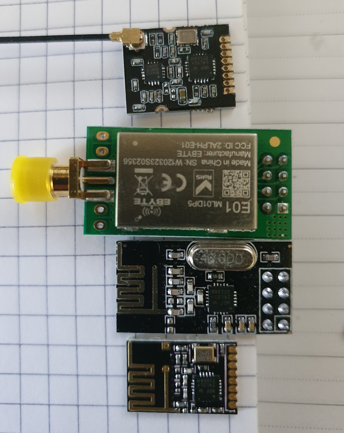

As most of you might have noticed the nRF2401+ modules comes in all shape and layouts. Please notice that the 1.27mm pin headers have different pin outs between the boards.
With this in hand....

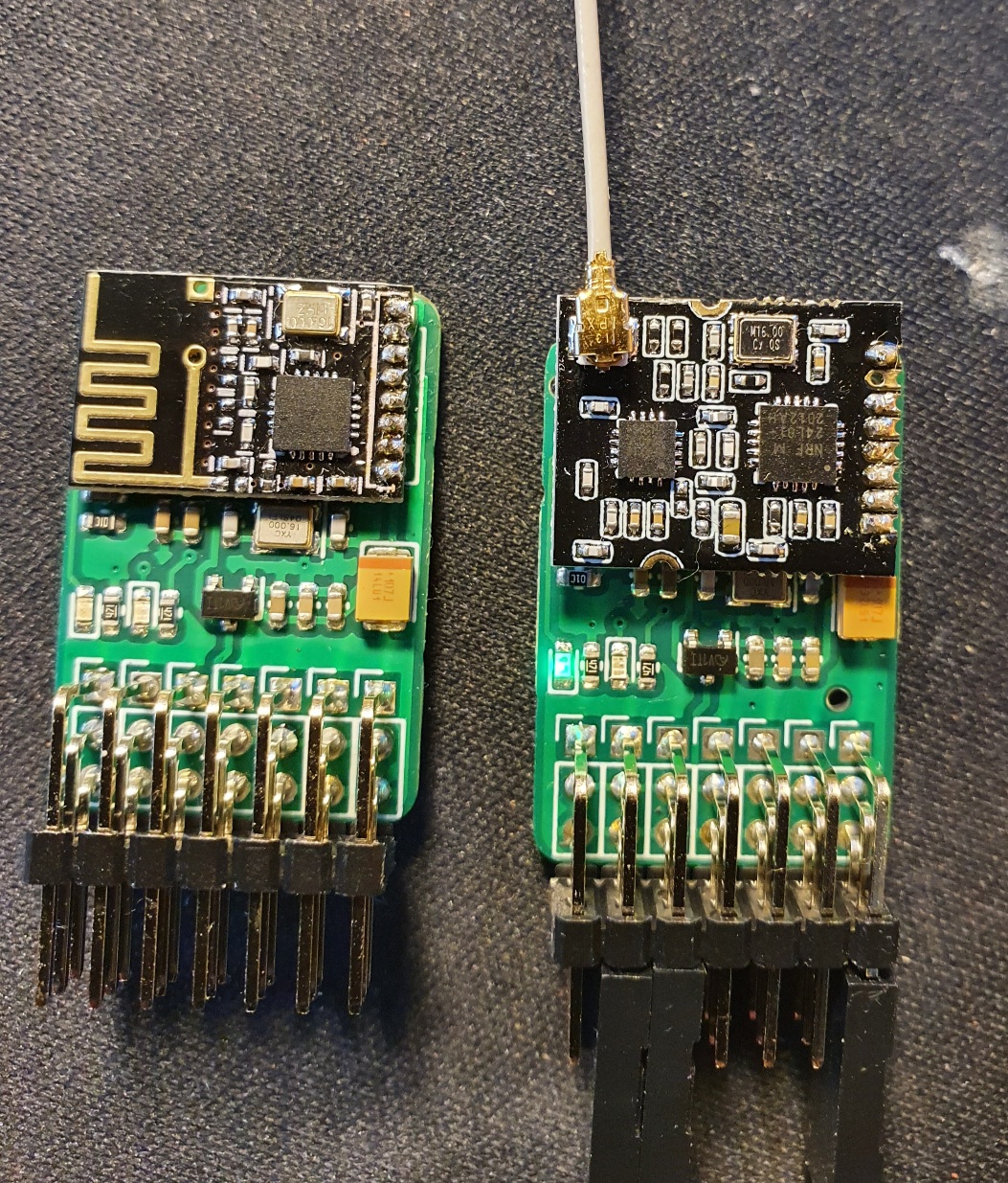

Here is what I use in my Rx, the one w/o antenna whip is for pure small models and I consider it a low range/ park flier Rx as the antenna could be shielded by the main PCB but in trials I haven't seen any issues despite all my attempts.
The one with the antenna whip, nRF24 + PA, has been test flown in a .60 size model.
The Rx PCB size is 30mm x 20mm and is actually 6 channels.

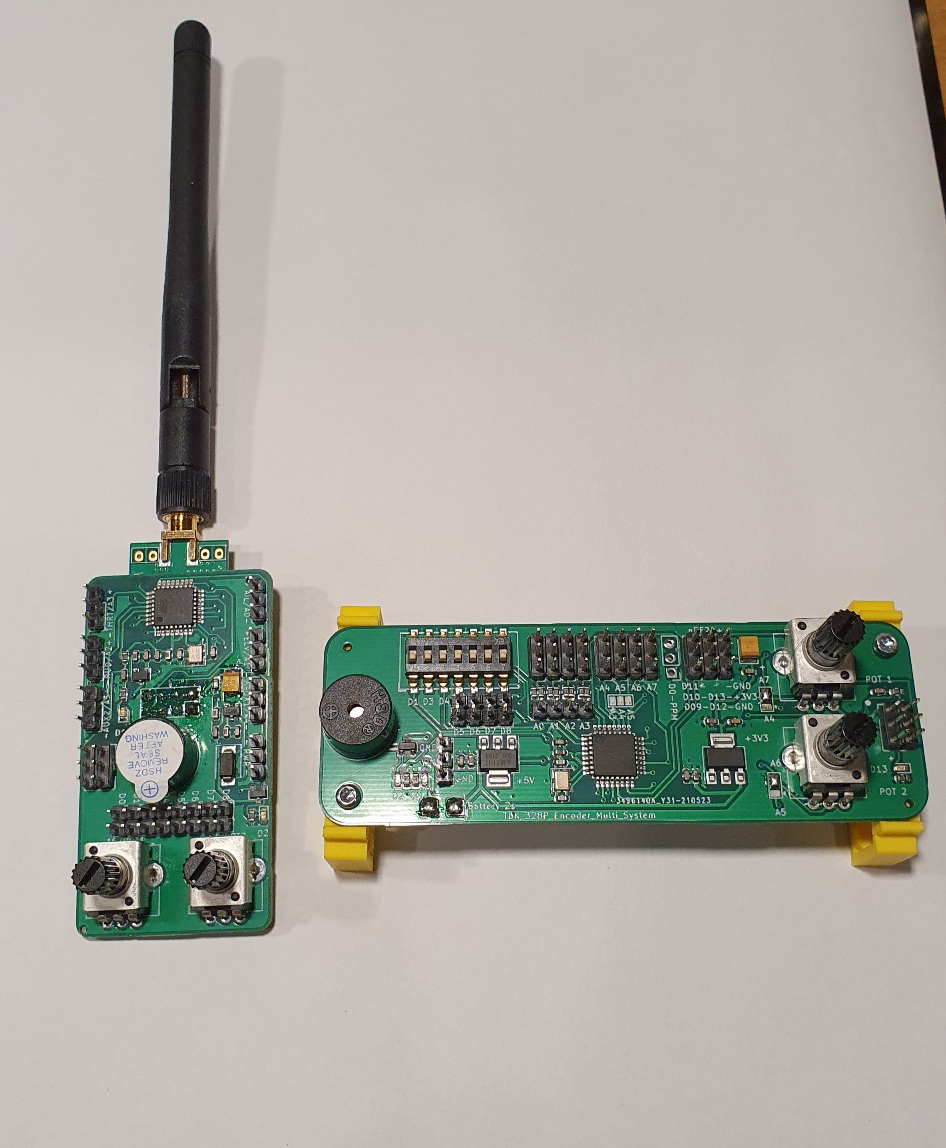

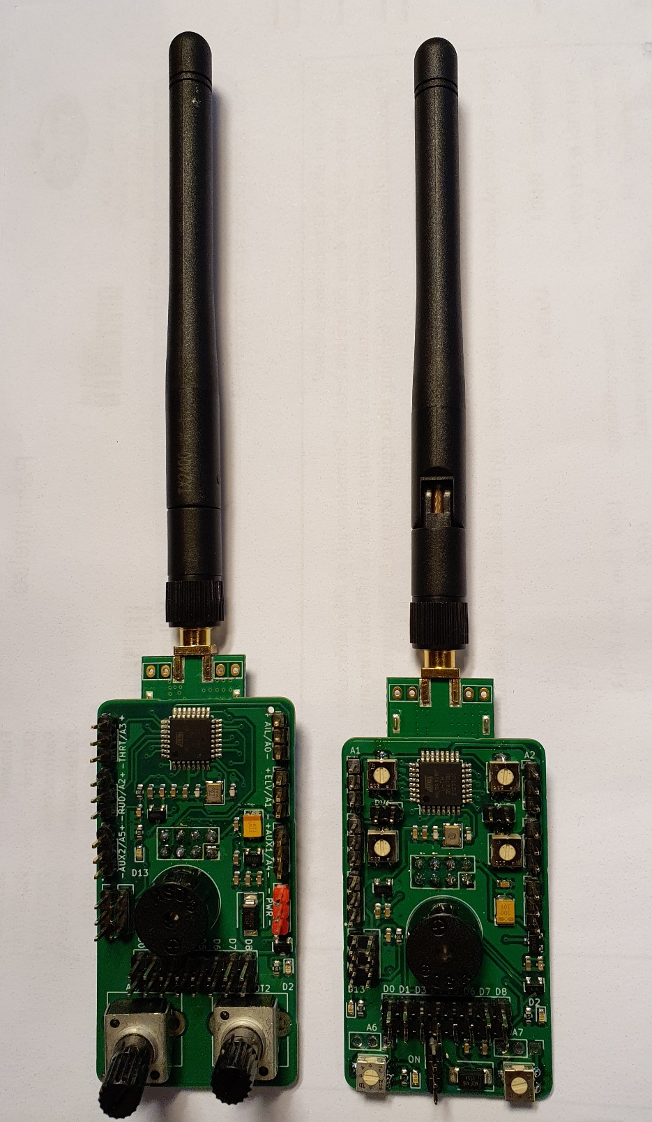

I'm back, I sure hope you haven't missed me.
In the meantime for whatever reason I found som spare time which open up for the little grey cells to exercise...

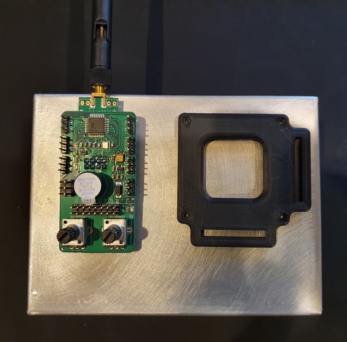

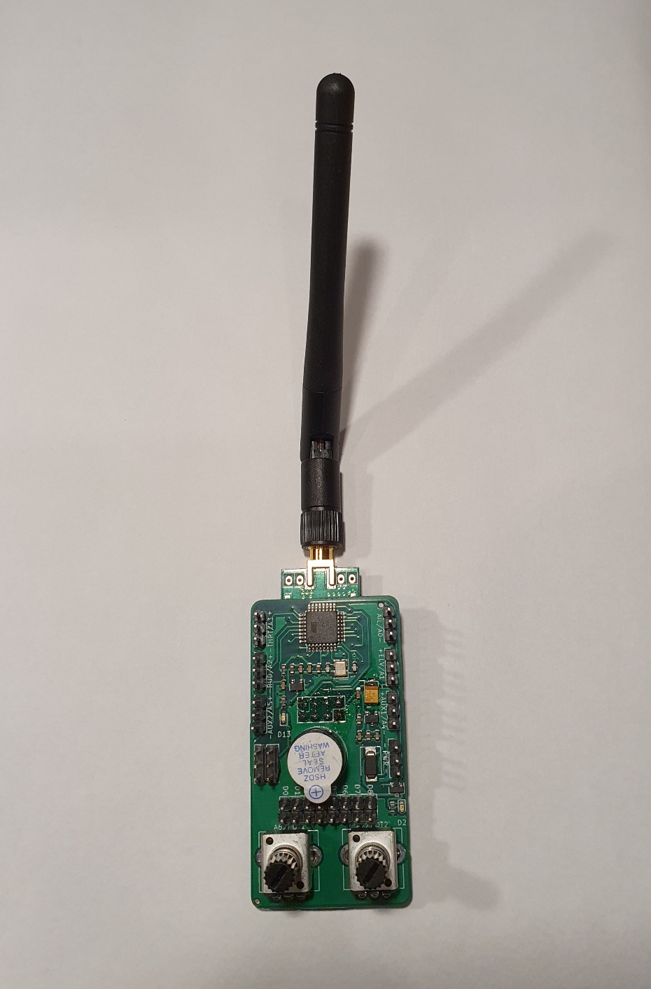

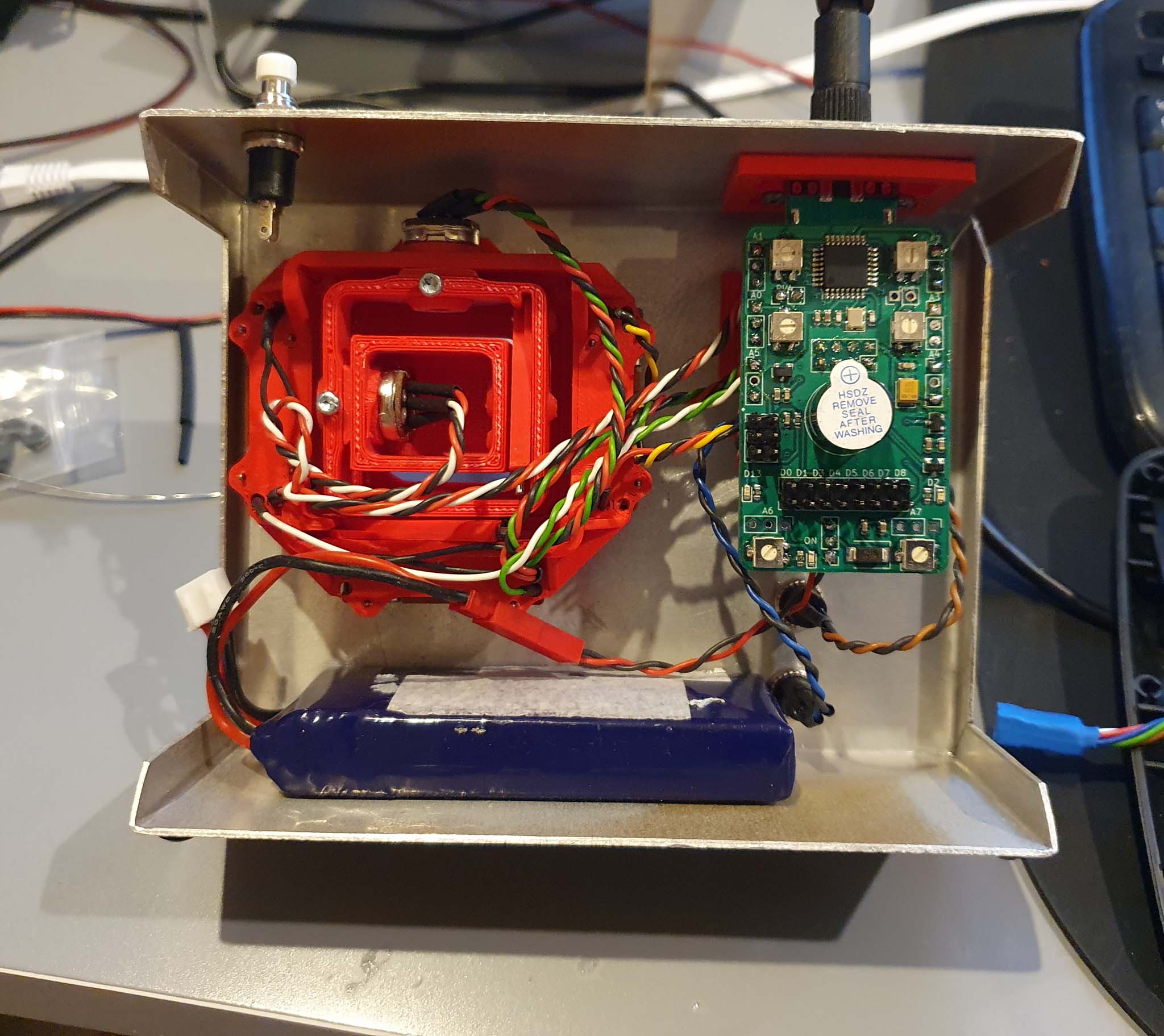

So what have I done...I have let my nRF24L01 encoder evolve and this fell out.
I just received a few boards today so after some more testing and if I see the results I hope in I might think to make some more and have them available in a package together with a Rx or 2 at a very sensitive price.

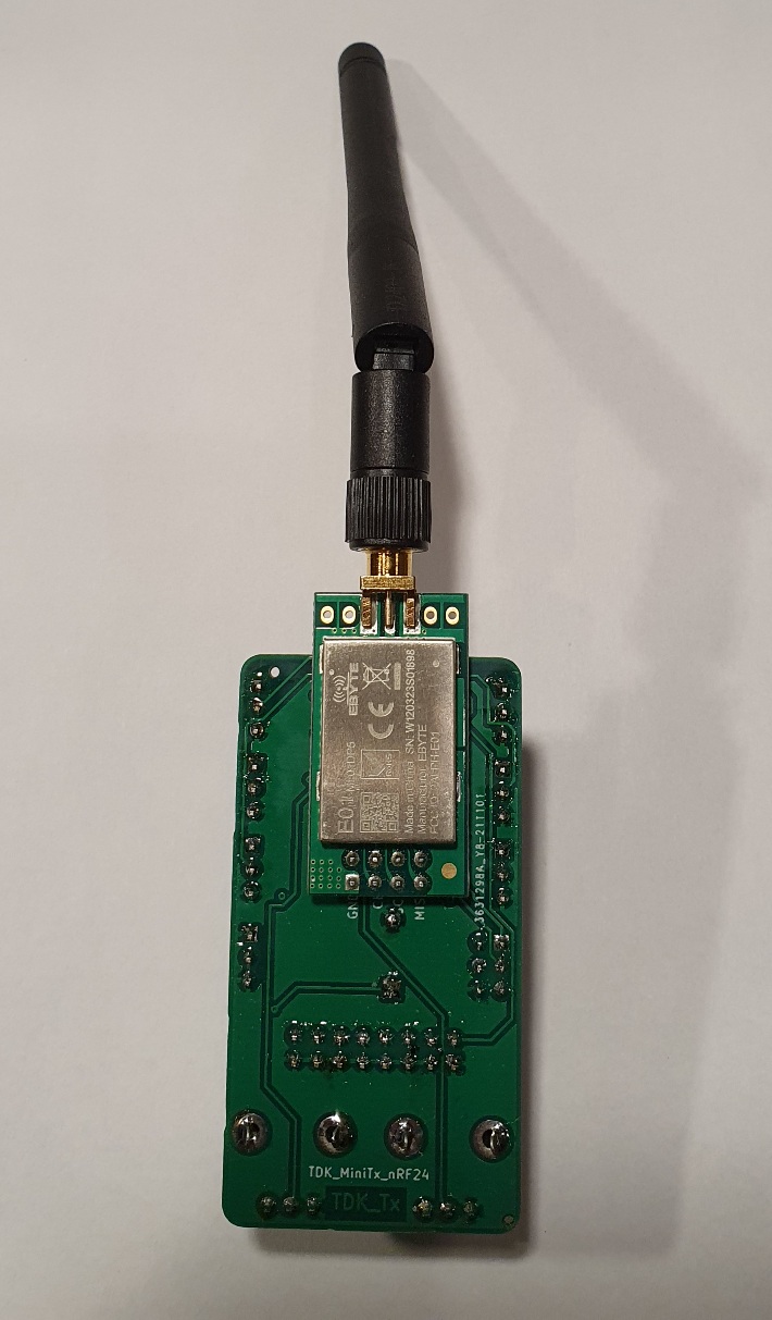

My earlier encoder is now mated with the NRF24L01 as piggyback so it's now a "single unit" It's a quite compact board, intended to be mounted just by the antenna holder and in most transmitter it would fit in the middle between the 2 sticks.
This is a 6 channel unit.
One feature , good or bad, is that the stick connectors have the signal in the middle which means that to reverse the pot it's enough to turn the plug 180 deg and re-calibrate.
"" + Ax - ""
The Dip-switch is replaced by pin headers where the top row is signal and the bottom ground so for most features it's jus enough with a jumper
...and yes the buzzer is still there.
What attracts me in some means w/o considering my time spent on the project I have now a complete Tx module/encoder and a couple of full range Rx at a sensitive cost and a lot of fun!

Hey Tobe,
Looks like a clever evolution of your encoder board.
I especially like:
- the simple reversing of the stick pots by changing the connectors to have the signal in the middle, and
- the integrated RF and encoder boards so you can mount both via the antennae base
I think both are practical features. Well done yet again
I'm definitely in for 3 or 4 (to start with
) when you are ready.

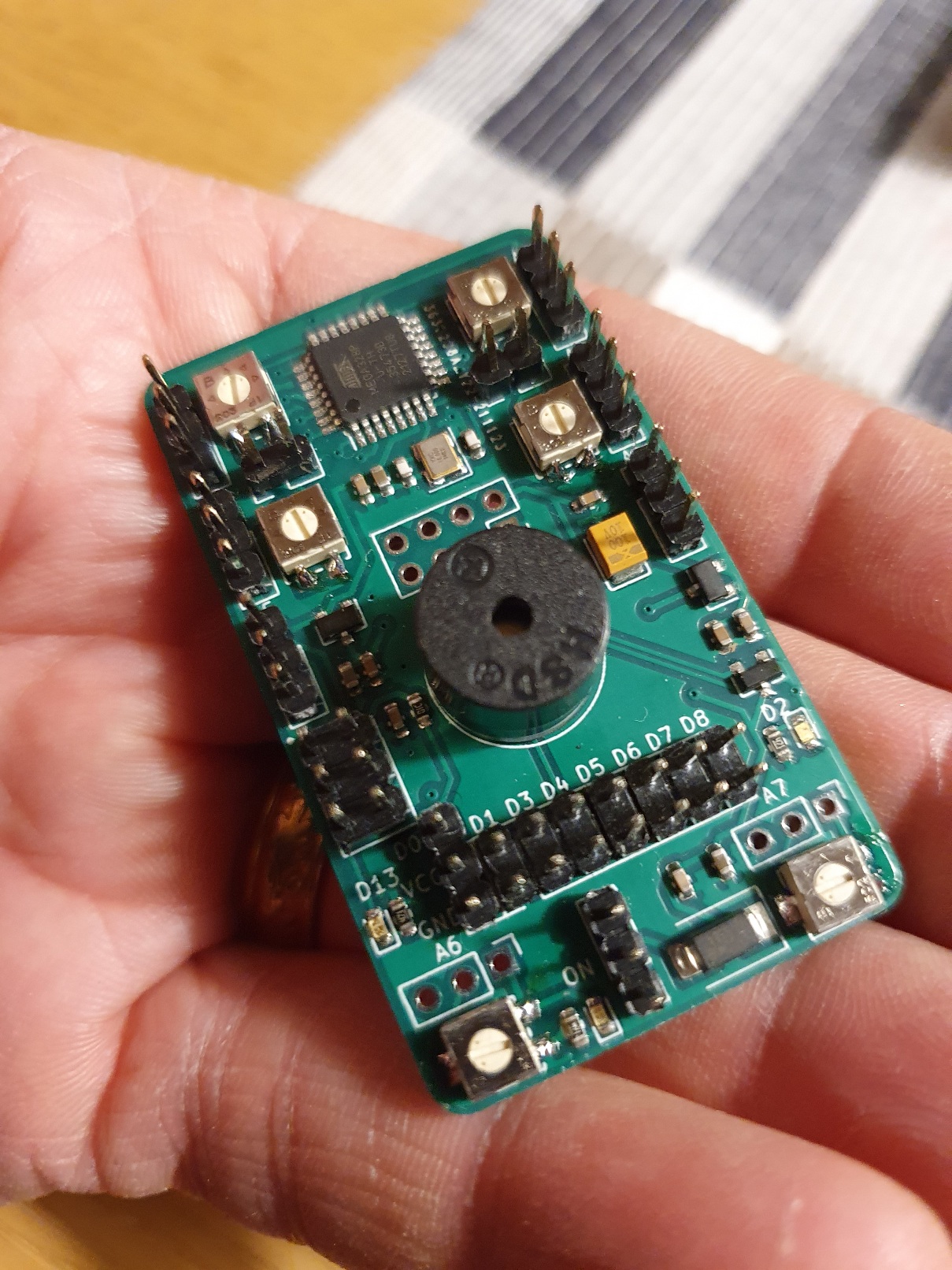

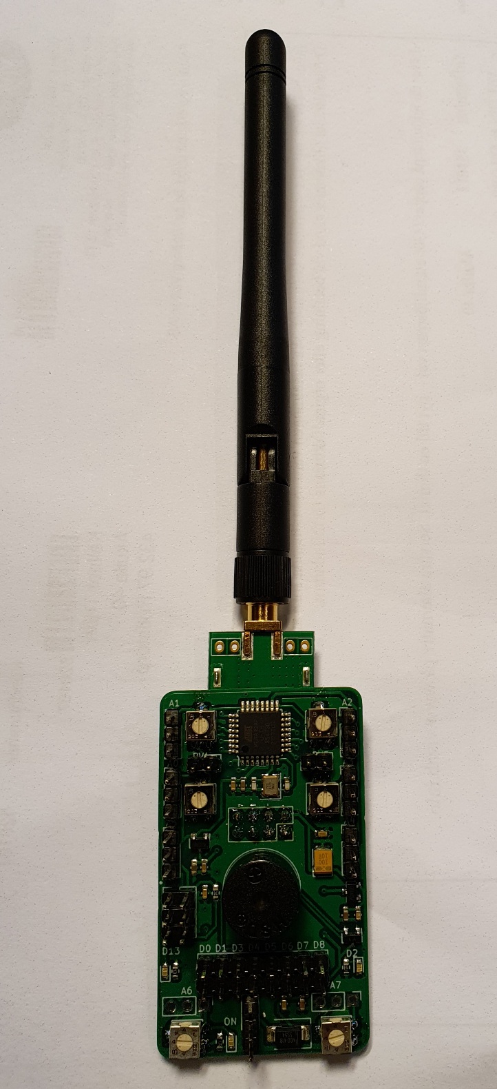

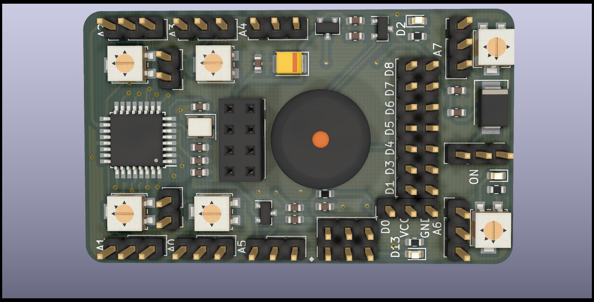

Here is a preview from KiCad in how I intend it after some more tests on my Beta version.
Channel 1-4 will have a trim pot each to set electrical trims if necessary.
Rates/Expo will be have the option to be set on the 2 lower trim pots alternative are external pots via the 2 pin headers.
D0 has VCC % GND to allow the connection of a regular RF-module if nRF2401+ is not used.
D1....D8 can be set just with a jumper alternative is an external push button or toggle switch.
Size is 56 mmx33 mm, nRF2401+ shielded module fits piggy back on the back as in the pictures of Beta

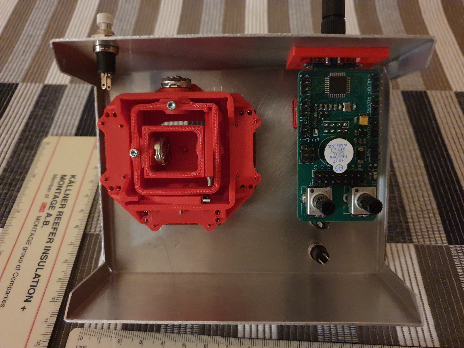

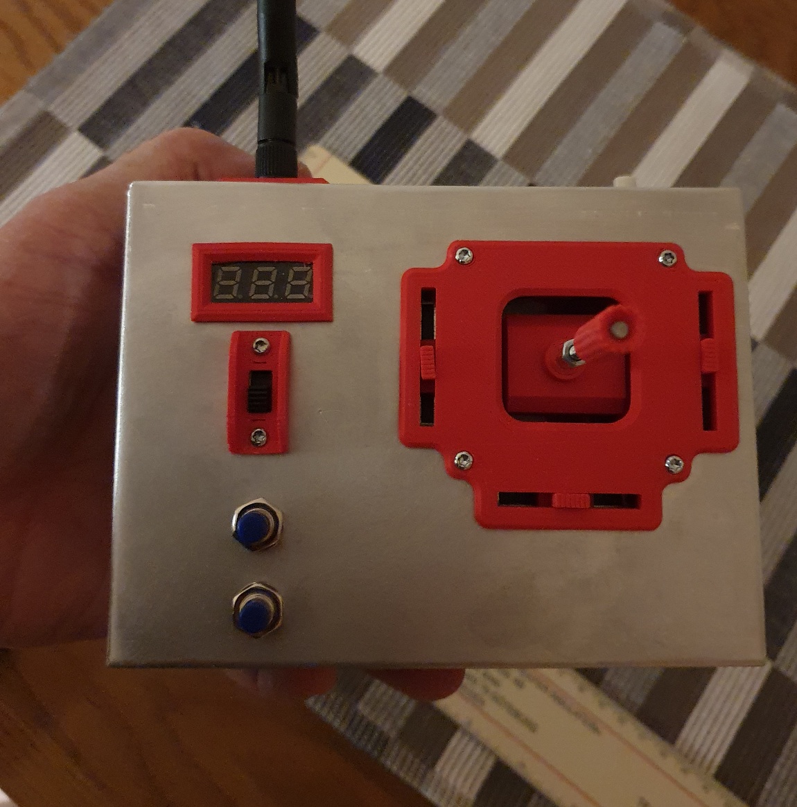

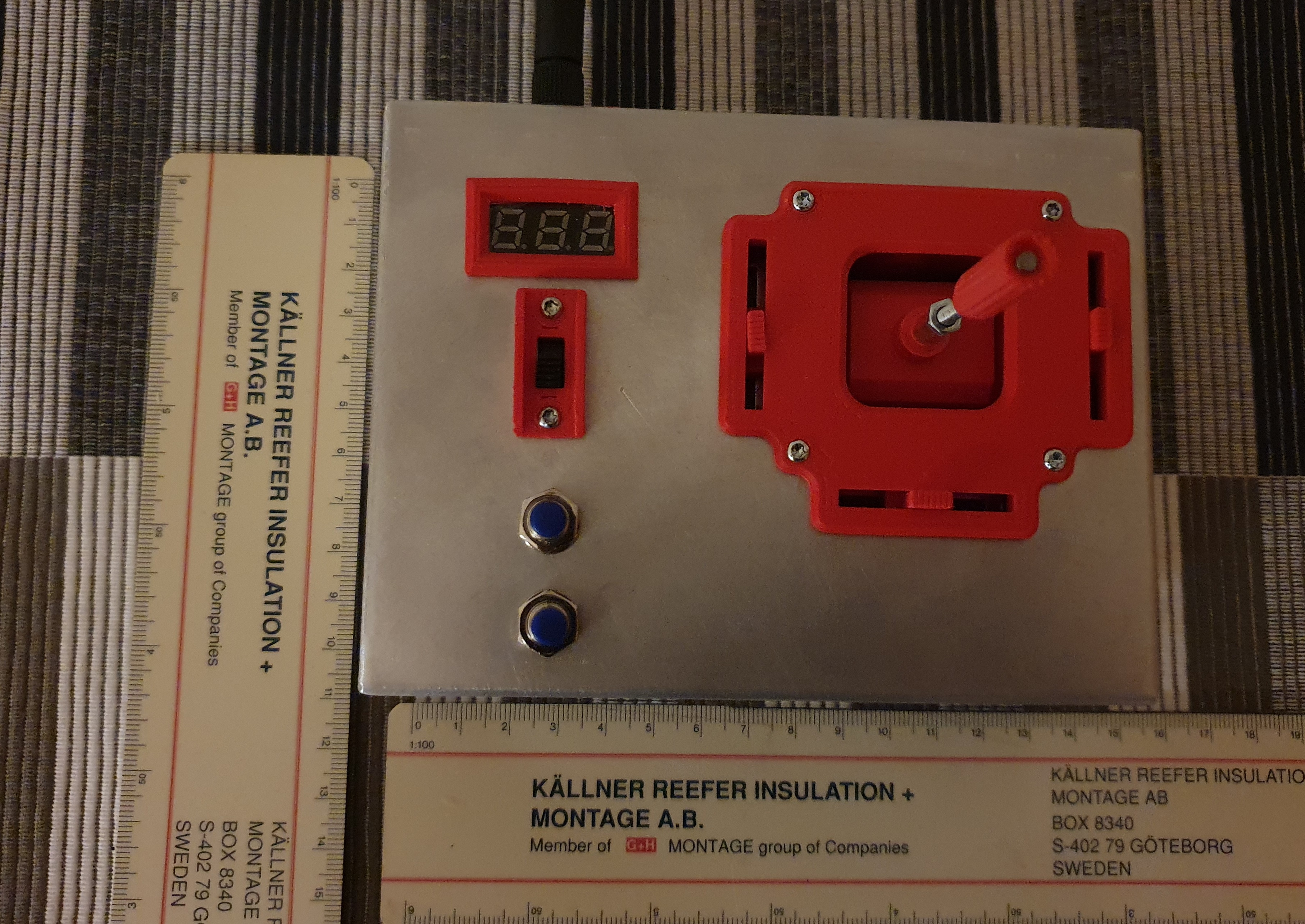

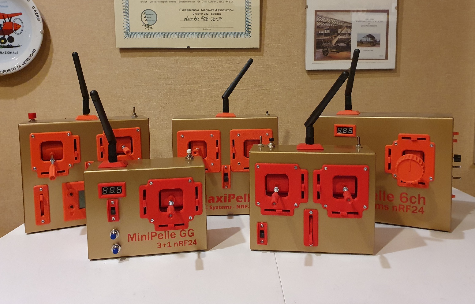

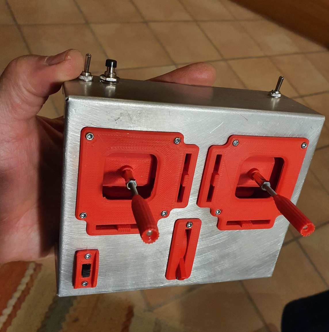

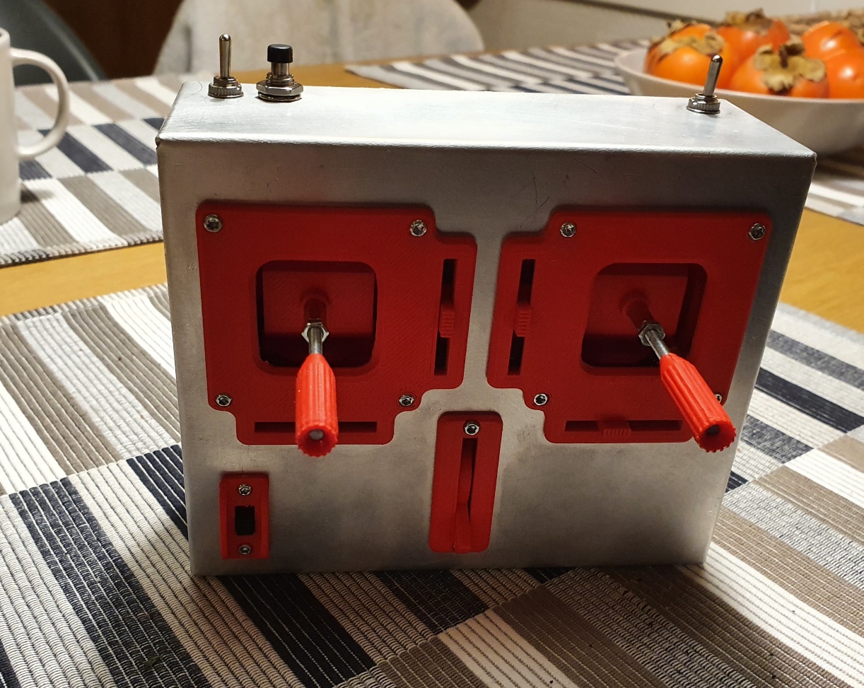

Here comes a peak to my new GG-Tx project where size matters!
5"x4"x2"
5"x4"x2"
Re: Tobe's nRF2401+ Rx
Tobe,Tobe wrote: 14 Nov 2021, 15:35 Here comes a peak to my new GG-Tx project where size matters!
5"x4"x2"
You've pre-empted the need I have for 2 GG Tx's that I've been holding off on. One is a conversion, the other a scratch build. I'll be watching this variant closely
- Posts: 714

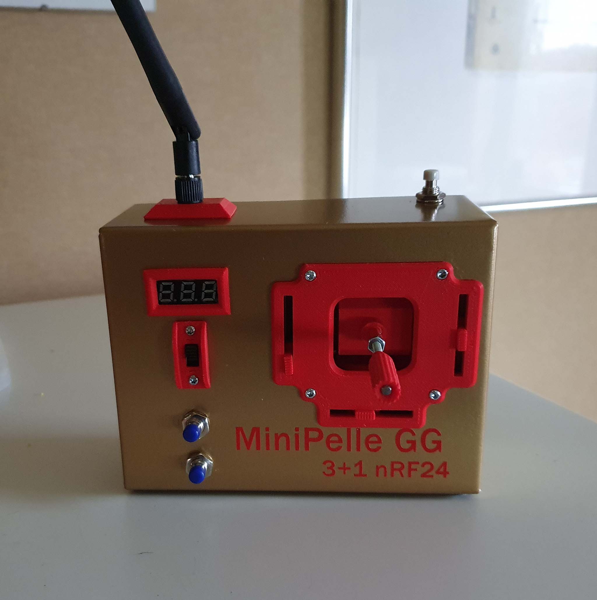

For you Wayne!
Paint job is awaiting...golden case and instead of MaxiPelle I might go for MiniPelle with a sticker on the back saying "When I grow up I want to be a MaxiPelle "
It has all feature as in the MaxiPelle 3+1 nRF24
