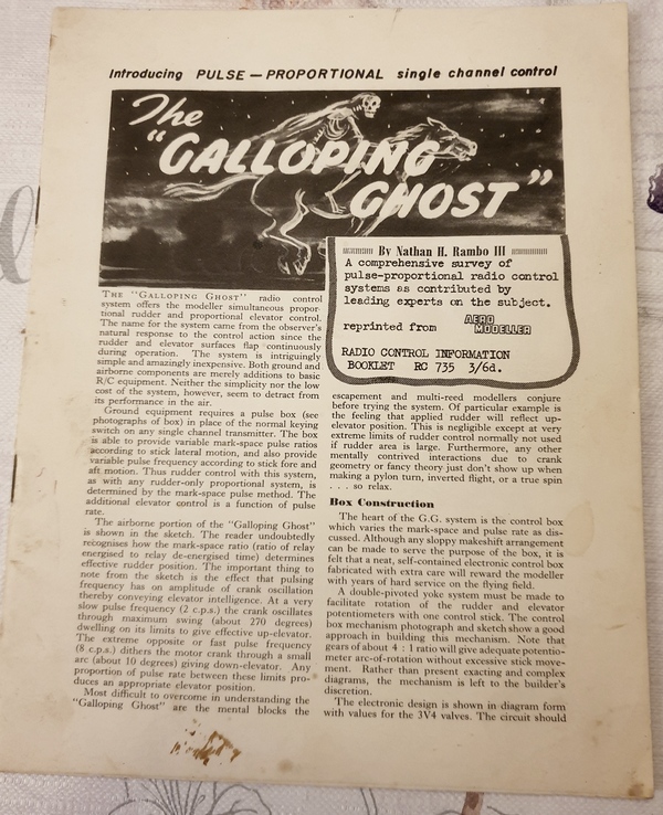

I found this in my attic whilst looking for some old plans.
The introduction states. "A comprehensive survey of pulse-proportional radio control systems as contributed by leading experts on the subject"
It's about 6-7 pages in total.
The "Galloping Ghost" Handbook

Can you scan it? others and I would love to read it. Will that violate any copyright rules?

To save you scanning the booklet, there is already a copy on rclibrary
https://rclibrary.co.uk/download_title.asp?ID=1053
