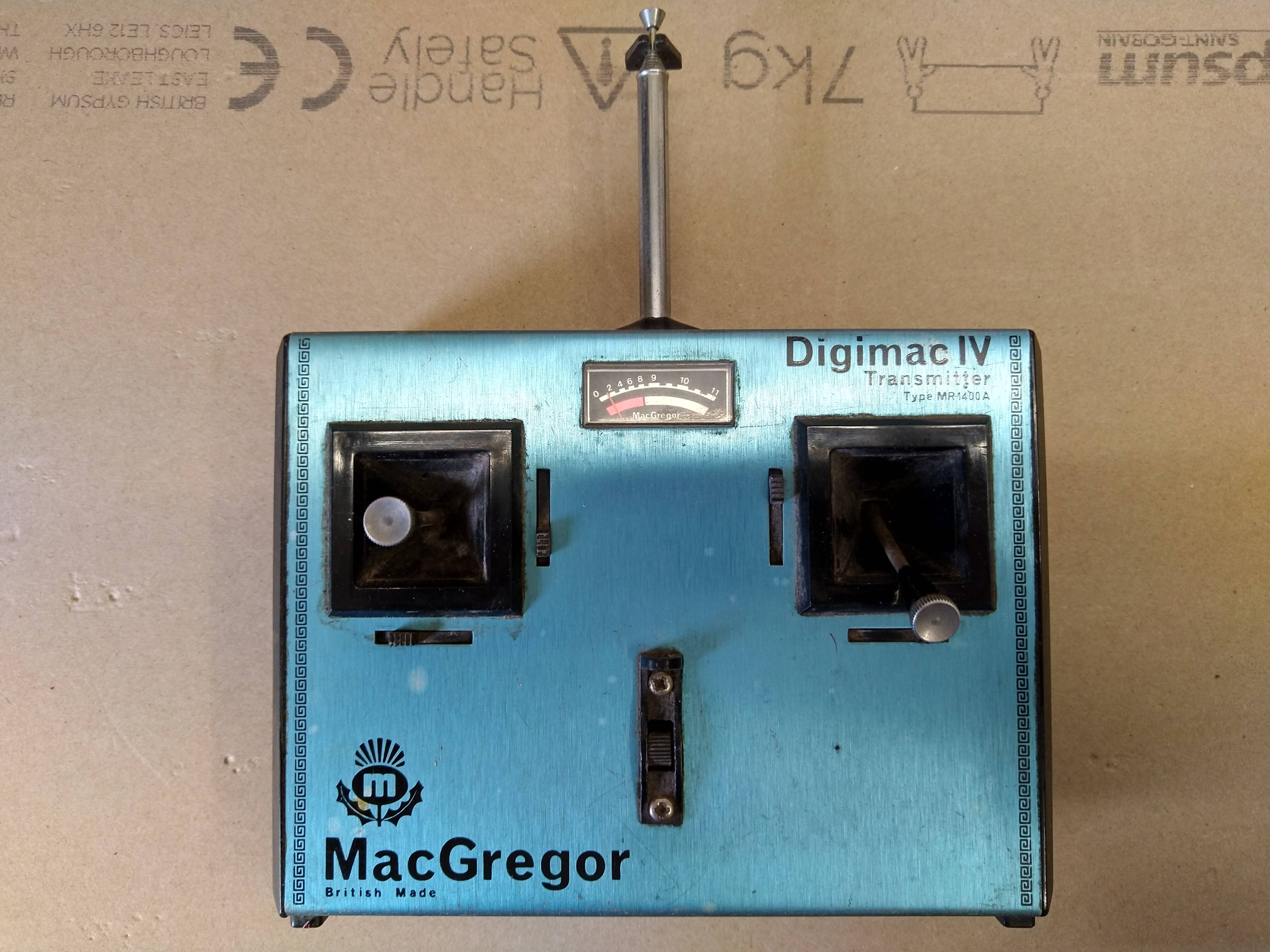

Digimac III

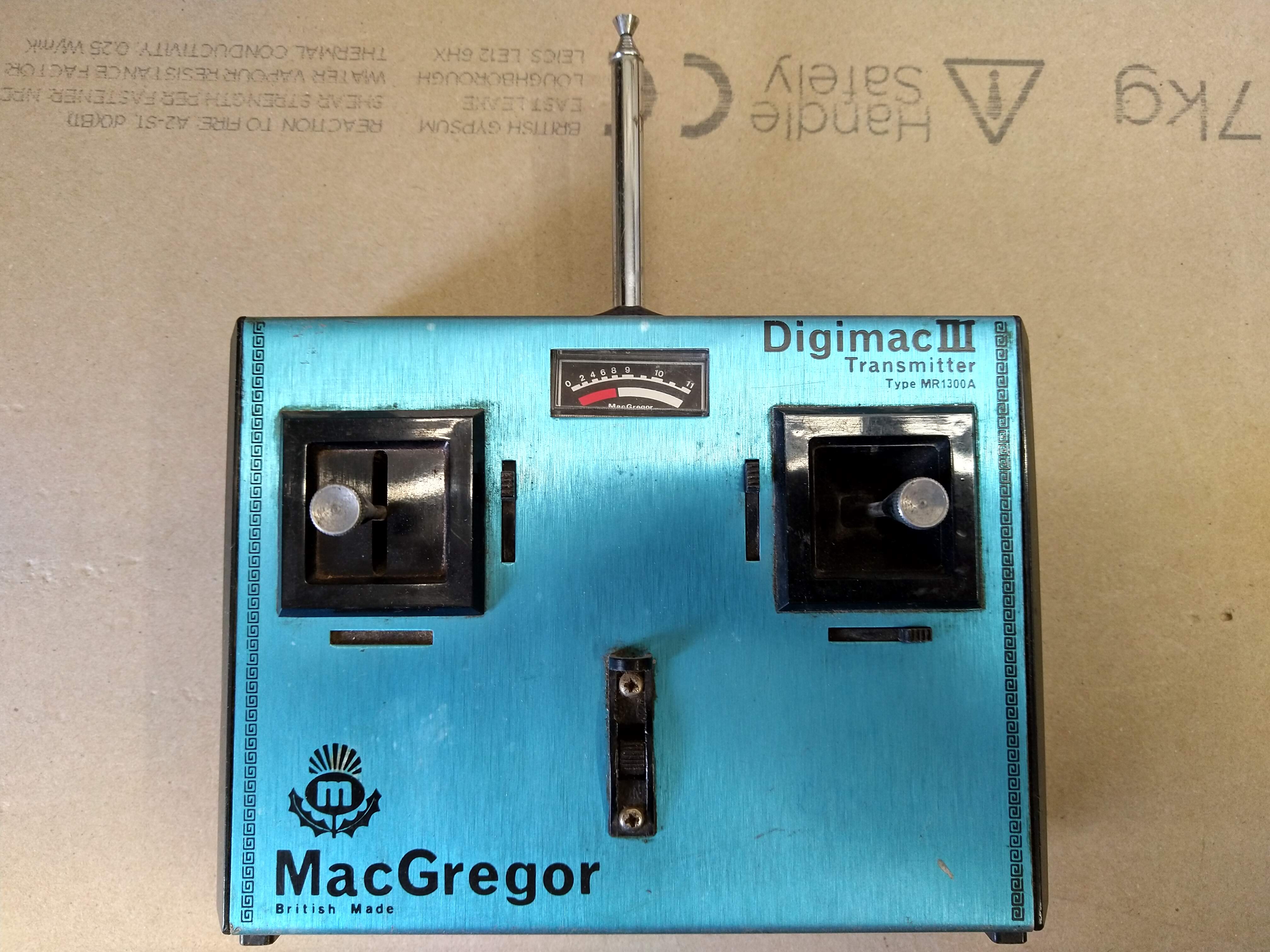

Digimac IV

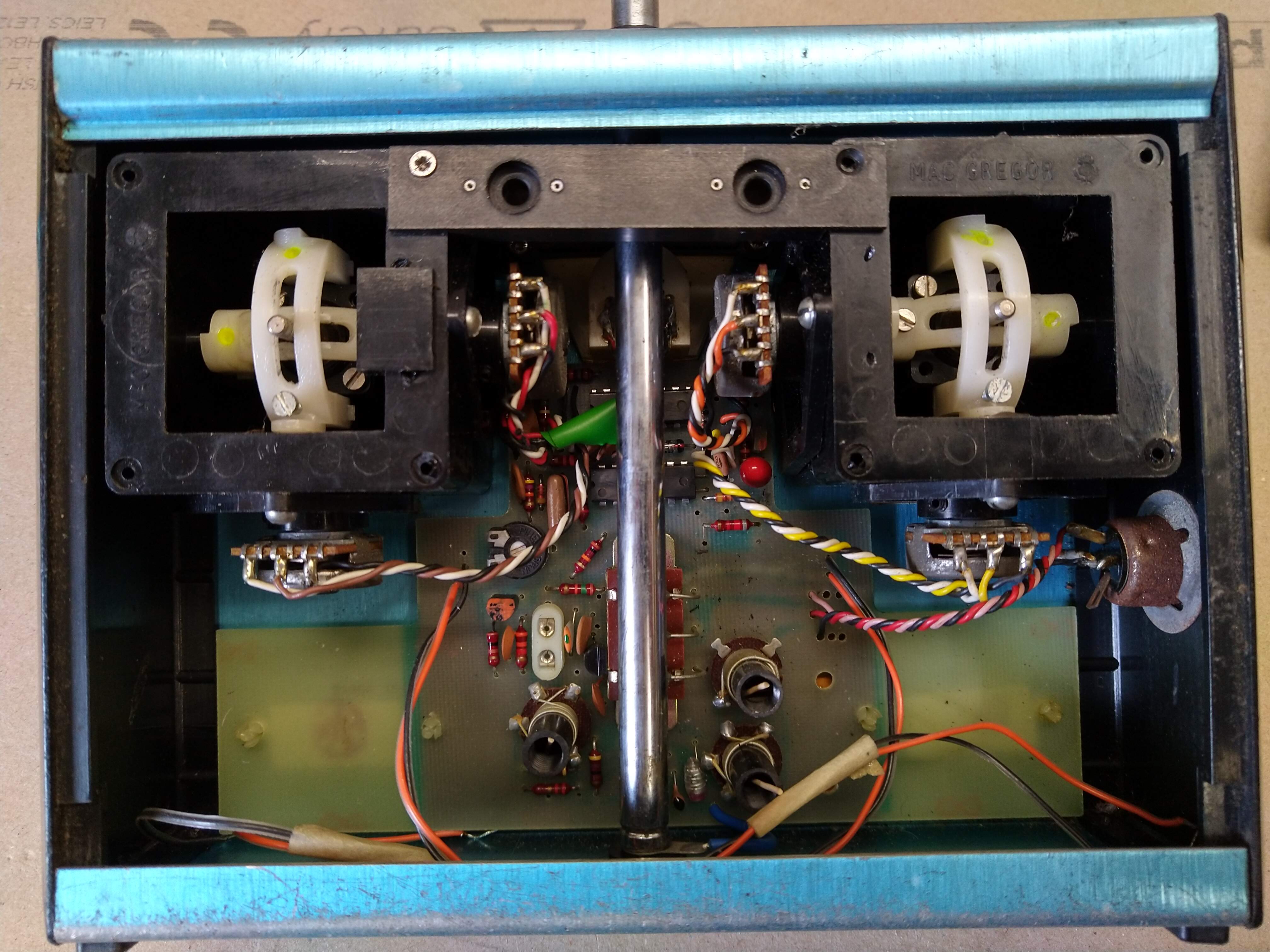

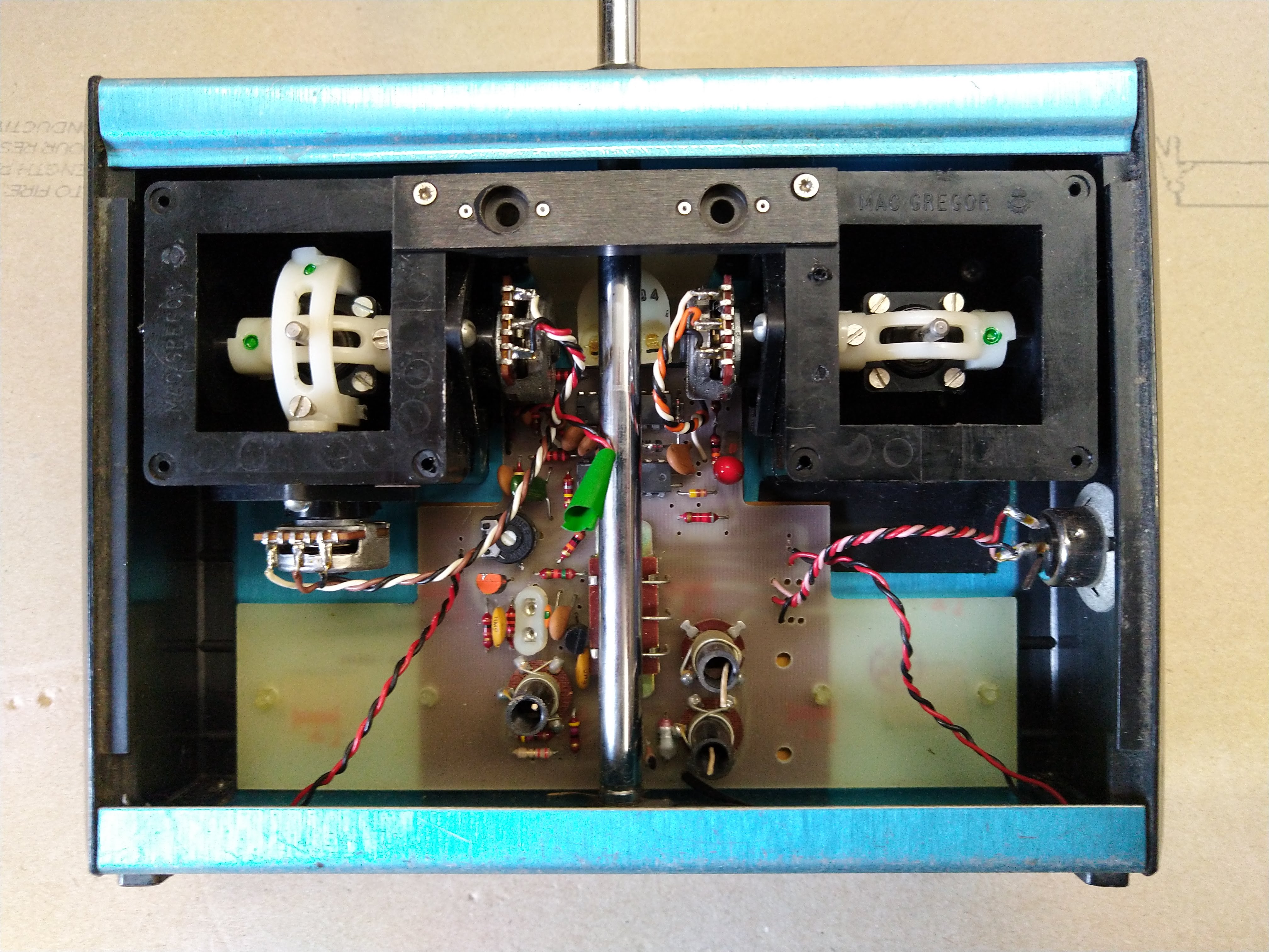

Time to move this project on, I've now got the encoders (thanks Phil) and I'm first going to work on the Digimac IV. The only thing I've done so far is convert from mode 1 to mode 2, it couldn't be easier moving a plastic clip from the right stick over to the left stick.
The pots feel a little rough, I sprayed them with Servisol contact cleaner but they still feel slightly rough, it might be mechanical, should the mechanism be lubricated? Should the pots be replaced as a matter of course?
Posts: 479
Joined: 16 Feb 2018, 13:57
Location: South Devon, UK
Re: MacGregor Digimac lll & lV
Post by Pchristy »
Pots "feeling a bit rough" might be the bearings in the stick units rather than the pots themselves. Many of the cheaper sticks used simple plastic in plastic bearings. Over the years, these accumulate dust, grit, engine oil, etc, which can make them feel rough. Dismantling and and a good clean, followed by a light smear of silicone grease usually gets them silky smooth.
To check the pots, you really need to have the electronics functioning. Take a known *good* servo, plug it into each channel in turn, and move the stick SLOWLY from one extreme to the other. If the servo jitters at any point in its travel, the stick pot needs cleaning or replacing. If the jitter is random each time you move the stick, it usually just wants a good clean. If its always in the same spot, its a sign that the track maybe damaged. In this case, it may respond to a thorough clean, but it might need replacing.
