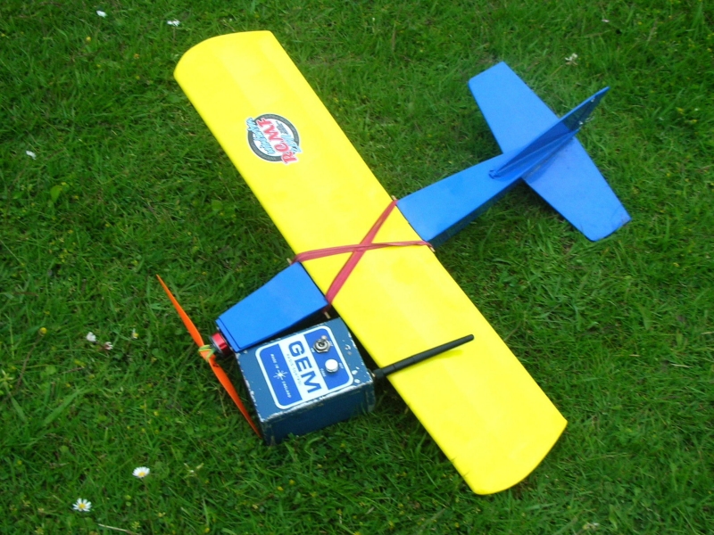

My Gem that I use for the Sharkface has a DM9, with an Orangerx R610 receiver (£3 jobbie).
It was converted back in 2010 so has done 7 years in S/C guise, no problems whatsoever once the timing peculiarity
was identified. Strangely, this has only just resurfaced with Taranis lads wanting DSM2 and fitting a DM9 - they found
all the channels were 100uS off until the PPM pulse width was changed to 400uS.
Gem (Spektrum DM9 / OrangeRx R610)
