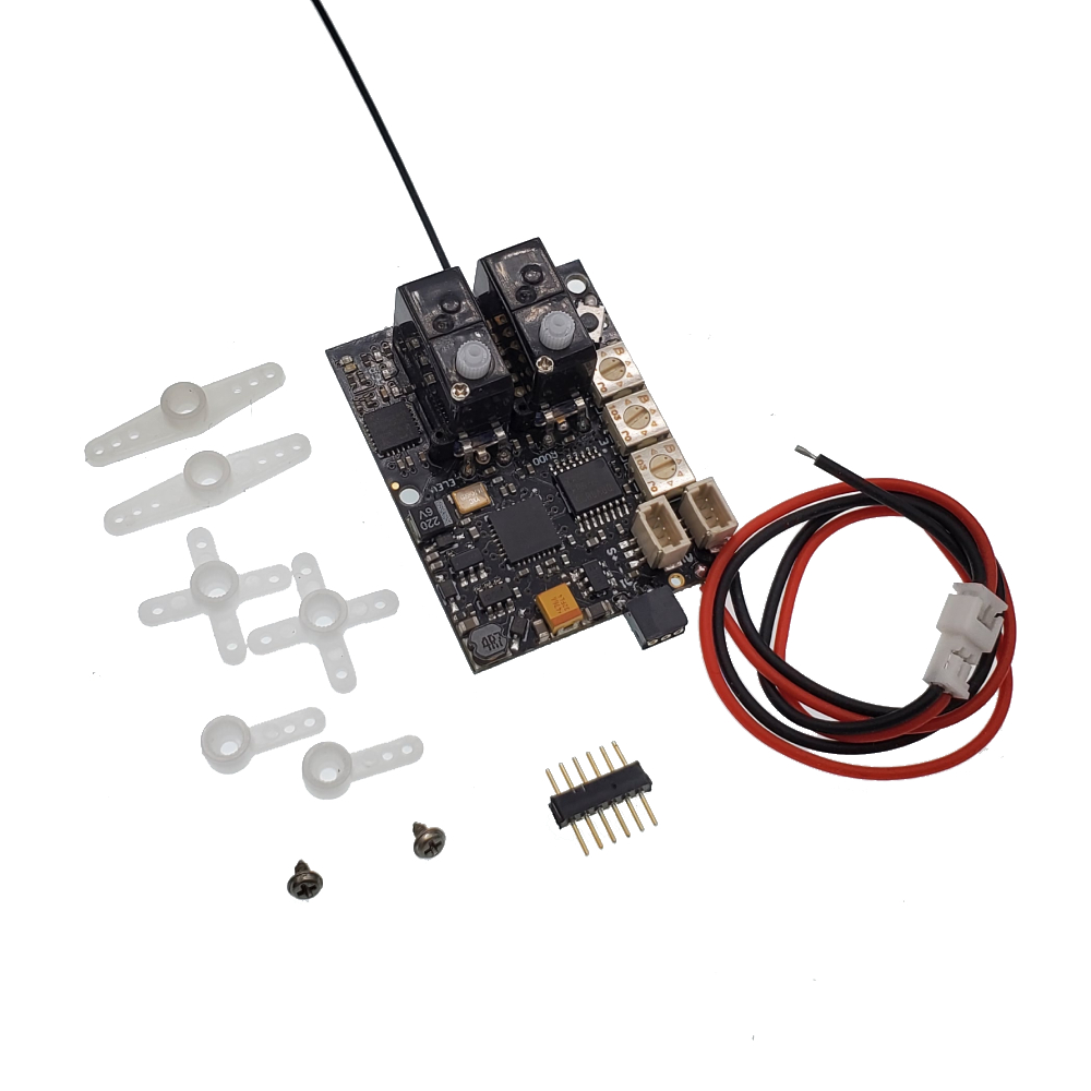

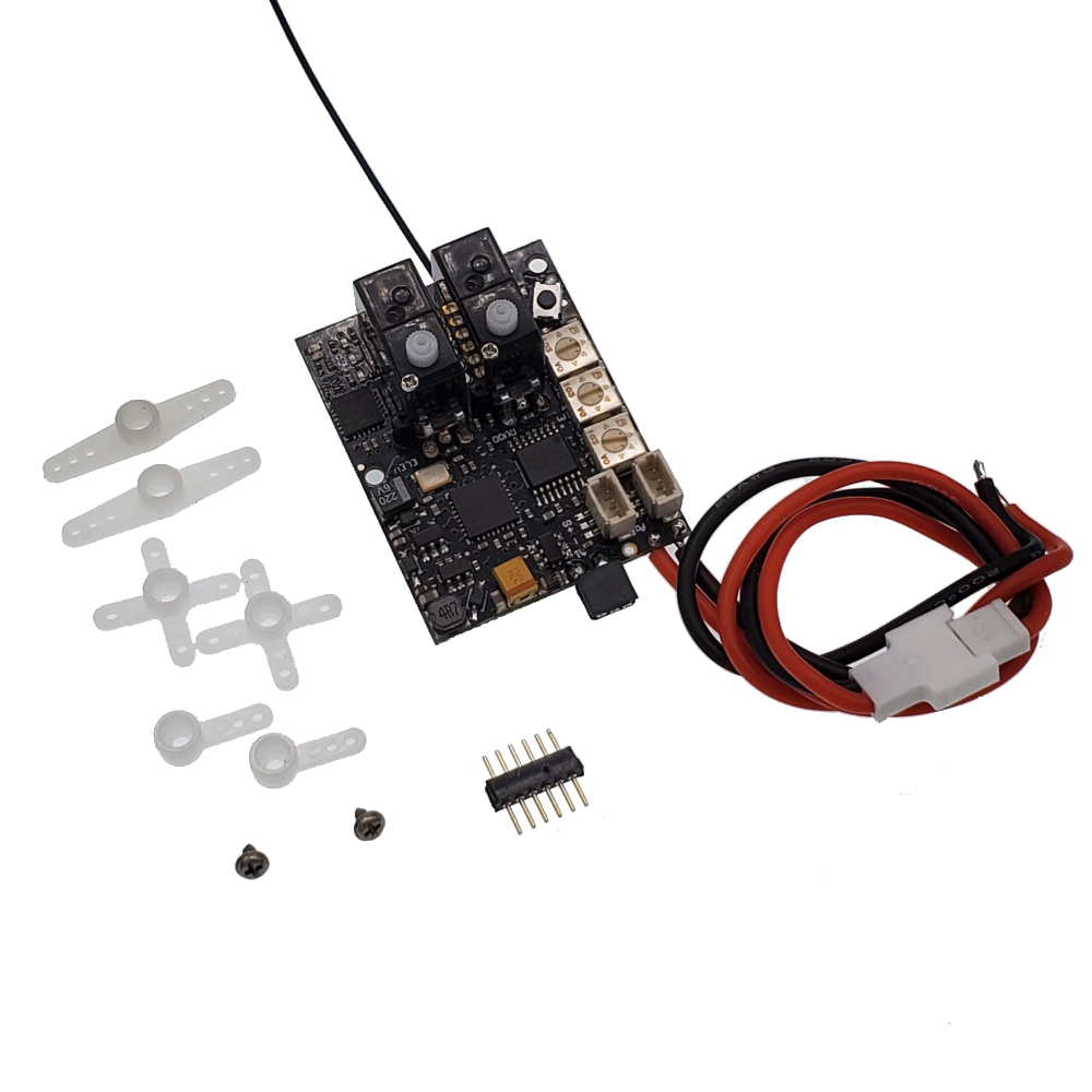

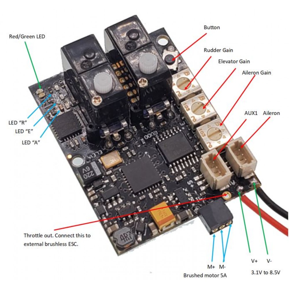

Hi Guys, am thinking about importing the new Lemon Microbrick for the upcoming Indoor flying season.
Mike K has already one and I will be sending some to RCM&E when they arrive which may well end up with Shaun to review! :D
https://lemon-rx.com/index.php?route=pr ... ry&path=86
Lemon supply them with different battery connection options and not being an expert on this indoor kit, would appreciate your views before I order a batch?
Posts: 1238
Re: Lemon Rx Microbrick

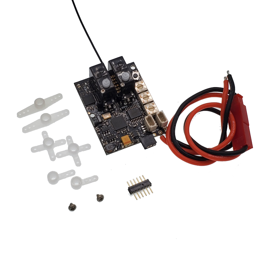

For 1s operation I would use a jst ph-2 connector. This is very common on many batteries these days . The 1.25mm Molex is old school and less popular with the indoor mob. They don't appear to offer this currently but I think that's a mistake.
We used to change the 1.25 connector to the PH on drones and indoor models; it was like turbocharging them.
For 2 s, use the red jst connector.

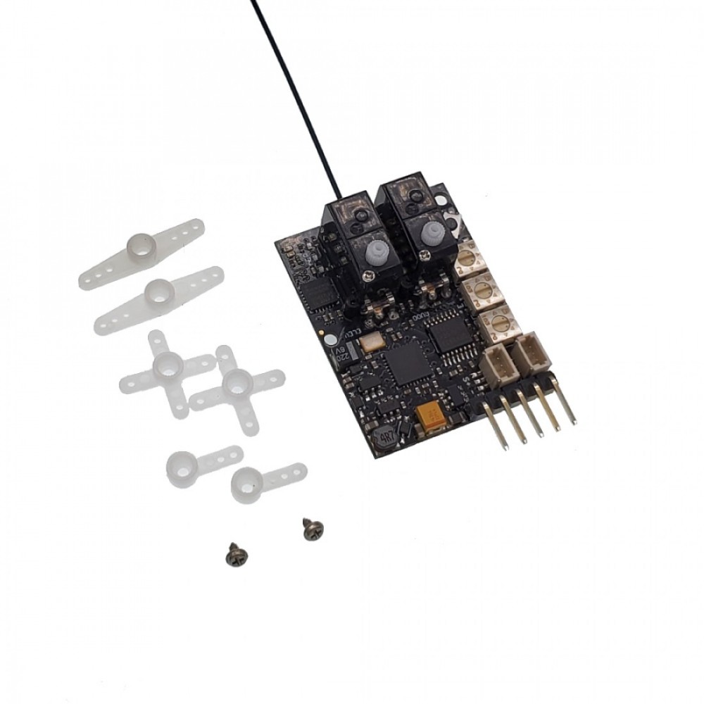

The description indicates a potentially useful unit, primarily for but not only indoor.
I appreciate that not everyone has a fine-tip soldering iron or the visual acuity to use it but might there be a version with just solder pads ?
