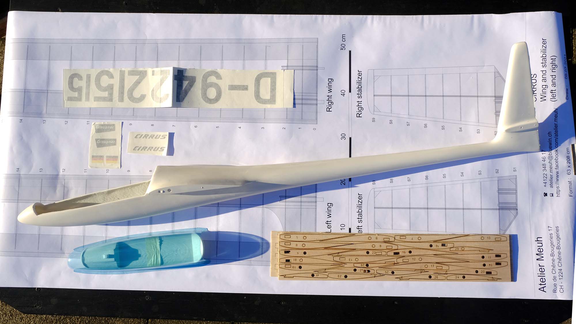

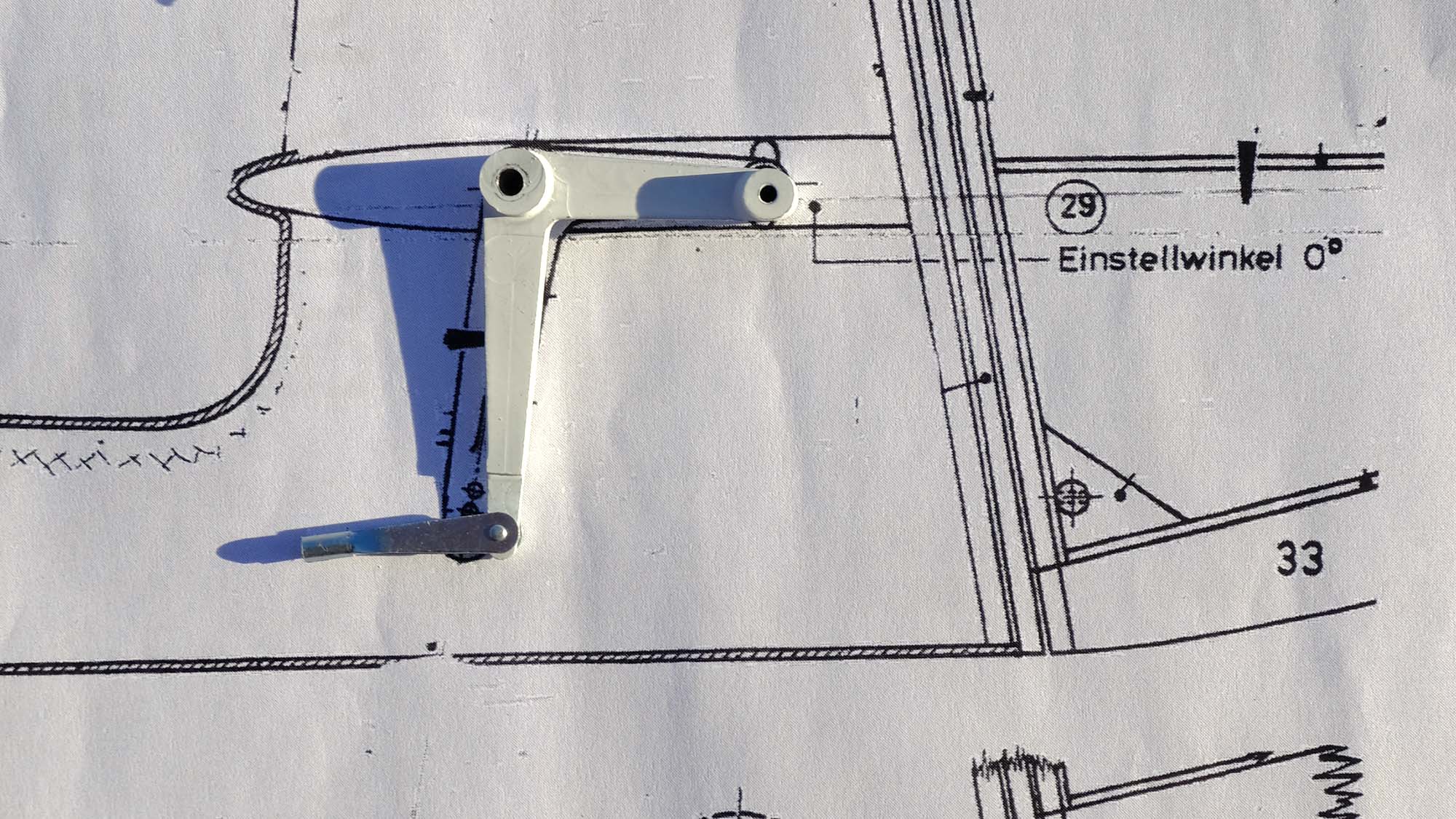

Thought I would share this little project with you.
I have been looking around for an original kit for the Cirrus from the seventies for a while now, (always lusted after one back then, but pocket money wouldnt stretch that far!) But it seems the kit collectors have driven the prices to stratospheric levels these days and also the original plastic fuselages had a reputation for cracking and generally not withstanding the rigours of regular flying.
This semi kit her consists of epoxy fuselage/canopy frame, blue tinted canopy, full size plans, laser cut ribs and decals Produced in Switzerland by a modeller doing his bit for Cottage Industry there.
It is available direct from Heinz Schneider in Switzerland for all that you see in the pic below, Not cheap at 230 Euro shipped to UK , but where else will you find one?
I bought the 6 mm carbon rod spars from EasyComposites in the UK and have found other items on German ebay such as an aluminium replica of the all moving tail horn and wing retainers.
A trip just down the road to Watton to the nice people of SLEC, saw me spending £50 for all the wood required for the wings and tail surfaces.
I plan on using an 8mm Carbon rod wing joiner and it will be a full house model with twin aileron servos and fuselage mounted tail servos plus the E Motor ESC.
The plan is to saw off the nose and fit a 3S Electric Drive, I know sacrilege, but don' t forget I live in Norfolk, the land of flat fields and Big Skies!

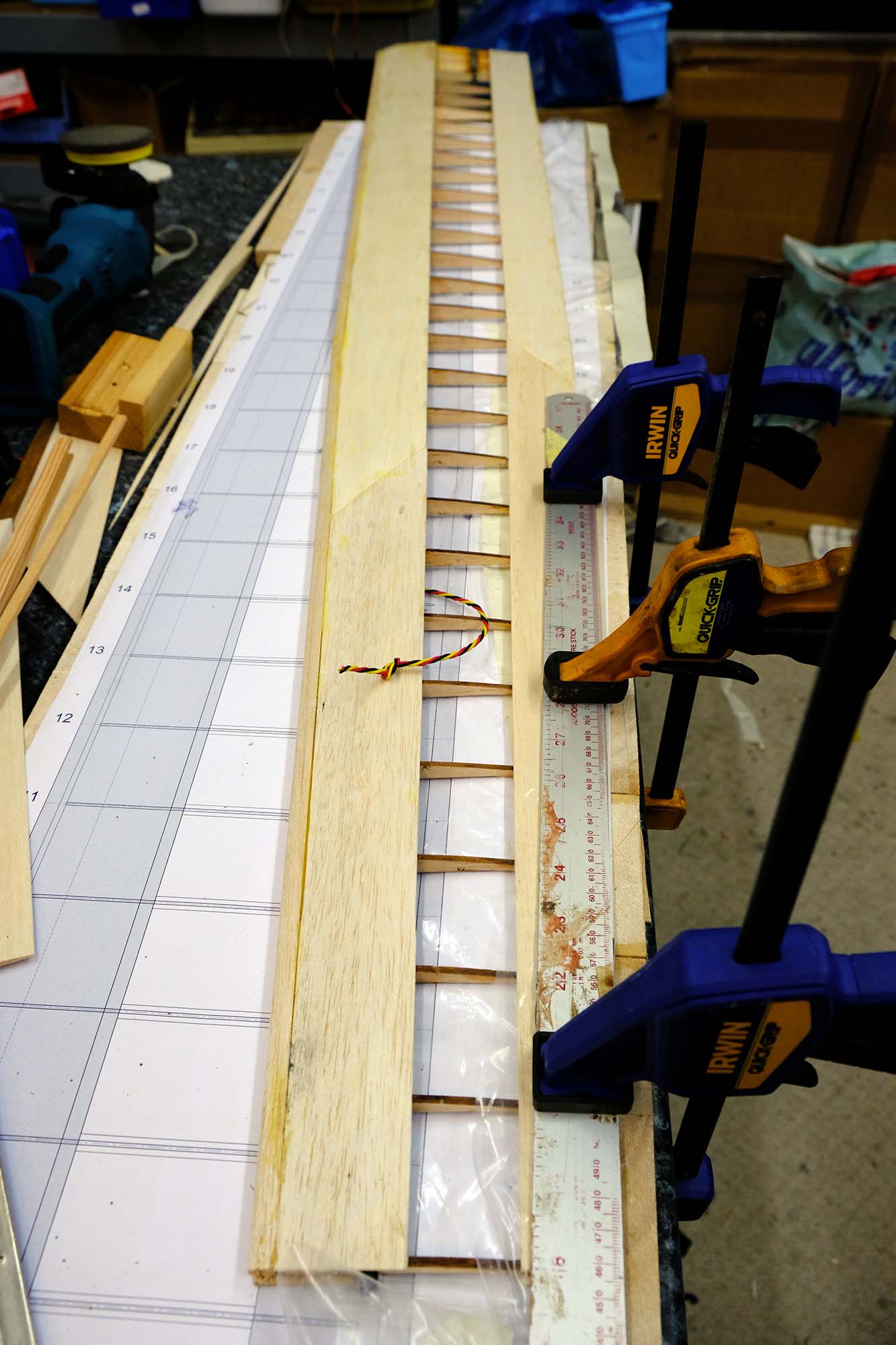

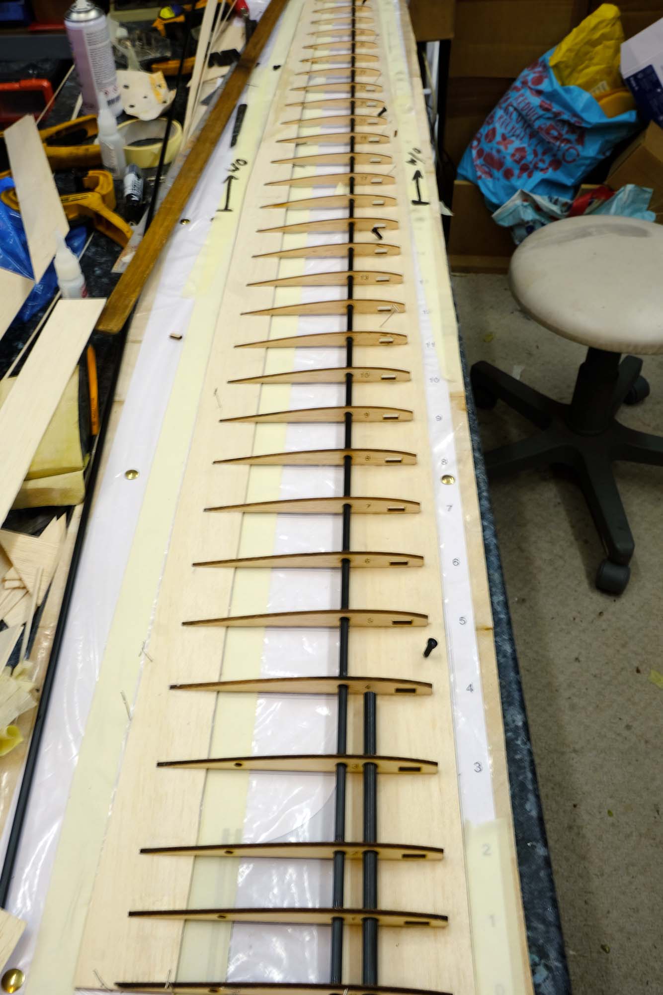

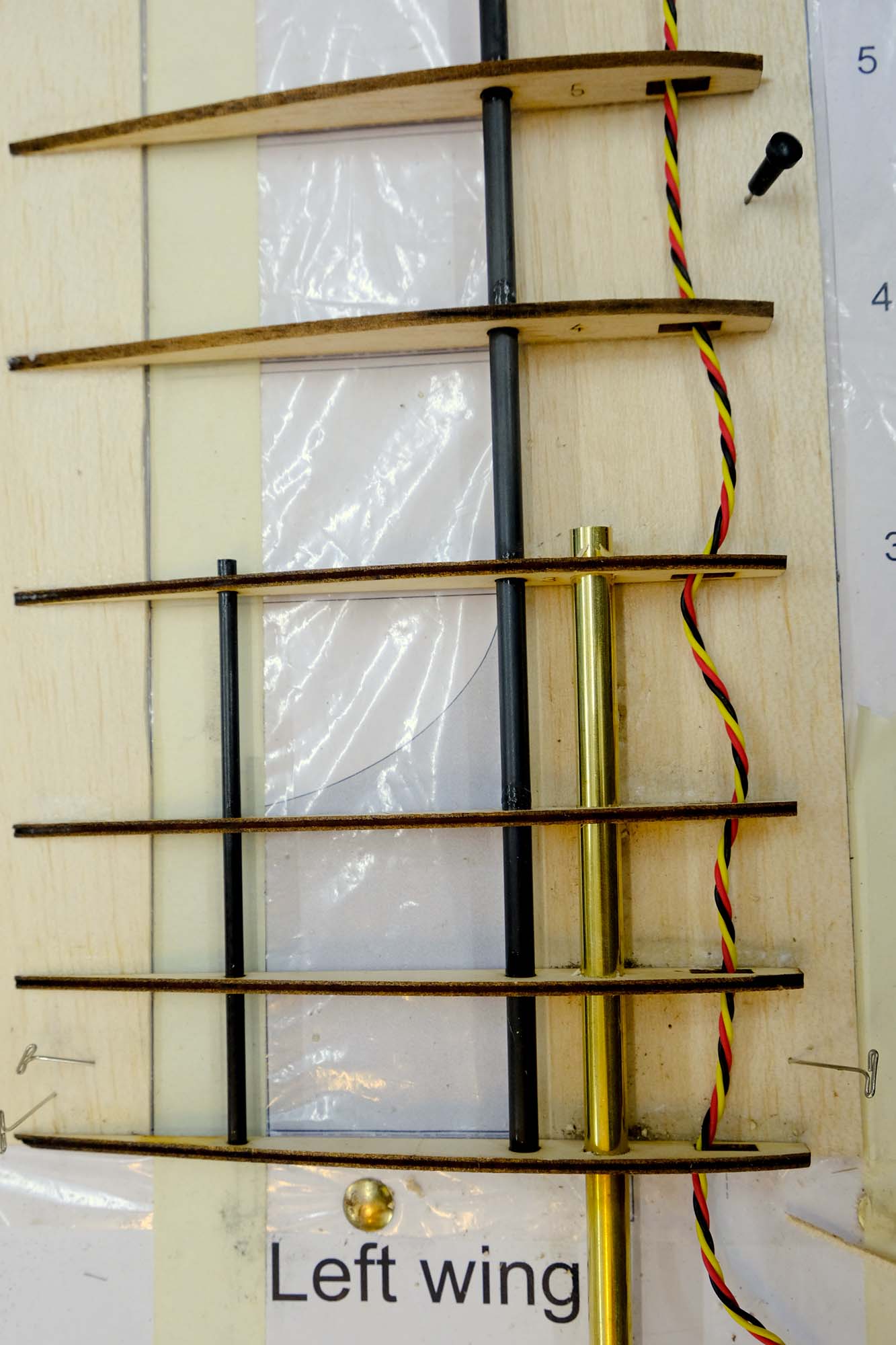

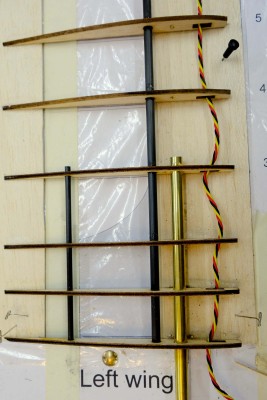

Started on the wings today with cutting the 1/16 wing sheeting for Leading and trailing edges. Took a bit of head scratching as not only are you having to cut the taper which starts just inboard of the aileron, but also having to scarf joint the sheets to make 60 inch long continuous sheets from a 48 inch sheet (max available length from SLEC).
There is also about 1/8 inch washout in the outer panel, so again, had to be mindful of this.
Anyway all sorted and it was a great feeling when all the laser cut ribs slid over the 6mm spar and were glued into place.
I also dry fitted the wing joiner tubes to ensure no nasty surprises later!

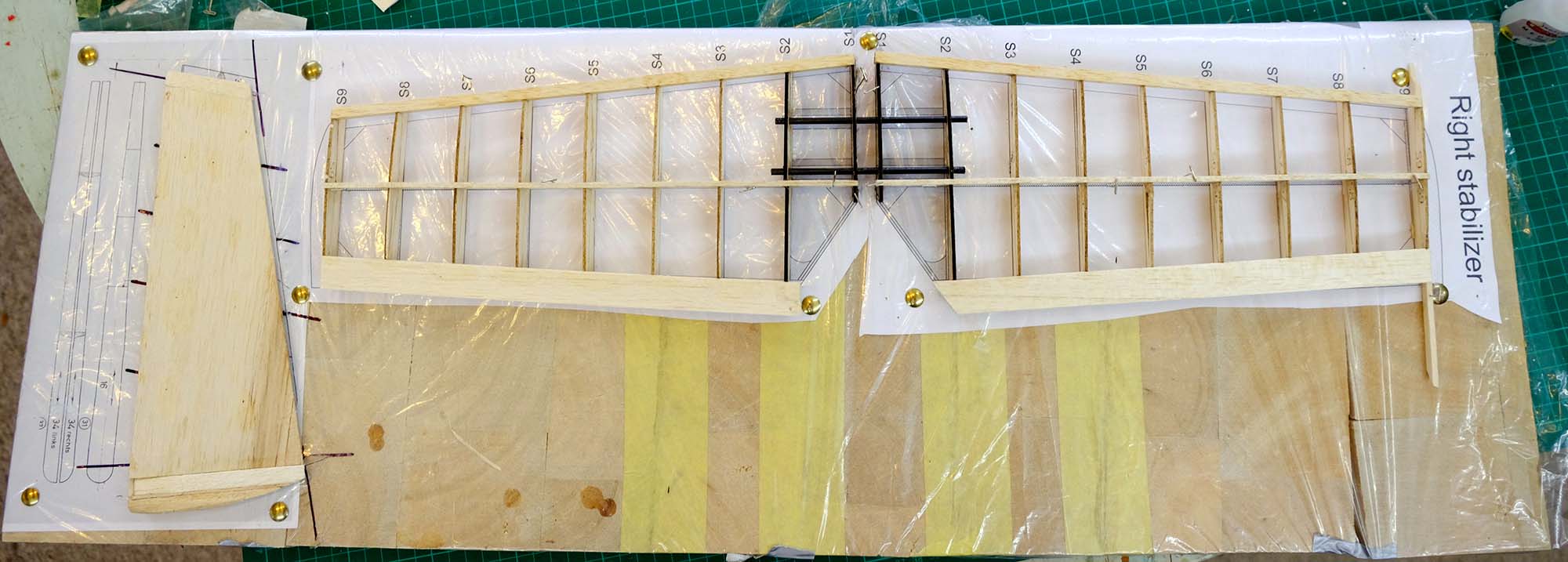

Too windy for flying today, so a few hours in the workshop this morning saw the Tail feathers bare structures completed.
The laser cutting is really good and the stab ribs had tabs to compensate for the symmetrical and tapered section, which made building it flat on the board an absolute breeze.

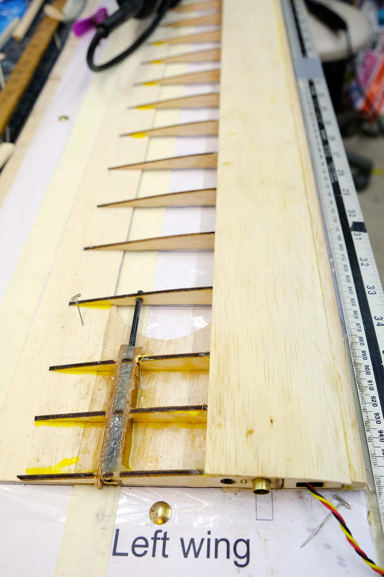

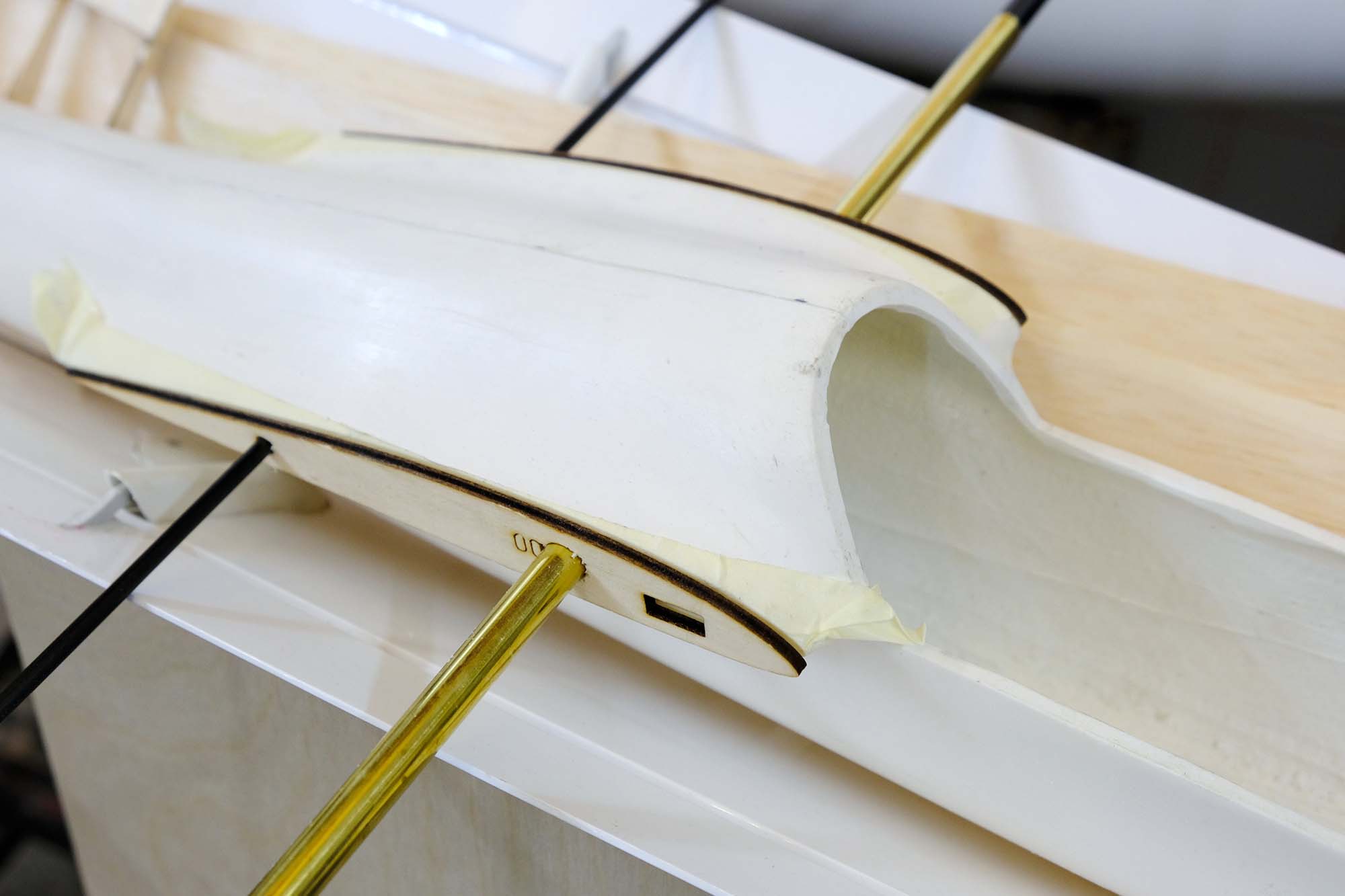

After work, attached the leading edge to one wing panel so couldn't do much more on that, so busied myself with the fuselage and drilled the wing joiner tubes using the ply wing root ribs as patterns for where the holes needed to be.
These wont be finally fitted and bonded in place until both wing panels are completed to ensure correct wing/fuselage alignment and incidences. Also epoxied the canopy hatch latch in place on the top of the fuselage.

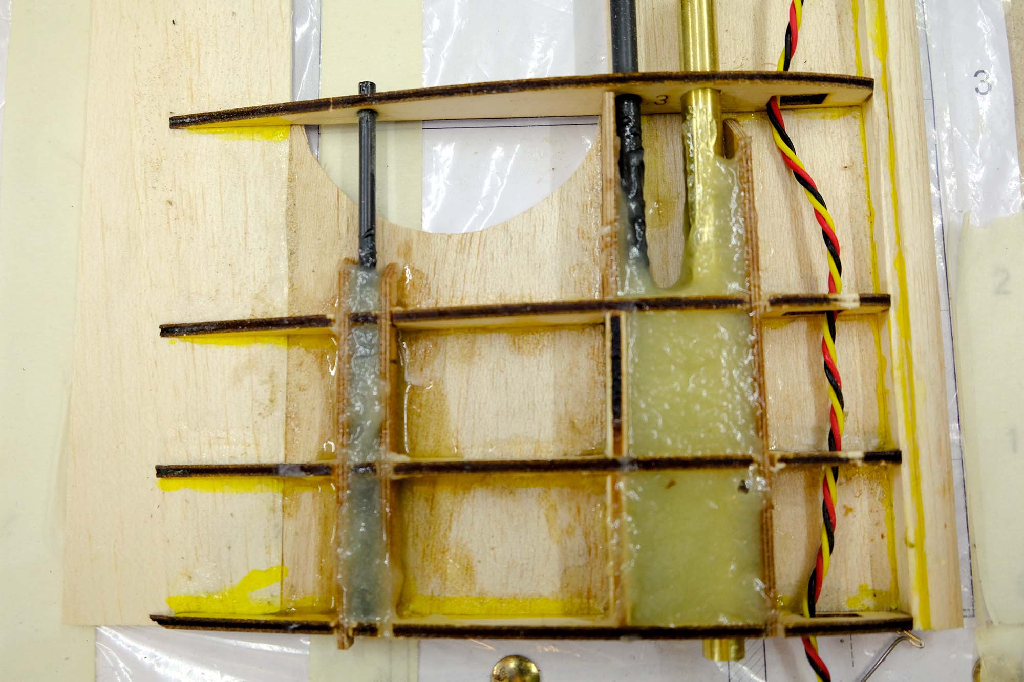

Bit more work on the LH wing panel this evening with a mixture of epoxy and micro-balloons added to the roots to bond wing joiner & spar together and reinforce the incidence tube.
The precut leading edge sheeting was also fitted so the epoxy root reinforcement cures all as one assembly

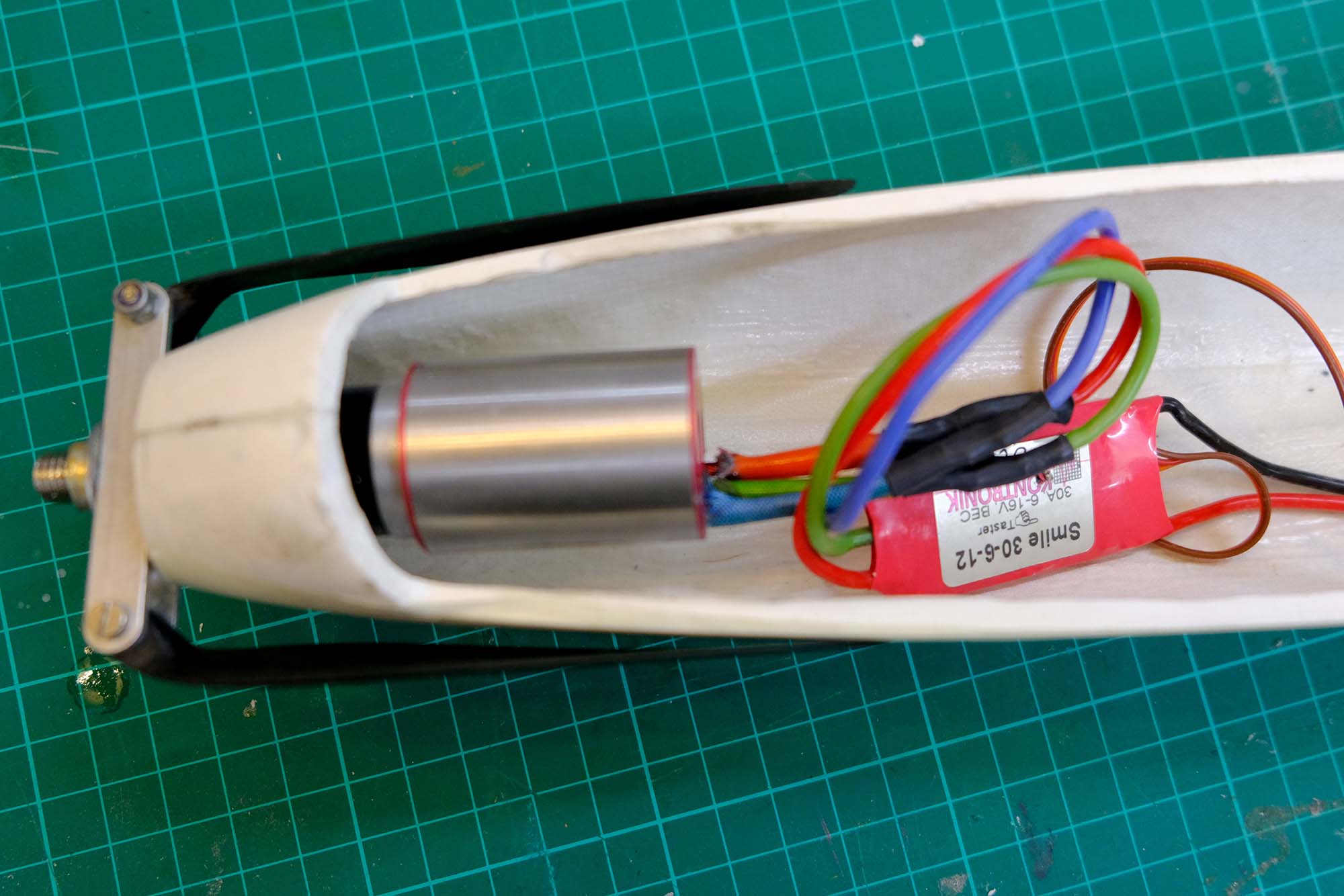

Teaching got in the way of progress this week, but this afternoon, completed the glassing the TE on the other wing panel using the elusive glass tissue tape.
Kontronic 40-42, 5.3:1 Maxon Gearbox
Volts 11.1 V (3S)
Current 30 Amps
Prop 10.5 x 6
RPM 8900

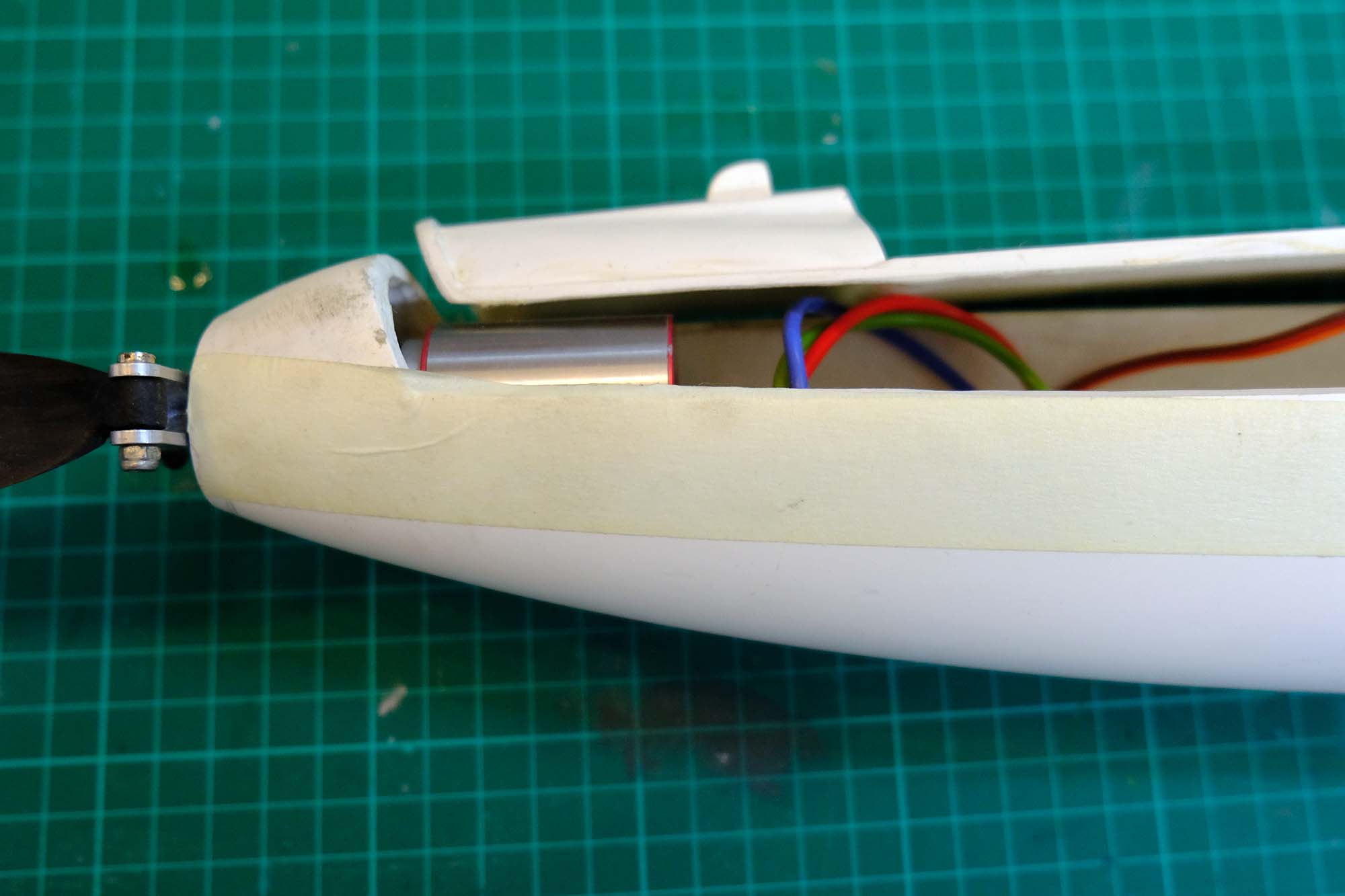

Encouraged by the breeze created, I made up a 40 mm motor former from 1.5mm Epoxy board, sliced the nose off and epoxied in place with a couple of degrees of down thrust relative to the stabiliser.
I had originally planned on a 40 mm spinner but think I will get a 38 mm Perkins CNC spinner and prop adapter from Pegasus in Norwich tomorrow.
As you can see, it all fitted beautifully with the canopy frame instrument panel moulding clearing the motor by a good margin...made for the job, methinks!
More to come

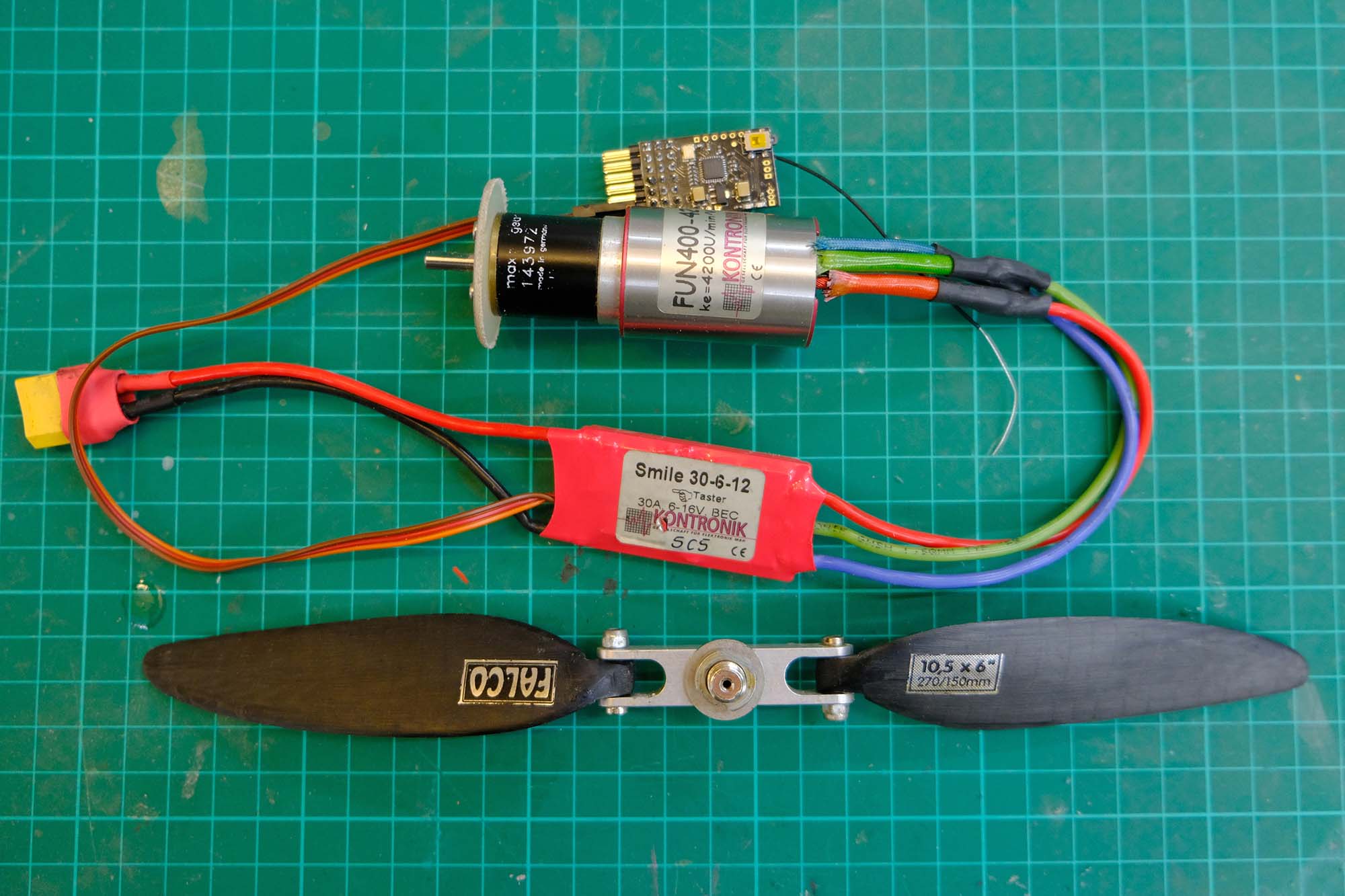

I also had a go with the Kontronic Drive that Mike K had kindly sent me for the project and after changing the connector to an XT60 was able to power it up connected to a Lemon 6 ch Rx.Kontronic 40-42, 5.3:1 Maxon Gearbox
Volts 11.1 V (3S)
Current 30 Amps
Prop 10.5 x 6
RPM 8900
More to come
Re: Graupner Cirrus 21st Century edition
Hi Stuart,stuart mackay wrote: 19 Nov 2021, 22:54 I also had a go with the Kontronic Drive that Mike K had kindly sent me for the project and after changing the connector to an XT60 was able to power it up connected to a Lemon 6 ch Rx.
Volts 11.1 V (3S)
Current 30 Amps
Prop 10.5 x 6
RPM 8900
The current & RPM figures you are getting for this combination are very conservative! Another 10amps could easily be accommodated by the motor & g/box. Suggest you try at least a 12 x 6. You don't need any more pitch unless you want Hotliner performance
Yes, it does look a great fit. Beware of heat radiating from the motor case, which will continue after you have shut the motor down, until the motor is cool. If the canopy frame/instrument panel is plastic, it will distort. If glass, it will potentially soften, so could also distort over time. Ensure plenty of flow-through ventilation - a small NASA inlet either side of the nose abeam the g/box and outlets behind the battery will keep everything much cooler.stuart mackay wrote: 19 Nov 2021, 22:54 As you can see, it all fitted beautifully with the canopy frame instrument panel moulding clearing the motor by a good margin...made for the job, methinks!
Speaking from bitter experience, rather than painting the top of the instrument cluster a dark colour, try 1000-2000 grit wet/dry paper glued on - it looks very scale like and helps insulate the underlying surface, further reducing the chance of heat distortion. Just think how warm your car's dashboard gets after sitting in the sun for several hours, even in Pommy Land
Admittedly, my large scale sailplanes spend much of their time in temperatures of 30+ deg.C but why risk it?
It should be a great flyer, enjoy.
