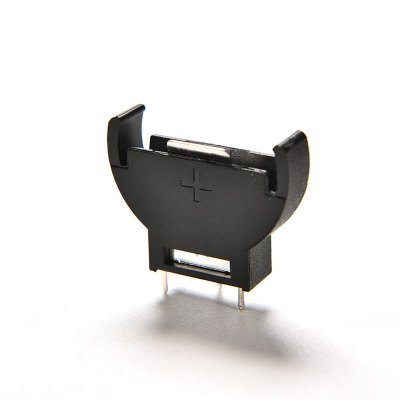

Not difficult to solder a couple of wires to the tracks and add an external battery and case such as a CR2032.
Tape up so nothing comes in contact with it and shove away in a corner somewhere.
Done it on the JR388 no worries.
Then cut the old battery out afterwards.

coin battery.jpg (11.21 KiB) Viewed 7192 times

Thank you Kalle and Bluejets - that is exactly what I need Kalle.
That is also a possibility Bluejets.
