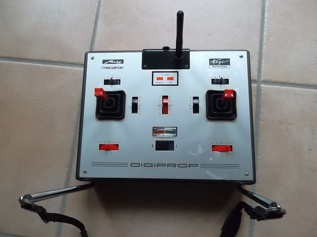

Last year I was lucky to get a nice Hegi Metz Digiprop 7Ch transmitter for a reasonable price.
Conversion is now finished using only 6 channels, channel 7 is used for a second aileron servo, so one of the sliders is not used anymore.
The heart is a DIY Strong Board with a modified 7Ch propo sketch from Phil.
For the HF part, a Lemon 2.4G module is used.
It features mixing, buzzer, servo reverse, even for the 2.aileron servo, throttle alert etc.
Works very well, flighttest was last monday flying an old Top Flite Elder.
This is the heaviest transmitter in my collection, the case is made of steel.

Eine Raeritaet und sehr schoen Frank!
