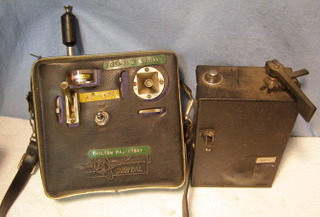

as received:

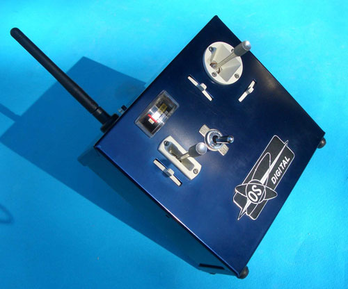

converted to 2.4 - changed to mode 1 so the left stick is now centering and the right stick is ratcheted for throttle:

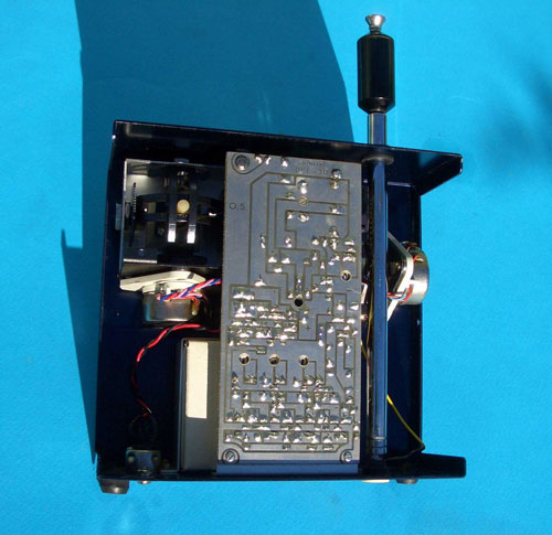

original internals:

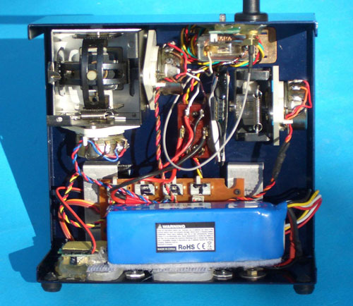

converted internals - uses a Futaba encoder from an 'Attack 4' (conversion predates availability of Phil's encoder) and a Frsky module:

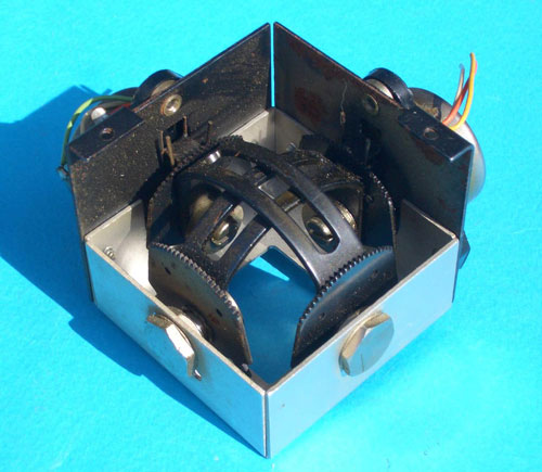

stick unit - I think I swapped out the simple springs on this:

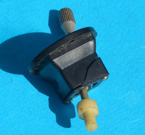

ball joint - in these stick units, the casing is often cracked, so it needed to be wrapped in heavy duty thread and epoxied:

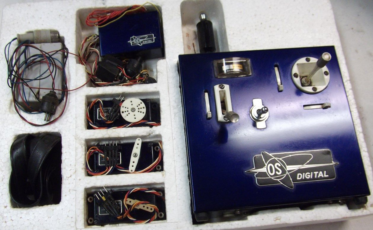

Also found this pic of a NIB example:

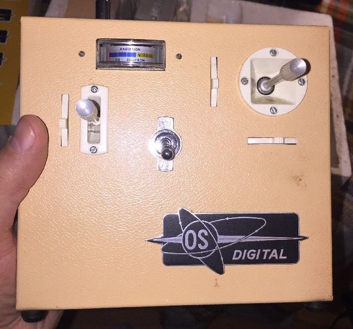

The set was also available in 'beige':
