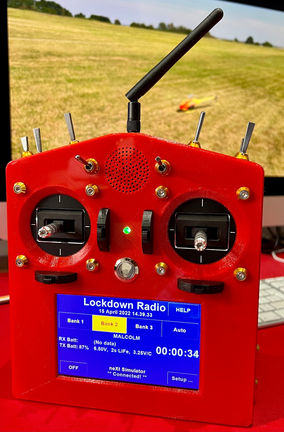

Hello!
I’m new here - so I wonder if anyone is interested:
During lockdown, I began to learn about Arduinos and microelectronics. I was a musician really (oboe).
To cut a very long story very short, I’ve
since developed a full featured proportional radio
control system.
The circuits and PCBs are my design.
I had the PCBs made in China. I assembled them
at home. The cases I also
designed and 3D printed at home in PETG.
The comms protocol is my work.
The code is all C++ and is open source on
GitHub as my repo: “LockDownRadioControl”.
The system is based on Teensy 4.1 and Teensy 4.0 MCUs
and uses EByte ML01DP5 transceivers.
The system has these features, so far :
16 channels
4 flight modes
32 mixes
99 model memories
2.5 km range
FHSS (2.4 GHz, about 16 hops per second)
SBUS
Buddy boxing
Data compression
12 BIT servo resolution.
Colour touch screen GUI (Nextion 5” Intelligent)
Failsafe
Binding
5 point curves - straight, smooth, or exponential.
Telemetry for volts, gps, etc.
Diversity (two transceivers on RX)
Model memory sharing over RF (no wire or sd needed)
Local model memory backup system (sd card)
Audio feedback
Input remapping
User selectable screen colours and audio.
Real time clock (corrected by gps link)
Waveband scanning function.
Future plans include PID stabilisation using MPU6950.
This system seems worth sharing to me!
It’s not commercial - just for fun!
Malcolm MESSITER

Hello Nino
Thanks! Yes of course I’m happy to share everything and I hope might learn something from others with greater experience than I in this area.
All is posted at:
https://github.com/Mmessiter/LockDownRadioControl
These files include all source code, .stl files and Gerber files for the PCBs. I try to keep these up to date but development is quite fast so sometimes confusion might result.
For example - I just upgraded from “enhanced” to “intelligent” Nextion displays. I am trying to keep the system backward compatible for those who wanted not to change hardware. It only means audio won’t happen. Also in the “sensor” hub code I discovered that while Teensy 3.2 works fine, the 3.6 and LC models do not work - so these code versions I better remove. I think that’s a small hardware bug.
Speaking of hardware bugs, I found one in the nRF24L01+ (which is the chip at the heart of the ML01DP5). And I found a work-around: This transceiver has two FIFO buffers, one in and one out, with space for three data packets in each. On the datasheet it says: “do not allow a fifo buffer to remain full for over 4 ms”. But it does not warn of the consequences!! The result, as I found, is that the chip stops working utterly until it’s rebooted. Not great when in the air. The fix is simply to flush the buffers after every send or receive. Essentially don’t use the buffer at all!

Very impressive Malcolm. You've clearly put in a great deal of work. Welcome to the forum, by the way! :D
How readable is that GUI (Nextion 5” Intelligent) display in sunlight? I've yet to see a colour display that's really clear in bright conditions. I've got a RadioMaster TX16S, and its display looks fantastic on dull days or indoors; but on sunny days the non-backlit monochrome display on my old Taranis is much more usable - besides being much more economical on the transmitter's battery.

Gosh thanks!!
I realise that one main reason I became obsessed with the radio development was because every aspect is home grown - in *my* home!
Consequently I fully understand if others are a bit less enthusiastic about building one - designed by a complete stranger.
But how about someone else designing and building a new radio from scratch? Lots of people do that with models, but I’ve not seen any do a radio yet - not fully anyway. If I can - a mere oboe player - I think anyone can. And these days the needed information is all there on Google, and needed components are all pretty cheap on Amazon and EBay! Transmitters almost never crash either !!
The Nextion screen is extremely good (especially their latest) but as you suspect, in bright sun it’s quite hard to read, like many. So I suggest setup in the shade, then fly in the sun. In any case the screen will turn off after a (user definable) period, to save battery while you fly!
