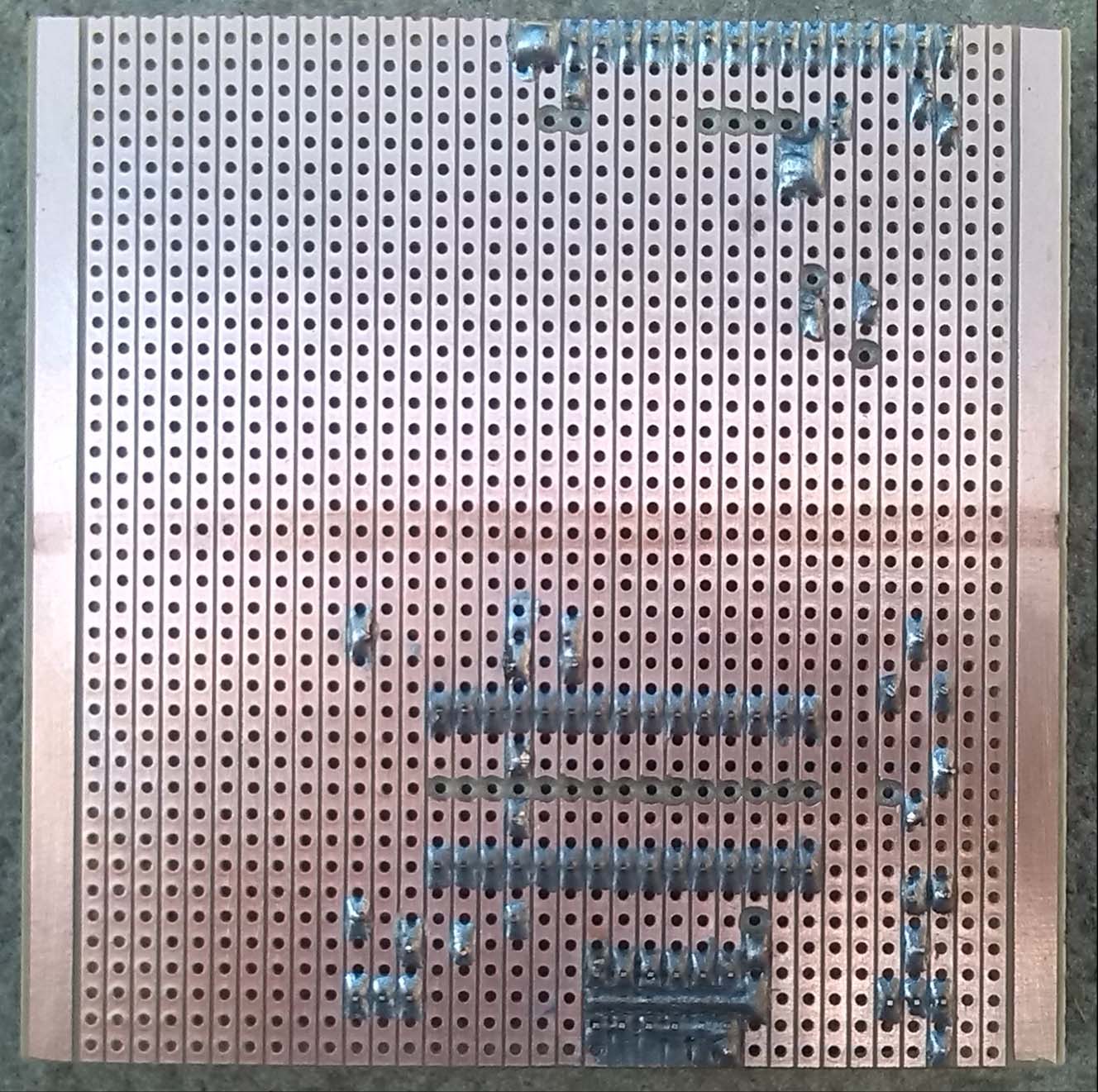

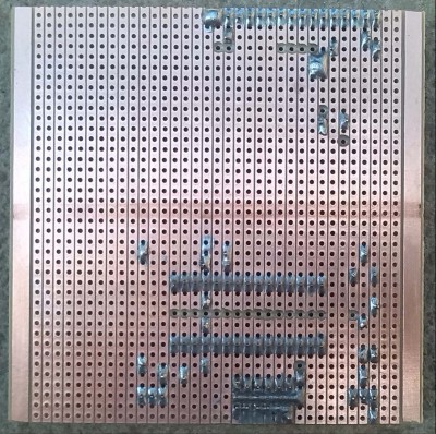

I have found a couple of photos of the vero layout but I've not been able to recover anything from Wayback or from my own backups.

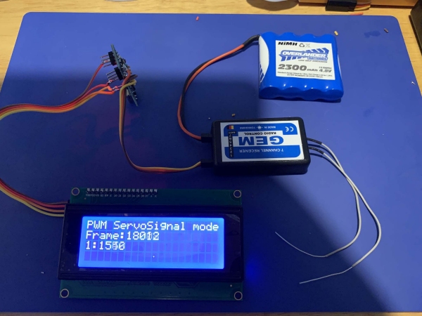

It can sense if the input is a single servo signal, say from a receiver channel or a servo tester - and will automagically switch from PPM to PWM mode, displaying the servo pulse width.

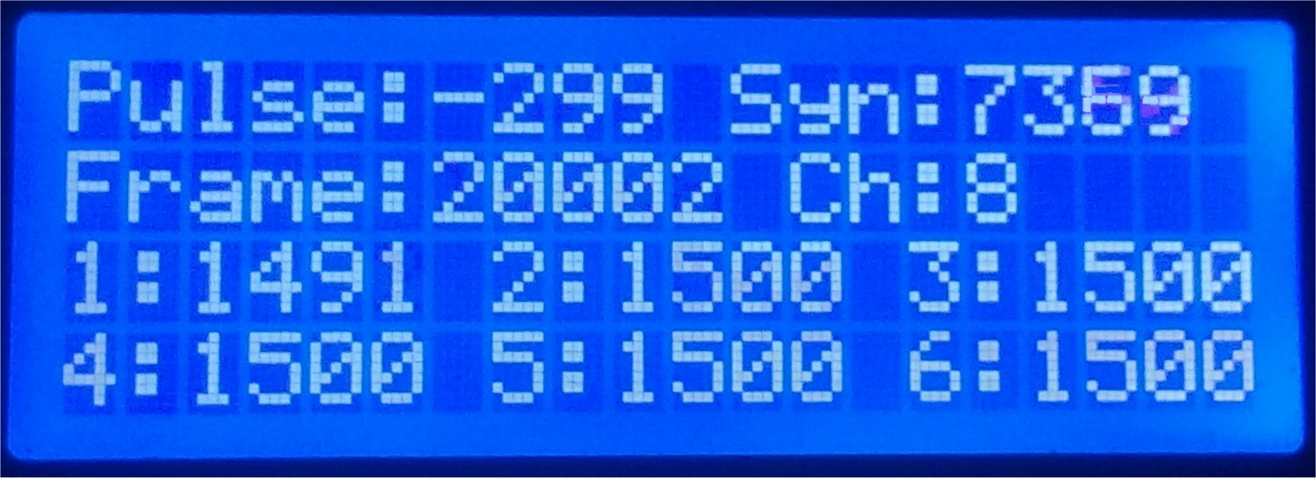

I find it very hard to photograph back-lit displays, so I have to turn the white-balance right down,
hence the dark photo. Honestly, its clear as a bell in practise!
Here it shows a 20ms frame carrying 8 channels, using negative-going pulses of 300uS duration. The first 6 channel values are shown, 1500uS being 'neutral' of course. All values are shown in microseconds:

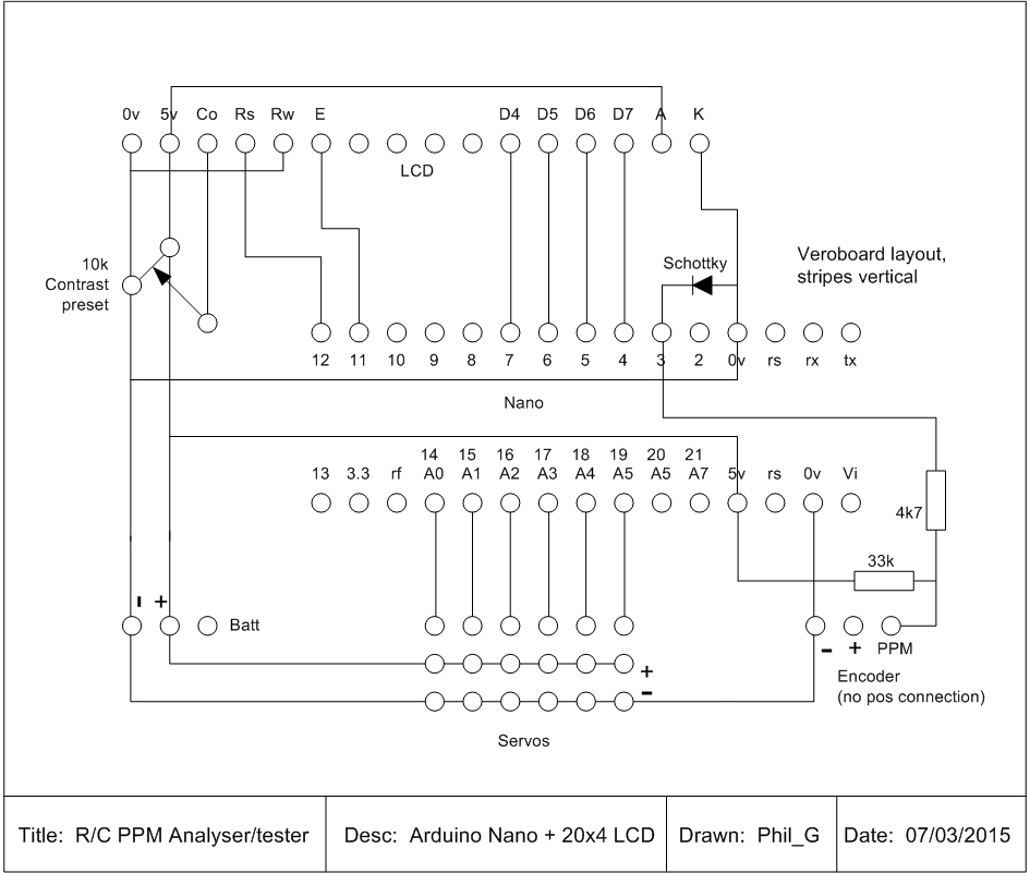

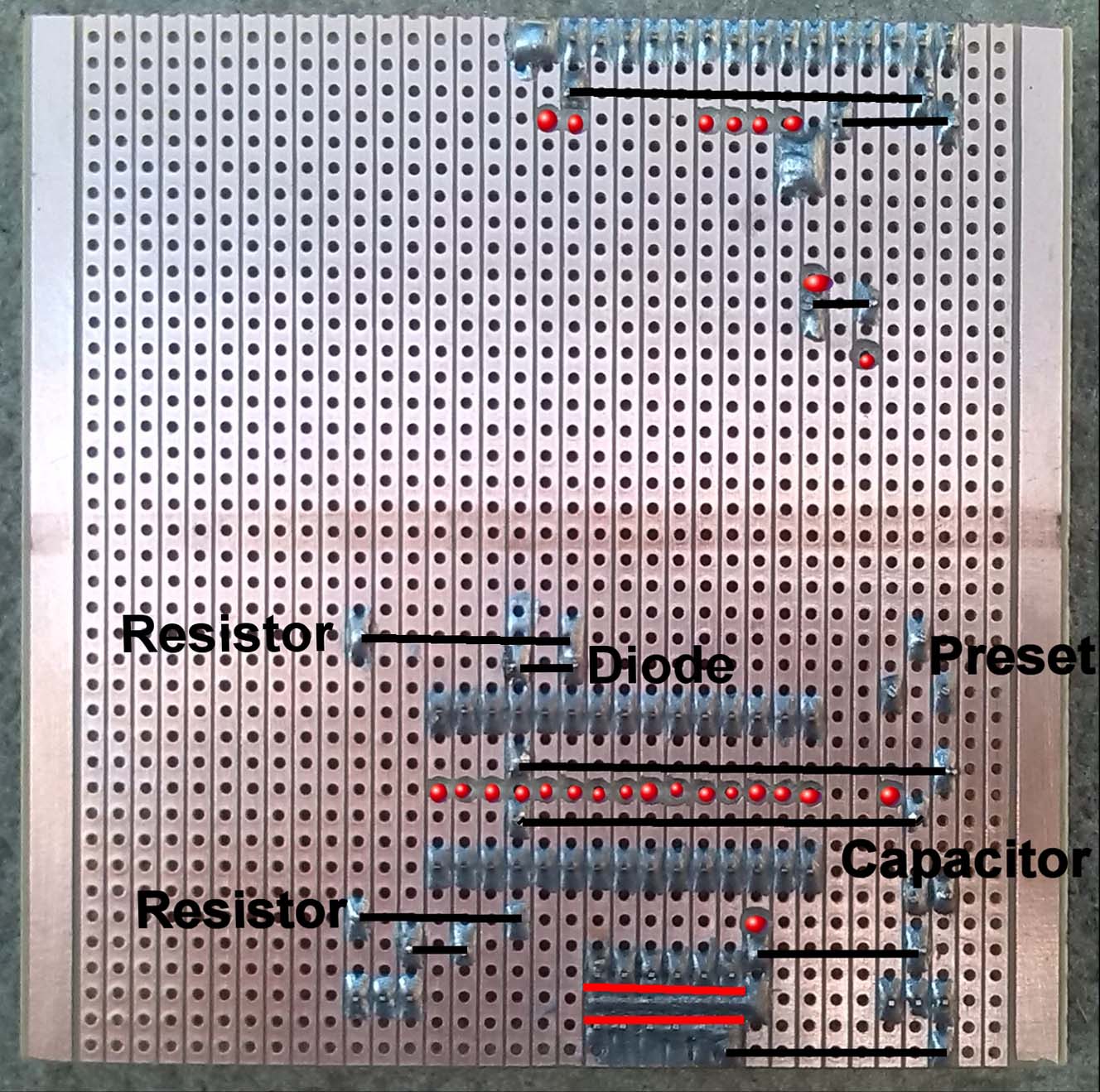

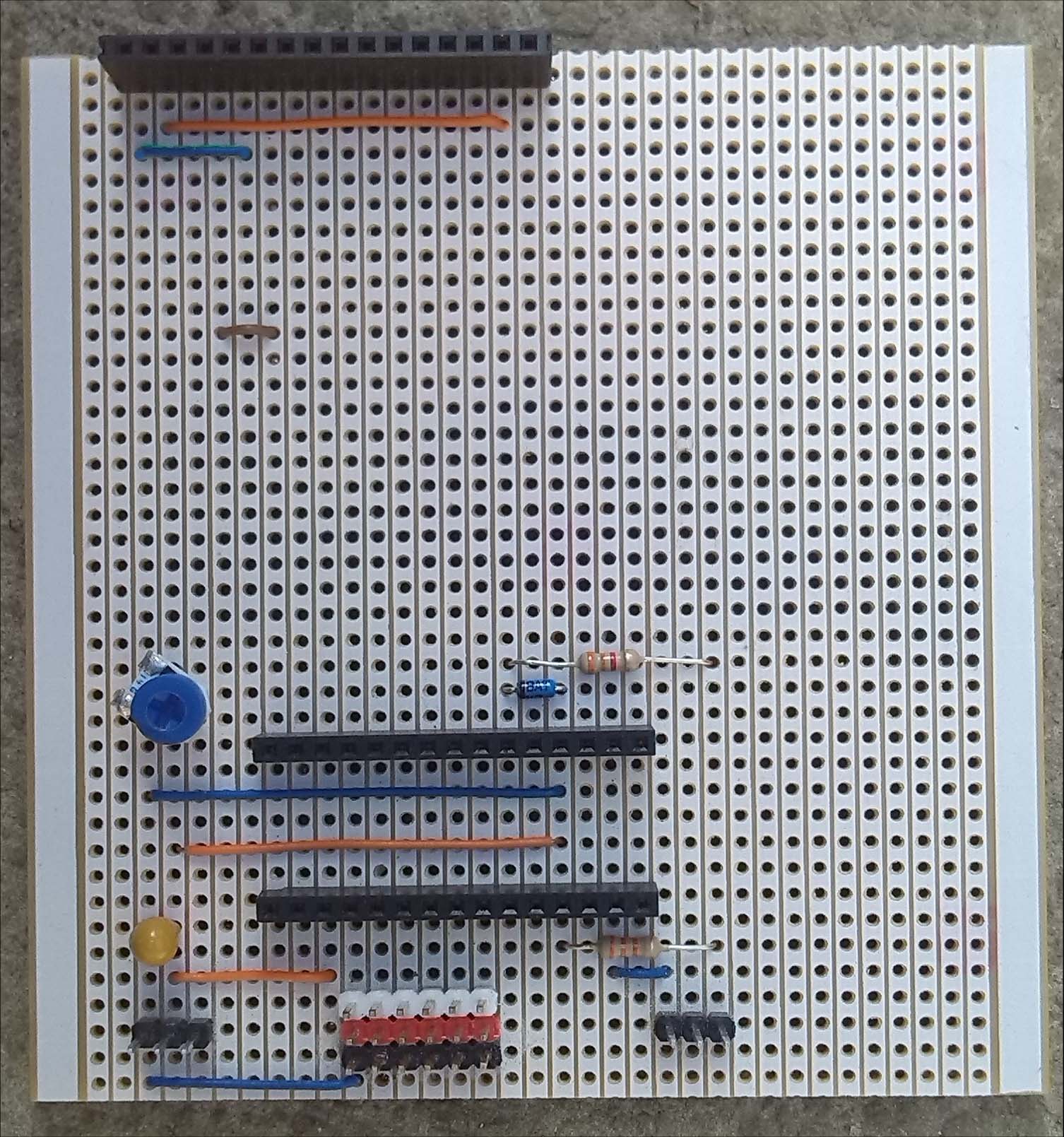

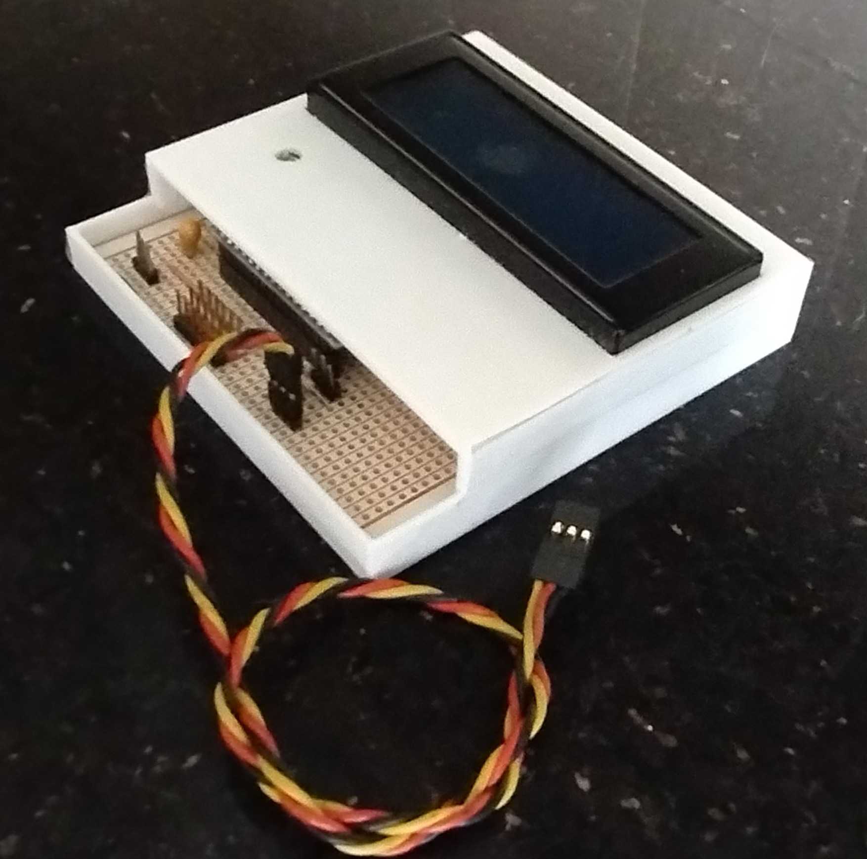

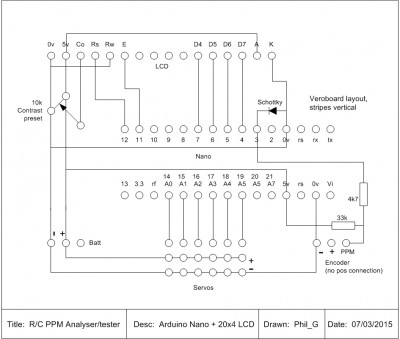

There is very little to it, just a slab of vero, a 4-line by 20-character LCD display from ebay, a Nano and a few headers. I haven't done a detailed vero layout but its very easy to recreate from this drawing, I've aligned as many connections as poss but there are some cuts and bridges to make. The hardest part is the servo block which is 'against the grain' as you can see in the vero photos. Track cuts have to be made between the servo block holes, or you could use a small vero strip mounted at 90 degrees to the mainboard, carrying the pos & neg to the servo block:

Also I forgot to mention that it measures PWM servo pulses too, ie from a receiver channel output:
Here's the diagram which is also a suggested layout:
NOTE the weird orientation of the contrast preset pot - see 'top' photo.

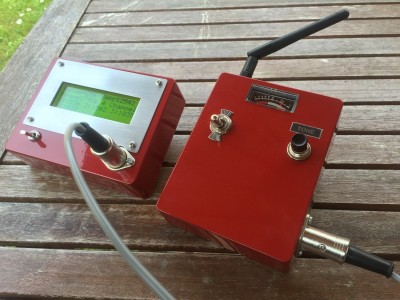

and here's Ron's S/C transmitter connected to the PPM tester...

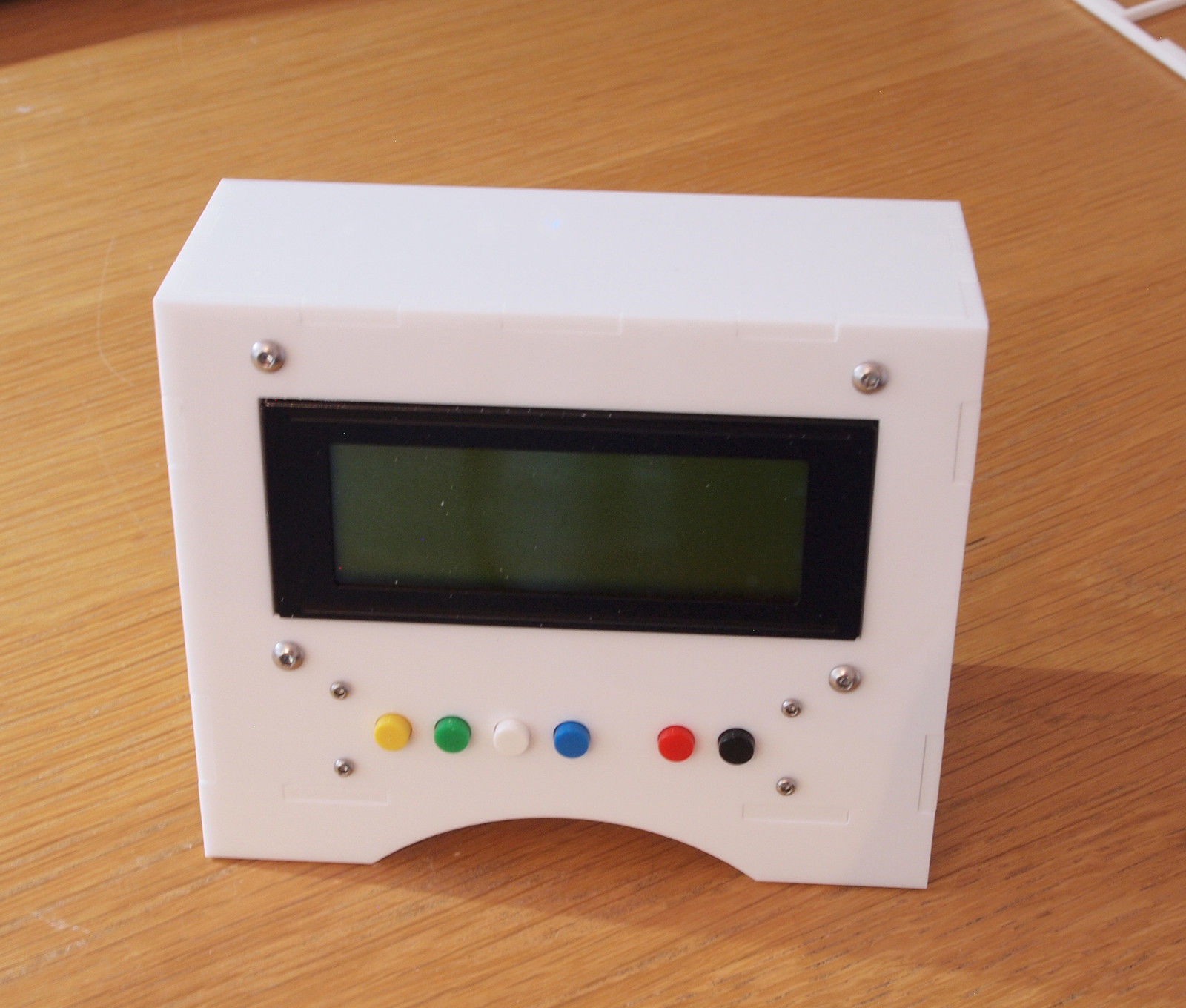

Here's a photo of my finished tester connected to a tranny.
This is a fantastic project thats very easy to build and super useful.
Thanks Phil :P

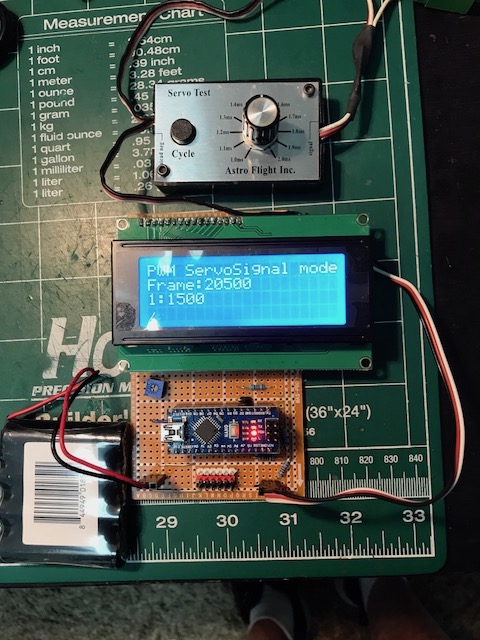

This is the one I built....
1 1/2 yrs on and it is still unboxed but still used to check my projects.
Ade

I had sat this aside for a while and then went to use it. I noticed the servos were real jittery. I couldn't figure it out. I tried plugging in an aux battery and inadvertently plugged in a 2S liPo. Oops...
Now no servos. I went back over the schematic and realized I shouldn't have been supplying Module voltage on the PPM input line, which I was. After some trouble shooting, I realized it just popped the traces where the PPM line came in. I repaired it and plugged in the correct power, after disconnecting the +V line at the PPM plug. All seems well. Servos smoothed right up. I also blew some of the lines in the display but I had a spare just for that occasion.
Question: Can I put a 5V regulator on there so I can use the Vin from the radio? That way I don't need the aux power supply. I get I don't want to drive the servos from the regulator on the Nano.

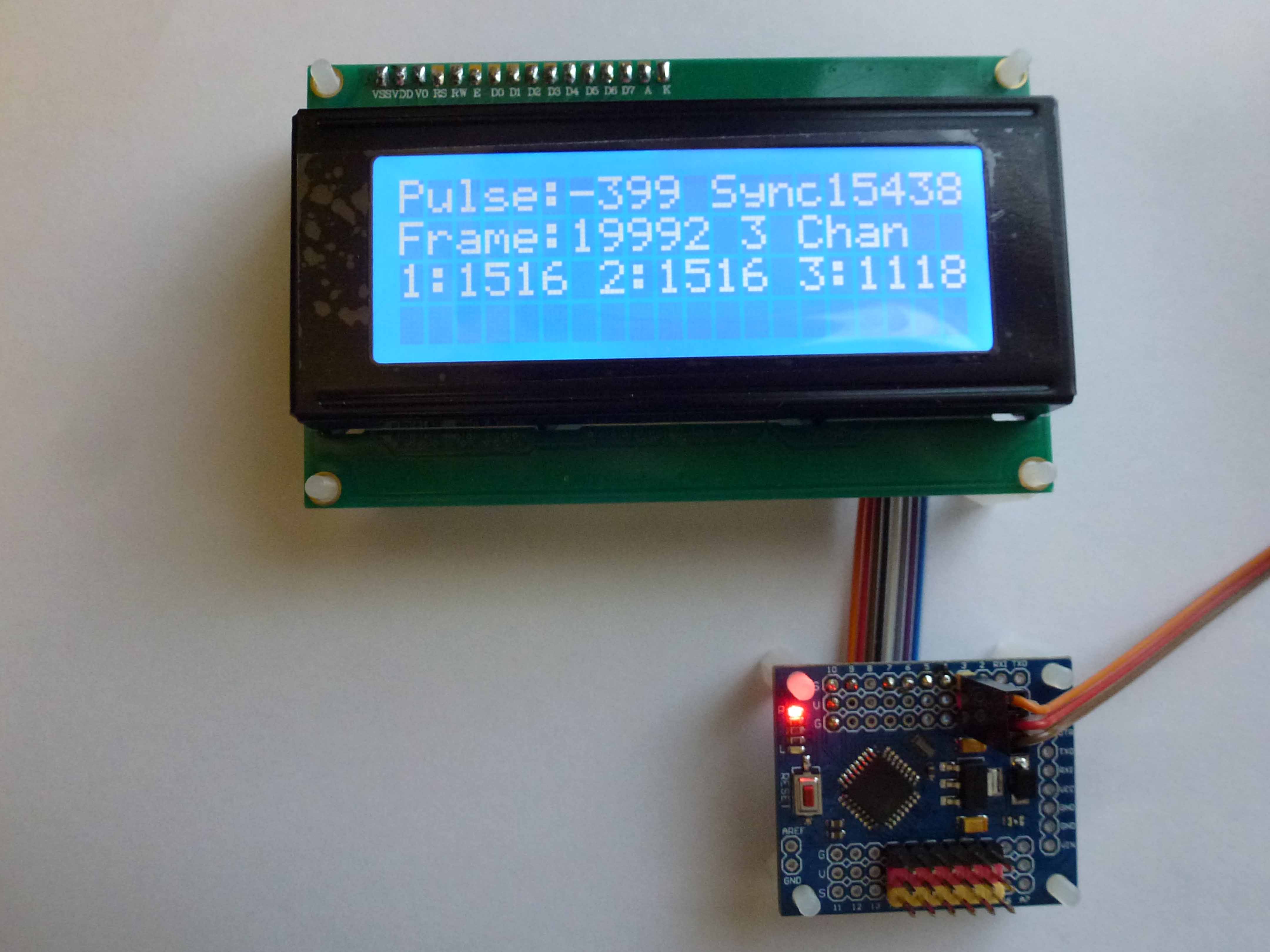

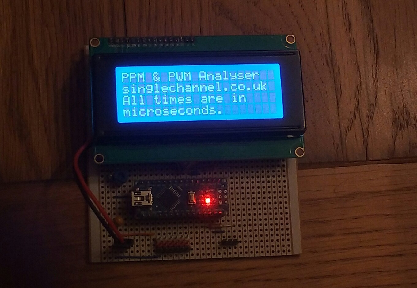

I finally did something creative with the nano I had burned for this project almost 2years ago (you shouldn't rush these things :shock: )

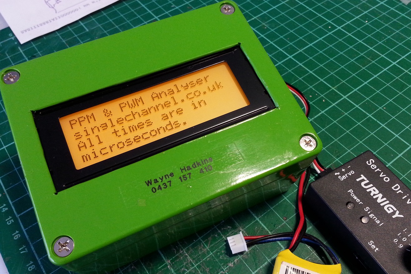

the splash screen
the splash screen
What a great gizmo!! Now that I have mine and have used it "in anger", I wonder why on earth I didn't make it sooner :oops: Thanks Phil, it's a rippa :D

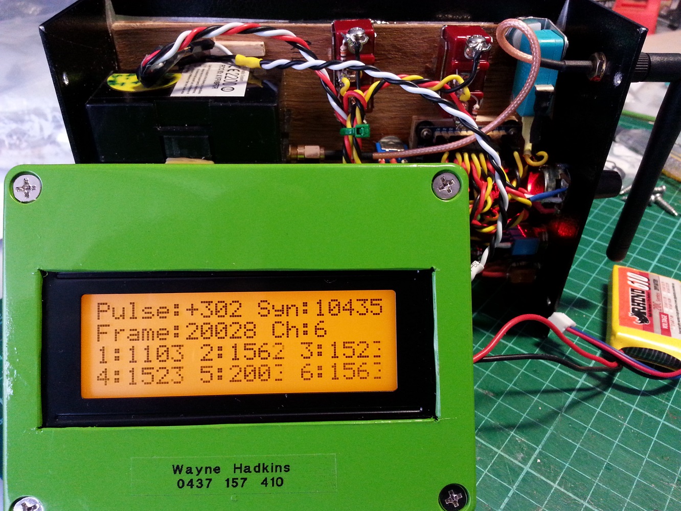

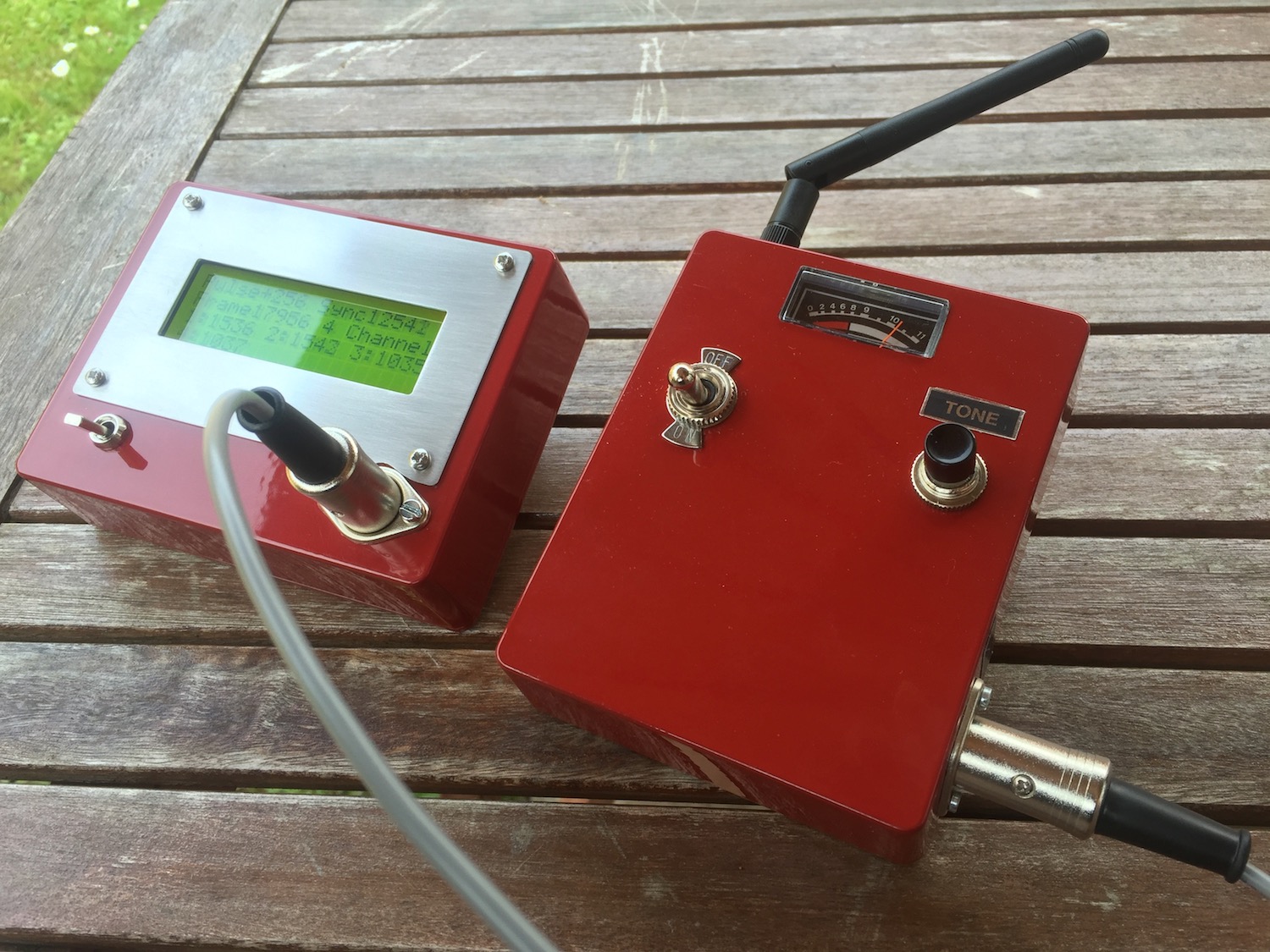

showing the output from my Reed Tx that uses Phil's encoder
connector block in the side of the box

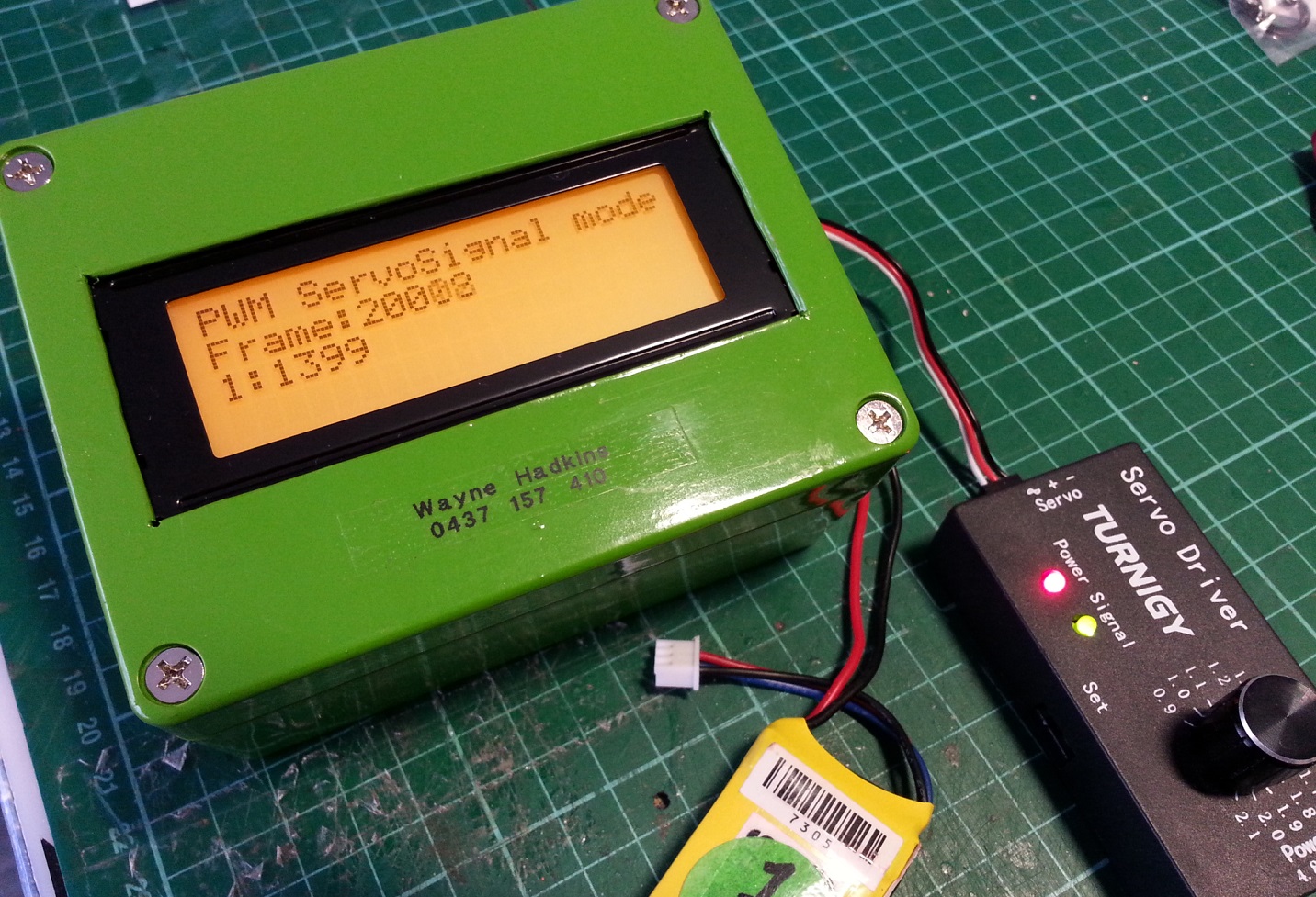

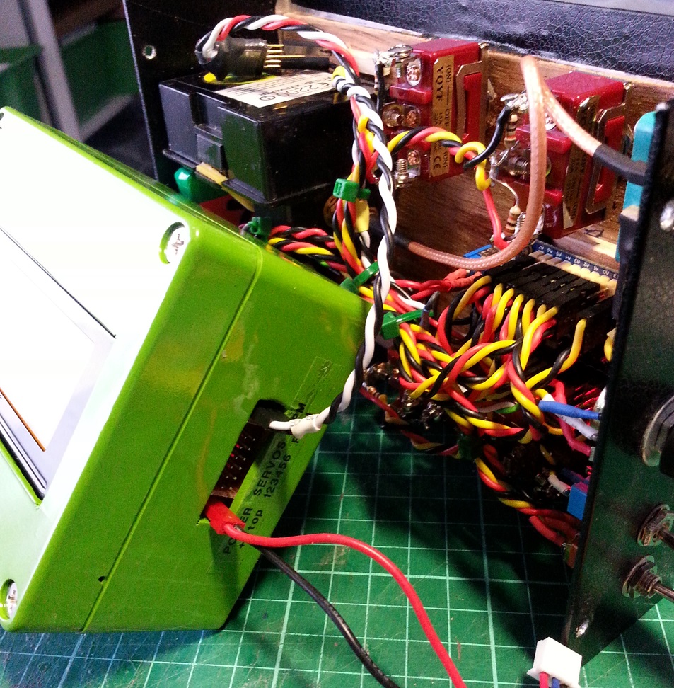

connected to a servo driver

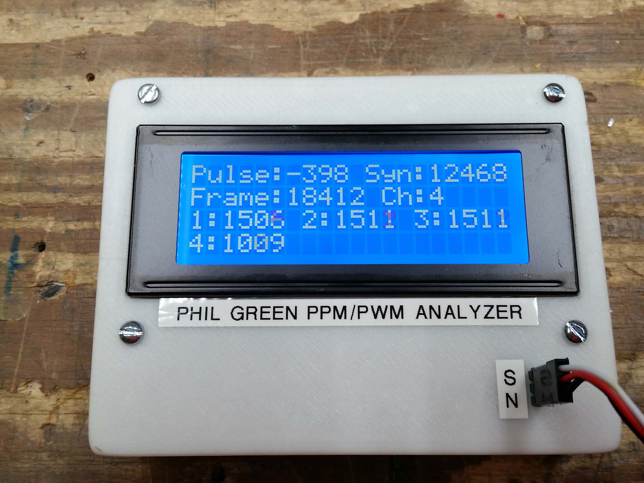

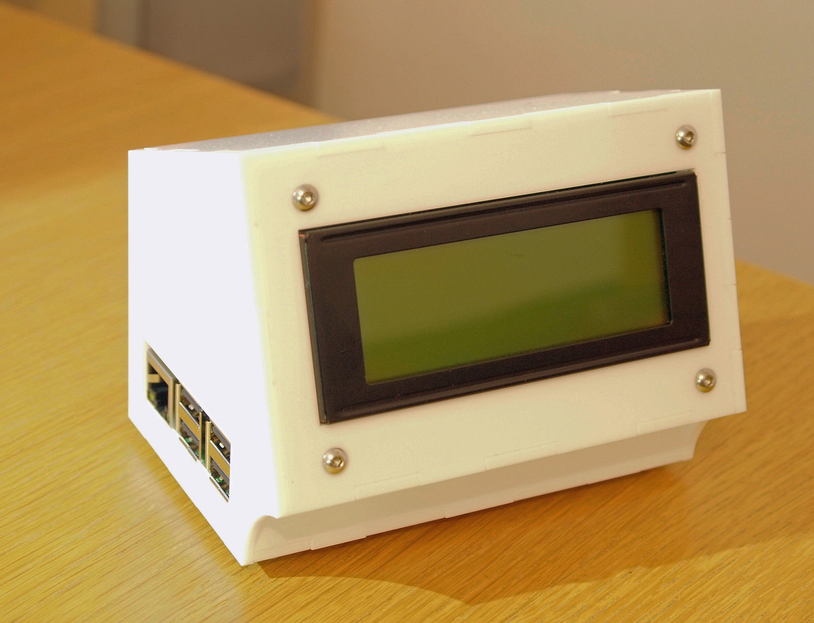

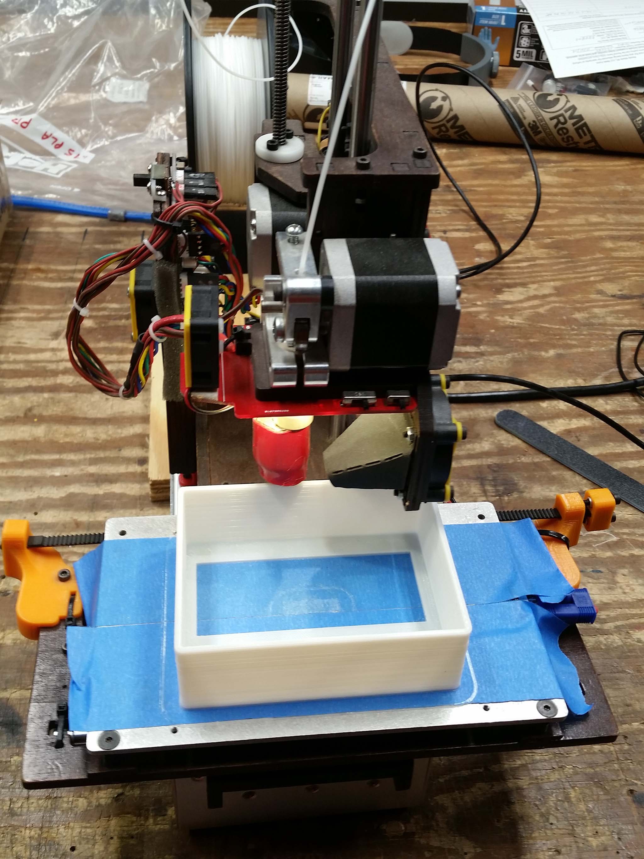

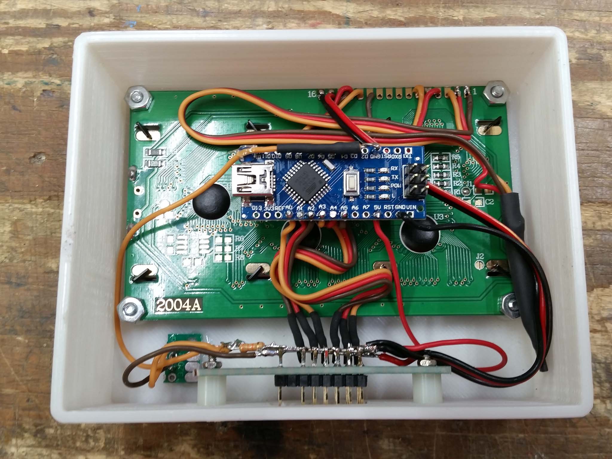

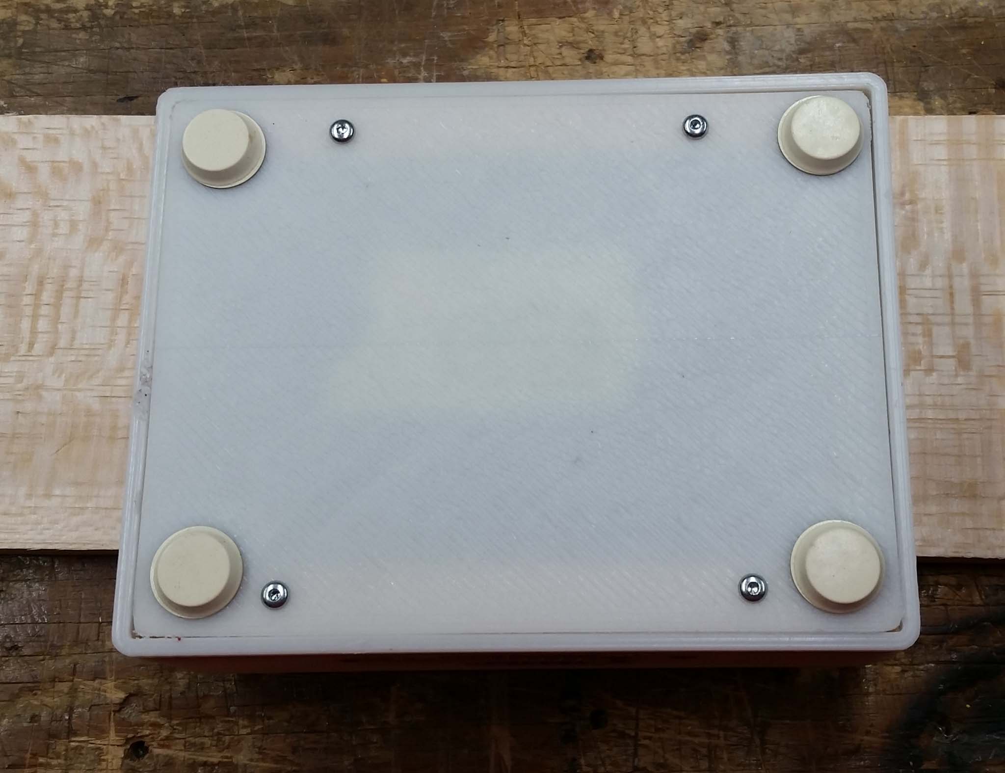

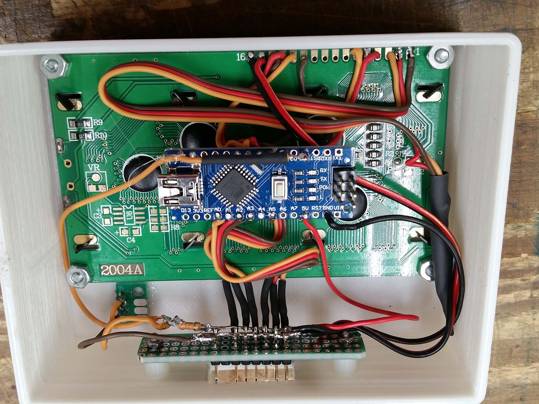

Here's my build of the analyser. Basically wired it point to point. A real test of my 67 year old eyes! I designed and 3D printed the 110x85x40 case for it. If anyone is interested I can email the .stl file to them. The LCD opening was a bit tight and a few strokes with sandpaper got it in. The servo header opening requires cutting out manually.
I altered Phil's sketch to show the "Americanized" spelling of "analyser" to "analyzer" and to allow the splash screen to be displayed for 2 1/2 seconds. This allows an easier read for me anyhow. :D
Thanks Phil!
Dave Rigotti
