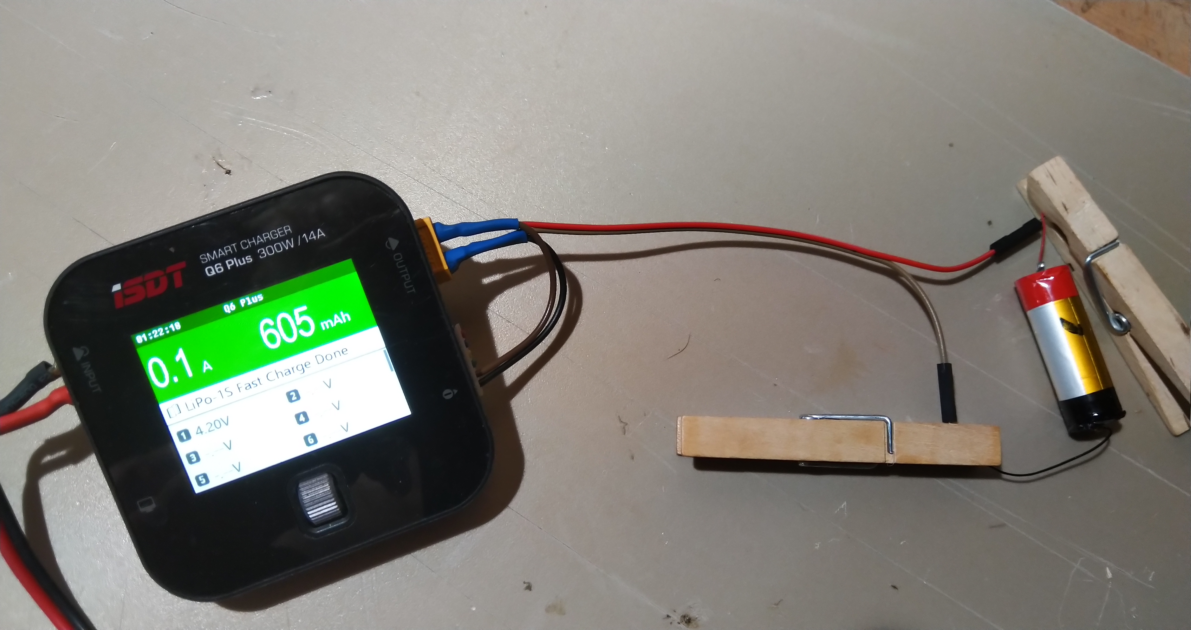

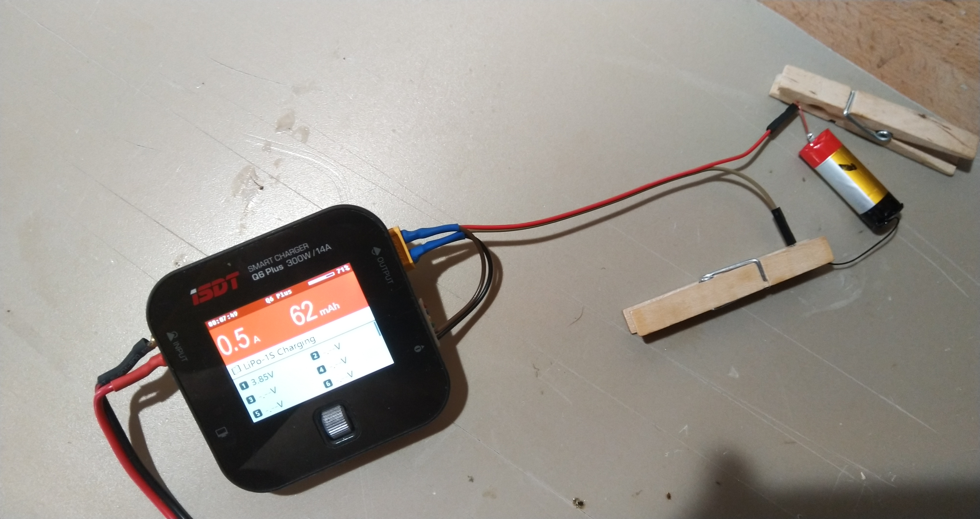

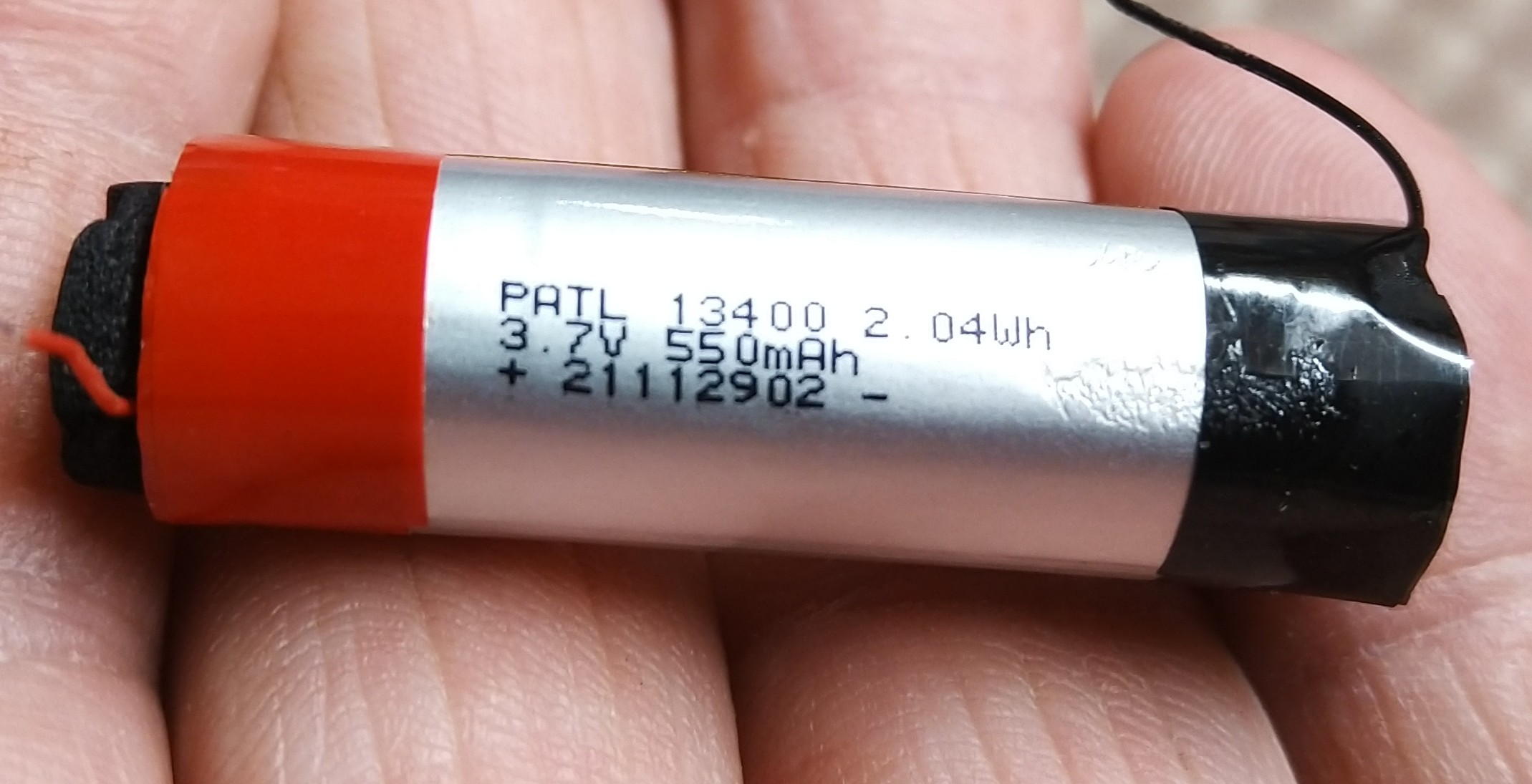

I've been taking Lipo cells from discarded vapes for a while now, Shaun mentioned his dislike of vapes this morning and it made me wonder if anyone else is doing the same? You might cringe at picking up something thats been in some elses mouth, but to me its criminal that these things - full of chemicals as well as a rechargeable lithium cell - are being thrown away like tab-ends. Lithium is in critical supply and these things lay in the gutter until they wash into the drains and poison the water system. Use dog-poo bags or gloves and give them a spray of household disinfectant when you get them home. Prise off the two ends and slide the contents out, if you're squeemish you can do this wearing the gloves or poo bags, and inside you'll find a tubular 550mAh lipo cell. Be careful as the wires are very thin. Snip them to release your bounty, and throw the rest in the bin. Chances are its perfectly good and will recharge just fine. Perfect for an indoor model or a MPX Fox or Lidl glider, or for torches, test gear, or if you're that way inclined (I'm not, why would you?), refilling and reassembling a vape. After a discharge to 3v, the cell in the pic charged to over 600mAh - this is typical, never found a bad cell yet.

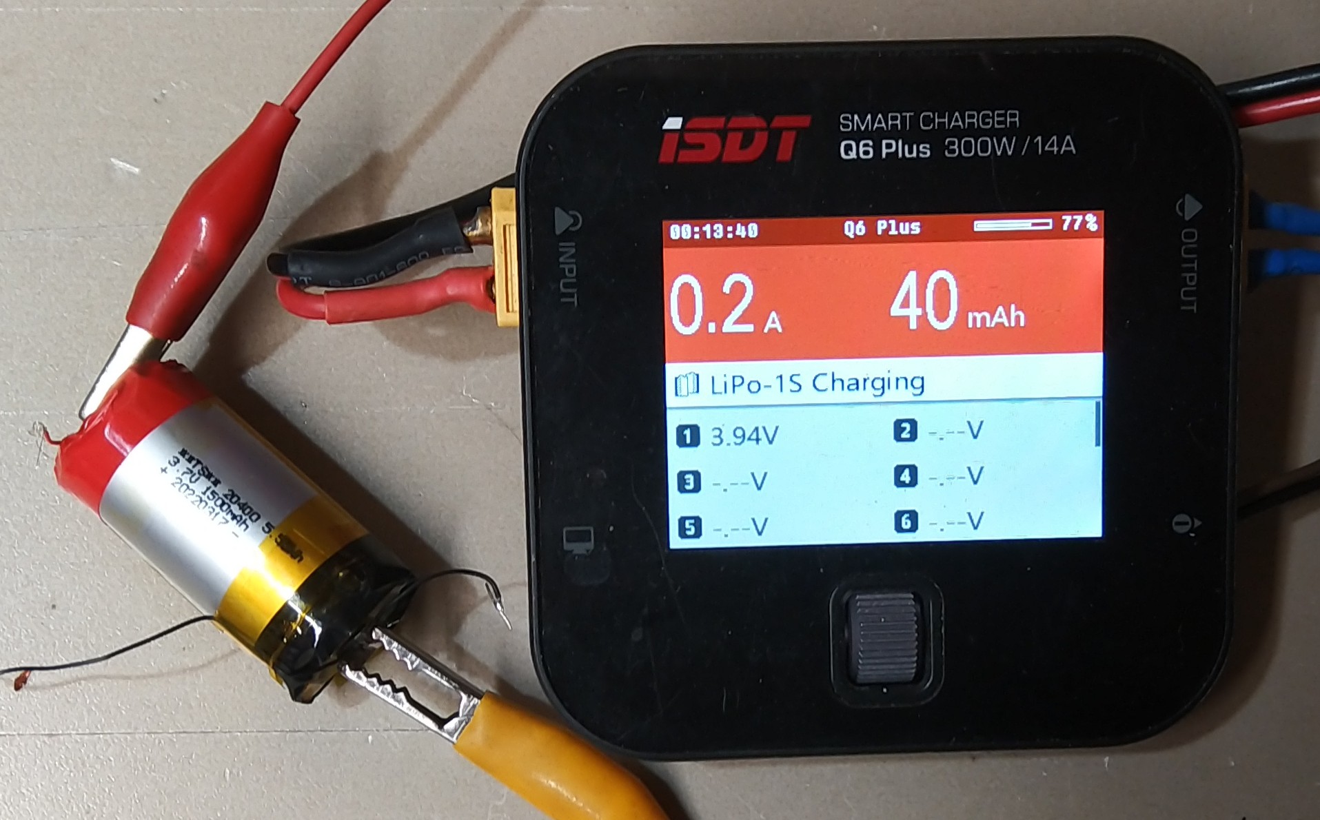

Went down Ponty Park for an hour this evening, arrived to find I had no key, so couldnt get lnto the flying field
I did find a vape though
1500mAh, same length as the usual cells but about 3/4" diameter. Ideal for the next Lidl Glider!

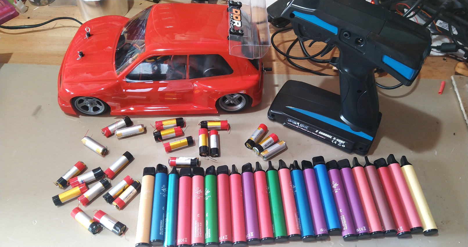

This week's haul, some dismantled & 22 still to do.
Quite apart from the joy of free batteries, imagine how much toxic lithium would have dissipated into the environment....
