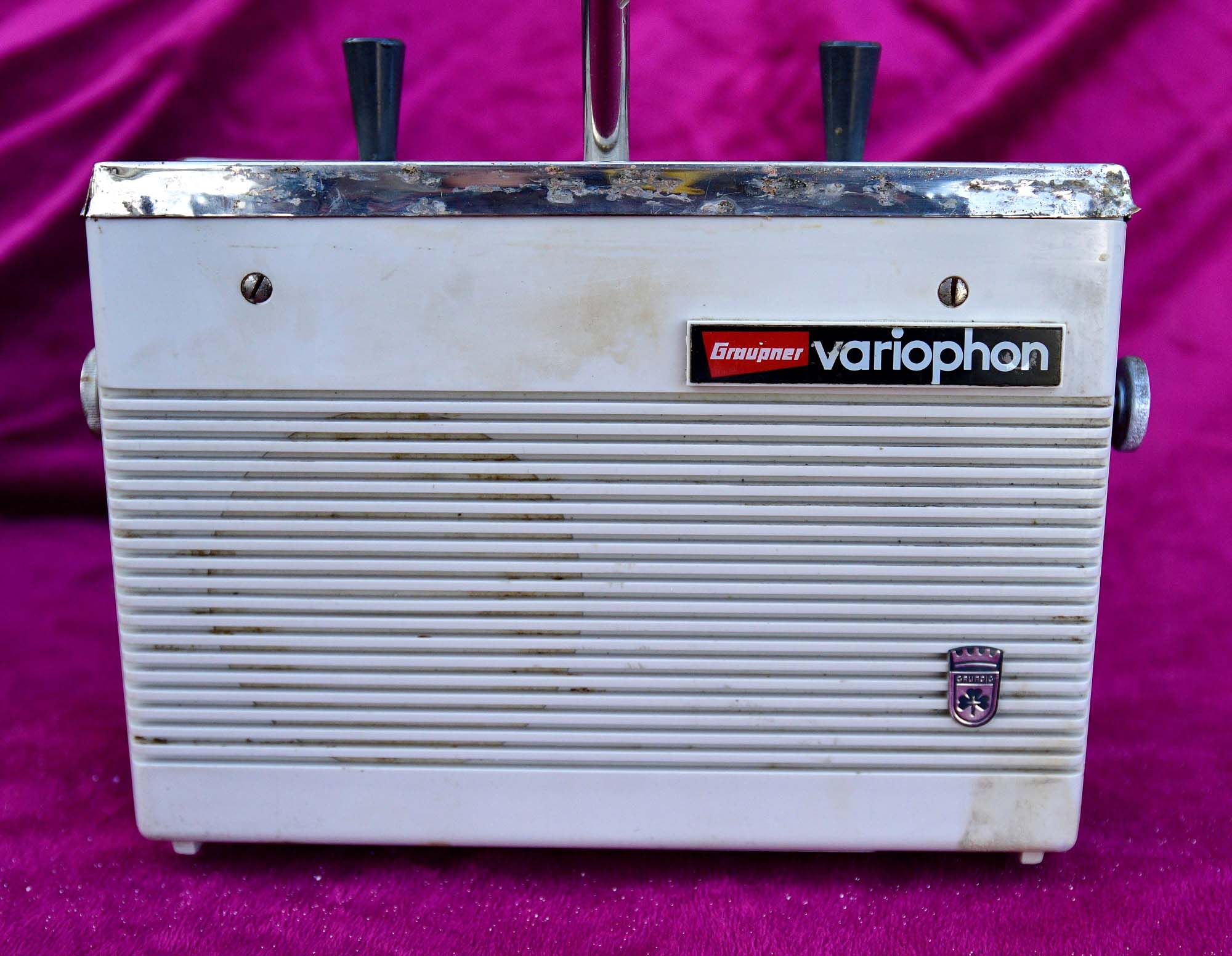

Jonathan Turner visited yesterday clutching his newly acquired Variophon 10 from Mike K after the Ivinghoe soaring meet last weekend.
It looked like it had a fair bit of Patina shall we say ?!?, didnt take a before photo but here is the after shot following attacking the badly corroded chrome trim with white vinegar and wire wool. The case had a lot of sellotape on it so EvoStick adhesive remover and methanol were used to clean the plastic up...He now has a set that can be displayed nicely alongside his Variophon 2.

It certainly looks better than it did last week! It was so badly corroded that I never opened it up, I suspect the internals and joystick switches will be corroded beyond use for a conversion.

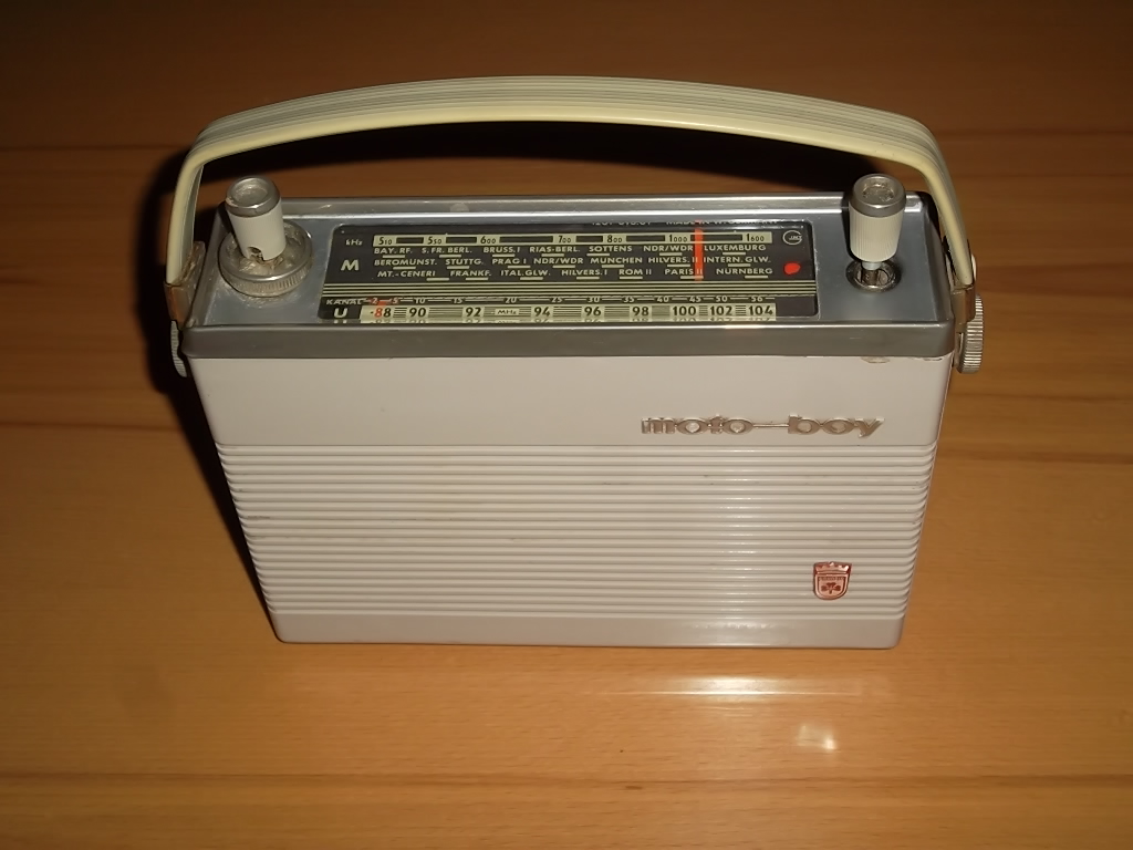

Jonathan's set is the older Variophon model (not the Variophon S) and used the case from the Grundig Moto-Boy portable transistors radio, if you look closely on the front left of the case you can see a circle where the speaker was fitted in the Moto-Boy. By the later S model, the speaker aperture had gone, but it was still basically the same case. I bought a Moto-Boy from eBay.de a few years back to have the complete Grundig set and the main case is identical.

I can help out with a photo of my Moto-Boy. The Variophon 10 is a very nice radio set. I used mine (converted to 35MHz) last week to fly a Graupner FW Piaggio 149 and a Graupner Consul.

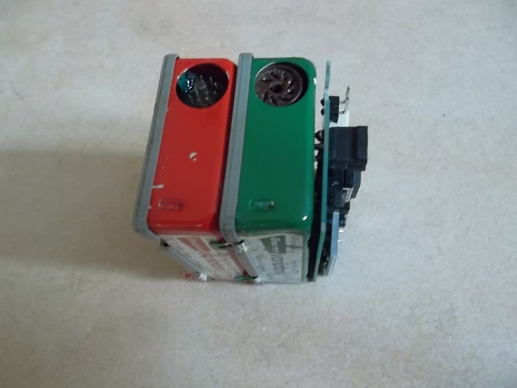

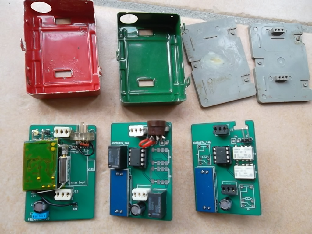

I was thinking about using an old Graupner Bellamatic or Servoautomatic with a modern receiver and that is what came out: In the red Varioton compartment is a modern 35MHz Yeti receiver and in the other Varioton cases (green etc.) are the drivers for the Servos.
A Bellamatic or Servoautomatic etc. can be connected with the original round connector. Even the power supply including the antenna can be connected with the round connector.
Required are 4.8V. The servos are using 2.5V, so a step down voltage regulator is added for that in each Servo-driver add-on.
The PCBs are drawn by me using Kicad and JLCPCB made the boards which look very professional.
The servo-driver consists of an Attiny85 and two relays.
Works great and looks very realistic.
I did two versions, the first will shorten the servo-motor connection when no voltage is applied. This results in a very slow movement when the Bellamatic returns to neutral.
The second version will keep the mototr connections open and the Bellamatic will return much faster to neutral (spring loaded).
I also did a PCB for one, two or three servos to just connect them to a modern receiver (2.4GHz or 35MHz) without the use of the old Varioton cases.
You can use any Reeds or even proportional transmitter to operate the unit, it just had to pair with the receiver. Of course when using a propo Tx, you still get only a reeds-like reaction of the servos.
For those of you interested in building one, here are the Kicad files:
