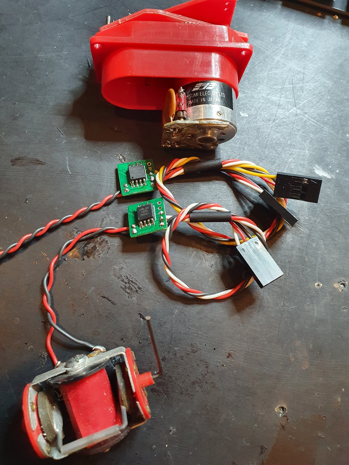

Let me share with you the latest in GG-Recoder

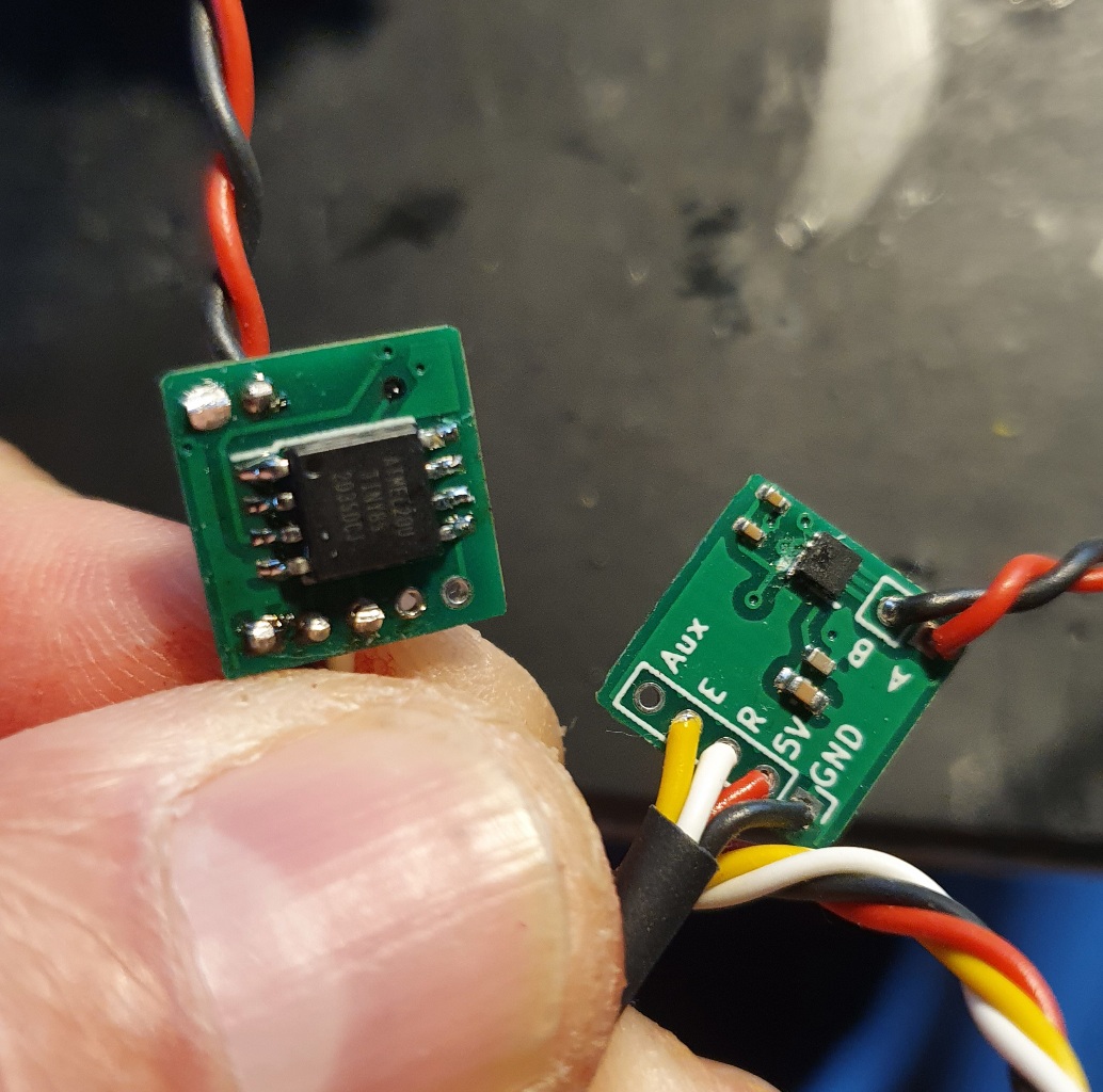

The size is 12mm square.
This Recoder has integrated in the PC-board the H-Bridge based on a DRV8838 and uses an ATtiny85 as processor.
The software is based on Phil's and Mike's work, the same board with some tinkering will work with all original GG actuator as there is a PWM function to set the proper voltage and ofcourse all the Tobe versions.
For the purist there's a the 3rd channel/throttle option that makes the actuator to properly cycle which was how the throttle was originally controlled.
I will have them available in a couple of weeks pre-programmed in accordance with the requested version: original GG and Adams -actuator in 2.4V 3.6V & 4.8V. The imput voltage to the Rx will remain the same, 4.8V - 5.2V but the output to the motor is PWM controlled and will be in accordance with the spec of the intended actuator
