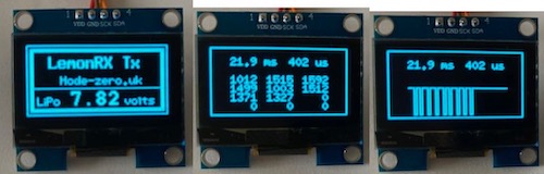

So after a bit of toil and some coding that'll probably make some cringe, I have implemented a third screen for the trace in the case of channels >6.
Tx Meter 3 screens
Tx Meter 3 screens
It'll still show the trace on second screen for the case of channels<=6
Tx Meter screen 2 with trace
In case its useful, I have put the sketch here and the circuit with notes here.

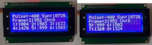

Next up was Phil's PPM/PWM Tester using an I2C display as suggested by Ron. In all honesty, had I followed Phil's original circuit I would have left alone.
Not much of a change is needed to implement the I2C version, except I couldn't make use of the vendor suggested library and it appears its another 'no longer maintained'. So I find h44780 and with a few changes it all works. Except, well...it would be nice to be able to see and output all 8 channels I had. I could have swapped the channels around in the Tx I suppose but... So after a bit of thought and some code adjustments its now multi screen and servo-outputs are in blocks of 4.
PPM/PWM tester multi-screen
In case its useful, I have put the sketch here and the related circuit and notes here.
