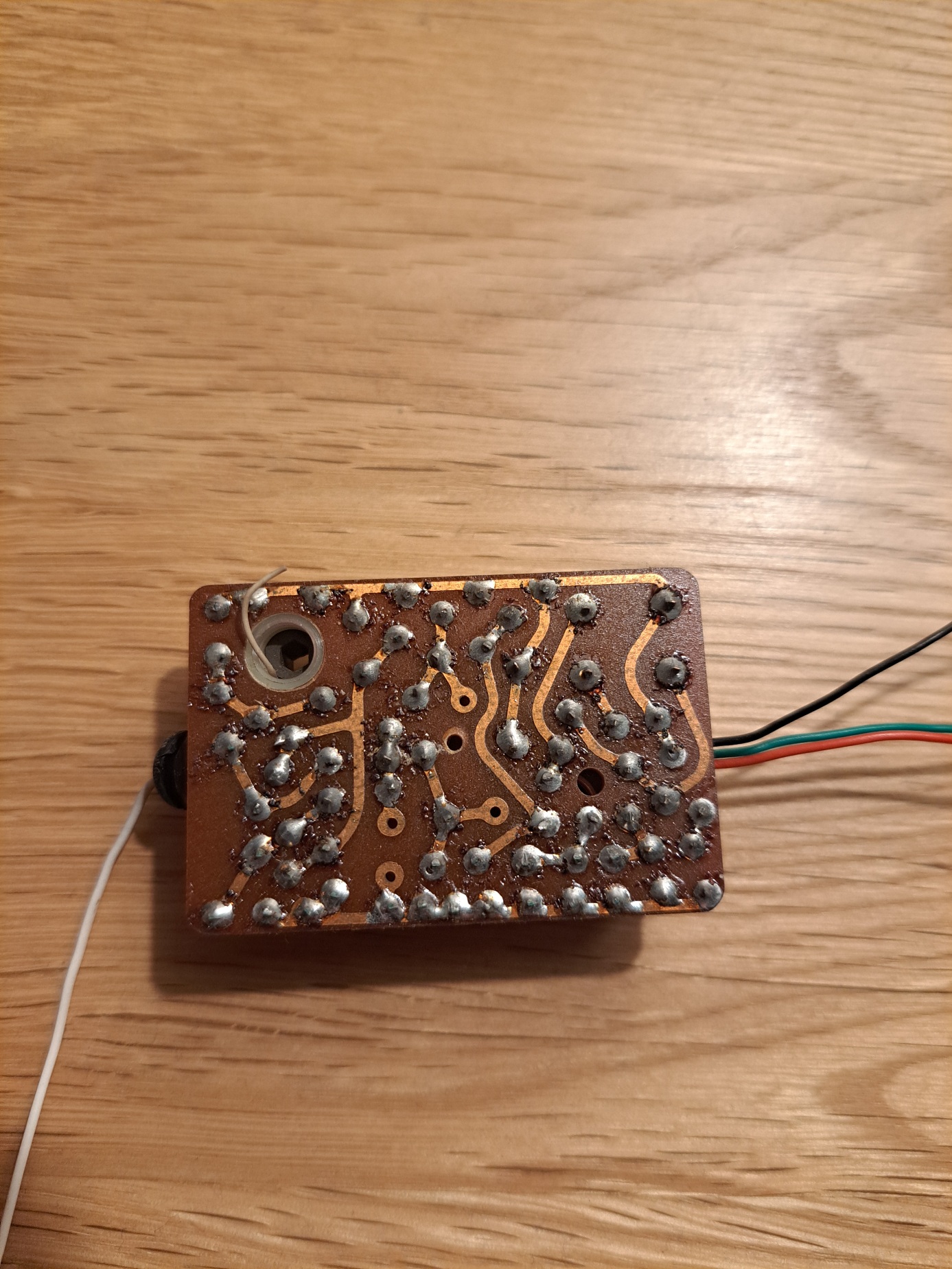

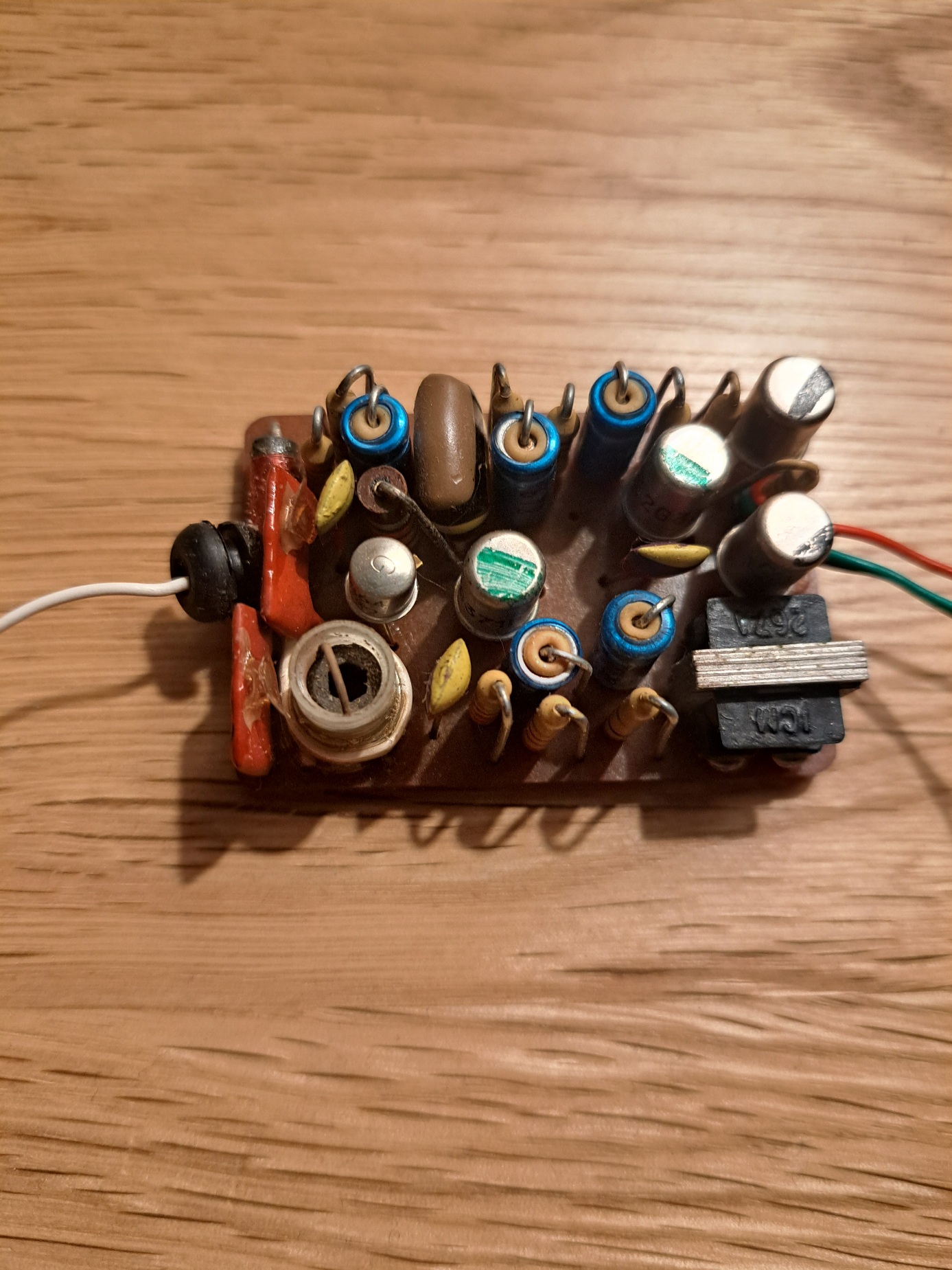

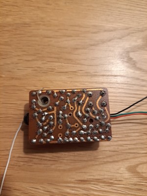

Hi chaps
I took it out of its case for pictures. I think...its an RCM&E receiver?
Re: Elmic Commander chattering...
100% certain thats an early Macgregor Stew, pre "blue anodised aluminium case" era, the one in the half-blue, half-clear plastic case.
Thats a superregen receiver, very high gain, so without a transmitter switched on it will chatter as it picks up random noise.
Thats perfectly normal and expected. Once it receives a constant unmodulated carrier it will stop chattering.
In a nutshell you need a nearby S/C tone transmitter to be switched on. The escapement should follow the tone button.
Assuming the tx is good and 'on', then if you still have chattering, my suspicions would be with the rx rather than the escapement, you can test the escapement by directly connecting a battery.
