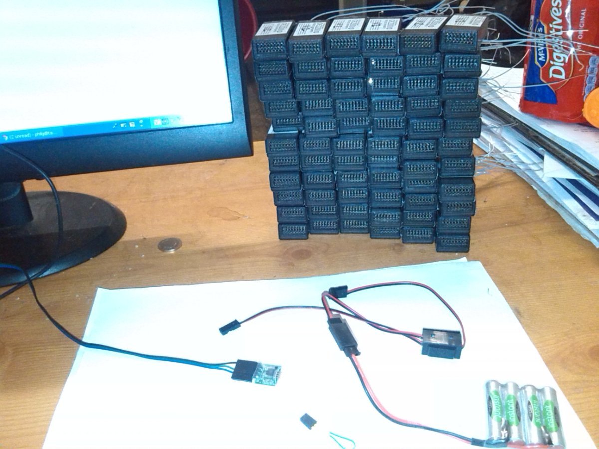

Re: Frsky XJT-Lite
There were two D8 versions Pete, when D8 was first introduced as version 1 it ran for a couple of years, then they introduced V2, definitely two versions.Pchristy wrote: 27 Nov 2022, 13:05 The versions only apply to D16. There was only ever one version of D8.
At the time I was quite friendly (in the net sense) with Rob at Giant Cod and had hundreds of V1 D8 receivers to update to V2.
It was over 10 years ago, I cant remember but I'm pretty sure I did a batch for Richard at T9 too.
I kept a V1 for testing and I probably still have the files somewhere
Heres one pile of many undergoing surgery:

Your D8 receivers will all have been V2 Pete, V1 and V2 were completely incompatible, control and telemetry. When V2 was annouced we caught most of the UK stock before they were sold. By then Frsky themselves had already switched to V2. I flashed a lot of D8 receivers for Giantcod & T9. Having made the change, subsequently Frsky never referred to versions or to any update to D8 - like it hadnt happened! I was on Frsky's beta for V8 and D8
I havent found the files yet but here's where it was discussed (in 2013, a year after its release):
https://www.rcgroups.com/forums/showthr ... st25555412 (and a few prior posts)
The V1 to V2 update was a major D8 protocol change and mutually incompatible as you can see from Frsky's document attached
For some reason this update seems to have been swept under the carpet, it doesnt even get a mention in the RCG "History of Frsky" thread
Heres a Frsky document which confirms my recollections:
