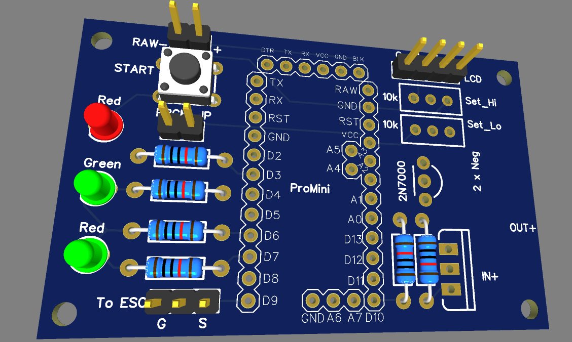

Below is example of a starter board for my scale model Rivierra boat.

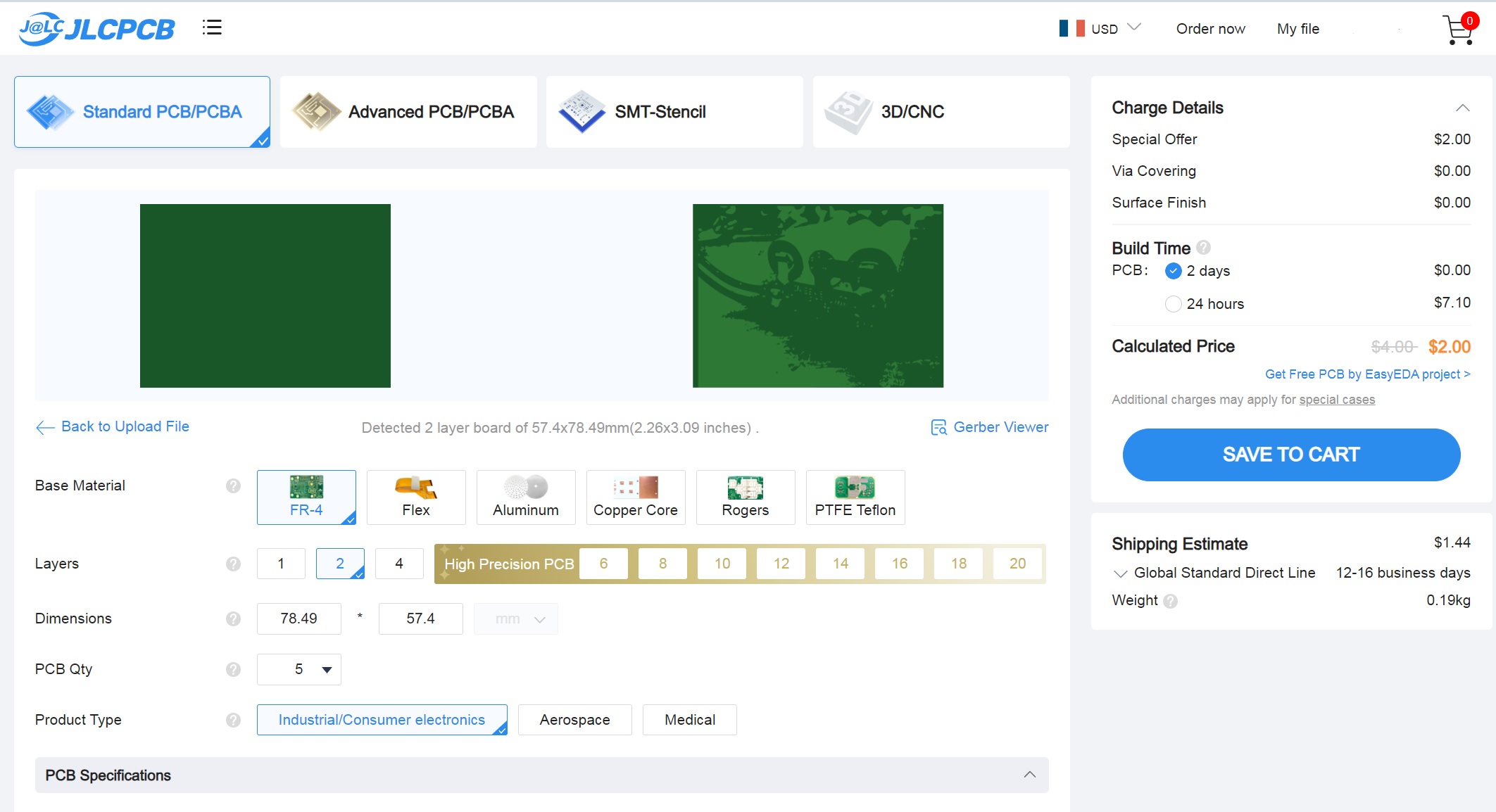

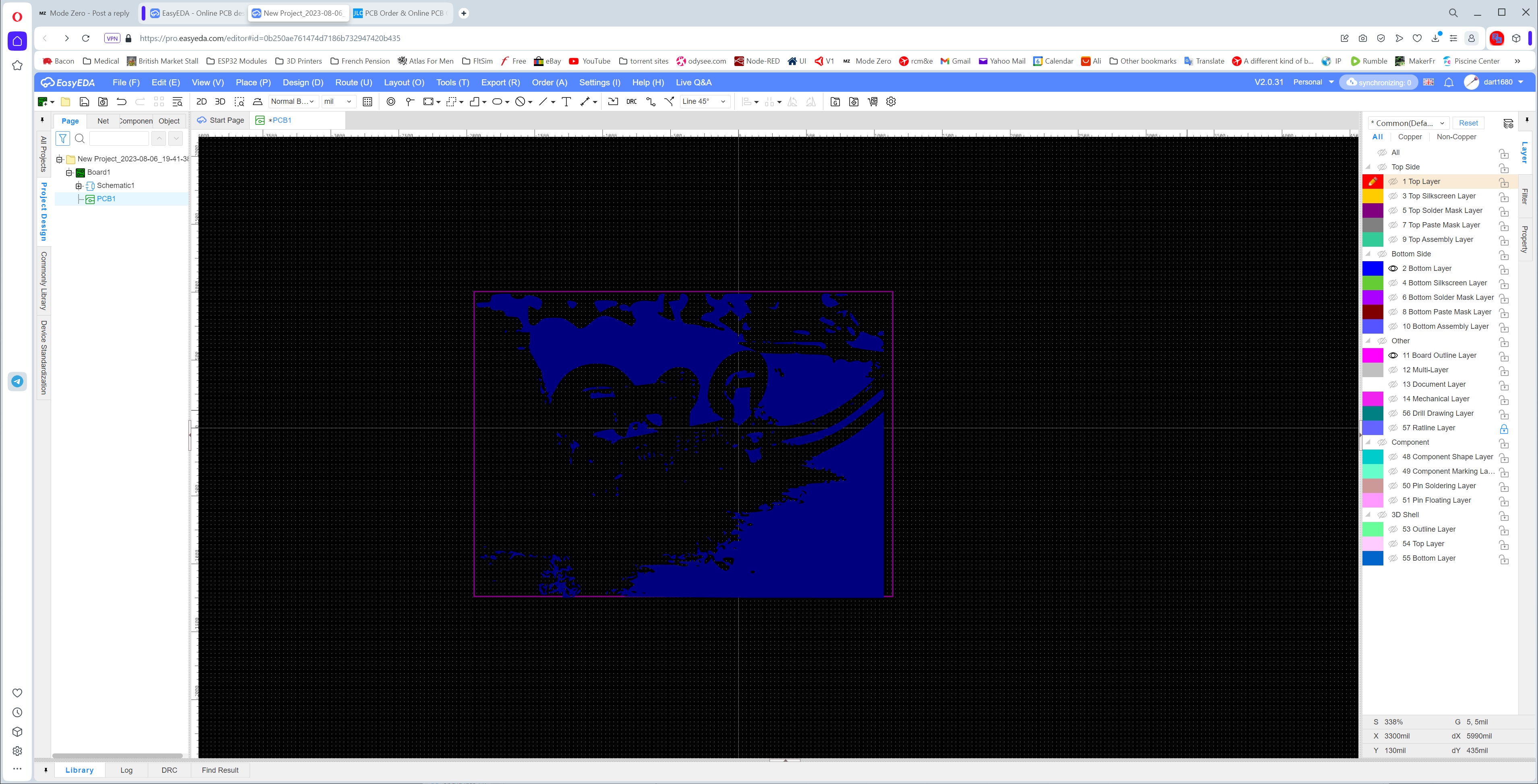

I think you can actually import an image into easyeda designer - but it has to be the pro version. I have never used it so cannot attest to how easy or effective it is but the ability is there.

Yes, there is. You can change any selected items layer, so if choose the top or bottom copper layers it should work.

Design I showed about took maybe an hour from beginning to (orderable) end.
