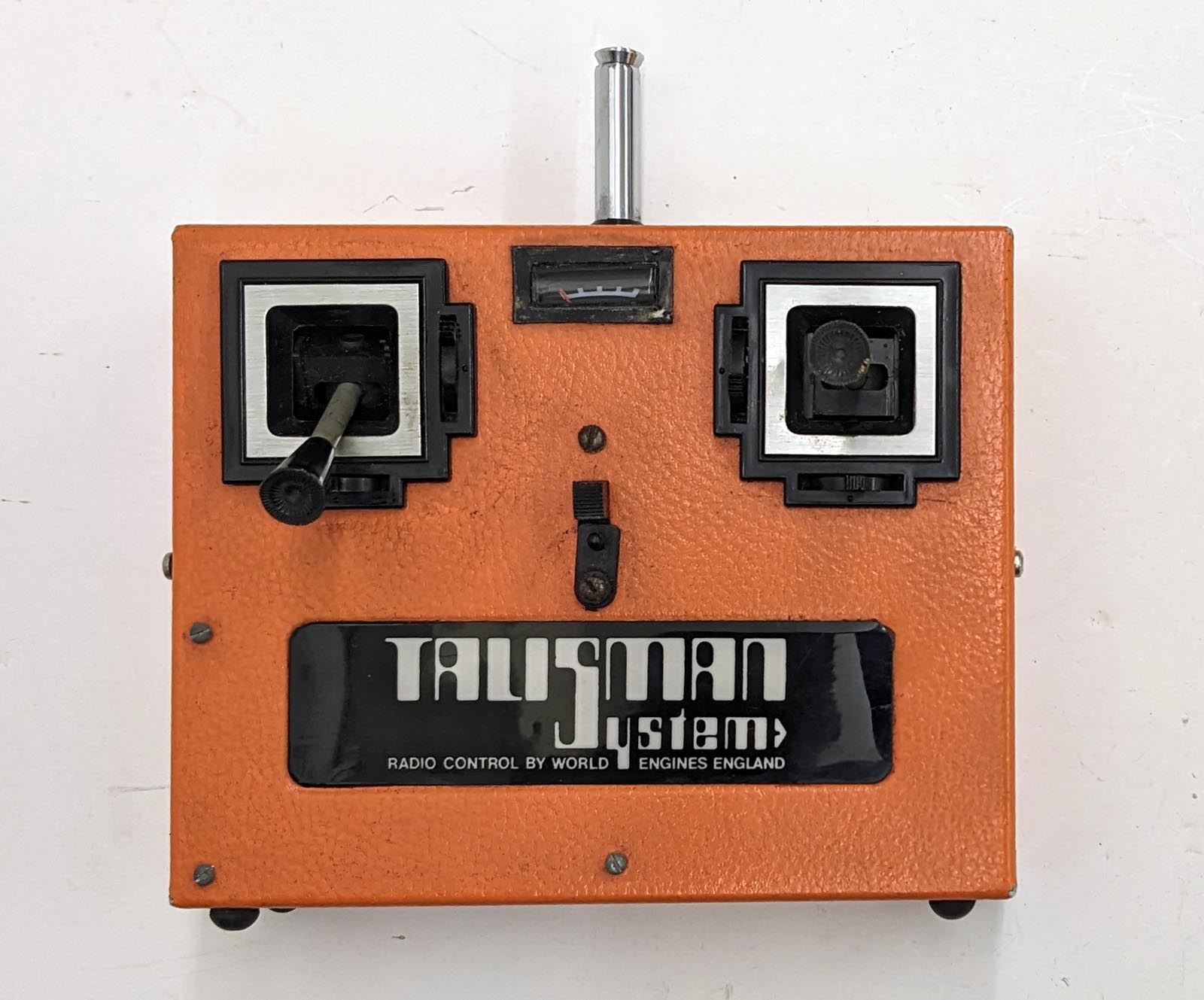

The orange case indicates that's quite an early one! However, it looks as if the original encoder has been replaced by a 5044 "piggy-back" board. Not in itself a problem, but the 5044 was very prone to RF pick-up, which resulted in neutral drift as the aerial was extended or collapsed.
The only cure I found for it was to build it on a double-sided board, with a ground plane on the component side.
Those early 35MHz receivers were pretty bullet-proof! I never heard of one suffering any glitching or over-loading at close range.
Would make a nice conversion to 2.4 GHz!

Is the location of the battery charger DIN socket a standard place on the front next to the joystick? All my Talisman sets have the charging socket on the bottom?
- Posts: 494
Re: Talisman on eBay
No, charging socket on the bottom was standard. The one on Ebay has been "modified" - quite a bit, from the look of it!
