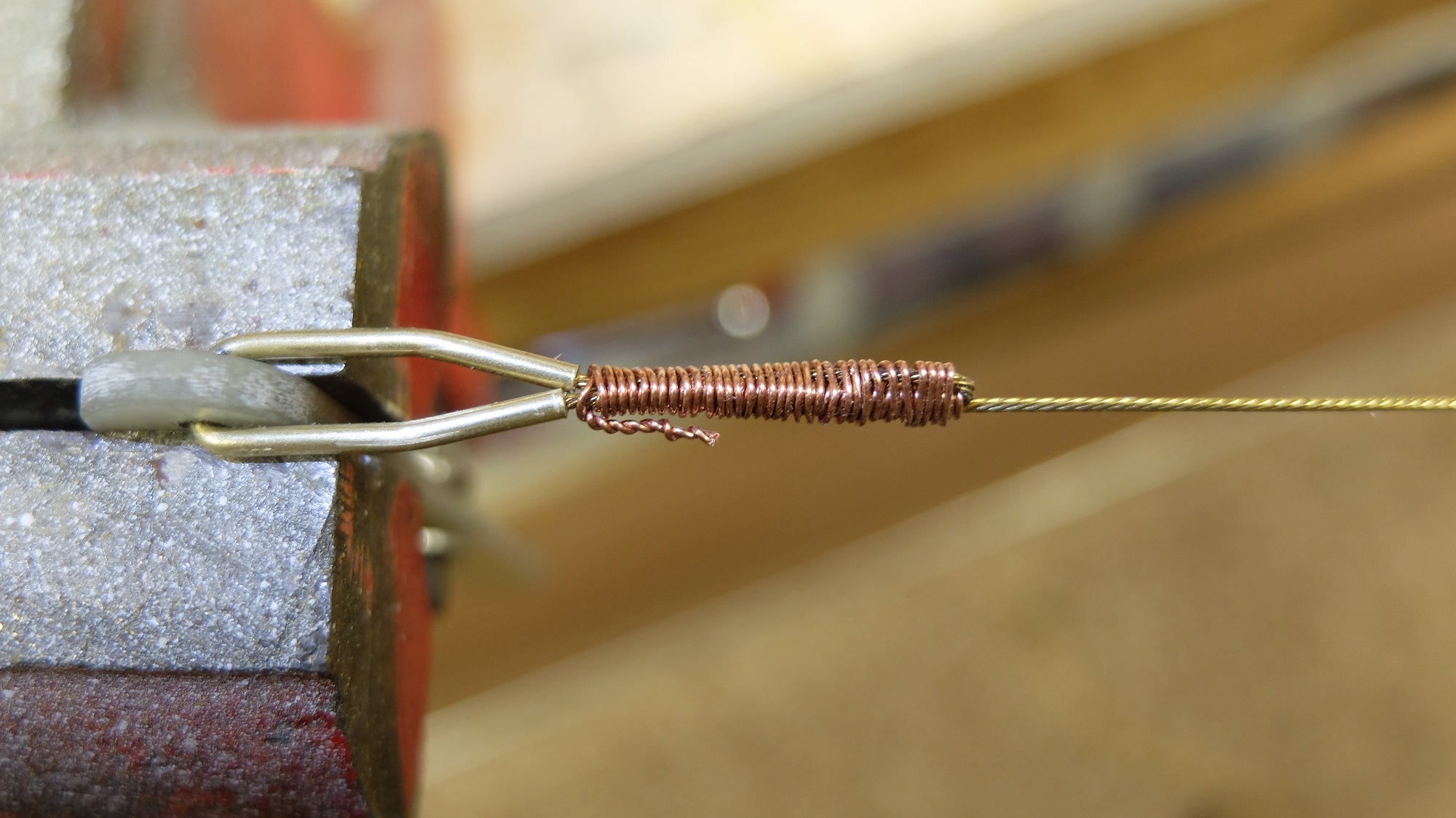

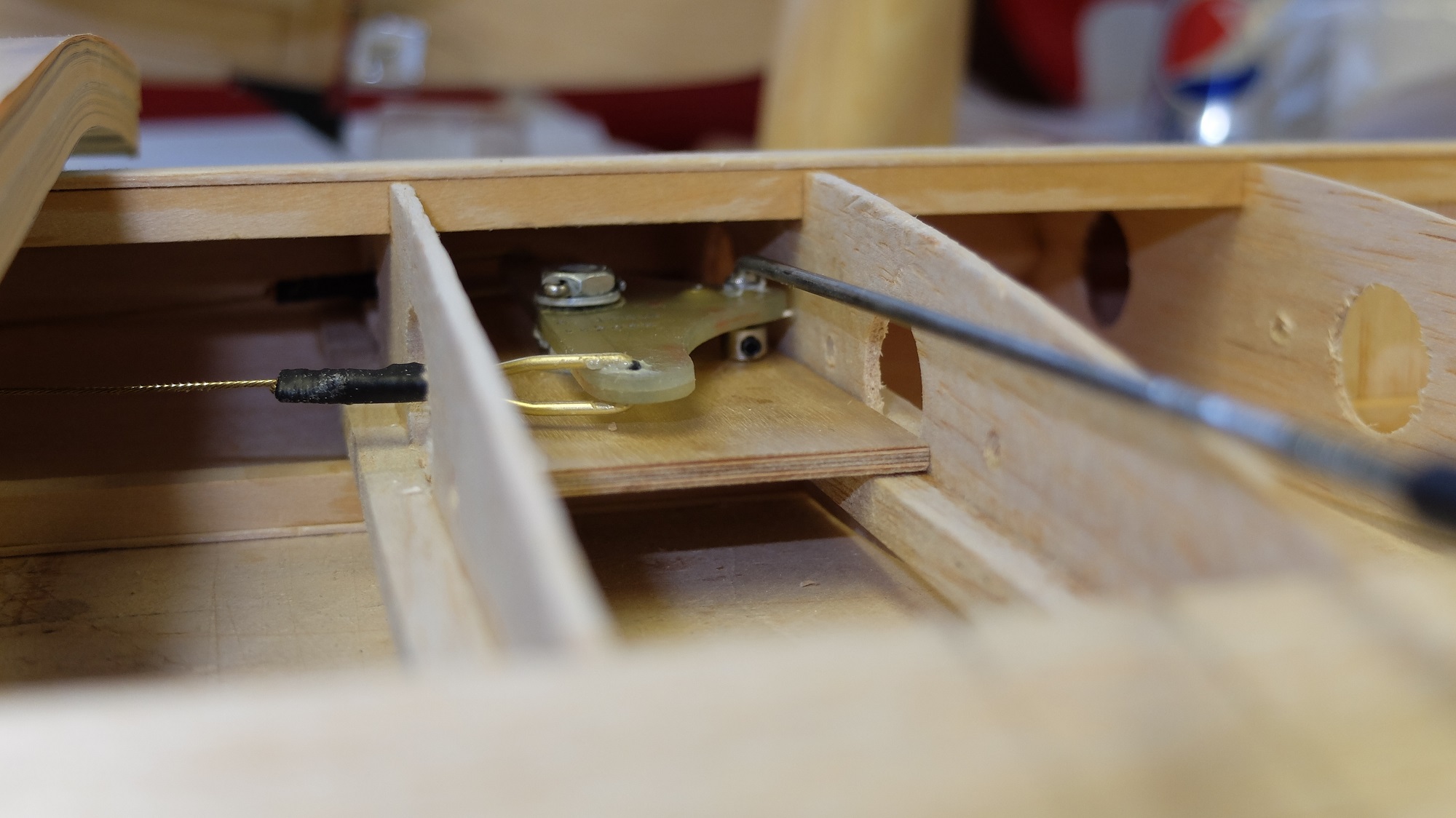

There are many ways of doing this, here is mine that I find works well.
Attached are a couple of photos of a 3" bellcrank (probably should have made it 4" for my model) I made up using 2 layers of 1/16" fiberglass sheet epoxied together, some brass tubing and Sullivan "C-D" lead out cable for a 40 (6.5cc) size cl model.
I wire wrapped the ends and coated them with some slow drying epoxy then put on heat shrink tubing on the ends near the bellcrank.
In the past I have also used small lengths of brass tubing and crimped them to secure the end loops.
Also used a small RC bearing in the bellcrank from an RC car sized to fit the pivot bolt.
