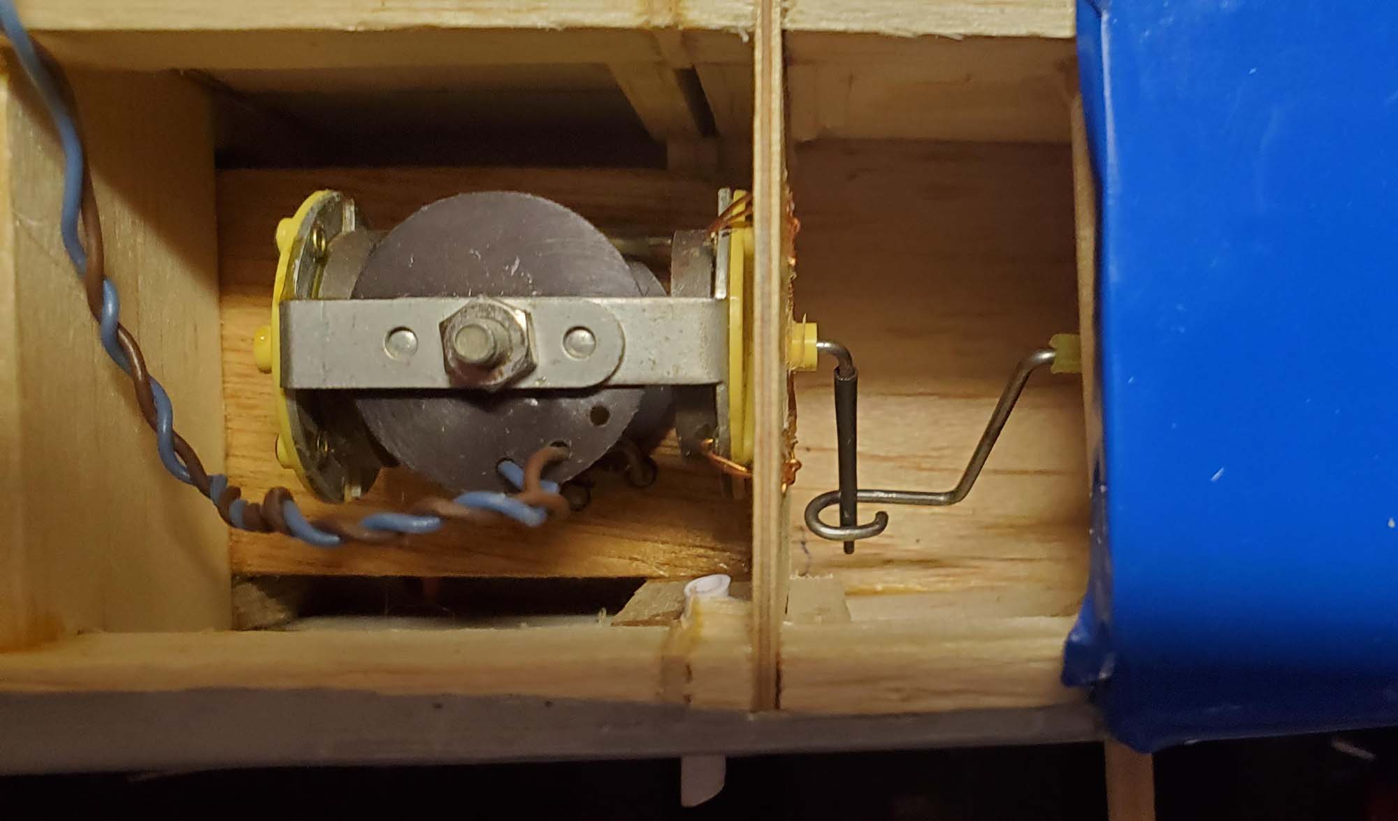

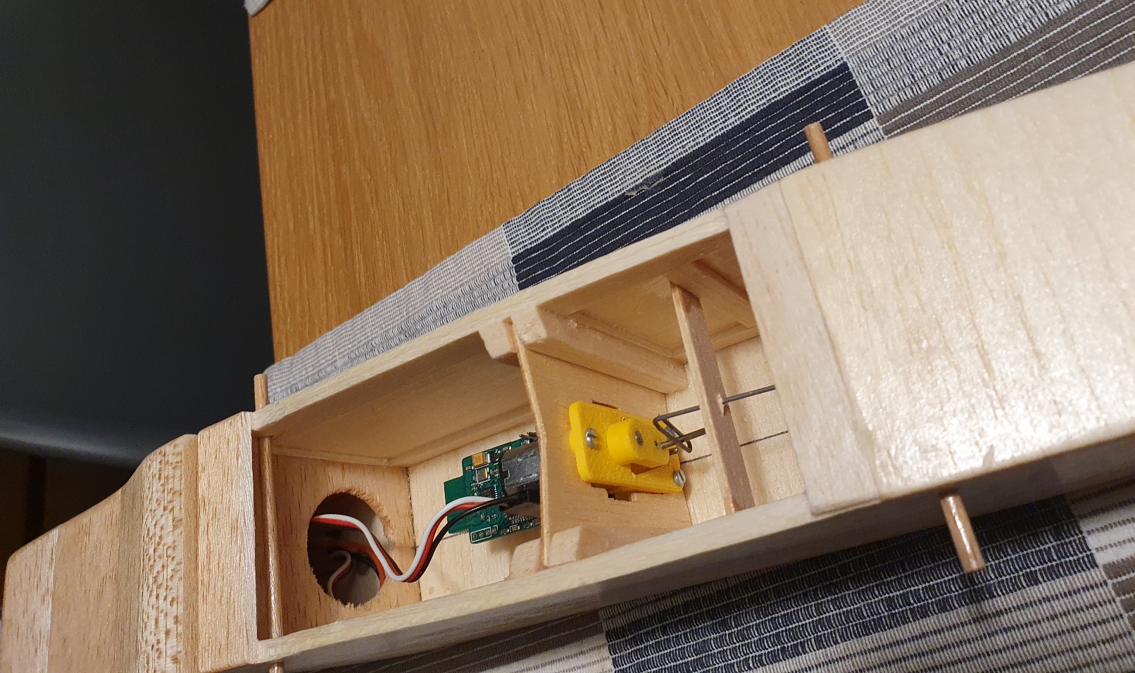

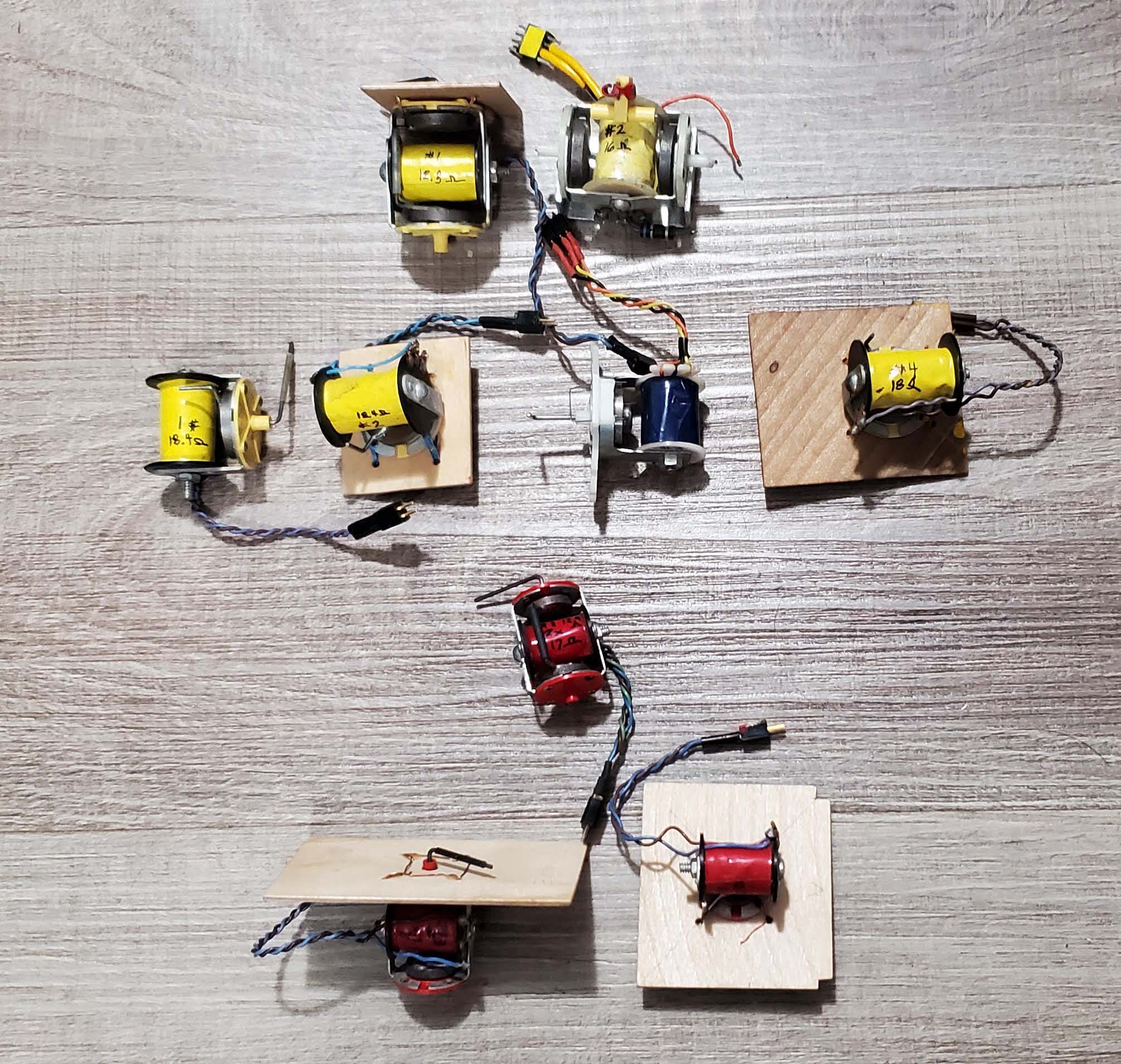

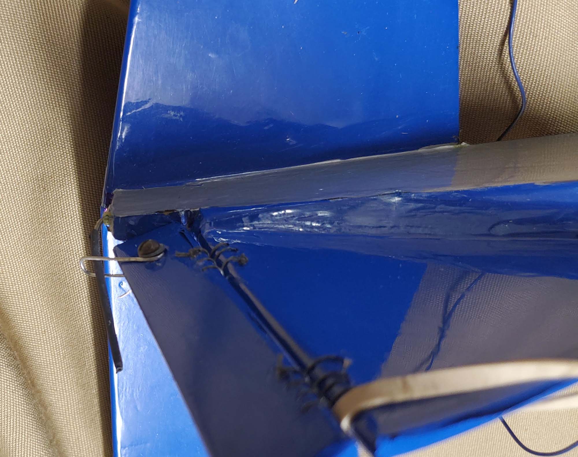

When I fly, the plane will initially roll left which I can correct but as it picks up speed it seems the actuator just doesn't have the ooomph to allow control,. I started with a Adams Std and then changed to a Stomper...same result. I am suspecting weak magnets and low torque of the probably 50 year old actuators. I attached pics of the linkage on the Sharkface and it is free and really has virtually no slop. I also posted a pic of my selection of actuators

I do have a bunch of various actuators so I did a quickie bench test using 2 wheel collars to hold a fishing leader on the actuator wire and then hang lead fishing weights up to the point the actuator stops working properly. The wheel collars/leader weigh <5g. Unfortunatley, my scale reads in 5 g resolution, so it's not very accurate. Here are the torque results in g-cm:
Stomper #1 Coil=18.3ohm w/ 100ohm parallel / <12.5g-cm RETEST WITH SHORTER ARM LENGTH 6.5 g-cm
Twin Mag #2 (this might be a testors?) Coil=16ohm w/ 100ohm parallel / 10.5g-cm
Std #1 Coil 18.4ohm / 2 wheel collars only so <12.5g-cm RETEST WITH SHORTER ARM LENGTH 6.5 g-cm
Std #2 Coil 18.4ohm / 9 g-cm
Std #3 (Mattel) Coil 16.1ohm / 8 g-cm
Std #4 Coil 18ohm <7 g-cm RETEST WITH SHORTER ARM LENGTH 5 g-cm
Baby Twin #1 Coil 12.9ohm w/ 220ohm parallel / <7.5 g-cm RETEST WITH SHORTER ARM LENGTH 4.5 g-cm
Baby Twin #2 Coil 29.3ohm
Baby #1 Coil 32ohm
The last 2 won't work reliably on 2,4V, I believe they are for 3.6V operation based on the coil resistance. I could get more accurate measurements on several by shortening the location of the wheel collars/leader....but they all just seem so weak. Many wouldn't take any weight at all added to the leader (those with a < sign)
for "fun" I measured a Hitec HS-55 and I ran out of weights at 308 g-cm (specs are 1300 g-cm). It's certainly not a powerhouse, but compared to an actuator it's a monster!
So...are my actuators weak??? I couldn't find specs anywhere.

One of the big issues concerning the Adams original actuator is that it's driven by a magnetic pulse after which it's depending on the recoil to get some force , the longer the " throws " are the less power. It's practice to have stops at about half the throw to get optimal function.

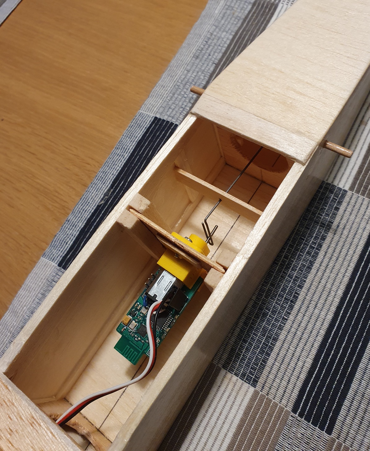

The Adams " Clone " that I designed a few years ago is based on a high rate gear ratio motor set up with a centering spring and the benefit is that the output is drive thru the full cycle assuring maximum output.
Second original Adams magnets will demagnatize over time reducing the output.
Due of the designe of the Adams the installation is of essence requiring to be as smooth as possible and what normally would feel good enough is probably to stiff!

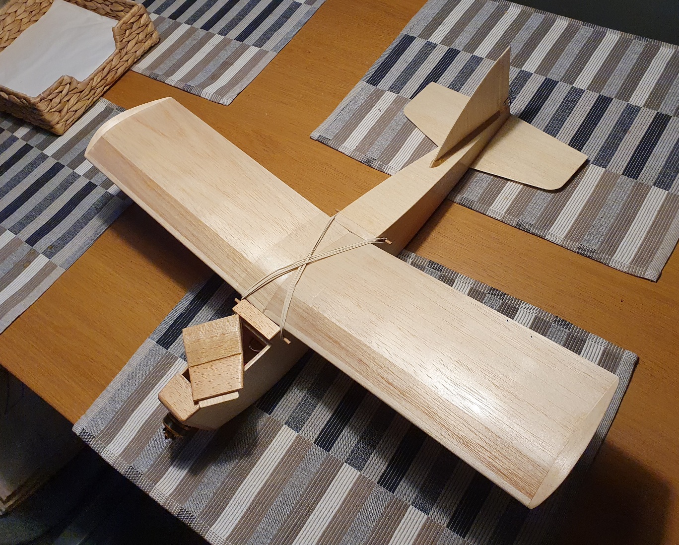

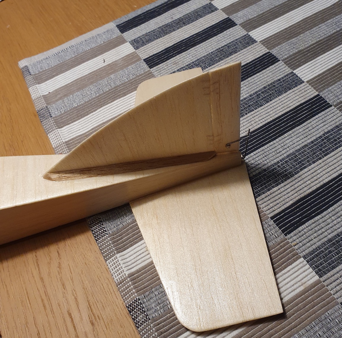

The following are a few pictures of my Sharkface with one of my R/O bricks, this Sharkface weights in below 250 gr. with a 2s LiPo ready to fly.

Looks like i have made at least a couple, suboptimal decisions in my implementation. I am using the full actuator throw and i could increase the force at the rudder by shortening the distance where my torque rod picks up the actuator arm.
